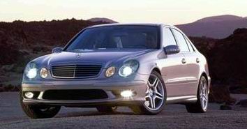

That's strange that the dealer would place that badge on that car, it does seem like deception. A Mercedes AMG is held in the same regards as a BMW M series. If I wanted to buy an ///M3 and the dealer gave me a 325ci, I would raise hell.
The real E55 AMG sedan is the supercharged V8 that puts out 469hp and 519lbs of torque.......insanity.
And as I look for a picture of it, I come across an article that makes me feel like an idiot :) That indeed is an E55 AMG (1999-2002), just not the one I was describing (2003+). That model puts out a "modest" 349hp and is not the model that is regarded as a super sedan.
349hp
469hp
And now if you'll excuse me, I'll be busy surgically removing my foot from my mouth. :bigups
-Mark
