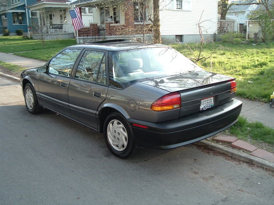

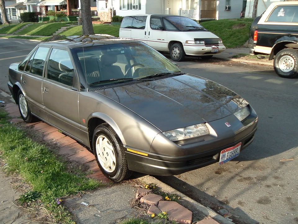

I agree with Accumulator about the rotary, learn it 1st. Practice on some old door panels or hoods. Perfect the technique using old items that can be wasted. Burn some clearcoat off of a practice piece to see what it looks like. Once you start getting the hang of it, learn it some more. Eventually you will have to take the plunge on a real vehicle, but with the earlier practice you will know what to do and what not to do.
Here is what you can do with one:
This was from last year on a 1992 Saturn SL I bought at an auction. I paid $600 for it in '02. Look how nice the paint is after I got done. This was my practice car. So you can see it can be done. Good luck. :D:D:D
Get the basics down first (full detail):
Wash
Claybar as necessary to remove embedded contamination
Wash/Rinse
Polish with abrasive and/or cleaner as necessary to remove swirls, oxidation, etc.
Wax/Seal
