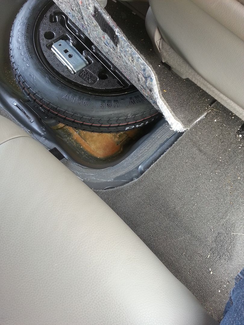

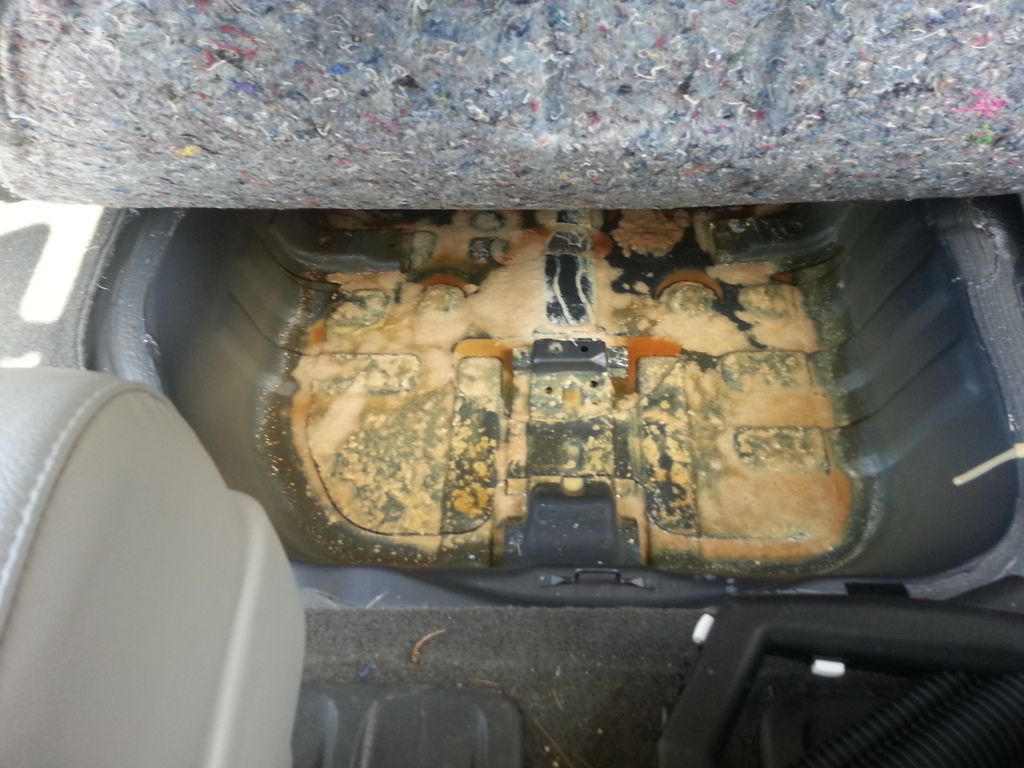

The biggest issue here is to try to determine - where - did an entire Gallon of milk go, and then go there and try to remove all of it if possible...
I am sure the entire gallon went to the front first since it was on the front seat and then ran back all the way to the floor under that side of the back seat if there is a hump all the way back to keep it on one side...
And then you have all the carpeting and pad underneath that got wet with milk, so every square inch has to be looked at and cleaned, extracted a lot, and cleaned again to be sure you did not miss anything...

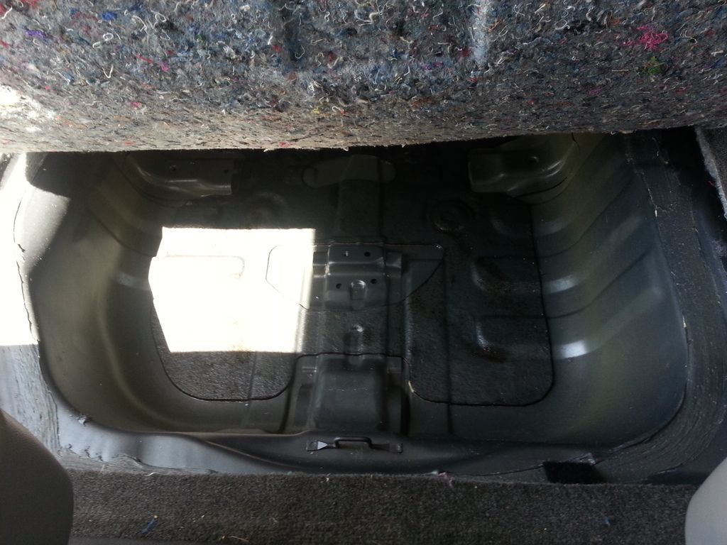

Once the front seat and back seat are out, you can look at the floor and probably see the trail of it and better still follow the smell and eliminate it...
I agree there may be deep places in spots - Im thinking that the floor sill might also be a place since it is usually a tunnel, where some wiring is in, may also have some stuff in there so you need to check there since you will already have the carpeting out, right ?

You might check the foam of the seats - with the sniff test - and see if they are holding some milk in the foam as well...

Just keep moving forward, focus on an area, get it totally done, then move on to the next area...
Coming from the military, I always liked to grid things out so I can see it and then get everything in each part of the grid done before moving on, so I dont lose my place..
