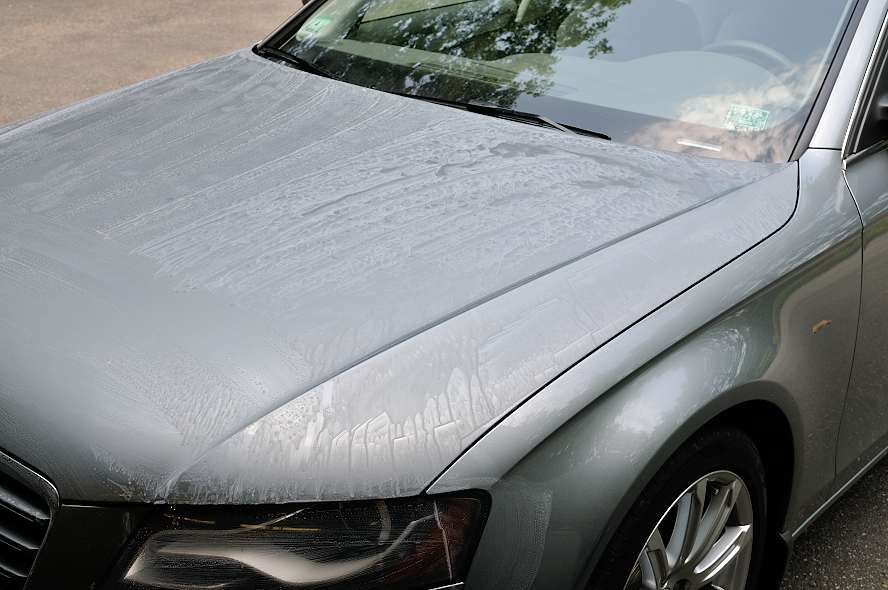

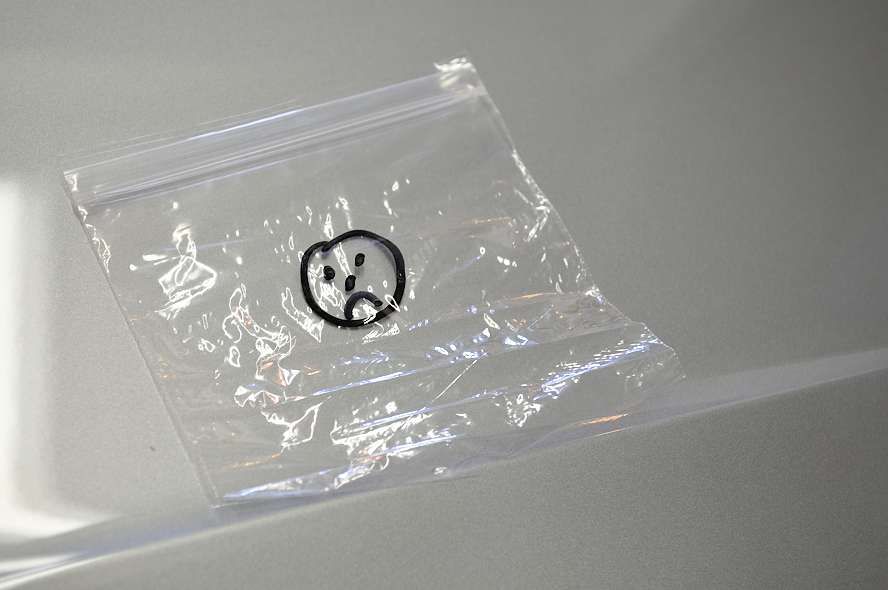

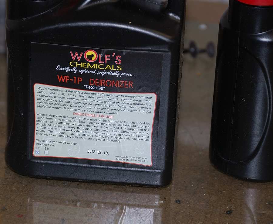

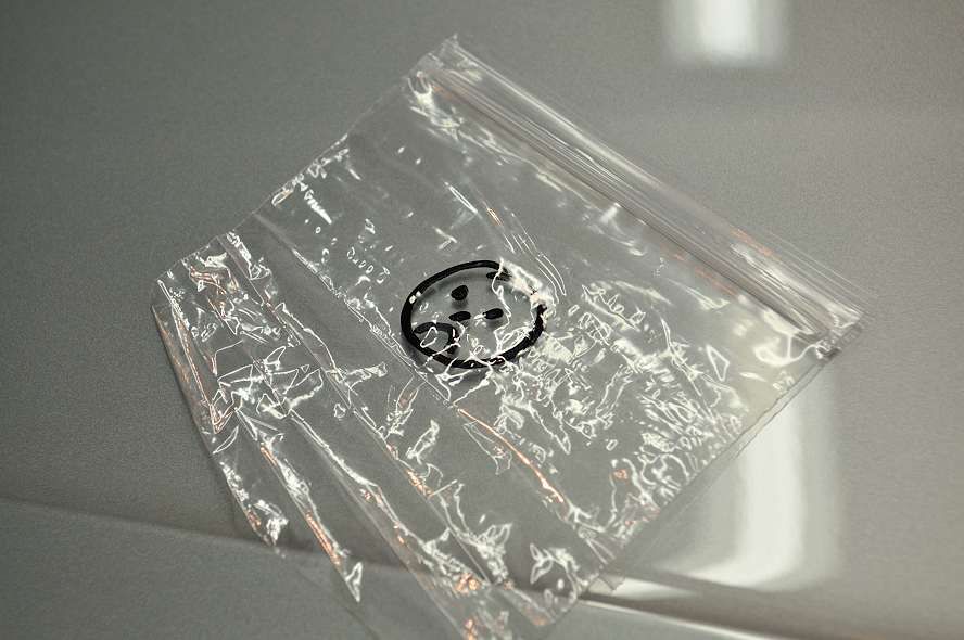

Here's my follow up on the plastic baggie test. I bought some of the Wolf's "deironizer" decon product and applied that. I let it sit for about 10 minutes. I'm only working on the hood of this car. I had OptiCoated it about 6 weeks ago and I strongly believe I sealed over a bunch of stuff. It failed the plastic baggie test in a miserable way.
Here's the Wolf's product after 10 mins of dwell:
It rinses easily, I did a quick wipe with water and my wash mitt:
I did the plastic baggie test again and would estimate that the Wolf's did remove a good amount of the tree sap, but I suspect much of the stuff I'm feeling is under the OptiCoat and more aggressive action would be needed.

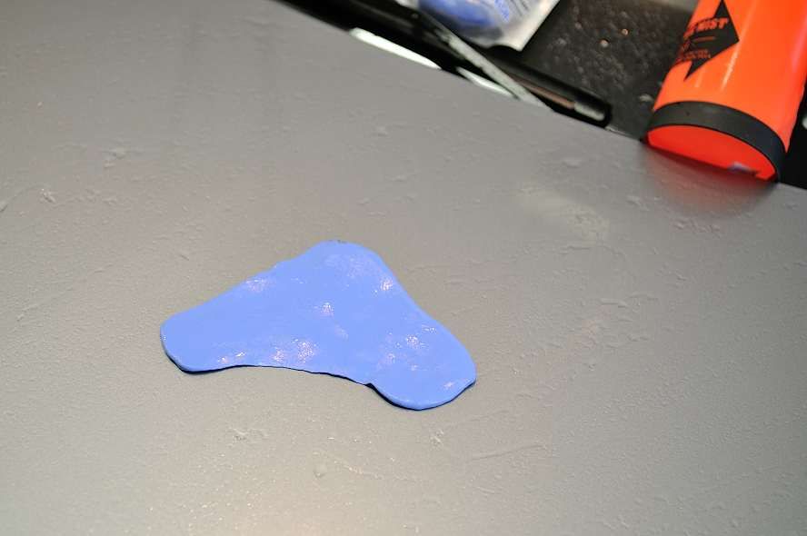

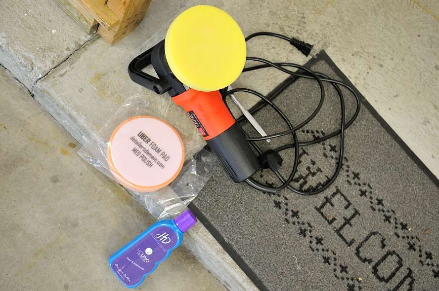

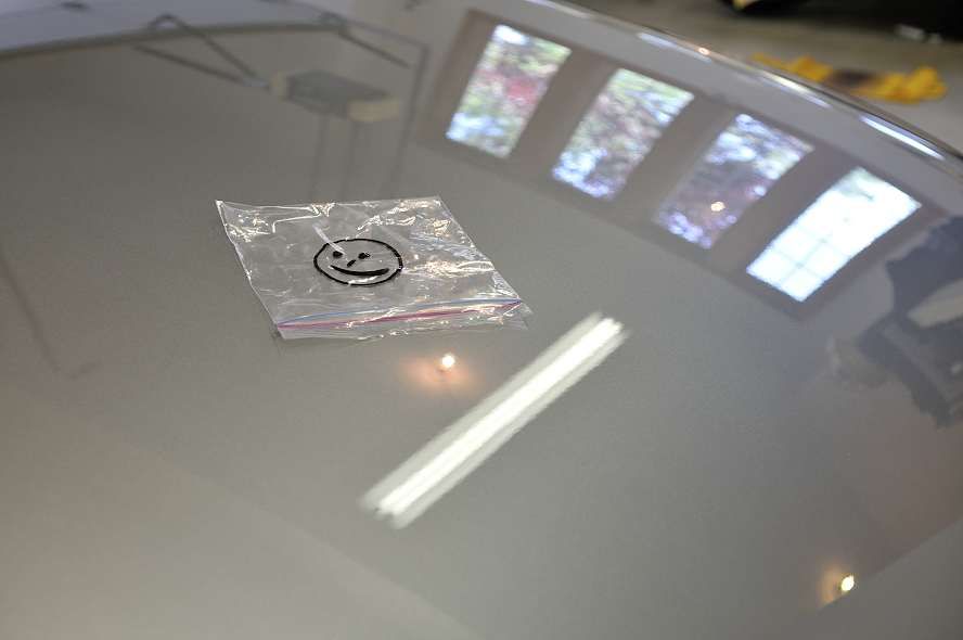

I wanted to test the action of clay vs. Uno polish on the OptiCoat. I polished half the hood with the Uno without claying. The result was quite good, but still not 100% clean.

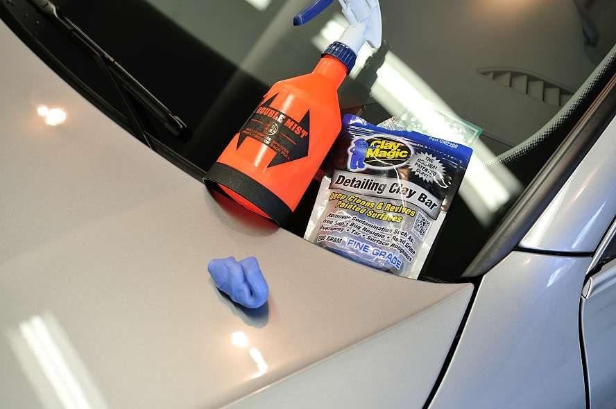

I moved to the other half of the hood and did just clay, the result was not as good as the Uno:

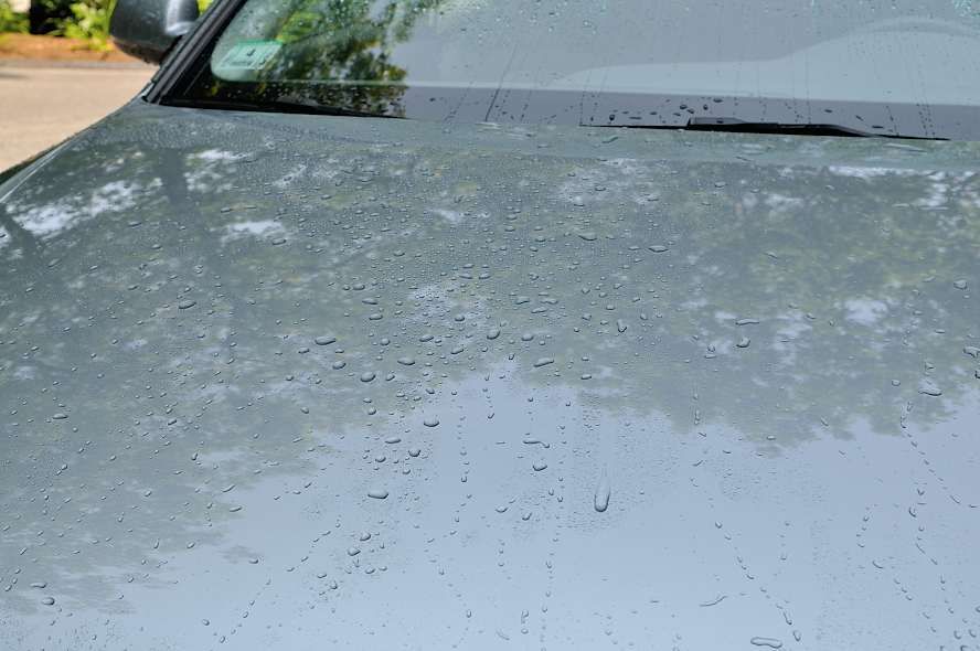

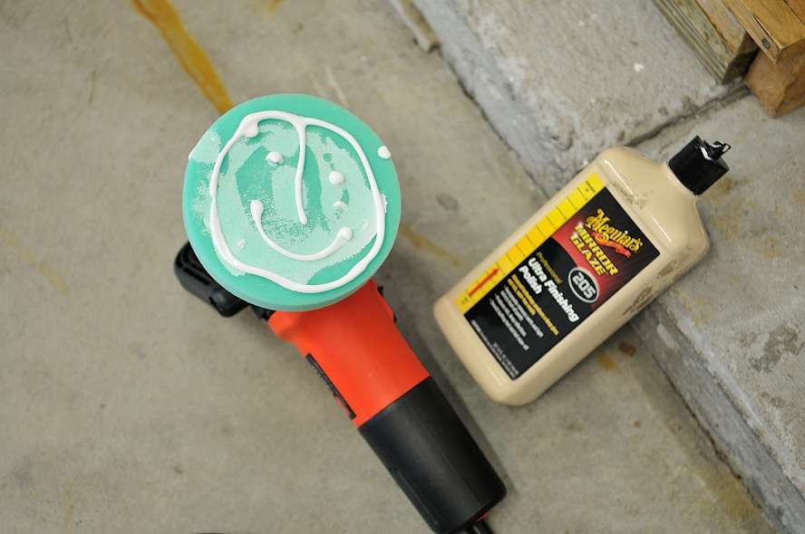

I ended up doing the entire hood with Uno (aggressively) followed by M205 to maximize the luster:
I'm sure the hood is the worst of it. I'll have to deal with un-doing the OptiCoat on the fenders and front bumper. The rest of the car has FK 1000p on it and I was able to get quite a respectable result with just the clay and M205 followed by a sealant. That was close to 100% contaminant free. The OptiCoat introduces a far greater challenge when cleaning this up.

Here's the Wolf's decon product:
Yes, it's got kind of a foul smell, but who cares? (I'd liken it to a ripe out-house on a hot summer day and someone has attempted to mask the odor with a mint air freshener ;) )
I was concerned about applying/spraying it, but it was not an issue. It mostly sticks where you spray it. I did smear it across the hood of the car. The viscosity reminds me of something P21S TAW where it clings well. I'm looking forward to trying it on some cruddy wheels and tar-caked regions just behind the wheel well openings. Those seem to represent a bit more of a challenge.
I did not observe any color change when using it apart from it turning light as it dried. As noted above, it rinses away nicely and seems to leave a fairly clean surface with minimal to no agitation. I'd guess 1L bottle will do several vehicles.

OK, to address the questions about whether the Wolf's turns red or not - - it does.
I had the good fortune this afternoon of a big Audi 4.2L rolling in the driveway with dirty wheels :bigups :bigups Now, we're not talking "toxic dirty" as this car is well-kept, but the wheels hadn't had a proper cleaning for some time and I was very excited about trying the Wolf's. While the owner thought my request a bid odd, they said "sure". On one side of the car I did the front wheel with just the Wolf's and the rear wheel with Griot's since it was already sitting out. The Wolf's does turn red after about 3 - 4 mins and then it turns black as it kinda melts the crud clean. It was hot today and the wheels/brakes were hot so I got quick drying and had to agitate to get it to rinse away. The rear wheel cleaned up pretty well with the Griot's, but a fair amount of embedded stuff (corners) remained and I really wasn't surprised. The front wheel was cleaner but somewhat dull. The Wolf's is certainly not a weekly wheel cleaner but more of a re-con type of product...as I expected.
On the other side of the car I misted the wheels with the Wolf's and grabbed a tooth brush. I did just a bit of scrubbing in corners with the tooth brush and that was enough to liberate the embedded stuff in the corners. I was quite pleased to see this. I've used plenty of different wheel cleaners and was impressed how well it did without too much effort. I then followed up with an application and secondary cleaning with Griot's. The wheels looked nice after this and were mostly clean without much effort :)
Wolf's is reported to be pH-neutral.

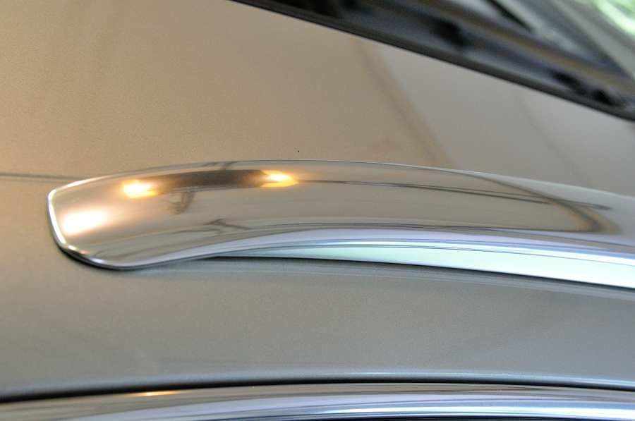

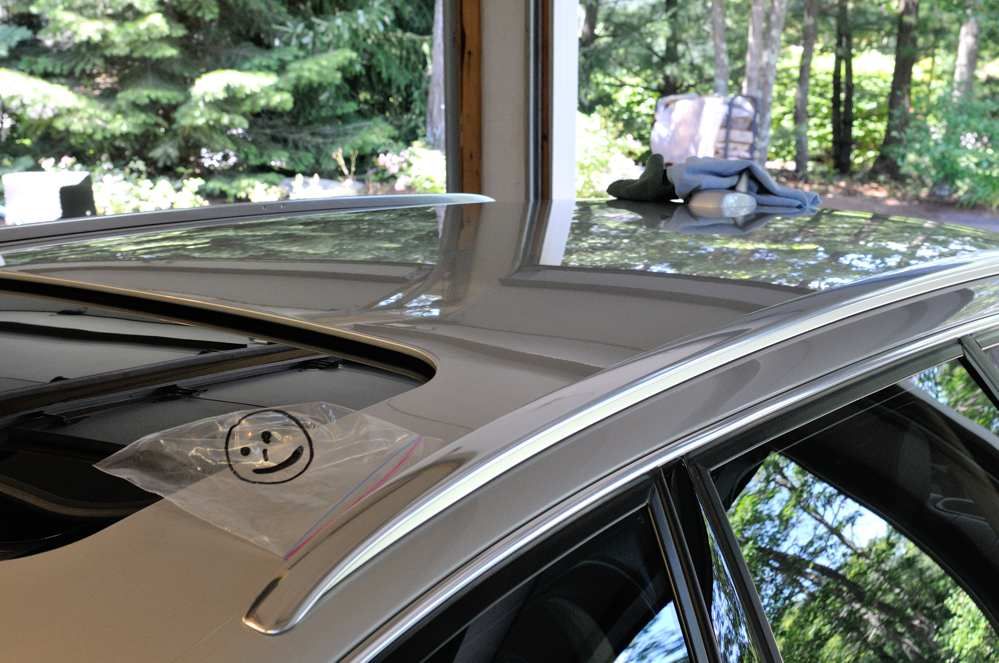

I spent some additional time with these new products today and found that the Wolf's cleaned up what appear to be water spots on these alumimum roof rails on the wagon. I have not found any other product that could improve the appearance. One rail is perfect, the other not too far behind.
I followed up with Uno and then IPA wipe and finished off with OptiCoat. This car is pretty much done and is an excellent candidate for a "permanent" coating like OC.

The M205 is very light in it's cleaning or abrading ability but definitely more than Paintwork Cleansing Lotion, if you see any swirls, haziness, dullness at ail in the paint, go with the M205
I've spent some serious time on several cars trying to clean this stuff off with #205 and it is not the solution.
I don't have an explanation but whatever M#205 left behind, the cleanser products cleaned it up. Doesn't make sense I know, but that's what I discovered.
