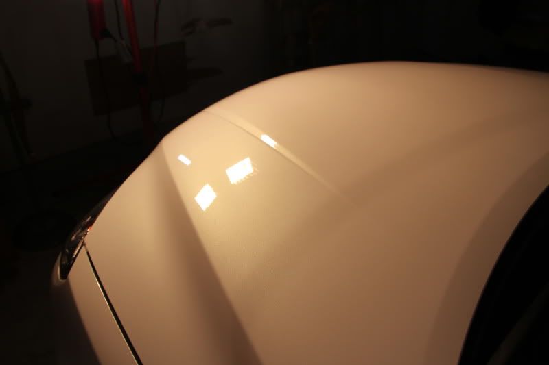

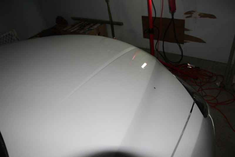

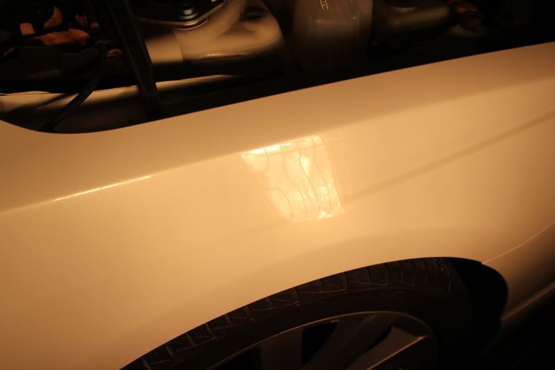

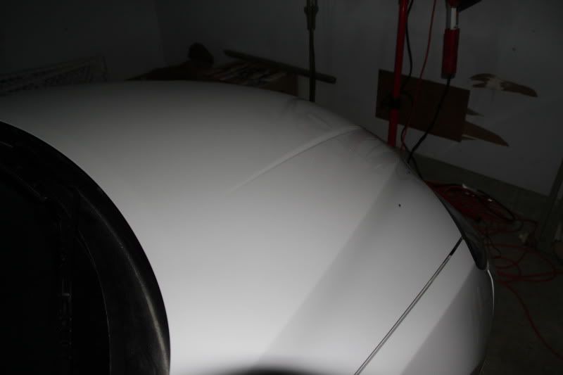

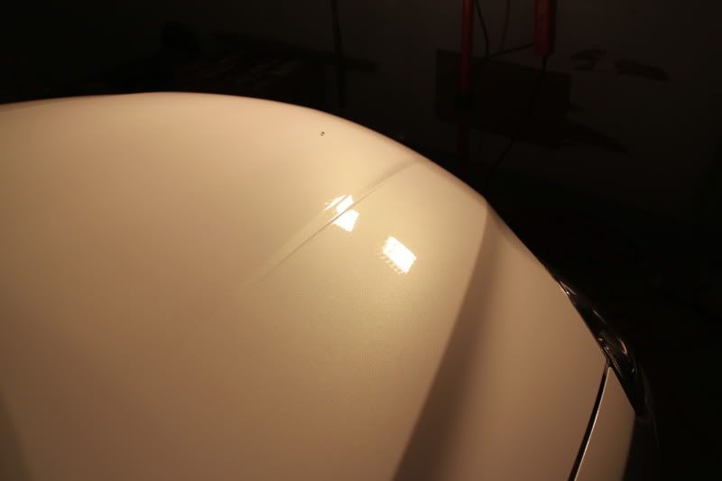

Yeah, I think I will lay down some duragloss first, since it has some cleaners and a VERY minor polishes in it... it will make a good base for the FK1000 IMO. The pics here are hard to see... the car is VERY bright white, but has nice flake in it... I tried to pick it up as good as I can, but I don't know if it picked up the surface scratches or not, but there were quite a bit of swirls. Honestly... Mazda paint is a lot harder than I thought it was!
These are the only shots I could get that showed the paint condition.. hard to see, but at least you get an idea... the whole car is like this and the hood was even worse!
Hood pics
You can see some of the very nice flake this paint has here...
