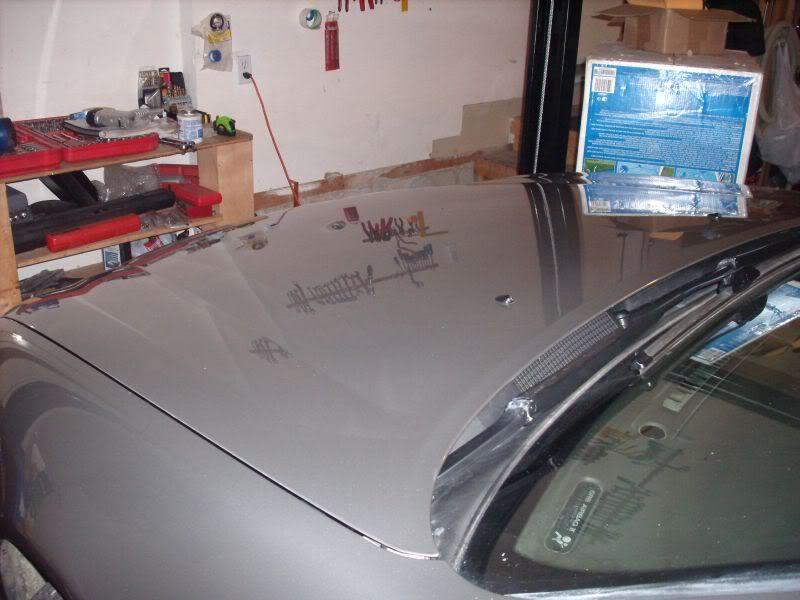

For the heck of it I did my dad's car. Daily driven 01 infiniti. Has ~250k on it. Not that bad a gloss imho.
