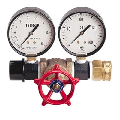

ok old thread i know i know....but how are you guys restricting your water flow to 2 or 3 gpm going into the filtration system??
....I have been using the fan setting on the nozzle since I have simply been too lazy to find a permanent solution but I believe Accumulator is using a restrictor/regulator he picked up from an RV store (IIRC). I found a brass pressure/flow gauge from Toro that is actually meant for testing but I was think about using for regulating (it has it's own adjustable valve as well). ....its overkill though and while it looks well built, I don't think it was meant to be used in a role where it is permanently fixed:
I would think an RV store or something similar should be a good bet.
Yeah, I'm using a pressure restrictor from the RV store. Simple little brass gizmo you screw in between the spigot and the CRS. I don't regulate the volume/gpm flow into it, but if I felt it necessary I'd just turn things down at the spigot.
