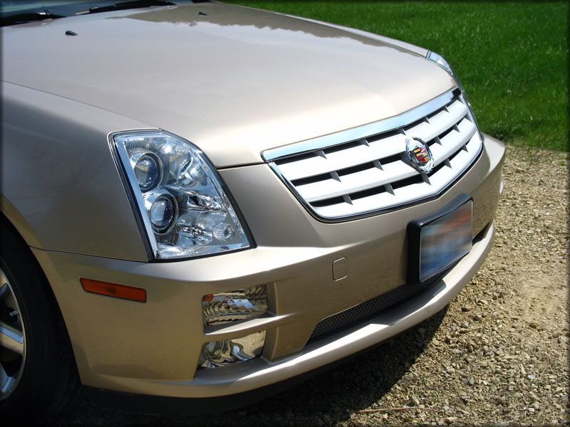

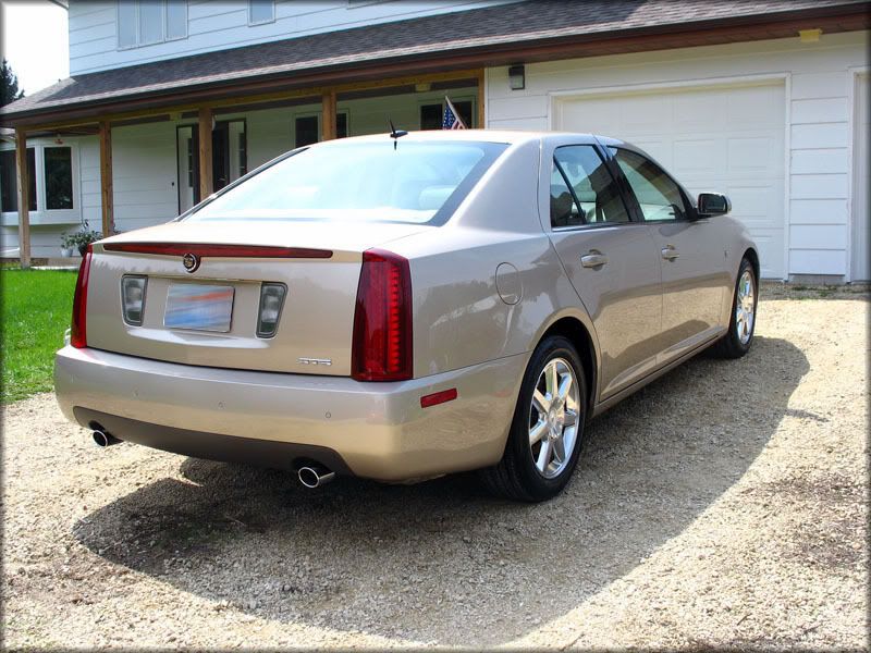

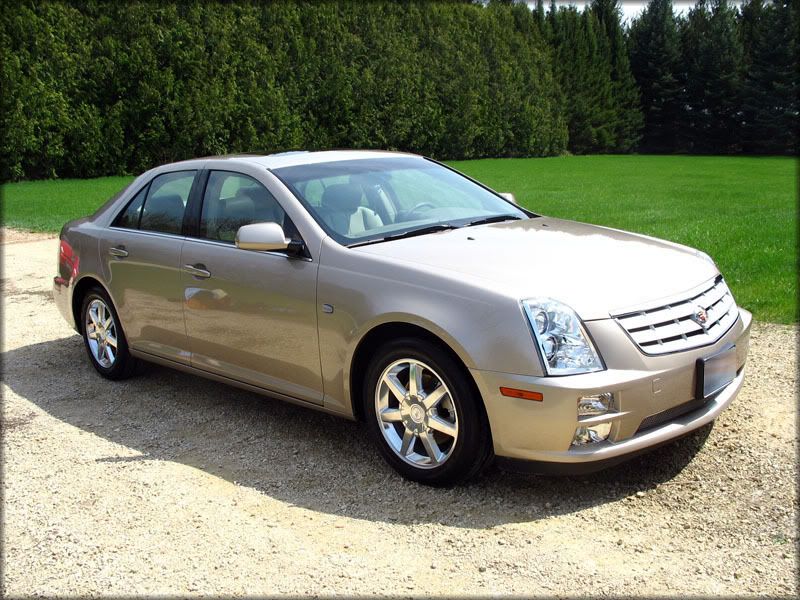

Cadillac STS - Acura TSX - pic intensive.

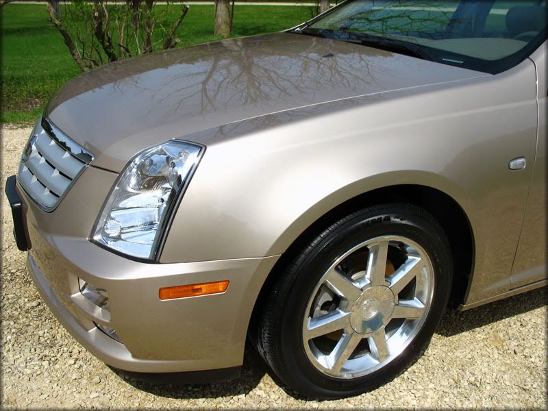

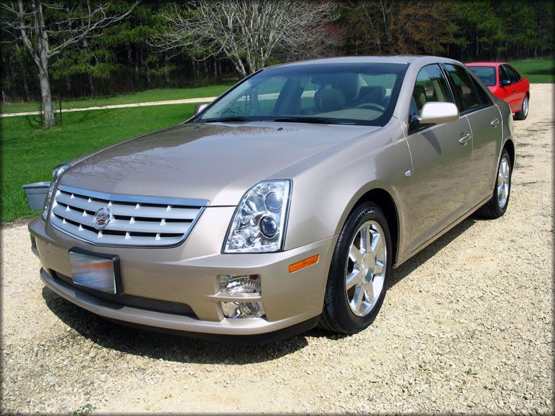

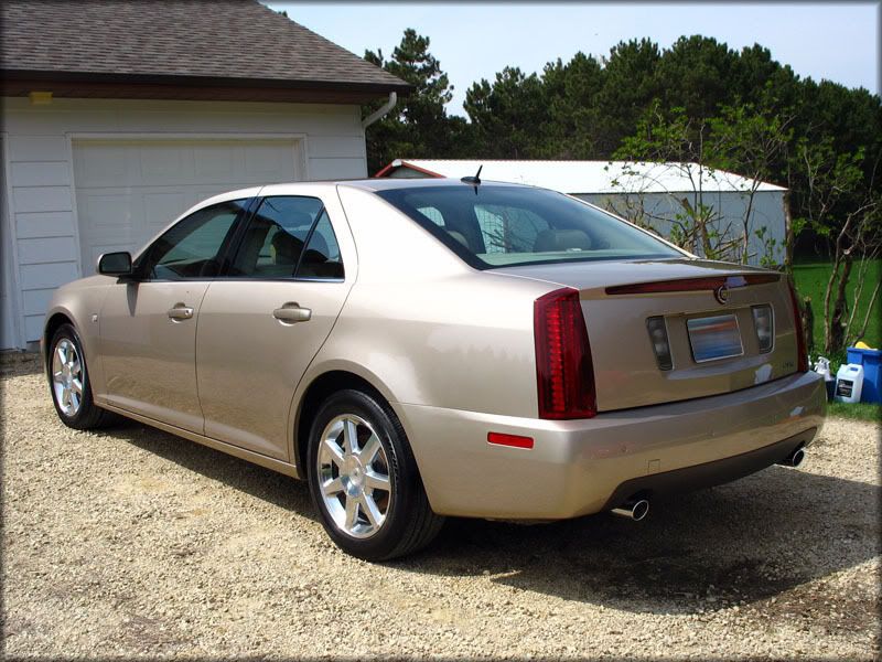

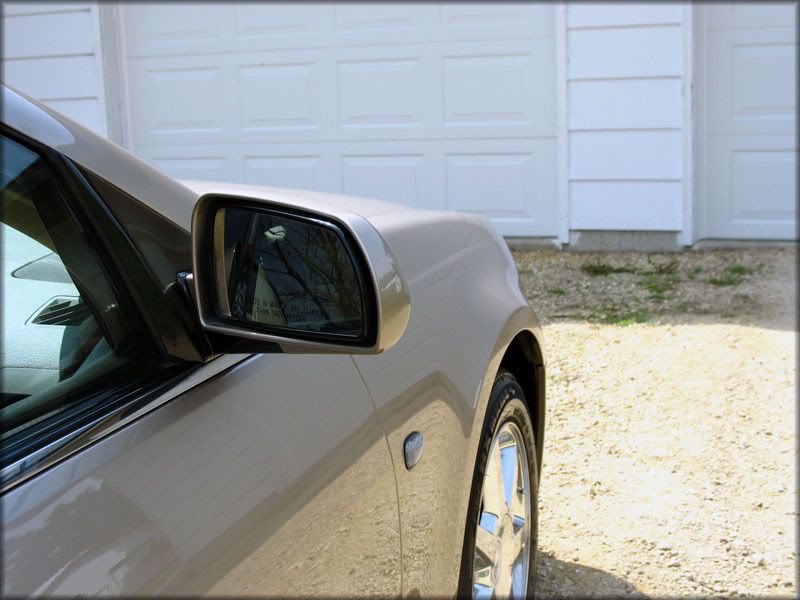

First up, a cadillac STS. I did this vehicle last October. It can be viewed here: http://autopia.org/forum/click-brag/78757-cadillac-sts-zainod.html?highlight=cadillac+sts
The Z5pro-Z2pro Held up like a champ over the winter.
Process:
Wash Z7
Clay Z18
Blackfire SRC finishing polish - polishing pad - PC @ 6
ZAIO
Z-CS - Paint, Trim, Windows, Glass, Rims, Exhaust
Z-8 Spray Seal
Z16 on tires, engine, and wells

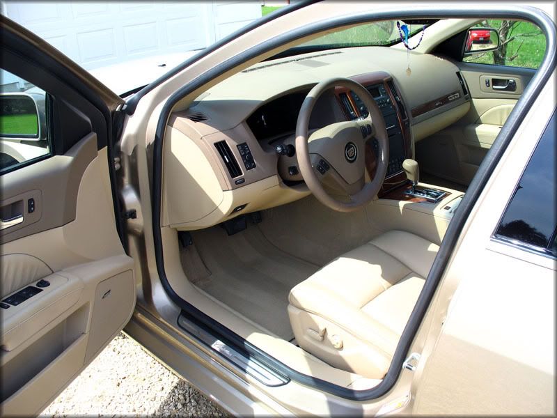

Interior:
Vacuum
Folex
Leather - Z9 cleaner & Z10 leather condtitioner
Z26 on interior surfaces.
A few deep scratches on trunk remain for clear coat longevity reasons. Snow brush :mad:

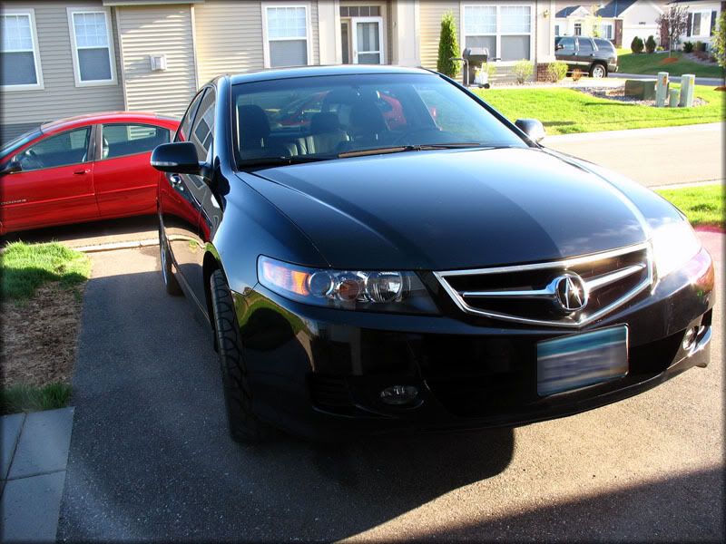

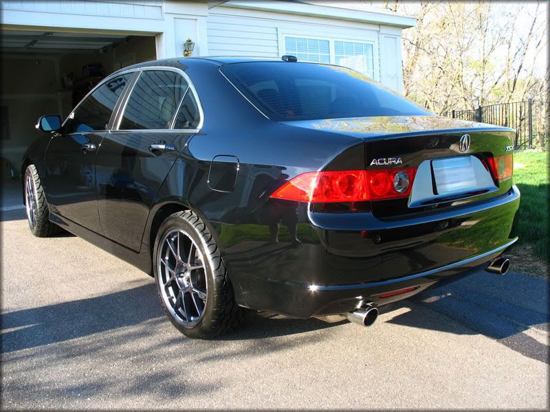

Up next... TSX

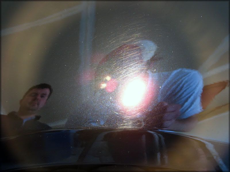

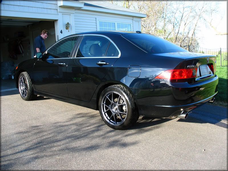

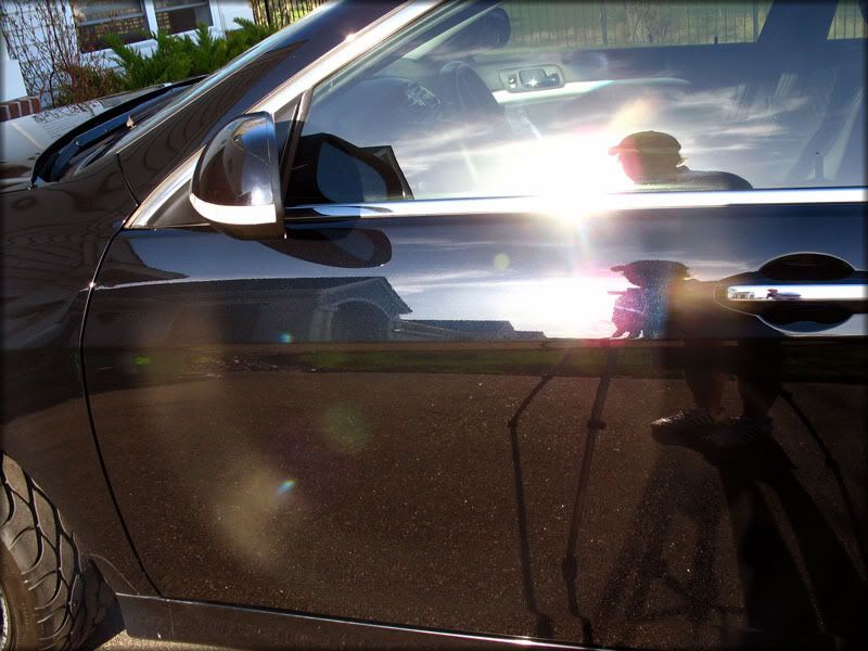

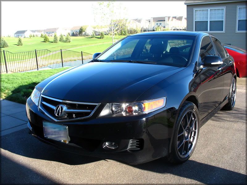

Today's job. Acura TSX done last year. The owner maintained with Z6 + Z8 over winter. Unfortunately, the car was pulled through a brush car wash leaving many Deep scratches.
Process:
Z7 Wash
Z18 clay
HTEC/OPT polish @ 1500 rpm...... I need presta :(
Blackfire SRC , pc @ 6
ZAIO
Z5pro
Z-CS
Z16 on tires and wheels
ZPC and steel wool on exhaust
Pics aren't the best.

i've always loved that BLUE flake in the jet black paint on those Acura's...
forget what acura calls it tho...
good work

Nice wheel work on the TSX, I really like how those tire-treads grab your attention. :cooleek:
GregCavi said:
...It was a hassle because my pad kept gumming up. I am hoping the presta will buff a little easier...
Greg, sometimes it is not the polish responsible for gumming up and/or skipping, etc. The same combo can work extremely smoothly on a decontaminated surface.
For me the HTEC pulls a gummy strip here and there for no apparent reason, but when I do a straight IPA wipedown before polishing, it doesn't happen that often.
Car looks really good, but have a question for you. When you use Z-CS on the trim, specifically on soft rubber moldings, how well do you find the product to work? Does it streak? Does it leave a dressed, or semi-dressed look? Does it blacken the trim a lot? How well does it hold up?
A little O/T here, but I completely agree here. I swore never to use #83 DACP again because of constant gumming issues, but I'm a sucker for punishment. So when a friend brought some over to have me help out polish his car, I used it, but tried something new. I divided the hood into three sections: 1 section was washed and clayed, another was wiped down with diluted apc, washed, and clayed, and the third second was decontaminated with ABC. On the washed and clayed section, I had gumming issues, drag when buffing, and just general problems with DACP. With the other two sections, DACP worked like a dream, so we ABC'd the entire vehicle, and I had not 1 single remaining issue with DACP, it even seemed to not dry up in the heat.

Thanks folks! I will definitely try some IPA prior to the HTEC in the future. I used the same combo on a vehicle yesterday and it worked like a champ. Go figure.
