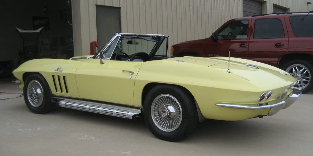

The car was very clean when I started on it... a few swirls and micromars to correct. But not too bad.

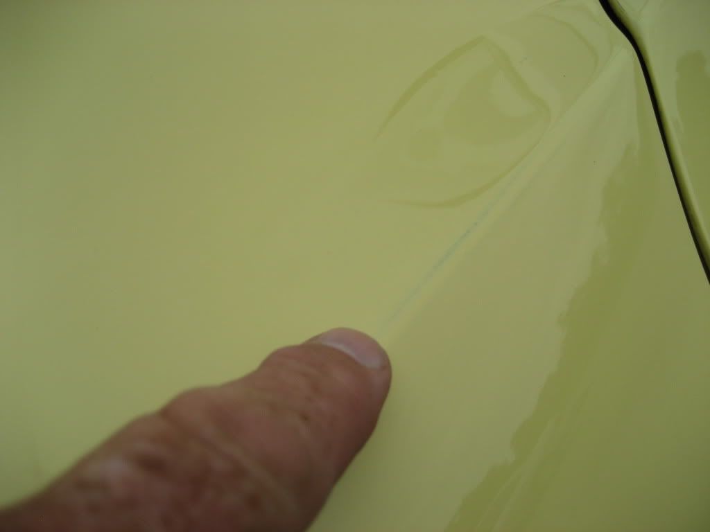

The worst part was the THIN PAINT!!! I had to be very careful around the high ridges on the fenders and the beltline.
There were also some areas that the paint was so thin that I could see the primer below it. A few stress cracks in the fiberglass, etc.
Paint is about 15 years old. Base/Clear.
Process:
Washed with QEW
Clayed with Meg's Quik Clay
PC 7424XP, M205, LC Orange, KBM
PC 7424XP, Zaino AIO, LC White
Applied Z8

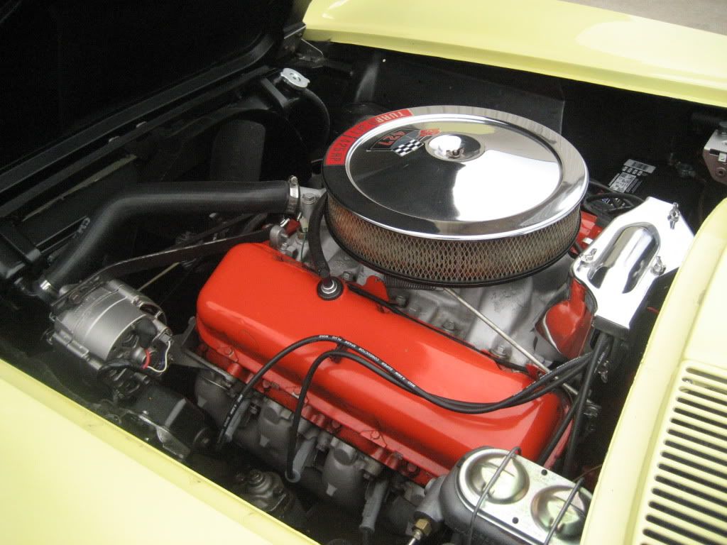

Engine: (It was pretty clean)
Sprayed and wiped with Sprayway Glass Cleaner

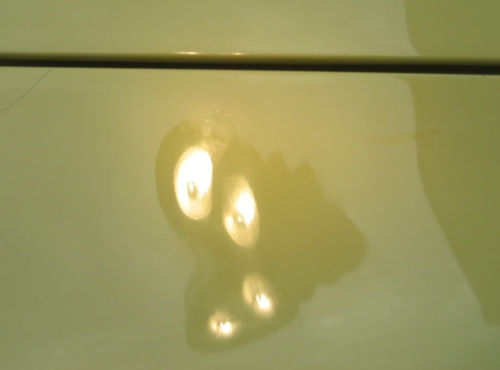

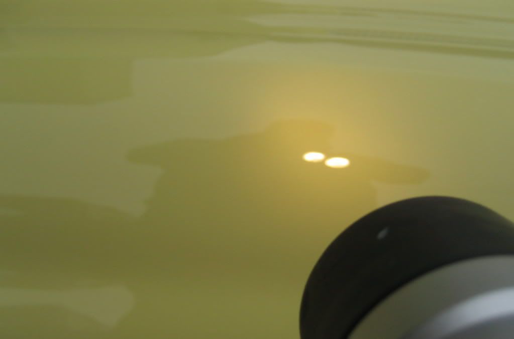

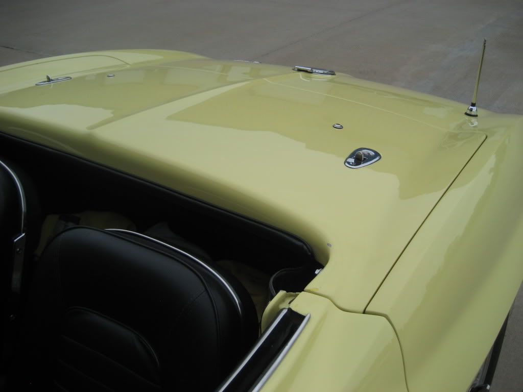

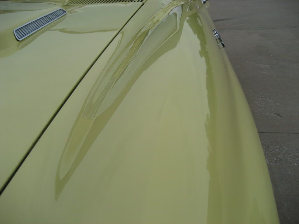

Before:
After:
