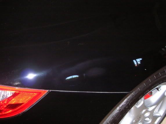

Perhaps the cloudiness around the spot is haze, but I'm pretty certain that oval spot seen in the pics is something totally different.
Just to be sure I'm "reading" the picture properly, it is a quite large area that is blurry. Correct? If so, it simply looks like compound hazing via PC. Polishing with SSR 1 or 2 and a white finishing pad should remove this...though it could take 5 or 6 really slow passes to do so, as SSR 2.5 can leave a pretty heavy haze on black

Well, the last time I saw the car in person was last night in a garage with not so good lighting. The large blurry area was not even visible at that time. I had the owner of the car take those pics and email them to me so that I could post them here to perhaps find out what is going on with this paint. He had actually mentioned to me over the phone about the larger cloudy area, or hazing that he noticed during the day.
I have detailed this car in the past to remove swirls, so I am familiar with hazing and how to remove it. That large area is not my concern though. The oval blur however is. FWIW, the owner did mention that the spotty area feels slightly smoother than the surrounding paint.
Well, it's too hard to see from the pictures to be certain. An experienced detailer (or paint shop) will have to look at the spot, but based on what you are saying and that you are familiar with compounding haze, I fear the worst for your client.

From what you are explaining about the spot decreasing/increasing in size as you polish it is sounds like yes you burned through the paint. The picture did not help me see what you were talking about, but one thing you can do is when you polished the spot at any point of time did the pad/rag have a diffinate black spot on it? If the pad/rag had any real black pigment on it then yes you burned it. You can still test that spot by hand polishing the spot with a rag and if the rag has black on it is burned. Only test it a little bit, don't use a buffer or spend a lot of time hand polishing you do not want to make the spot worse you only want to check for black paint.
It's only polishing haze. Get some SSR1 or FPII and a finishing pad then work the area about three times on speed 5.5. The haze will go away. Then finally, take a deep breath.

I too have a black 997 and the paint is pretty soft and can be challenging to work with. If you haven't yet, you might want to try either Vanilla Moose or RMG with a finishing pad. The finish appears to be smooth enough and it looks like you may have some "haze" left over from the polish and the fact that you used an orange pad. Assuming the orange pad is light cutting rather than a polishing of finishing pad. It also looks like you may have worked the polish a bit too long?
