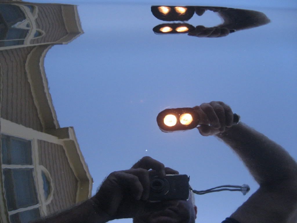

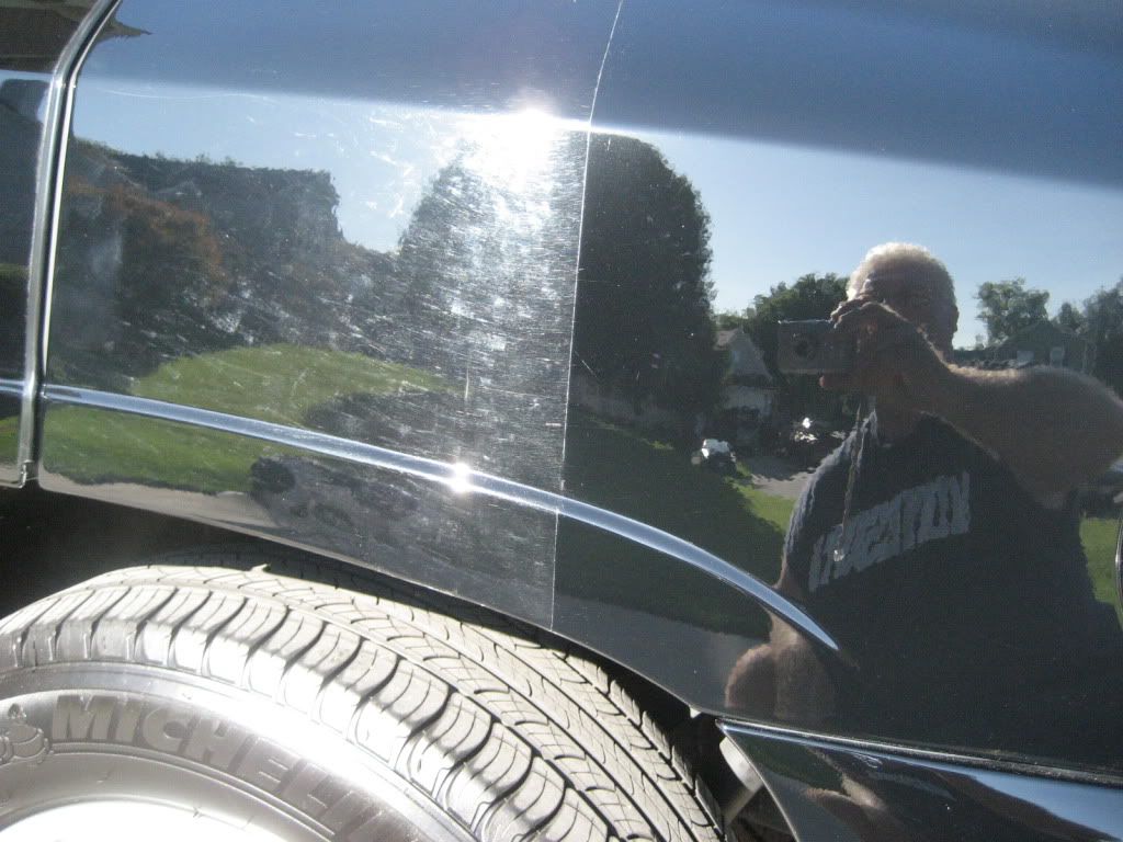

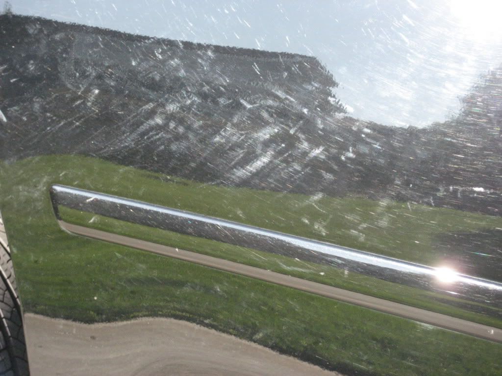

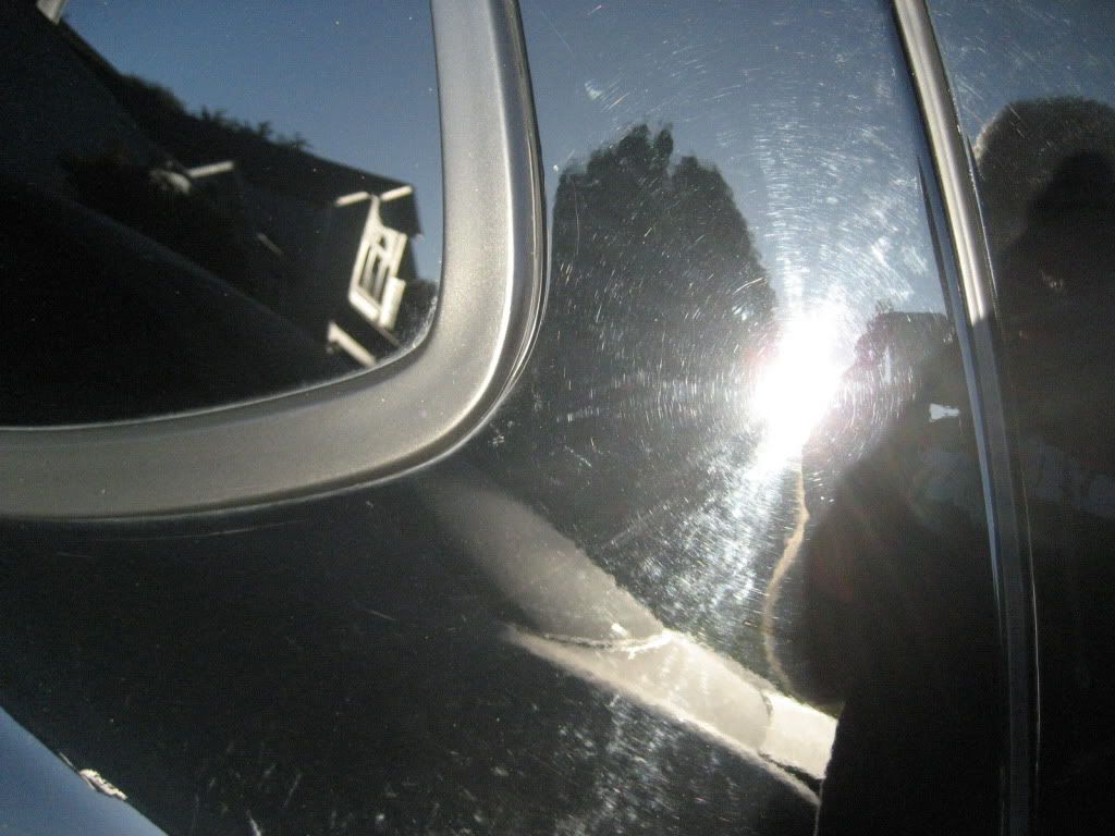

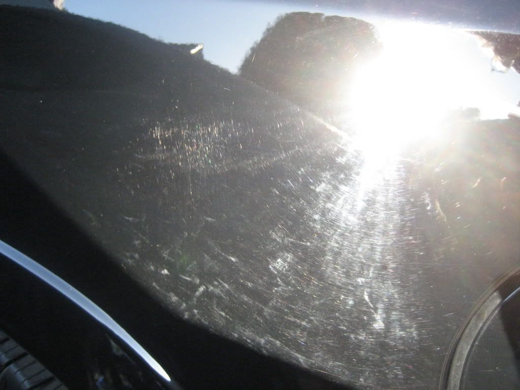

BEFORE:
This is not dirt, these are SWIRLMARKS!

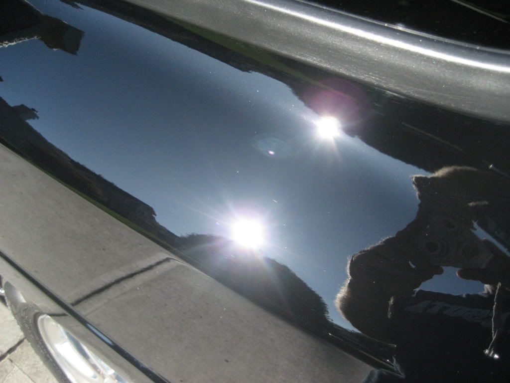

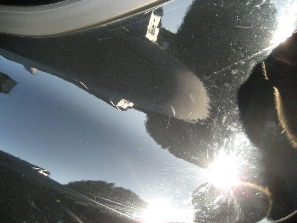

50/50:

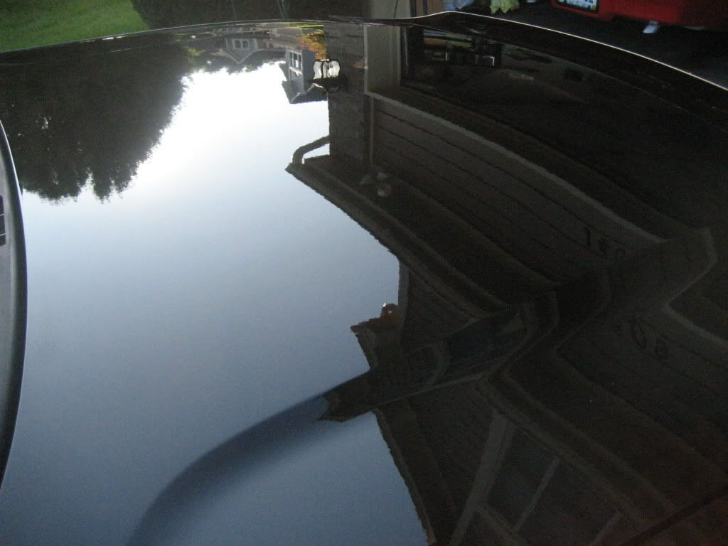

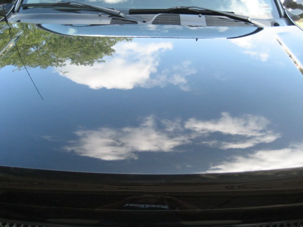

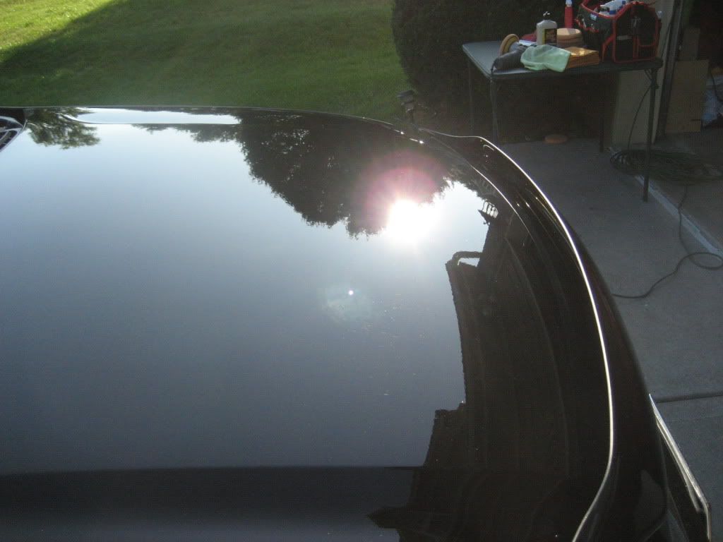

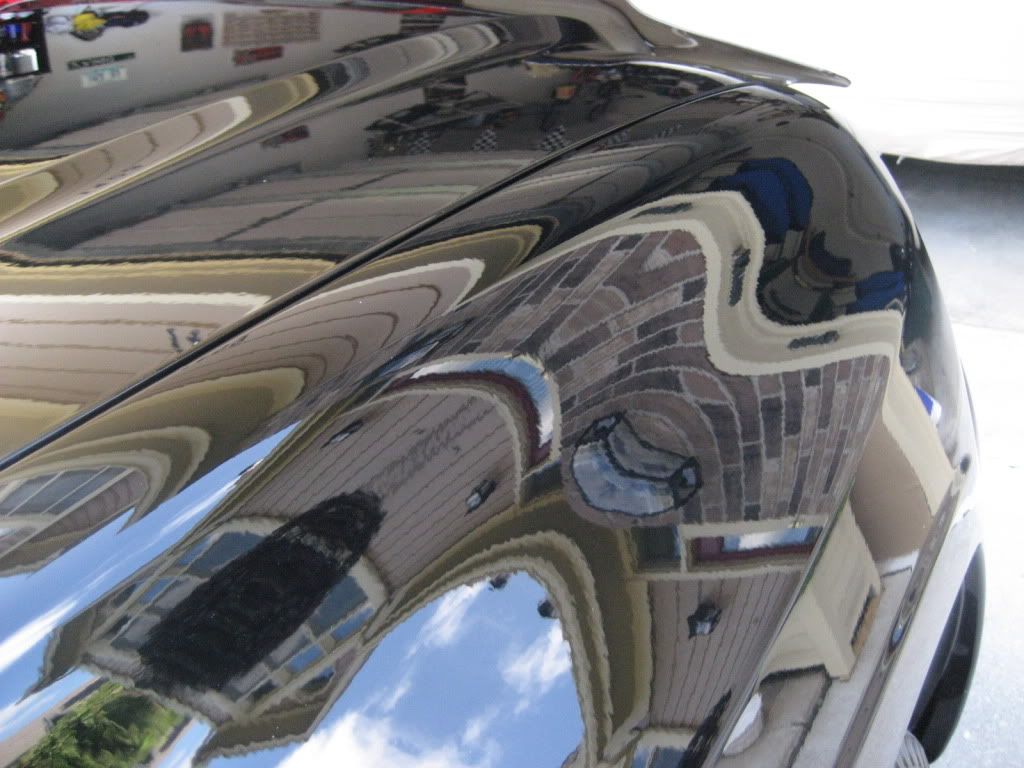

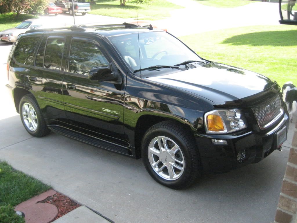

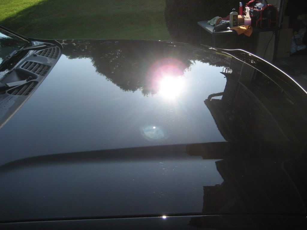

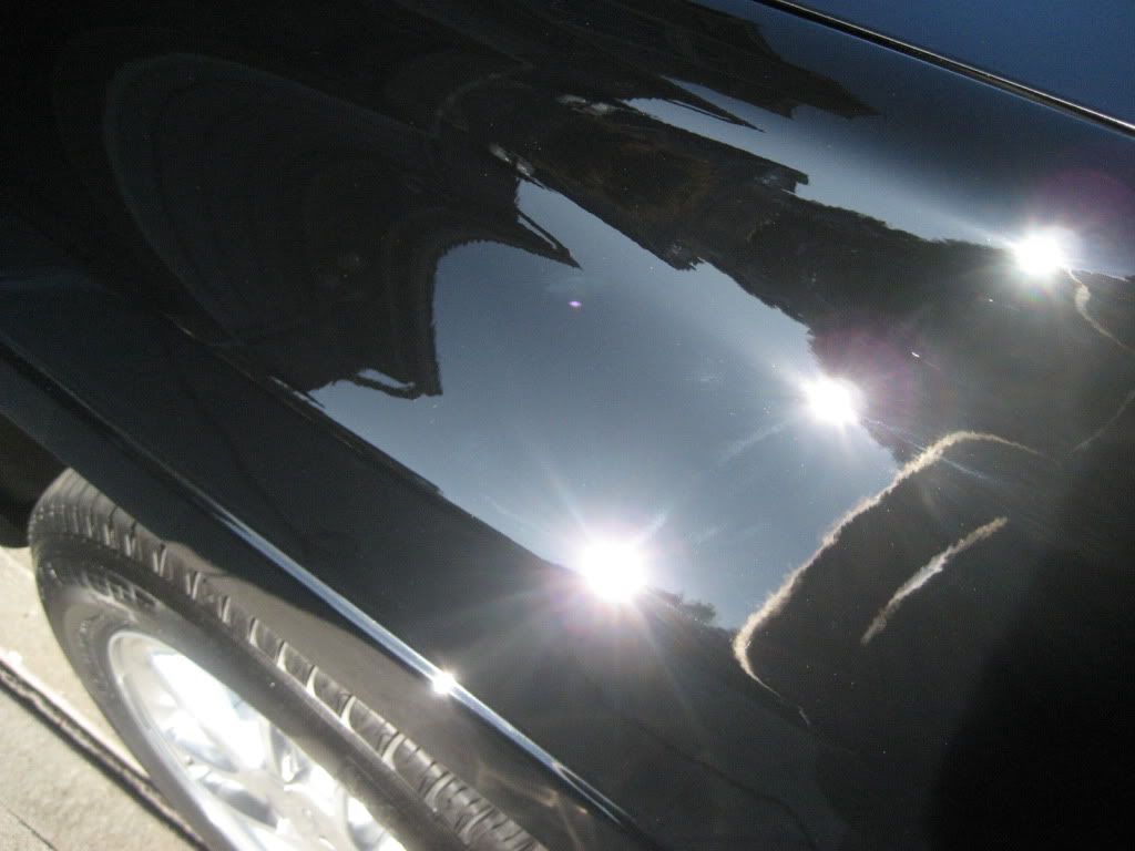

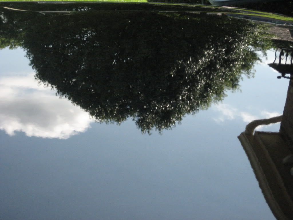

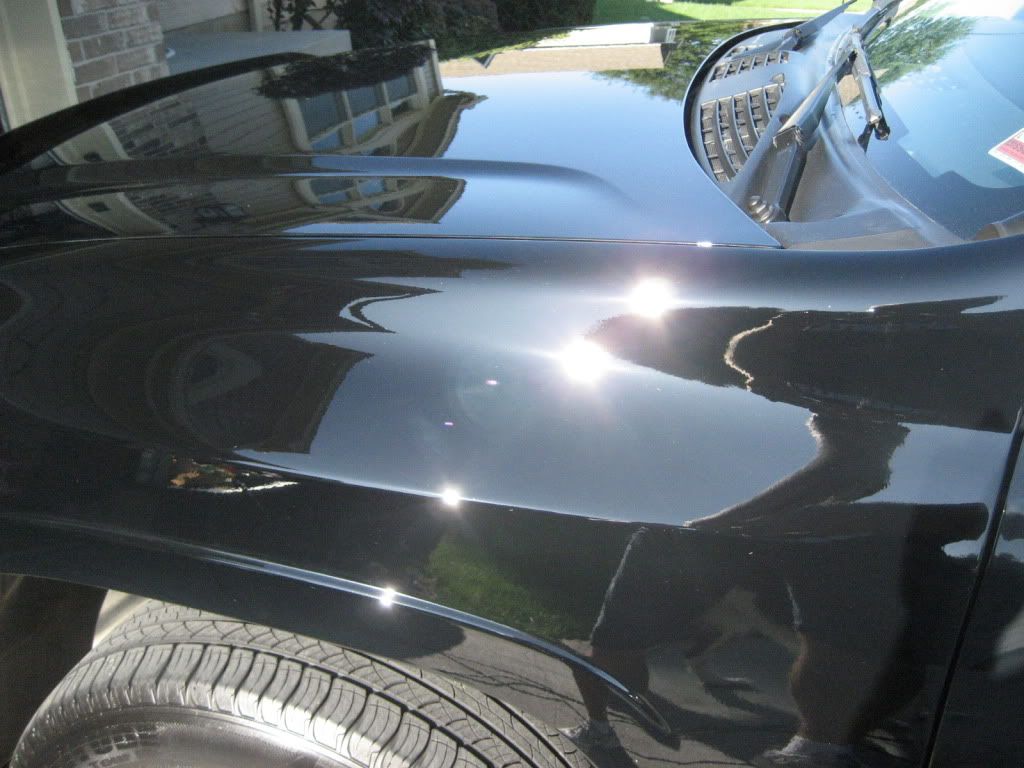

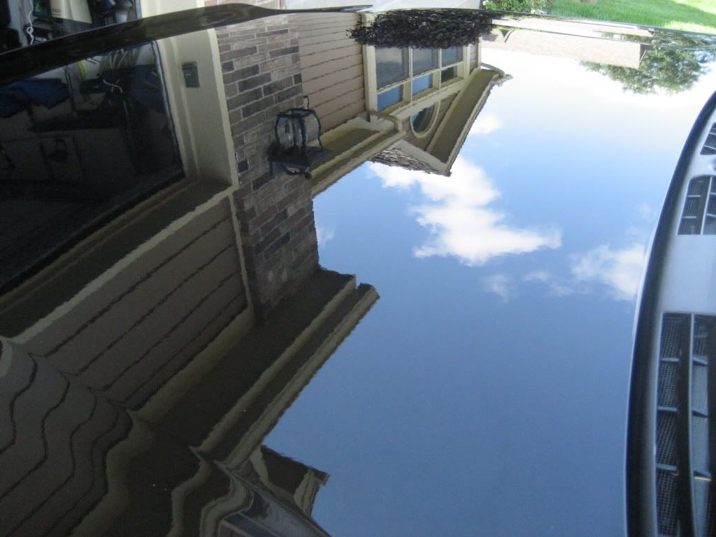

AFTERS:
Awesome job Bill :thumbup:
That was one heck of a one step, looks like M205 has some pretty decent corrective ability on its own, not too bad for a finishing polish :smile:
Fabulous 50/50s and sun shots.

I've heard that M205 works great on "light" swirls, so I thought I'd give it a shot on "heavy" swirls! I was pleasantly suprised!

I was using a LC Orange CCS pad. I was outside, but I started when the sun came up. It was only 62 degrees and the total job took 4 hours, so I was finished before 11:00. Still only 72 degrees when I finished.
On hot days I'll work in the garage, but it was so nice and cool, I couldn't resist being outside.
I would say I worked each panel (1/2 the hood for example) for about 7-8 minutes.
I think the key to getting a very shiny, non-hazy finish with the orange pad is greatly reducing pressure at the end of the polishing. The first 5 minutes are heavy pressure. Then I usually spritz the pad with one shot of water, then very light pressure in figure-8 pattern rapidly for about 2-3 minutes.
Wow that is a heck of a 1 step. Nice job. GM's clear coat is usually pretty hard. I have been fighting the 105/205 combo because I want to use up some of the other products that I have. I am getting closer to giving in to temptation when I see results like that.
You are correct, GM clear is very hard, but, even though this vehicle was a "Swirl-Fest", the swirls weren't very deep. So fairly easy to correct. (Once again, heavy pressure)
