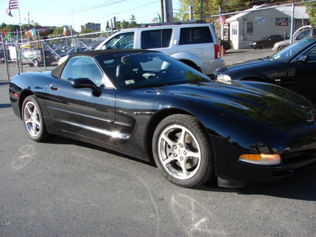

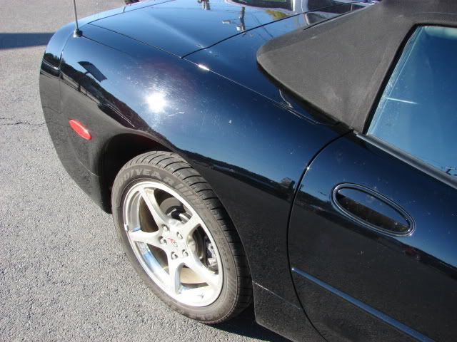

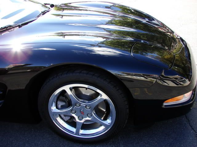

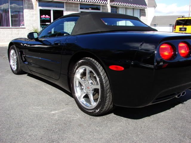

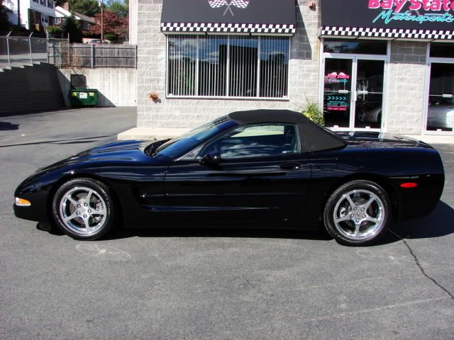

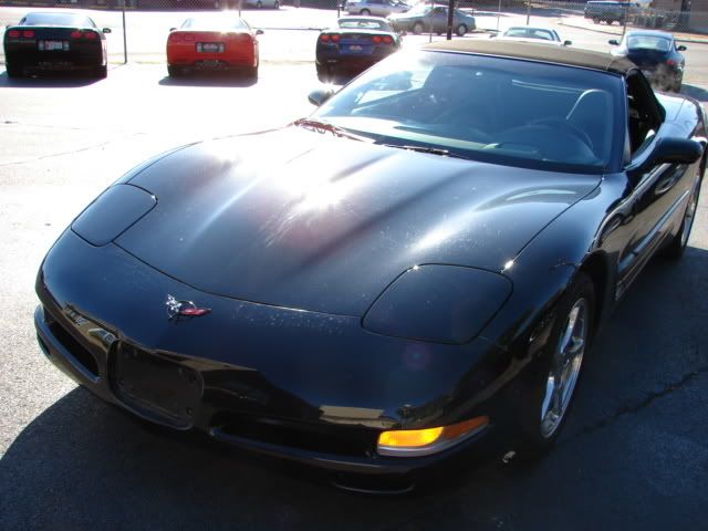

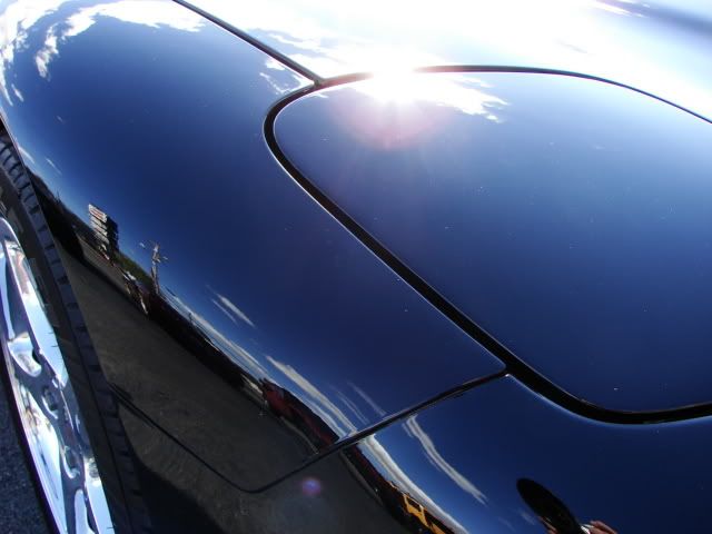

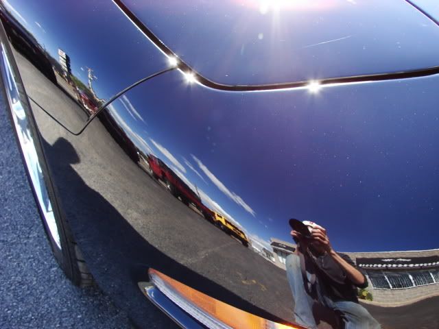

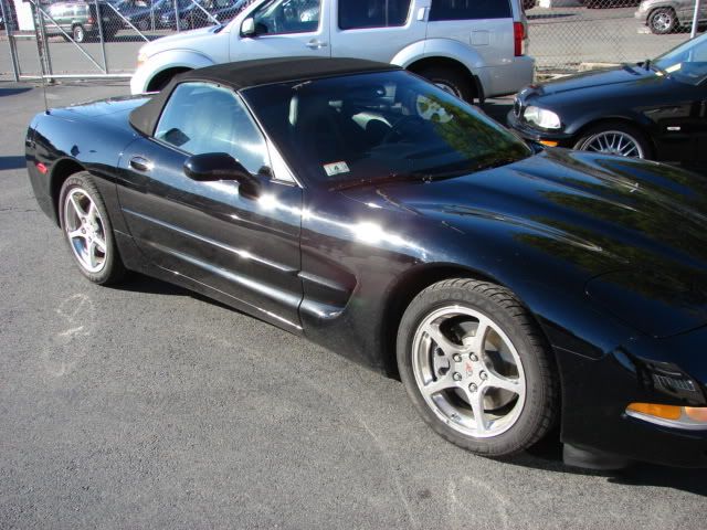

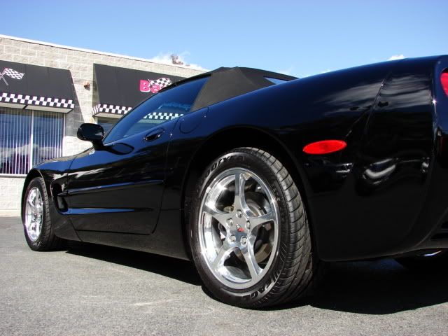

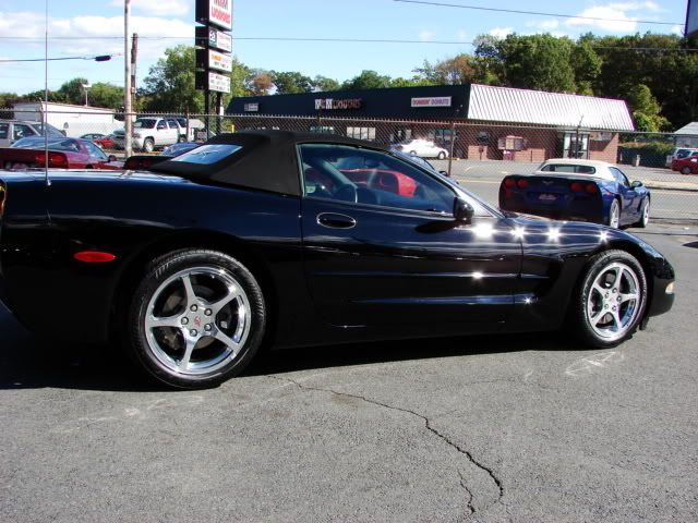

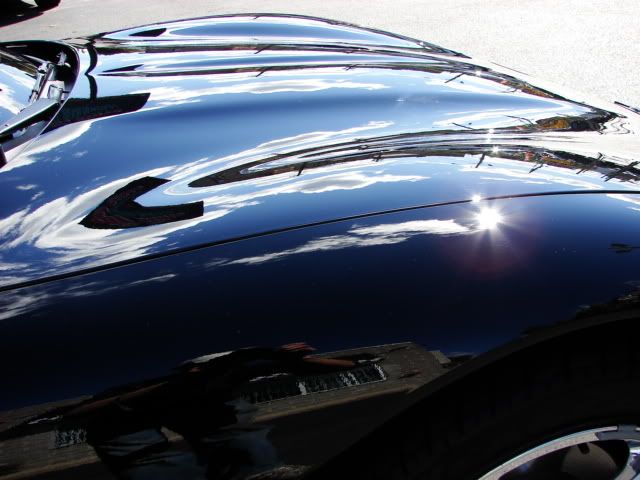

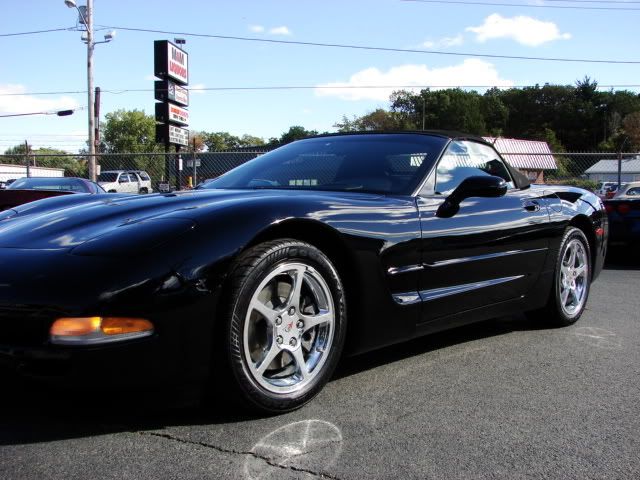

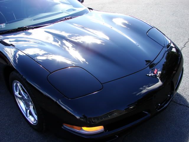

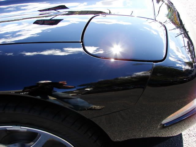

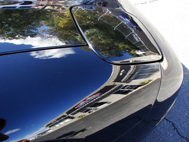

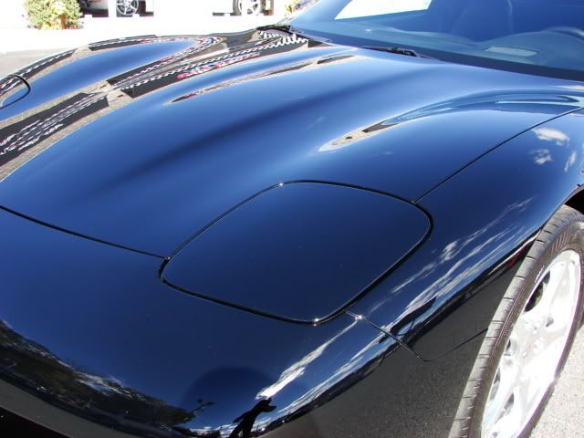

Here is a Corvette that I detailed for the dealership I do work for. It is a 2001 with only 8,500 miles on it. The previous owner obviously did not take vey good care of it. It appeared that it was never washed, waxed or oven vacuumed its entire life. The car was bought for the owner of the dealerships friend, so it really needed to come out good.
I will let the pictures do the talking as to the condition of the car. There were some really deep scratches on the hood and the front right front fender which required wetsanding to fully remove them.
My Process:
Washed, cleaned wheels tires and engine compartment
Clayed with purple Kar Kraft clay bar (agressive)
Rewashed
Wetsanded deep scratches with 2000 grit
Compounded wetsanded areas and other major scratches with PG using a yellow Edge wool pad @1800 rpm X 2 or 3
Buffed complete exterior with SIP using a blue Edge wool pad @ 1500 rpm
Buffed complete exterior with 106ff using a foam finishing pad starting @1400 rpm going down to 1200 rpm
Hand application of Zaino AIO to complete exterior (Glass and wheels also received ZAIO)
Hand application of Souveran
Super Blue dressing on tires and wheel wells
Here are the before pictures...
All in all it came out pretty good for the amount of time I was allowed to work on it. I was told to do the job without breaking their wallet, so not quite 100%, but a big improvement from before.

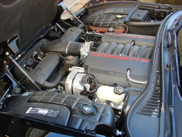

Forgot to add befores of the engine bay and interior....
