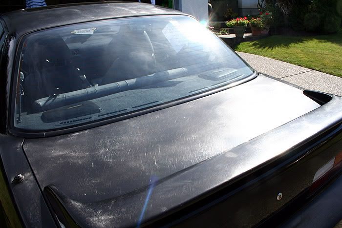

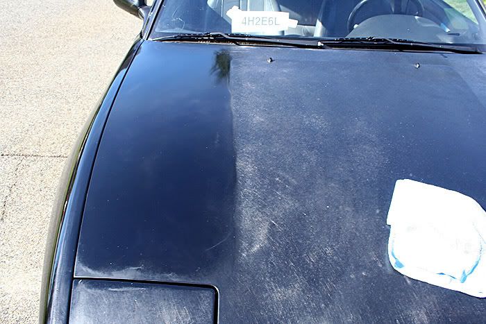

I'm amazed how neglected this car was. Apparently it was never washed in its 15 year life, and it came from Ontario :eek: Right when I saw it, I almost died. Hood, roof, trunk and spoiler were covered in extreme oxidation, but throughout that, it looked like someone had taken a metal brush, and ran it along those panels about 500 times. You'll see what I'm talking about in the pics. I tried everything on it. Even straight Hi Temp Extreme Cut on a cutting pad did nothing. Removed most of the oxidation, but heavy swirling still remained, even after 3 more passes!

Trunk shot
One pass of HT-EC via rotary on a cutting pad, looks better eh...?

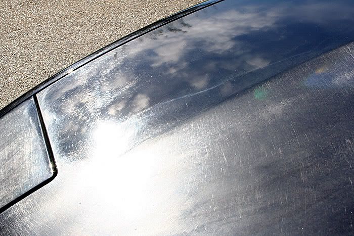

Not so fast, check out what still lies under that! :(
Some more progress (No the swirling is still there, afternoon sun kinda makes it look better than it is)

Wow. That thing is destroyed...I woulda guessed the hood and roof would of succumed to cc failer by now...or at least the start of.
my vote is that the owner used a broom/push brush to remove snow for years. add a little more swirling onto that paint and it could become a new style for auto finishes! hehehe
