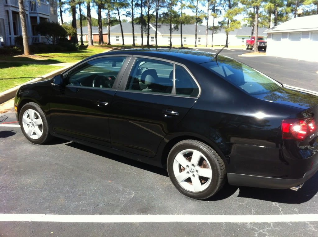

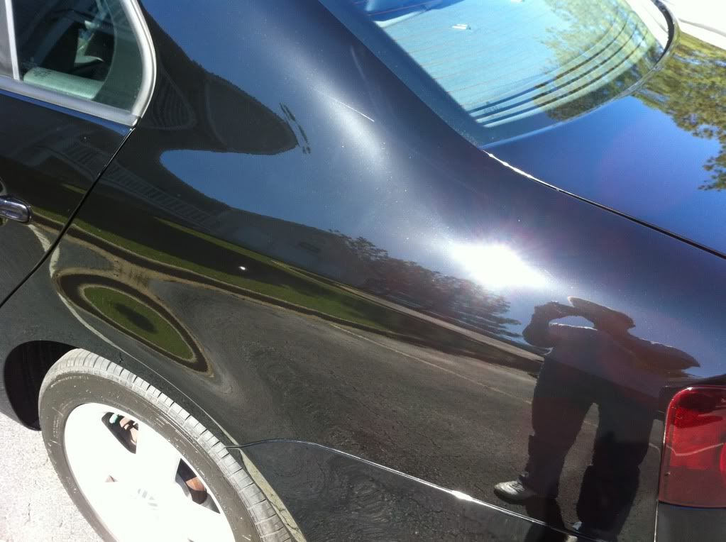

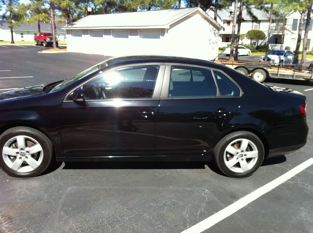

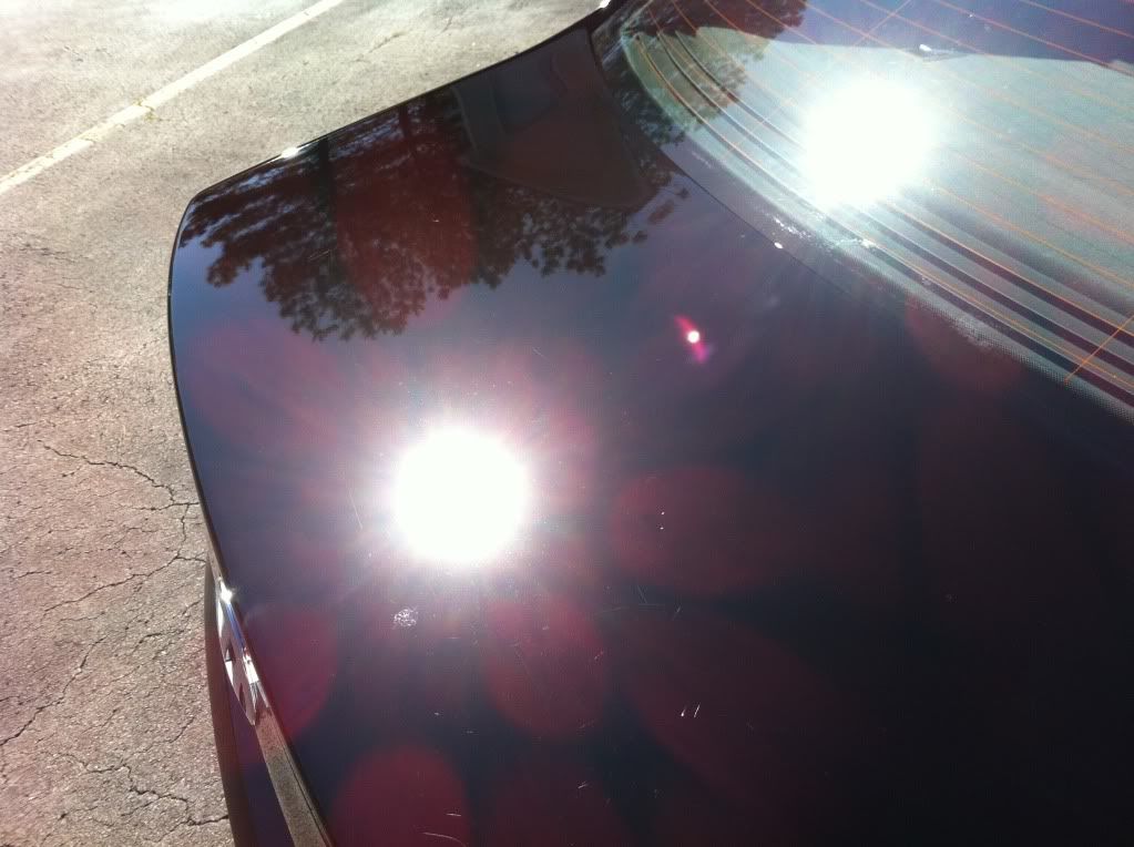

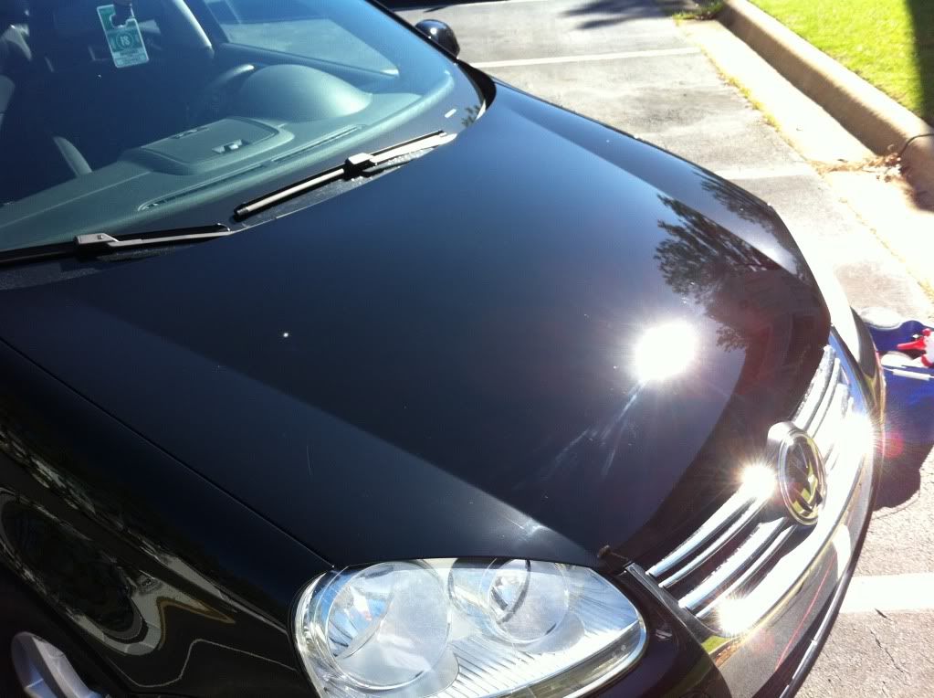

Ahhhh!!! So I'm so excited to share my results :) I can say that my outcome FAR EXCEEDED my expectations.
to GeeReg - I know you already bought all your stuff, but I can say that if you're not having success, these products worked exceptionally well for me....completely transformed my car, and I have no experience.
I saw something from 3D somewhere, that said you can apply poxy over the remaining residue without issue. So, I took a leap of faith and did the whole car. Here was my process (after wash & clay obviously)
1. HD Uno on 3D Green pad. I spread the product over the section using speed 1 first, then I bumped up to speed 5 and applied some pressure. With pressure I did one horizontal, one vertical, one horizontal, one vertical. Then I took the pressure off and lightly did one horizontal and one vertical.
2. On the plastic bumper, I needed to apply Uno on the Red finishing pad. I used the same process above, but with speed 3.
2. Wiped residue off with GG Pre-Wax cleaner. You don't see the remaining residue until you pull the car into direct sun.
3. Carefully washed the car. :)
4. applied poxy, speed 4 with 3D Red pad, quickly in one direction with multiple passes and no pressure.
5. Tada!!!
Thanks for all the help!!!! I'm so happy with the results! :)
