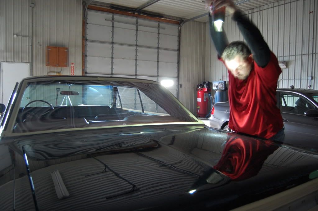

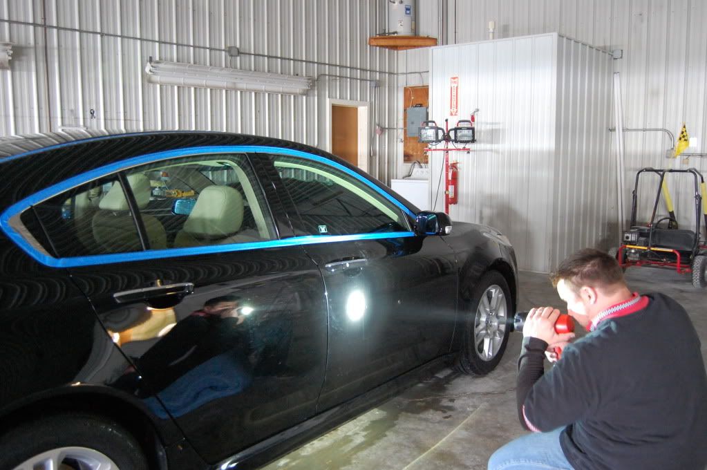

This thing blows my old sun gun away! I love it. Here are a fw shots of it in action. Keep in mind. The sun gun is designed for color matching. I got tired of how fast the battery would dye on it. It would also get hot and have to cool down. It a waste of money. I tried them Brinkmans and they don't see threw the oils in certain products. This thing rocks. Battry last forever. Its rechargable and lightweight. I love it.
Walmart.com: Black and Decker Rechargeable Spotlight: Camping
Here you can see the power when I was using it on this 2010 Acura TL

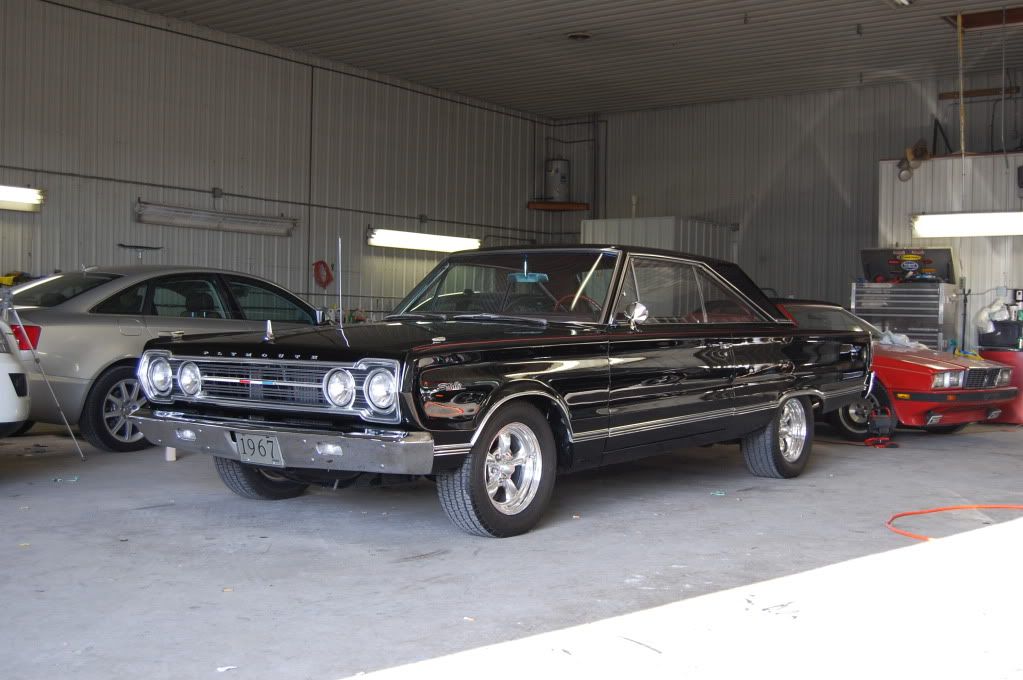

Here it is on a 1967 Plymoth Satilte Matching Numbers! Nice ride here.
Thing came out great with two coats of Migliore Presidenziale on it.
I highly recomend this light to anyone. I use it everyday and its going strong so far for about 2 months.
