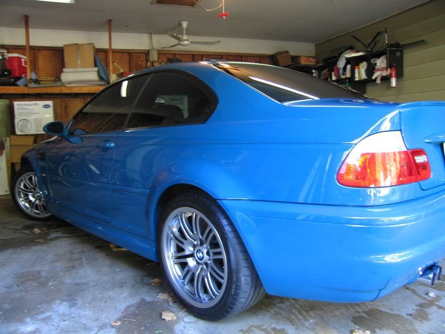

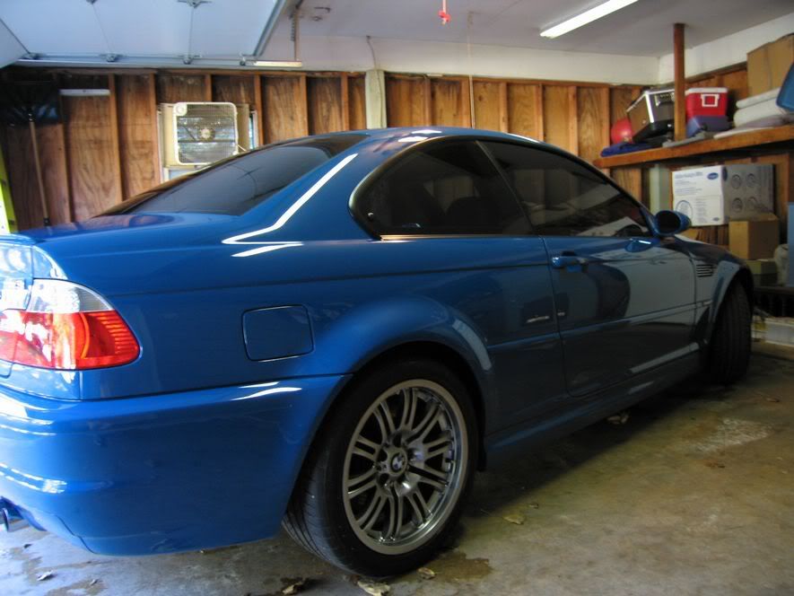

Unfortunately it rained on & off so all after pictures are inside the garage.
FK1 wash
dp clay - didn't really needed it
ssr2.5/pc on vertical panels & green propel pad
ssr2.5/rotary on hood.roof/trunk/1500rpm/lc orange pad
FK1 wash
pwc on hood/trunk/roof
FK1 #2180 sealant.
FK1 tire shine
FK1 #415 on wheels/exhaust
Lighting was terrible so God knows what I did on the rotary.

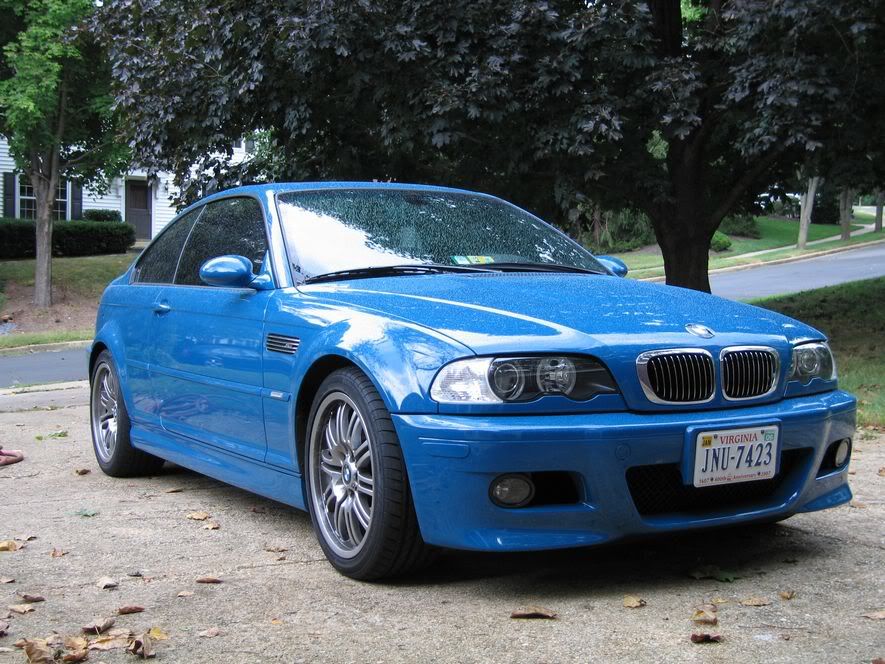

before
after

not trying tobash, but based on the lighting condition in the garage and being in the garage, it is very difficult/near impossible to tell if there are any rotary swirls.

Thanks guys - Normally I wouldn't post a "garage" picture but since it was an M3.....
