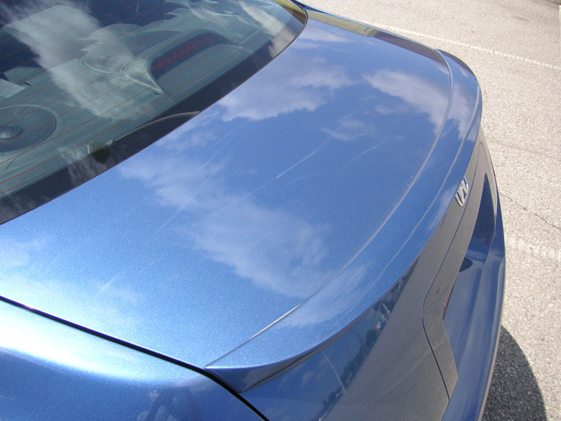

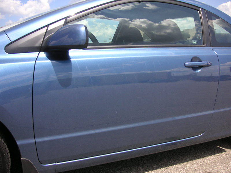

2006 Civic Coupe. The dealership "prepped" it really well! The owner was understandably skeptical of detailers in general. I think I sent him off feeling good. :)
Wash, clay
FPII/white via PC

The Civic is also nice, looks like a different color now, even though the befores were probably also a bit washed out from the sun.

Those befores are ones the owner sent me when he contacted me; not sure what kind of camera he uses but that might explain the color difference.
