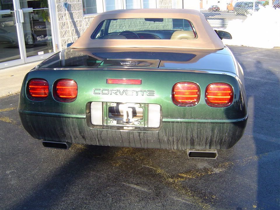

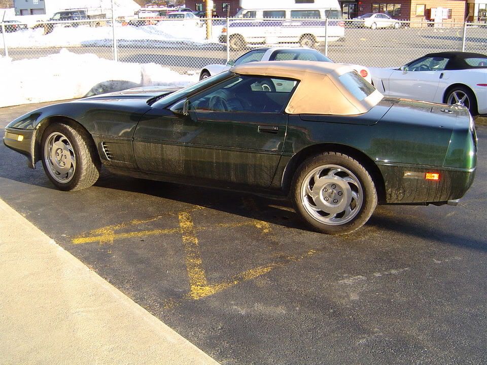

This car just came in last week in need of a good detail. It has almost 59K miles on it and is actually in pretty good shape for the miles. As you can see from the before pics, the paint needed some serious attention. This car was definitely taken care of, but I think the previous owner just washed it because there was no traces of leftover wax in any of the nooks & crannies. The paint was spider webbed and lacked any gloss/ shine. There were a few scratches on the lower rockers and some stone chips on the hood.

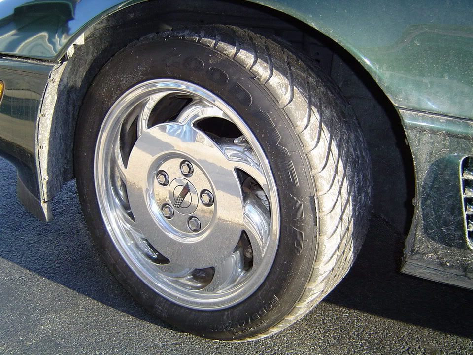

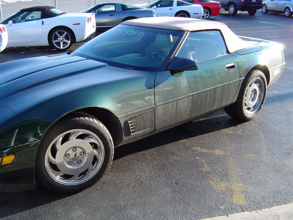

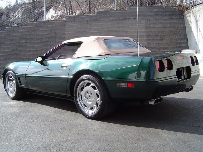

Here are a few before pictures:

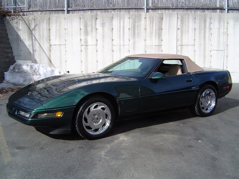

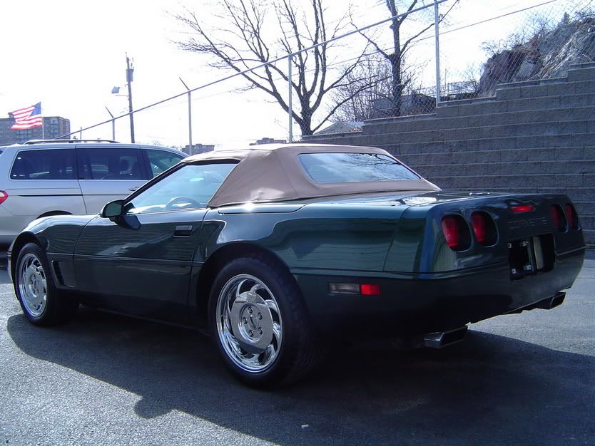

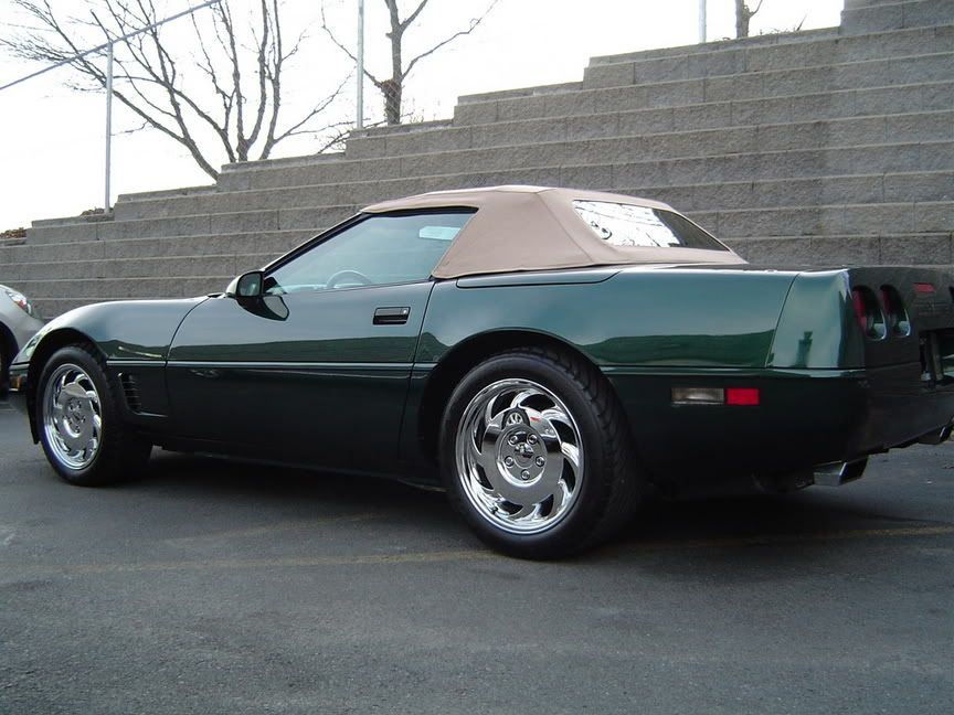

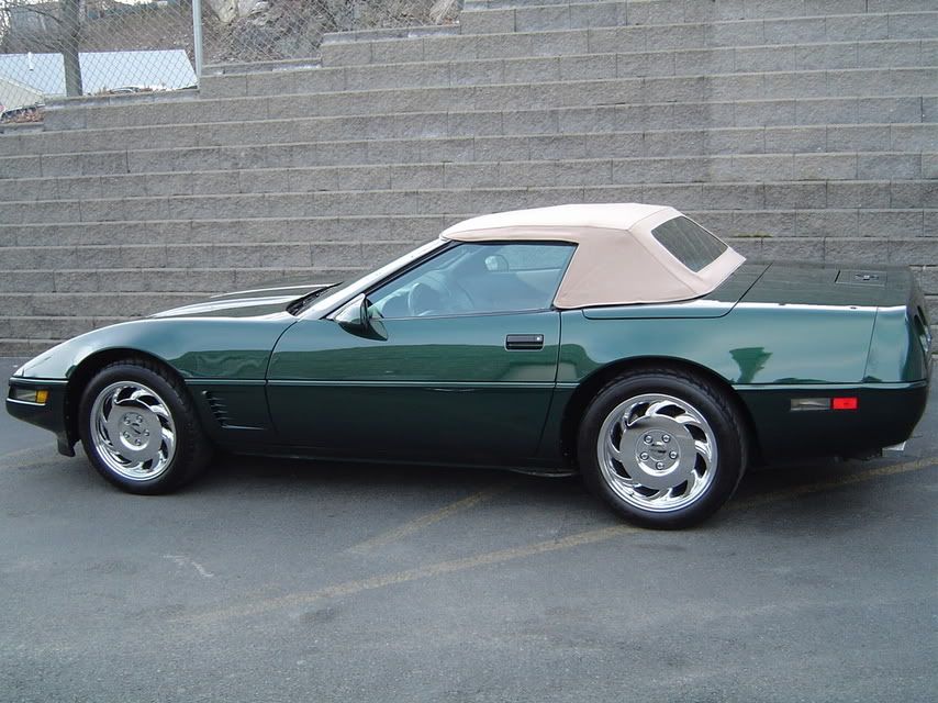

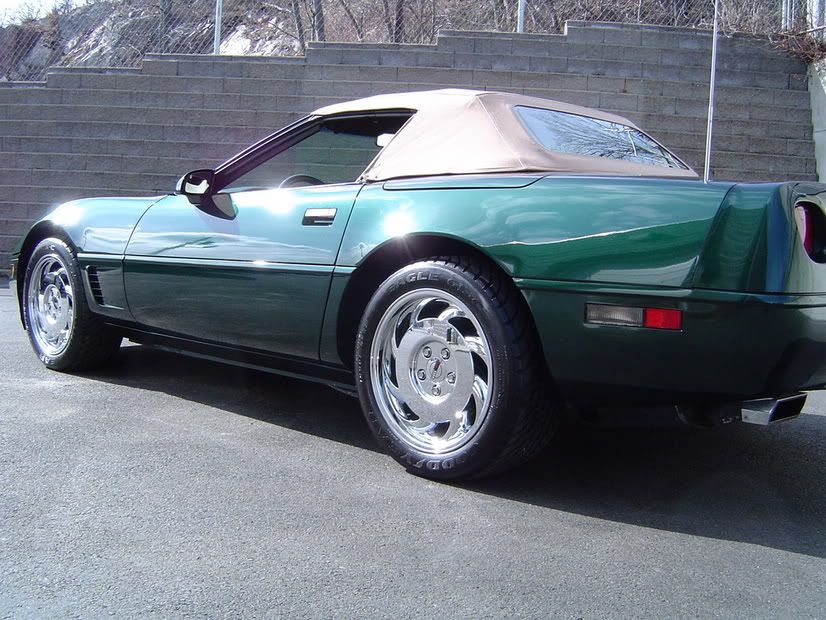

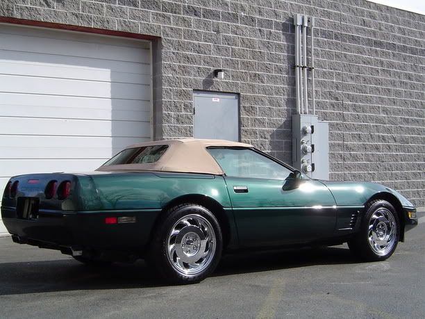

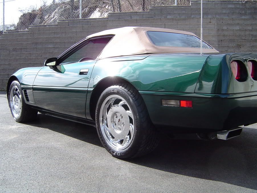

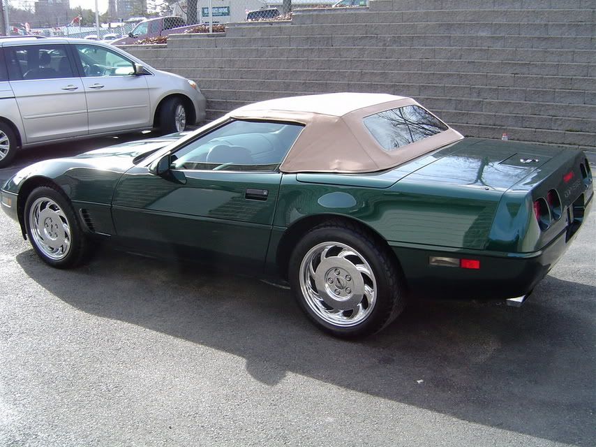

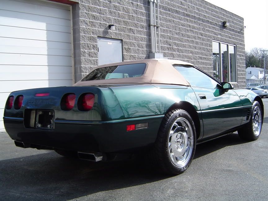

Here are the afters:
