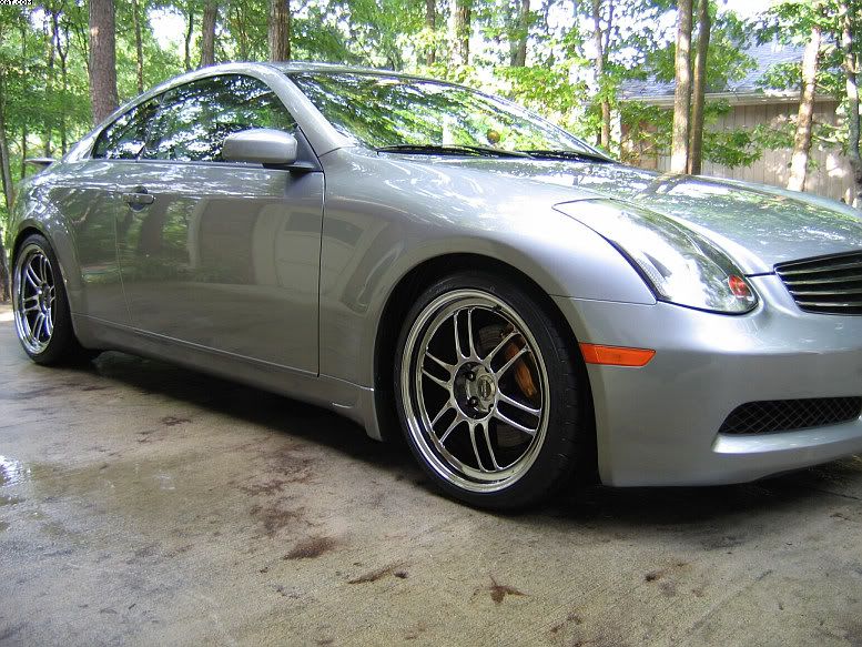

The car is an '04 coupe with about 22K on the odo. It has been lowered and fitted with 19" Enkei rims shod with Nitto rubber. At the moment those are the only two mods. It is a daily driver and had not been waxed or polished to any degree since it was purchased. Below are some pics and a description of the detail. Please pardon the poor lighting and rain drops in a few of the pics as I was battling scattered t-storms all day.
Enjoy,
Mike
The detail...
Wash with Meg's NXT shampoo
Clay with Clay Magic clay bar using Meg's #34 as a lube. Even though the paint felt smooth after washing the clay pulled off a significant amount of nastiness.
Polish with Meg's #80 using a Meg's 8006 pad and my PC set at 5-6.
Glaze / Polish with Meg's #81 using a Meg's 8006 pad and my PC set at 5.
Seal with Meg's #21 using a Meg's 9006 pad and my PC set at 4. I let the #21 set on the paint for approximately 45 minutes before removal.
Rims are sealed with #20, exterior glass has been VM'd and the tires are dressed with two coats of Z-16.
