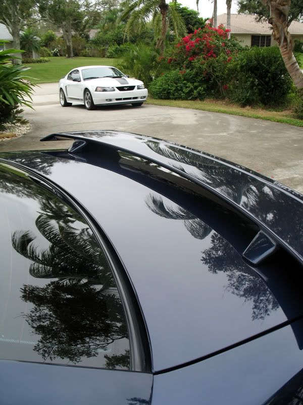

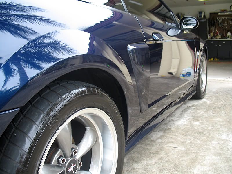

First up was my brother's 03 GT, He came up from college for the weekend (He goes to the University of Miami, hopefully I'll get accepted and will also be going there!), So I decided to clean up his car for him and give his car a fresh coat...process was as follows
Exterior
-Wash with NXT
-Spot clay with Pinnacle Poly Ultra Clay
-Poli Seal via White pad, PC 4/5 x2
Quick thoughts on poliseal...For short, its an awesome product, it goes on incredibly smooth/easy, and comes off the same, adds depth and gloss immediately and seems to have great durability for an all in one product, I love the scent, love the ease of application and absolutely love the looks it provides!!!
-Wheels cleaned with Meguiars All Wheel Cleaner
-Black Magic Tire Shine Gel (awesome product, smells great, looks awesome, goes on pretty easy and sling seems to be minimal)
-Poorboys Trim Restorer to exterior trim
-Rain X to all glass
Interior
-Vacuum
-Carpets Shampooed with Tide
-Poorboys Trim Restorer to door panels/dash
-Leather Conditioned with Pinnacles Leather Conditioner
-NXT Glass Cleaner to inside windows
Engine:
-Degreased with Simple Green Diluted 10:1
-Scrubbed with misc brushes/mitts
-Pressure Cleaned
-Dressed with Turtle Wax Tire Foam (closed the hood and let it bake on)
-Wiped down with Poorboys Trim Restorer
