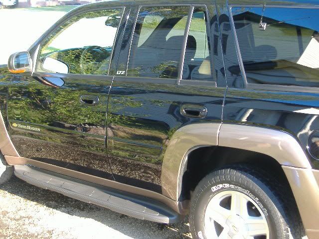

Great work! I have been messing with a bit of wetsanding as of late. Good to know that the PITA GM clear takes some real work/cut to remove the OP.
youre not kiddin gm, i can't believe they are even allowed to release cars that rough. there should be some sort of code they have to follow.
You should see the new black Z06s. :shocked One guy had wetsanded his new black Z06 as he had done it in the past on many cars. Its the way they should come from the factory.
Made a huge difference! :goodjob

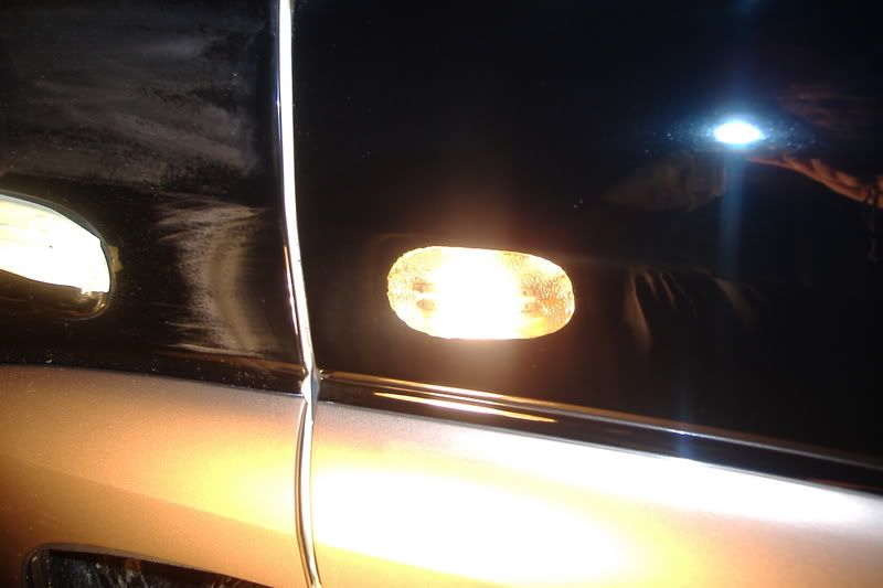

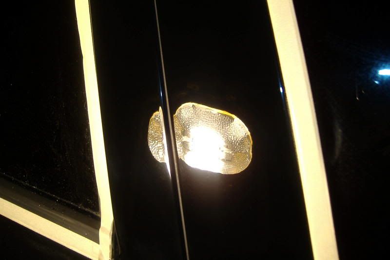

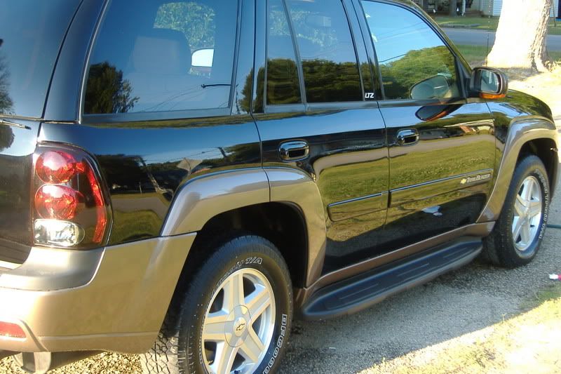

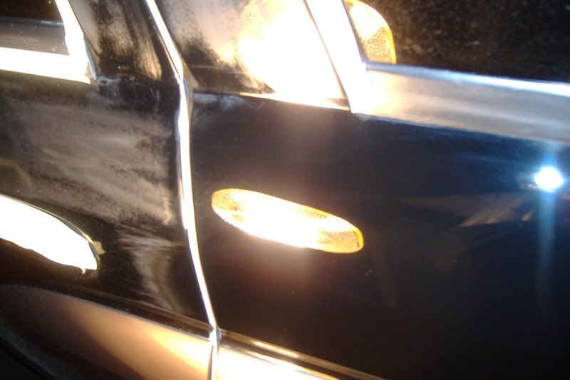

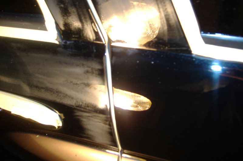

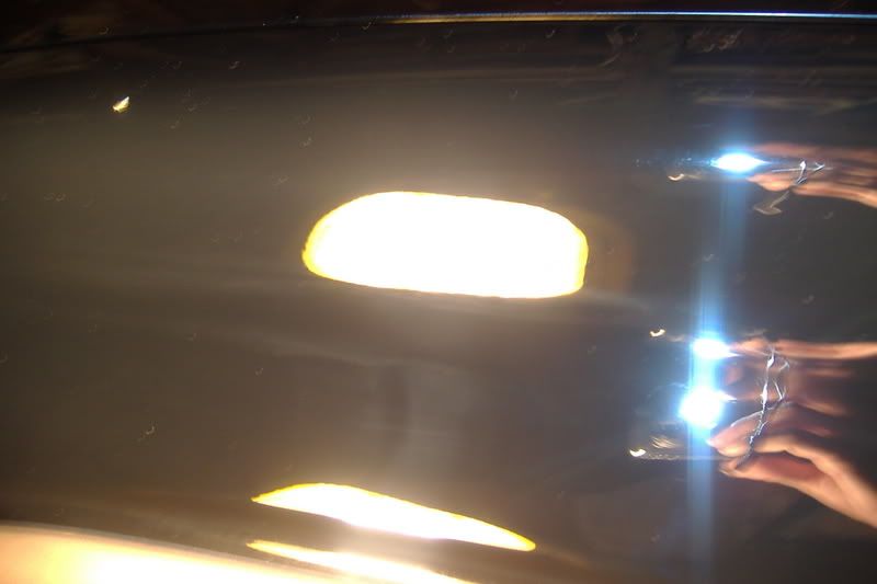

quick update w a lot of pics. the sanding marks are decieving on these pics as they were still a little wet with #34 so they arent uniform looking in pics. i decided to sand the pillars with 2k and compound with pc and orange spot pad. rear panel was 15 2k 25 3k then pollished with pc 4 inch orange spot pad ohc
I think im done messing with this thing for a long time now. the driver side got poliseal ajt topped with nr. the passenger side will most likely get the same in a month or two.
