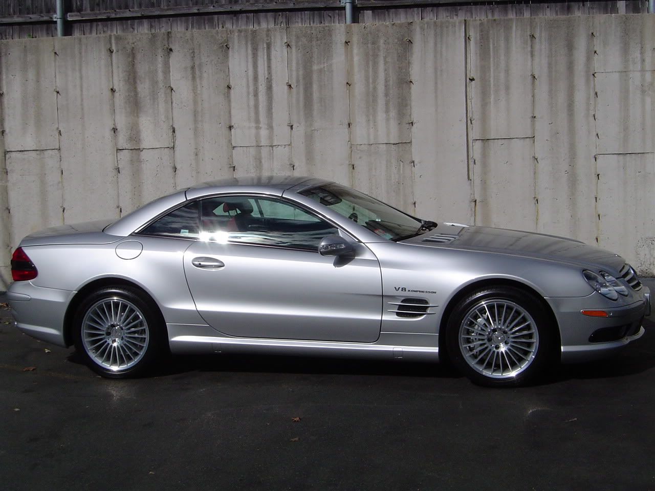

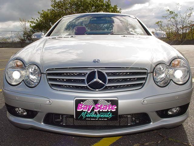

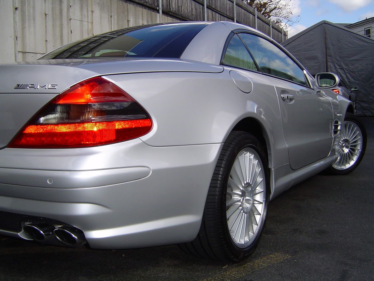

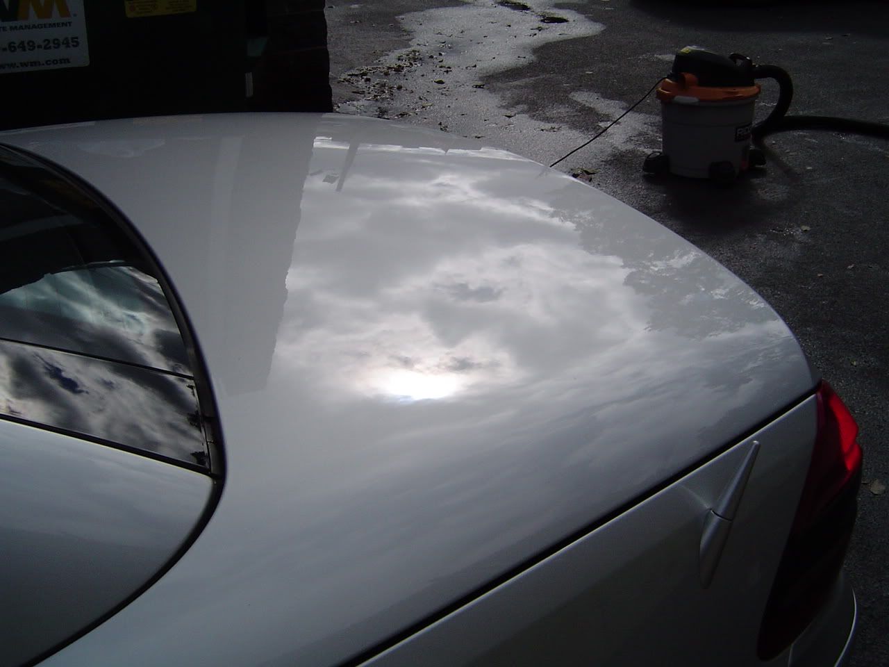

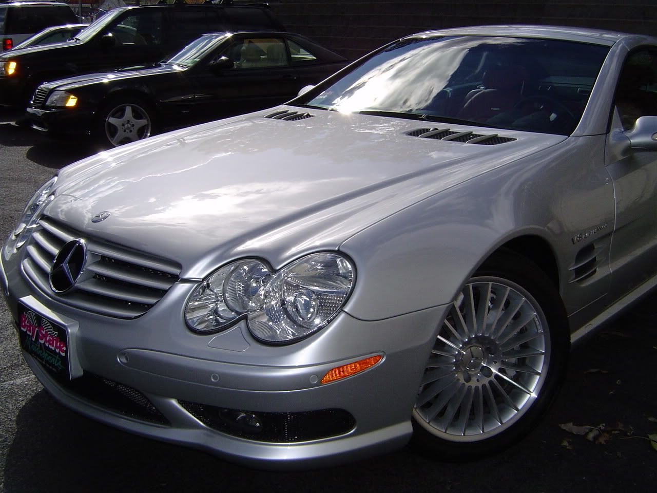

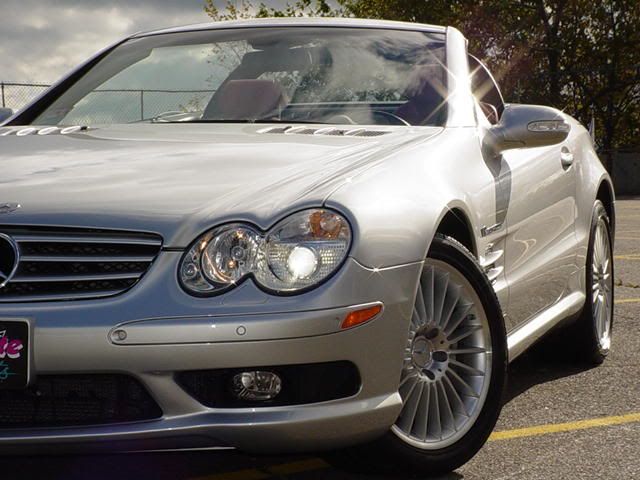

This is probably one of my favoite cars ever. It rides like a luxury car, but when you stomp on the gas :spot watch out!!!! This car has a few horsies short of 500 horsepower, so you can imagine how good it goes.

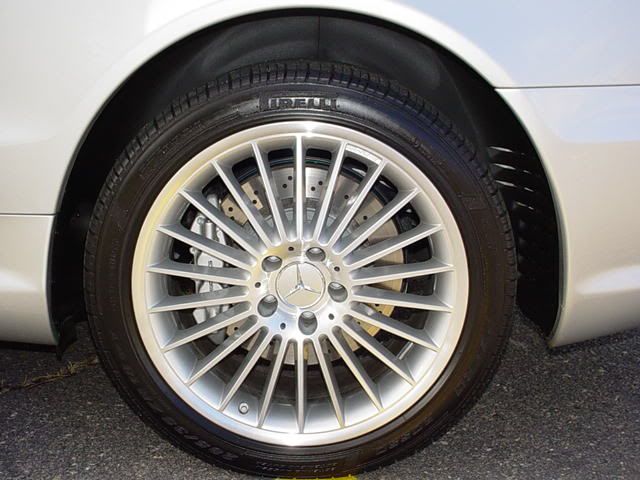

Well anyways, the car was filthy when it was traded in and needed a good recon to make it look handsome again. I thought I was in for a nice easy detail, but after I washed it I noticed that there was a lot of scratches on just about every panel. Most of them buffed out pretty easily accept for a couple that needed compounding. The wheels in particular were extremely dirty and a major PITA to clean and get behind the spokes clean, so I ended up removing all the wheels and detailing them off the car.
Here is my total process:

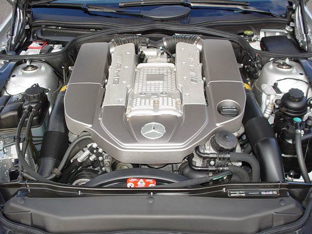

Washed exterior, cleaned engine compartment, removed and cleaned wheels
Treated wheels with Michelin Brake dust repellant
Clayed exterior with Kar Kraft clay bar
Spot buffed heavier scratches with Menzerna Powergloss by rotary with cutting pad
Buffed complete exterior with Menzerna Intensive polish using cutting pad
Buffed complete exterior with Menzerna Final Polish II w/ polishing pad
Wiped exterior with water/ alcohol mixture to remove any oils, etc..
2 coats of Z2 pro
Dressed tires with Super Blue Dressing

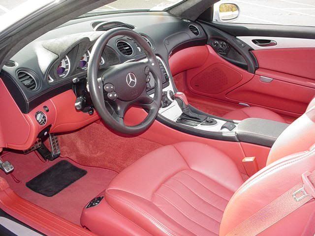

Cleaned interior with Super Kleen general purpose cleaner
Dressed all vinyl with Meguiars Interior Quick Detailer
Conditioned leather with Mercedes Leather Conditioner

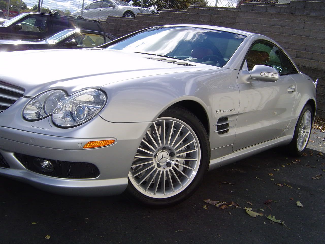

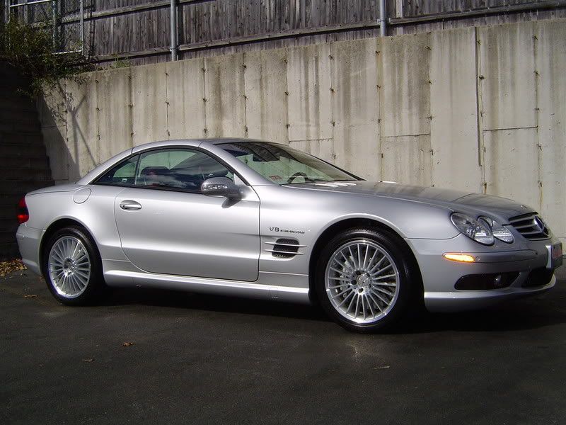

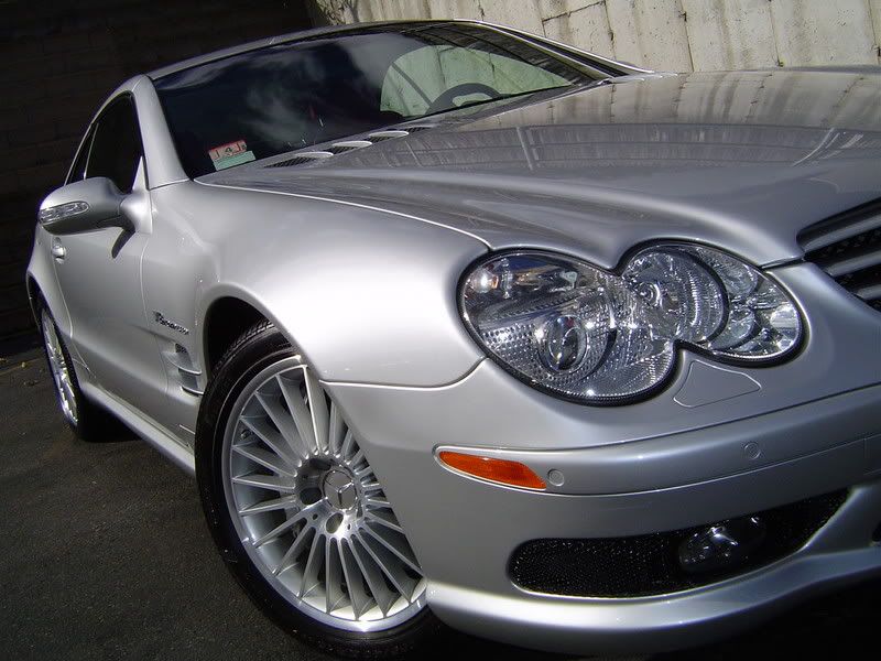

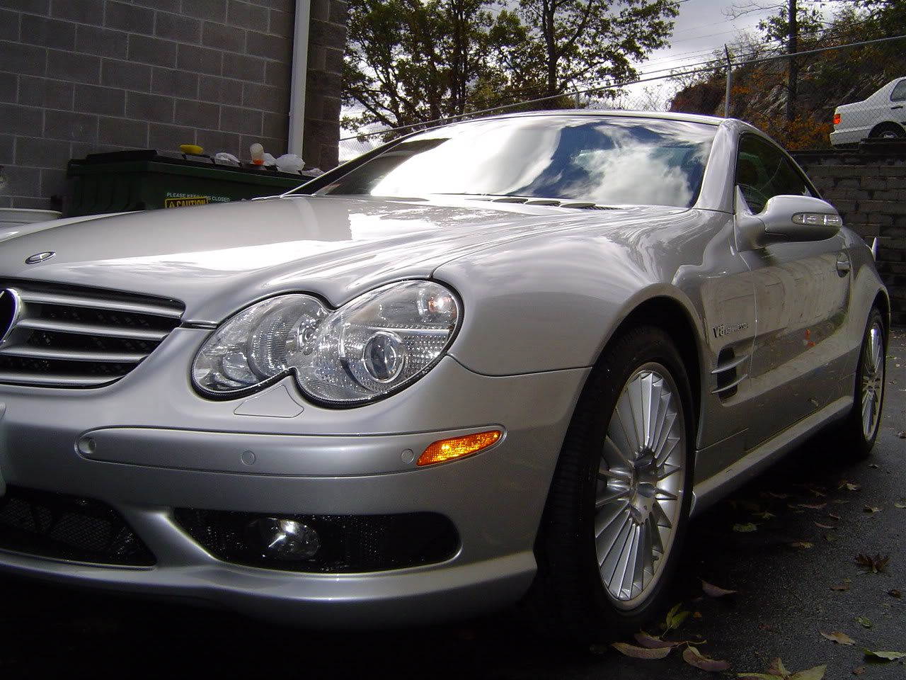

Now to the pictures:
more coming.....
