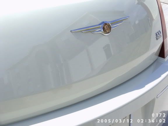

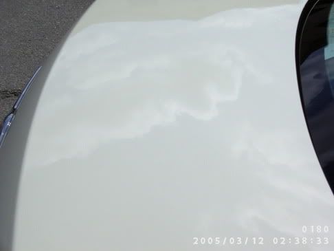

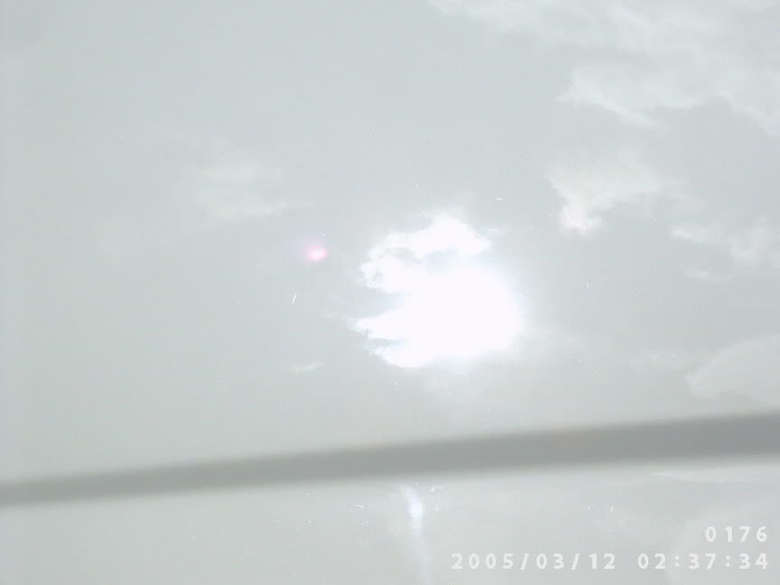

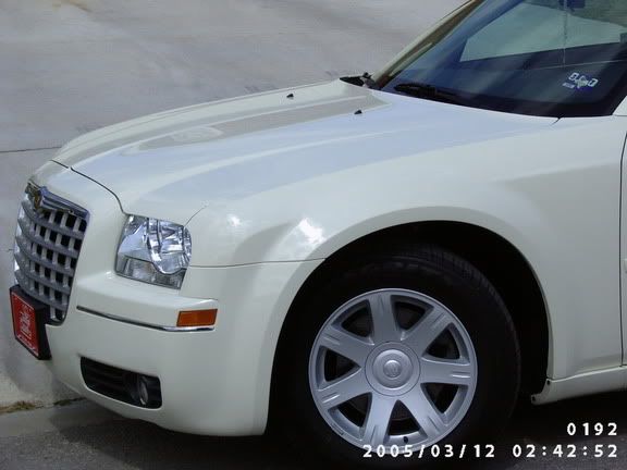

I have fallen in love with the vanilla color that is on the car. Since I have already have posted pictures of the before on another thread there will not be any. To be honest I cannot see a difference in the look of the vehicle using the pictures as a side by side comparison. Yet when you see it in person even the most inexperience eye can see that the color really is more vivid. I hope the pictures show the reflectivity.
I tried very hard to find swirls on the finish before, during and after the detail. I found some small marks that were most likely made during the final wipe down with Z-6.
