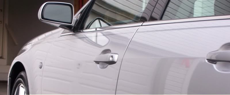

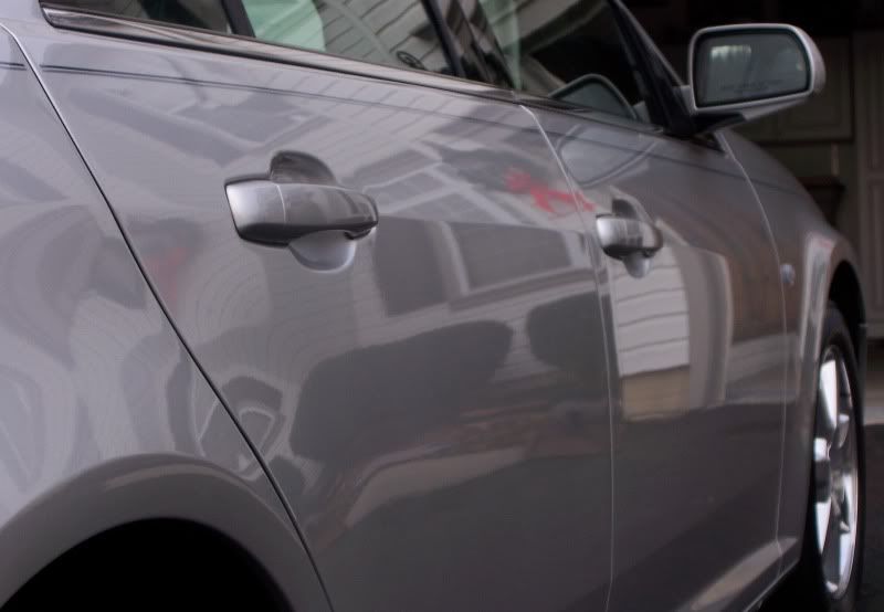

After I finished the Z treatment on my wife's black Tahoe, I was curious to see what it looked like on my silver STS.
Process Used:
Wash: Optimum
Clay: Optimum
Polish: ZPC & LC Polishing Pad using the PC @ 5
Seal: ZFX/Z5 x 2, ZFX/Z2 x 1
Final wipe down using Z8.
Total Time: 3 1/2 hours. I had the heat cranked up to 75 in the garage, which helped the cure time (about 10-15 minutes per coat).
Here are a few after shots:

Thanks. The paint was in pretty good shape, so no need for multiple polishing steps, or it would have taken me a lot longer.

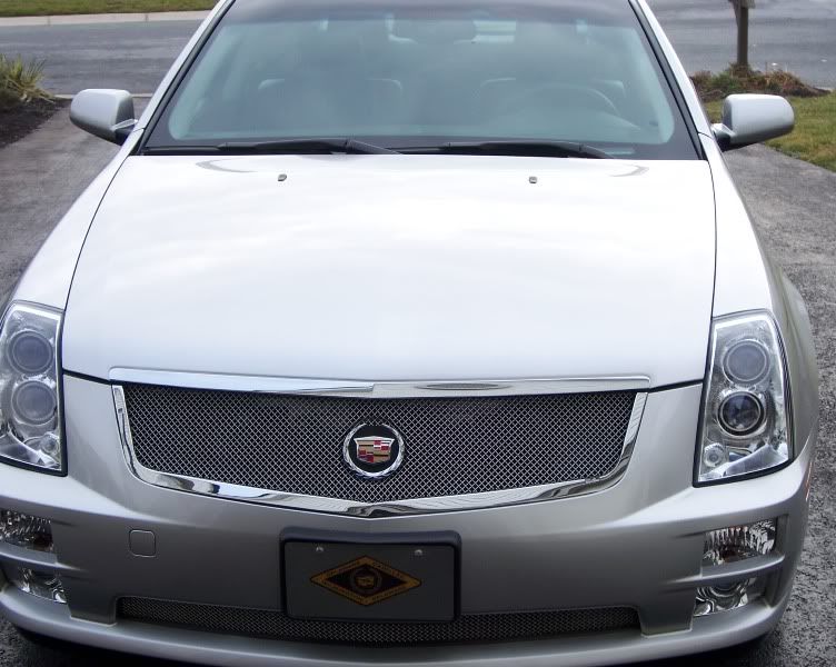

Your caddy looks great! Is that an STS-V or is the metal grill an option or aftermarket piece?
Thanks Mikeyc. I wish it was an STS V! (LOL). It's a dealer installed/after market grill, but I like the look too.
Sean - The sun was in and out. In the sun it looks awesome, but I didn't see the same dramatic difference on silver that I saw on black using Z.
