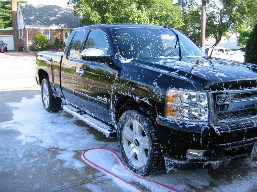

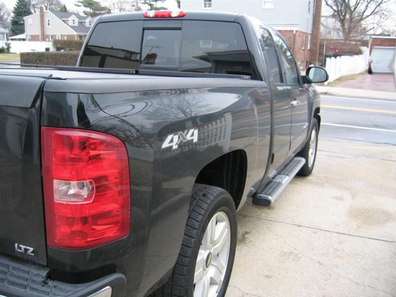

Before Photos:
The procedure is as follows,

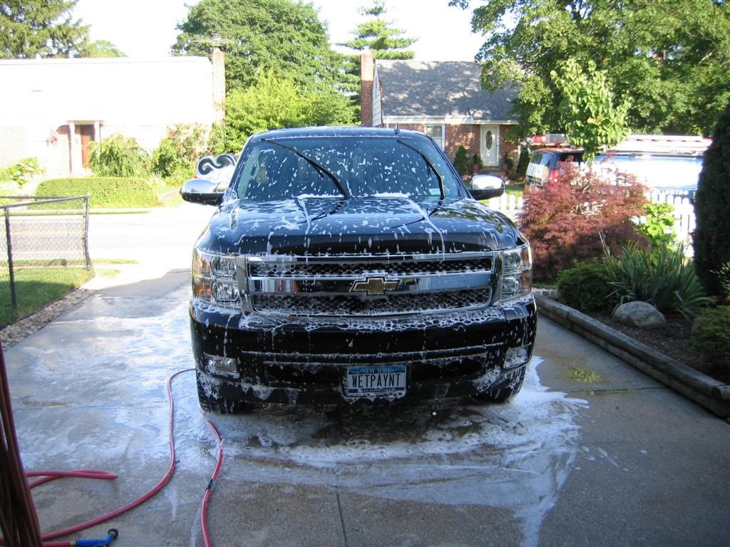

First the vehicle was washed down with Dawn 3 times, why? there was about 60 coats of zaino on it,
then I used 90% Isopropol alcohol pure and rubbed the whole vehicle down.

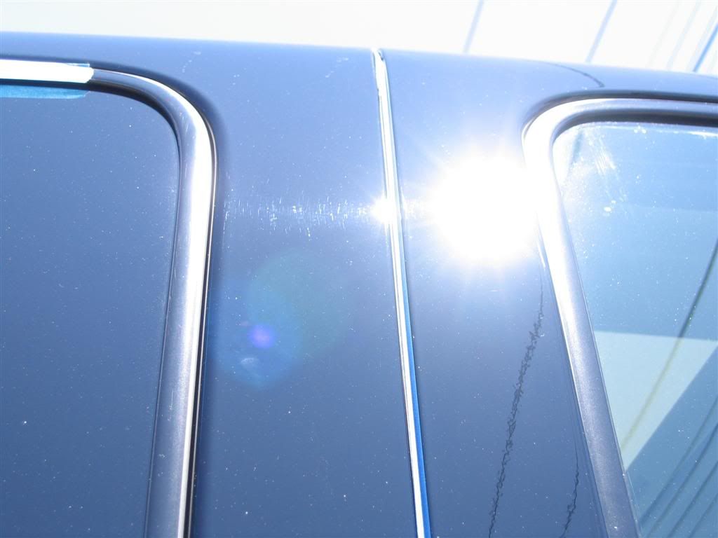

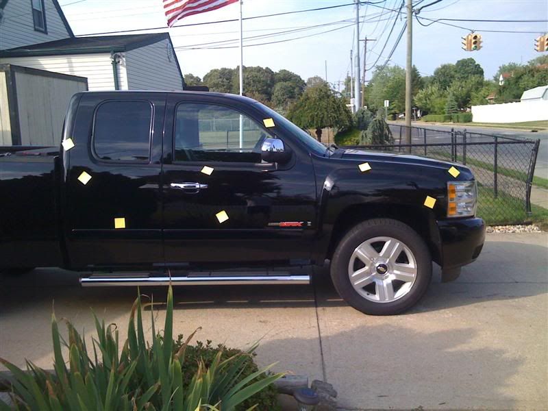

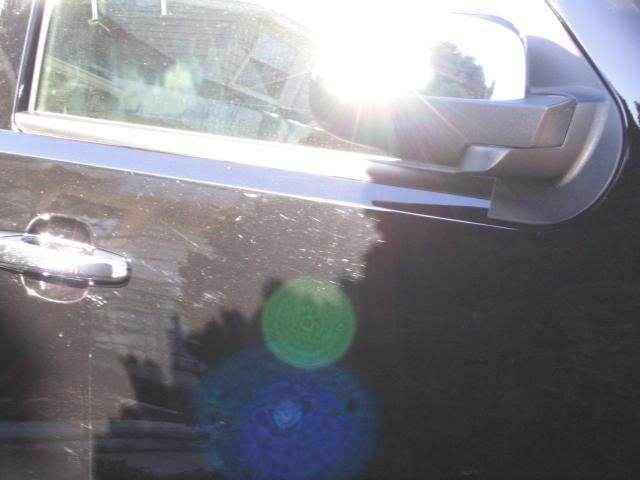

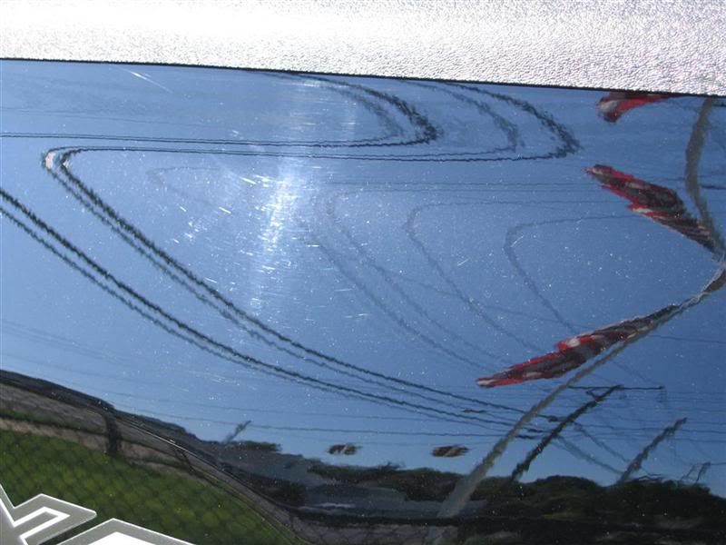

Then I looked around for some swirls, and I think I found some...You Think!
At this point I think I better stop with the Sticky's
You get the Idea, many swirls, many more photos on site.
Next I started Claying (Z18) the vehicle using 2 cap full of Z7 TO 1 Gallon of Water as the Lube.

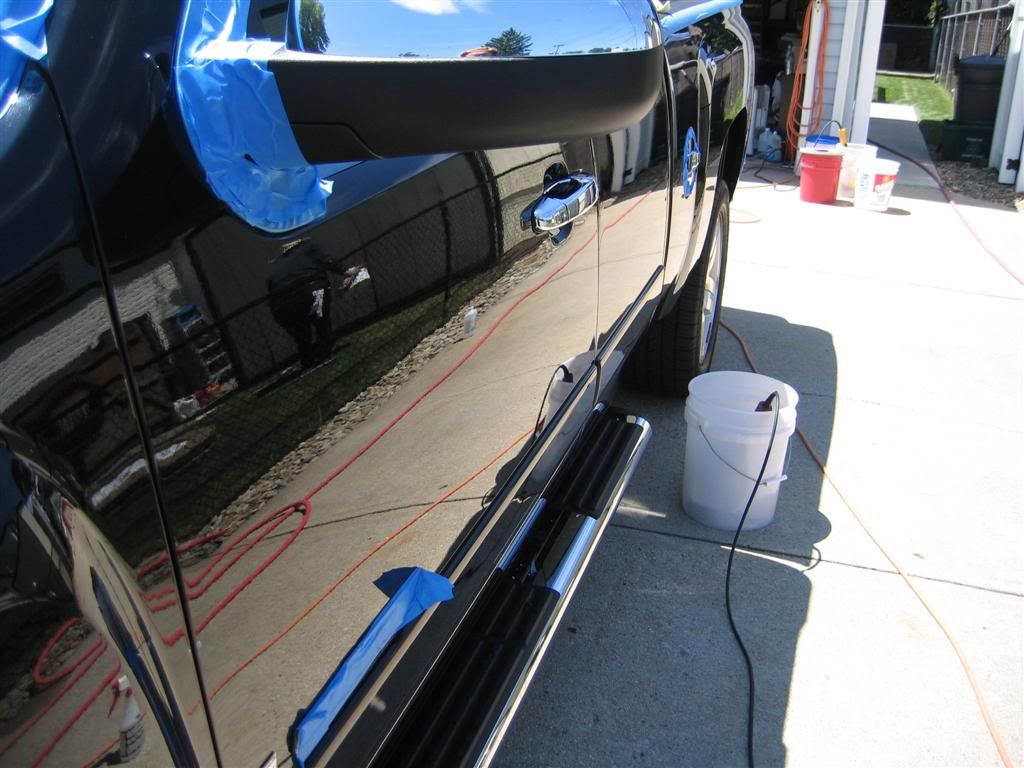

Next I taped all trims, and everything that i did not want the Polishing to touch.

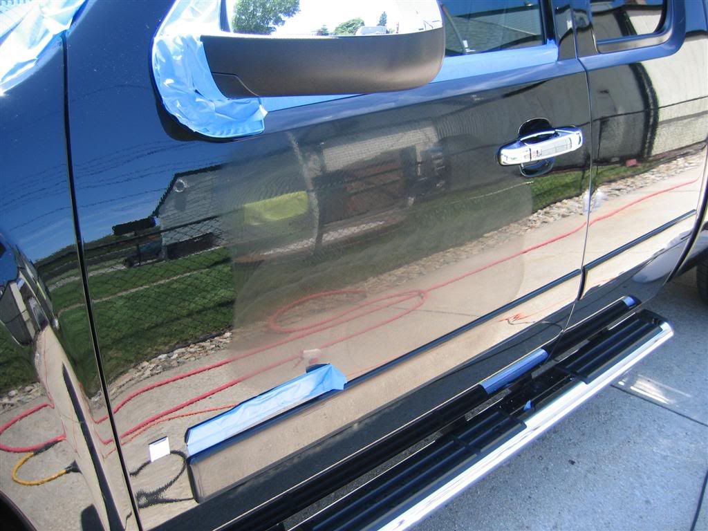

I started out using M205 with a Country Orange 7.5 inch CCS Hi-Gloss Pads and the 6.5 inch versions also.
Each panel got got 1 application and as per instructions on the product, starting with med pressure and ended with light pressure.
The M205 is some good stuff, removed almost all the swirls. Which im happy with. I then removed all the tape off the covered areas, and foamed the vehicle with DP Extreme Foam Shampoo, then rinsed off and washed it down with Z7. Used Big Blue to dry the vehicle.
Re-taped all the trim again.

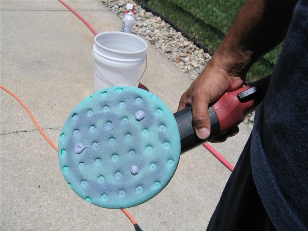

I started out with the green pad and seasoned it (as per Todd (Thanx again Todd)) with Menzerna PO 106 FA.
Afterwards,I only applied 3 pea sized 106fa to the pad and worked it into the vehicle panels Using the Flex 3401 set @3-4, until its transparent.
Then buffed it off with Microfiber towel. Every panel got polished twice, the first time firm passes set @3-4,the second time light passes set @4-5 just incase i missed anything, but the final passes, i finished in the direction of the wind thats going to travel across the vehicle. At this time, anything that M205 did not get out, the 106FA did. Checked and Re-Checked.

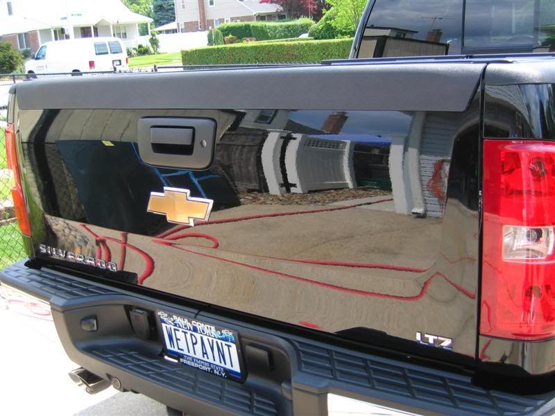

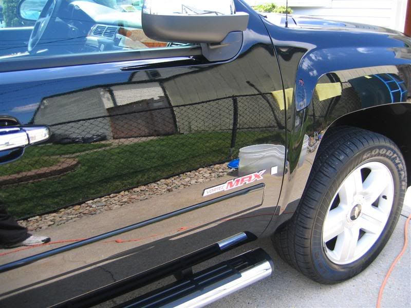

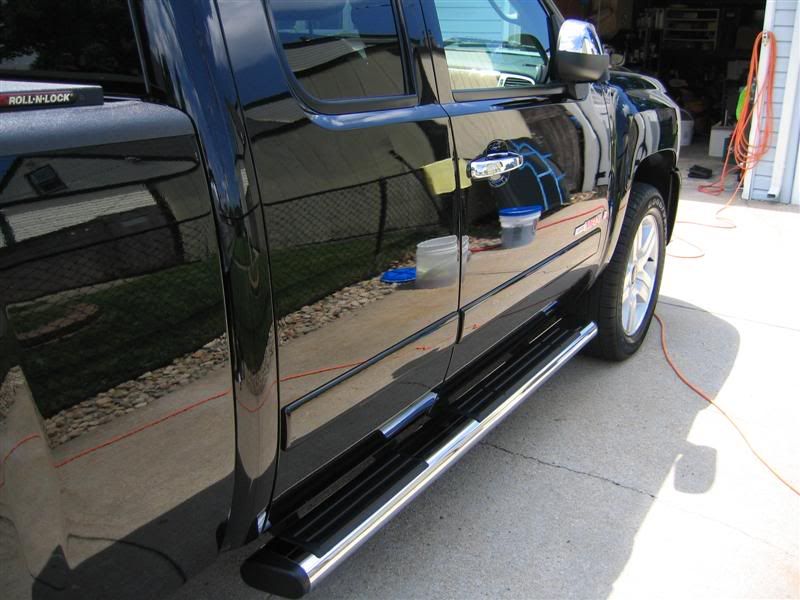

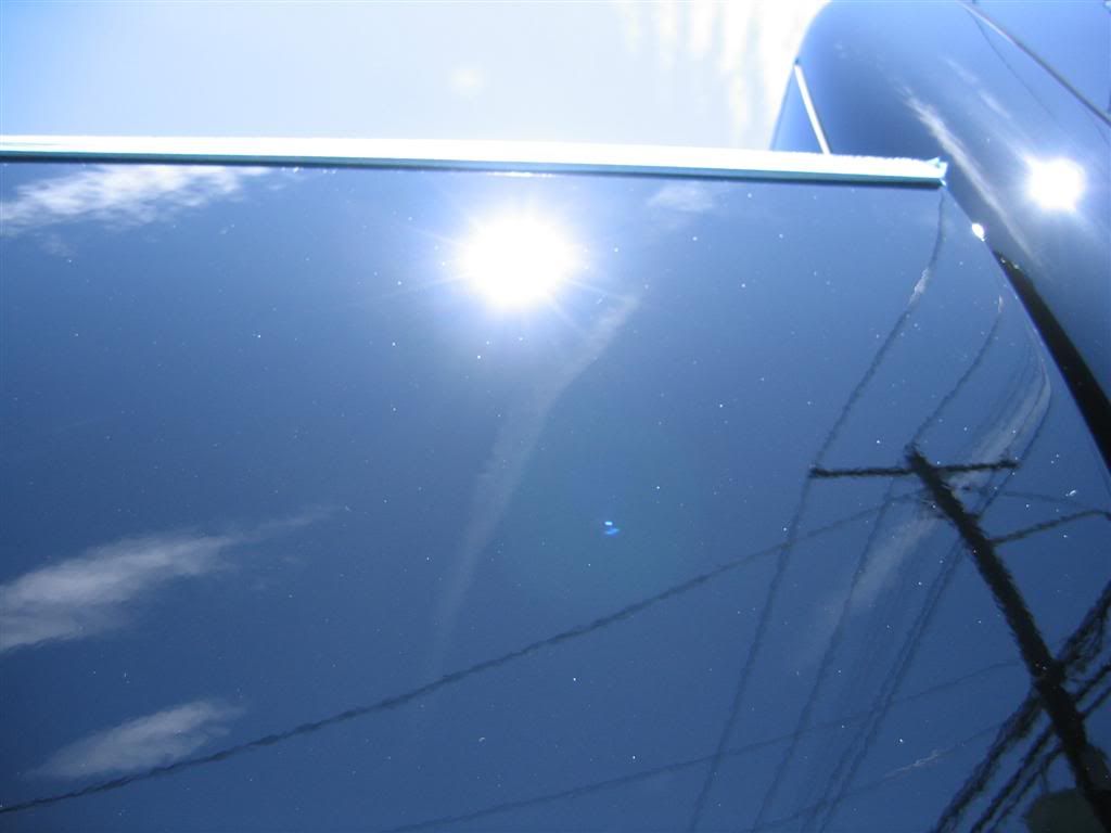

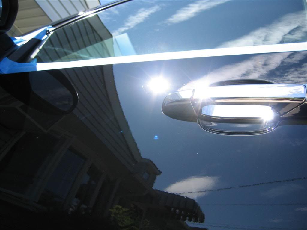

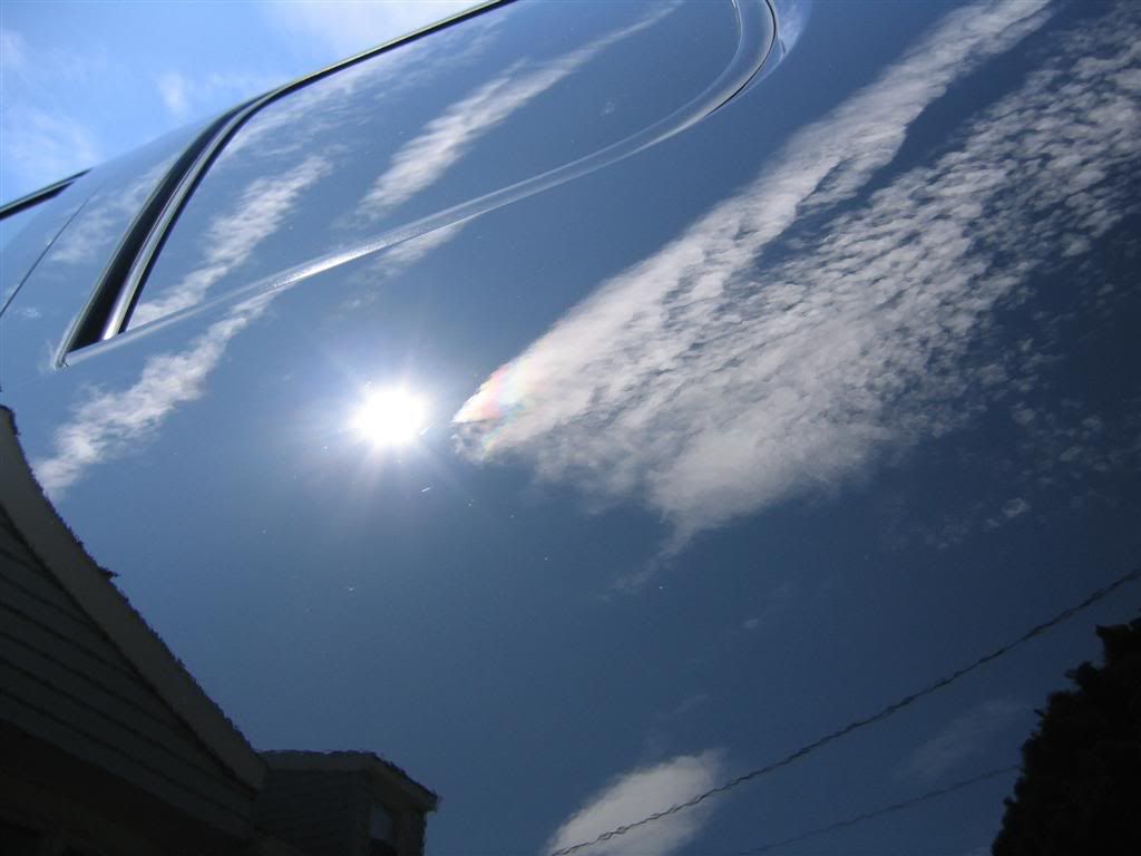

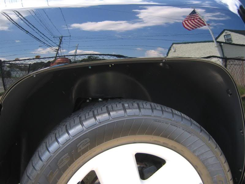

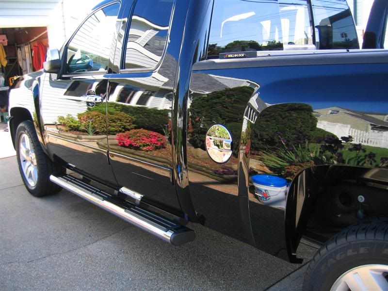

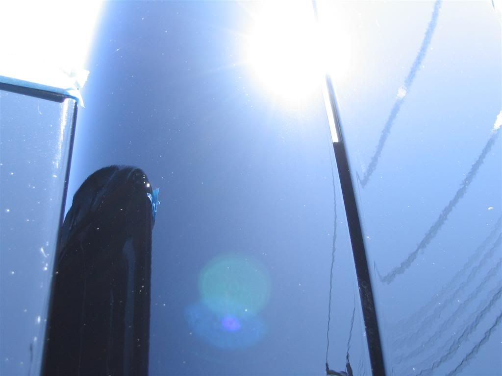

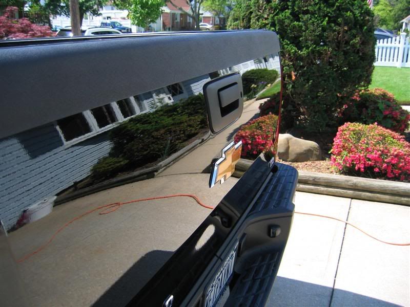

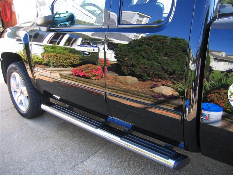

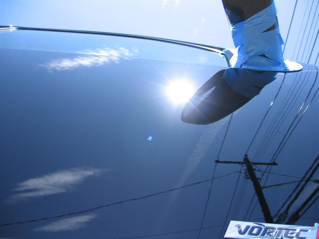

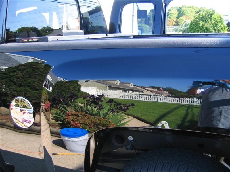

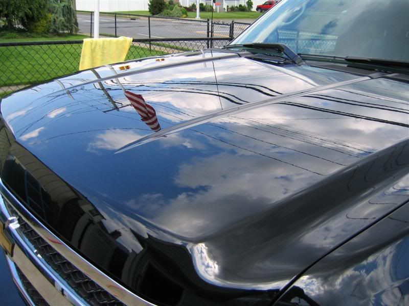

Here are a couple of sun shots:
Many more on website.
http://s575.photobucket.com/albums/ss196/Claude_45/Weekend Toy/

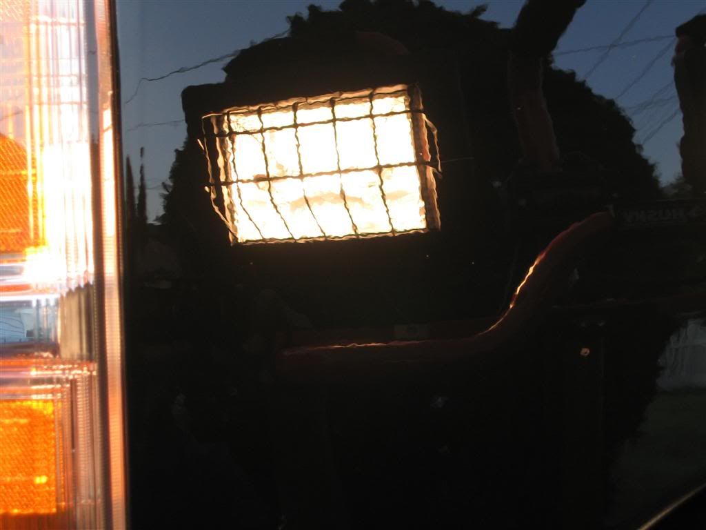

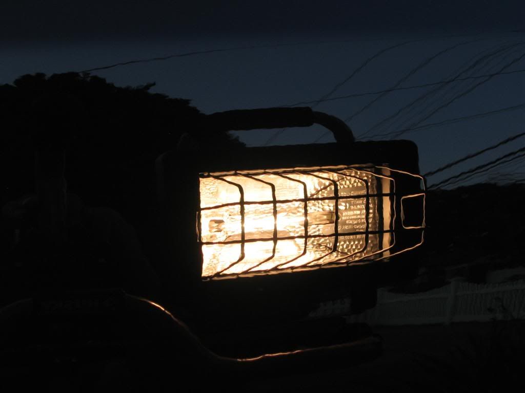

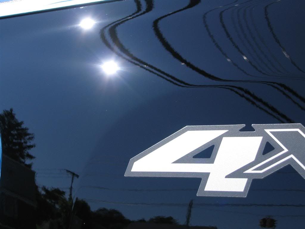

Here are some Photos where i was losing light so i pulled out the Halogens, to see if there is any swirls.
More on the Website.

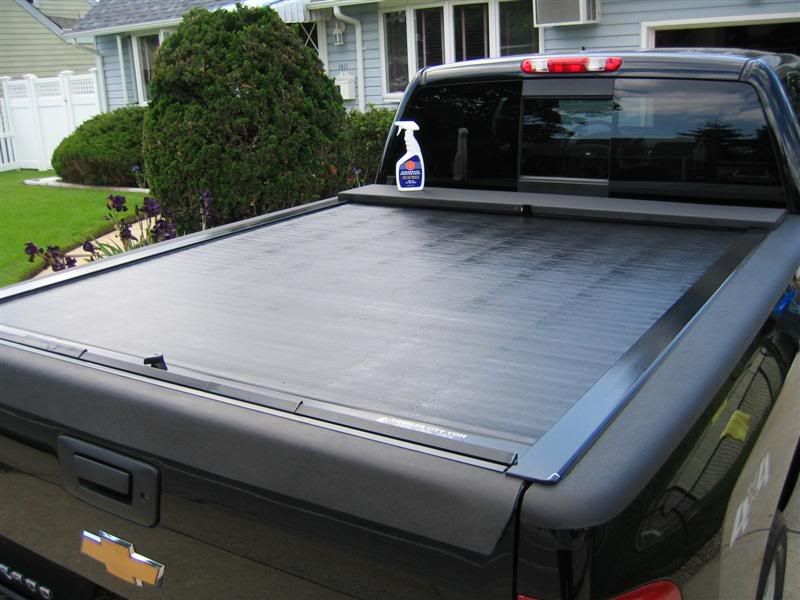

The tonneau Cover got cleaned with 303 Fabric/Vinyl Cleaner and got a heavy coating of 303 Aero. The rail caps and tail gate cap, got 2 coats of Dye Using Forever Black Bumper & Trim Dye Kit.

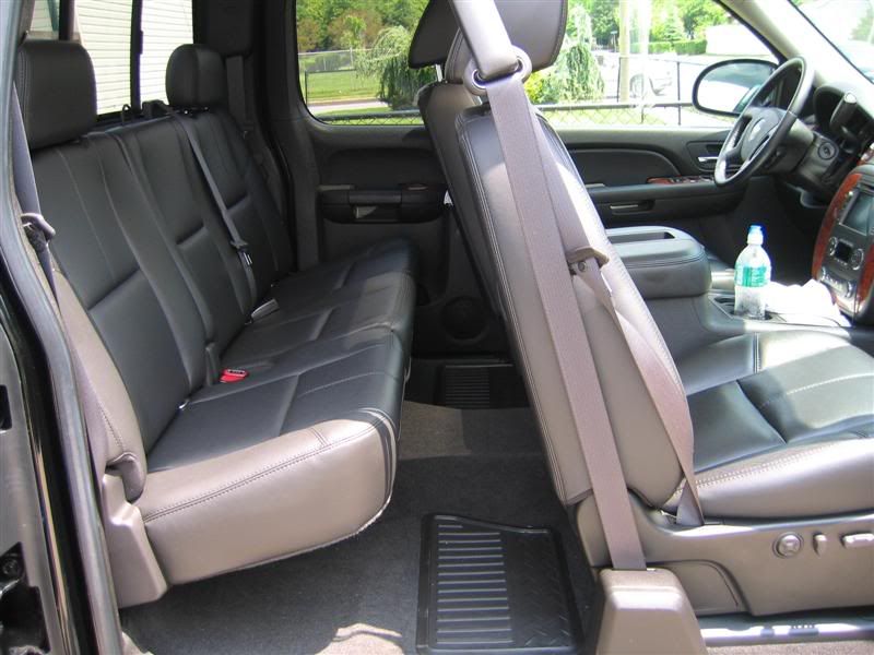

Interior, all leather got cleaned with Zaino's Z9 and wiped down with Z10.
All textured interior got cleaned with 303 Fabric/Vinyl Cleaner and wiped down with 303 Aero and after 2hrs.
got wiped dow dry.

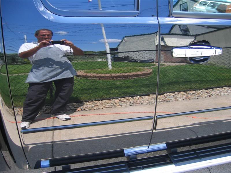

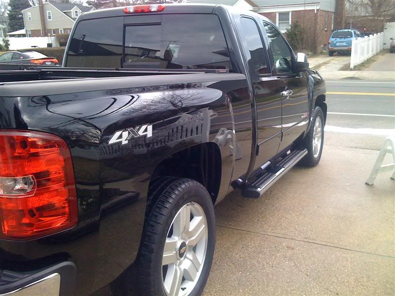

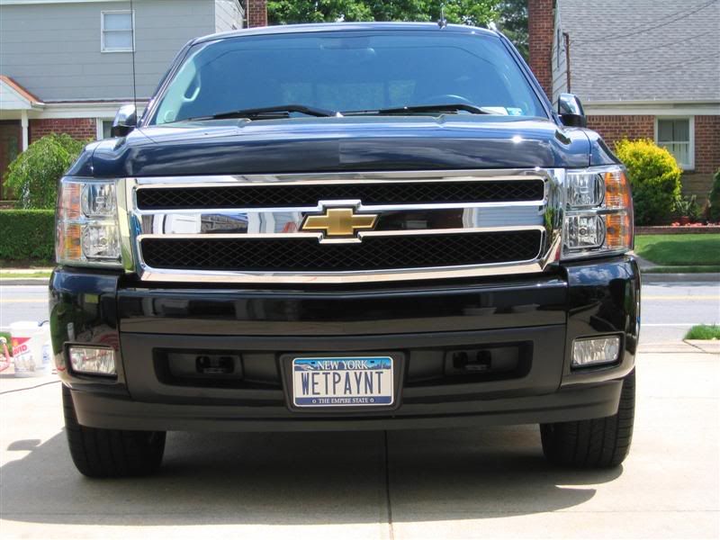

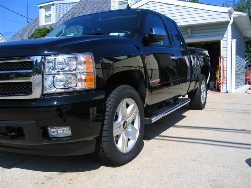

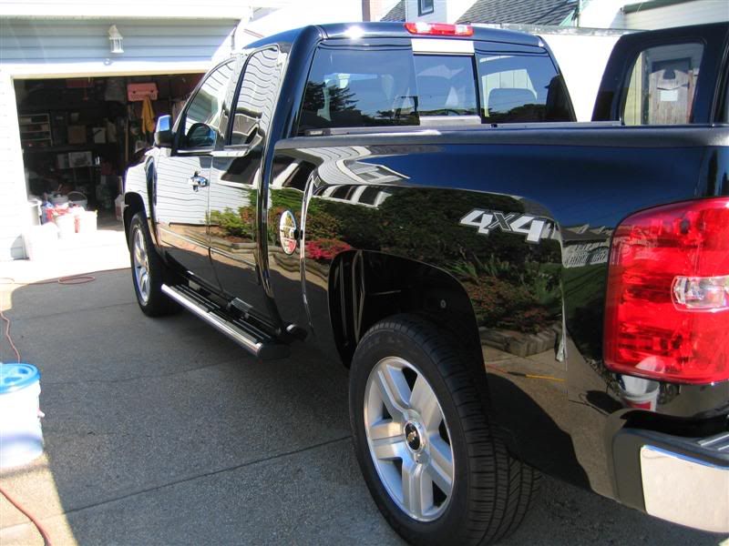

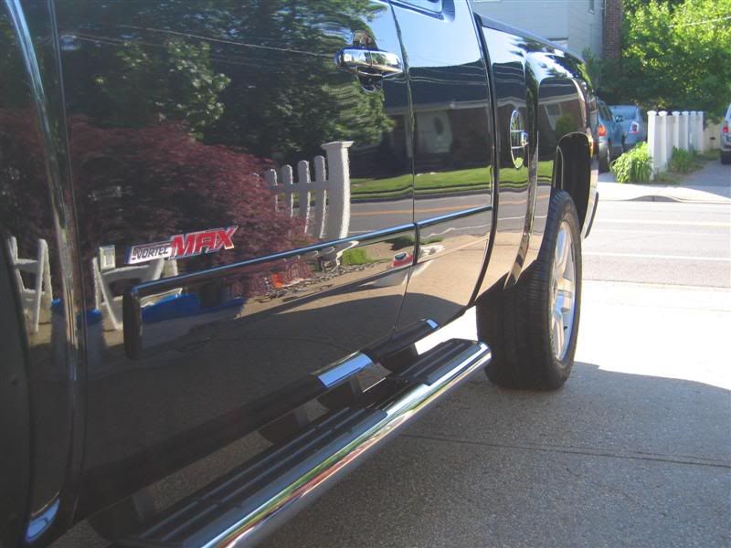

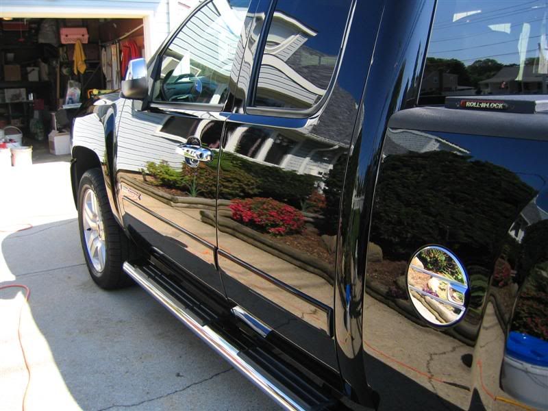

The final look after following instructions and taking my sweet time on my toy, gets me lots of compliments.

Next day i foamed the vehicle down with Z7 and rinsed off, only dust was on it.
Front Wheel Wells got dressed with 303 Aero.
Tire got one coat of Zaino's Z16 Perfect Tire Gloss.
Rims,Chrome,headlights,tailights,fog lams,license plates got air dried and Z5'd and then sealed with ZCS.
Followed the instructions and i just didnt like the dye sponge on the bottle, so i used a regular foam applicator to apply the product with gloves on, and it worked out great for me as you can see from the photo above.
24hrs later I applied ZCS to all the caps and it looks great Satin finish.
All trim on the vehicle that's textured, got wiped down with 303Aero, and then wiped down dry 2hrs later.
All non tinted windows and mirrors got Z5'd and next day got wiped down with Meguiars NXT Generation Glass Cleaner.
Tinted windows did not get Z5'd.
got wiped dow dry.

Mixed Z5 with ZFX 2 oz. to apply 3 coats onto the paintwork, Chrome and stainless steel.
After every coat, I wiped the vehicle down with Z8 instead of Z6, but the Zaino Applicator was Z6'd at all times.
It almost cost me my PVC fencing round my property. Someone was complimenting me while rolling at 5mph right onto my driveway while looking at me working on My TOY.
Checkout the Apron Baby!
