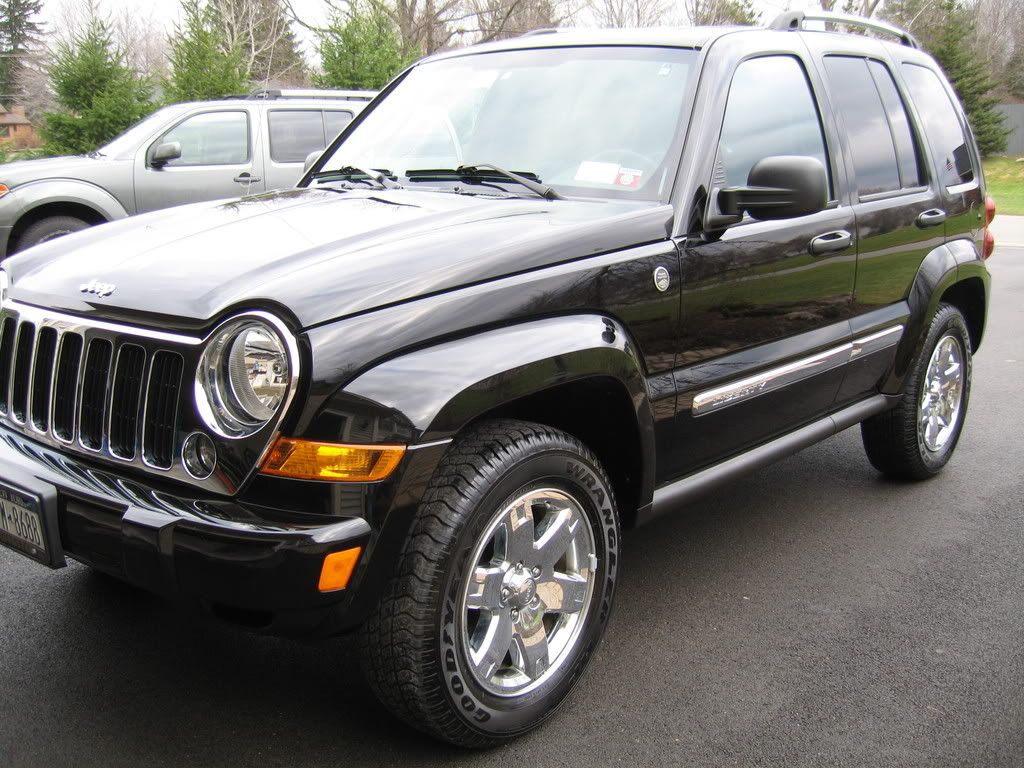

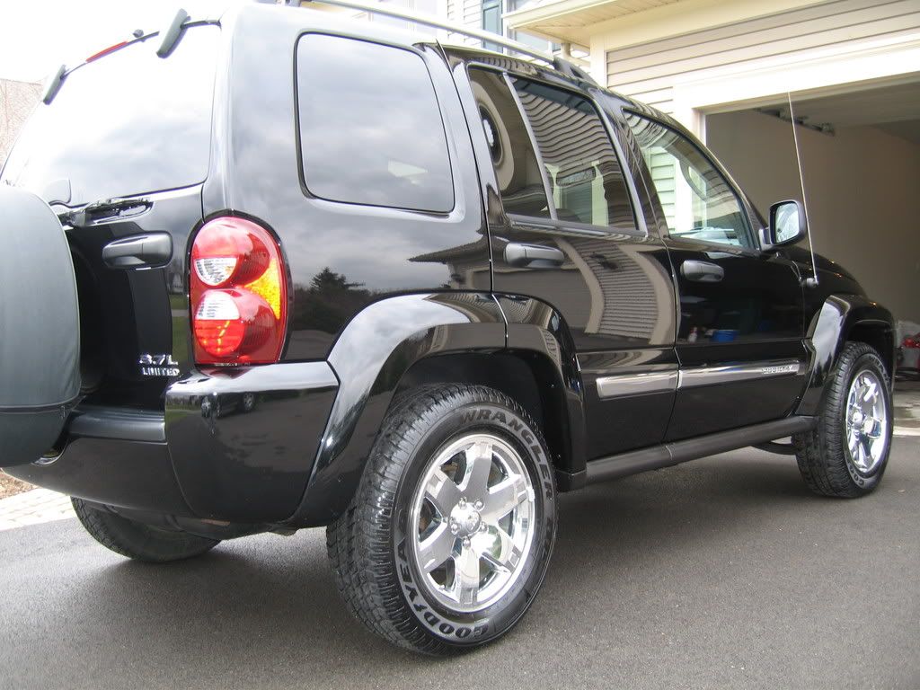

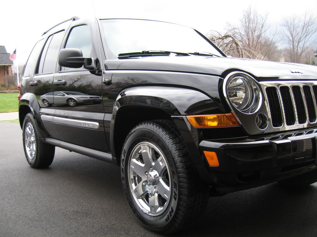

I went back to Blitz on this one because my customer was looking for a deep shine and something that lasted. Since this was black I figured heck why not. I have gotten over 4 months on Blitz in the past and I already scheduled him for 3 months from now. Also I advises the owner that the chrome was lifting on the wheels and he was little upset about it, good thing I showed him this prior to working on the car.
Here are some pics, I know its not what we are used to looking at here but I am happy because I getting work again in the area I now call home.

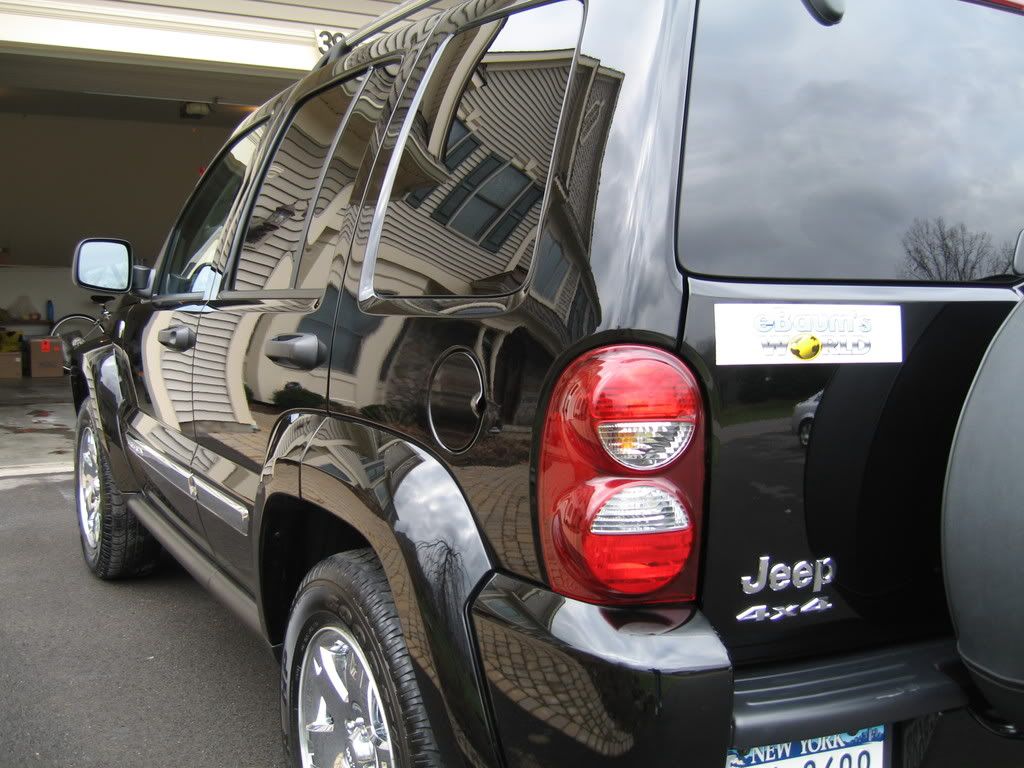

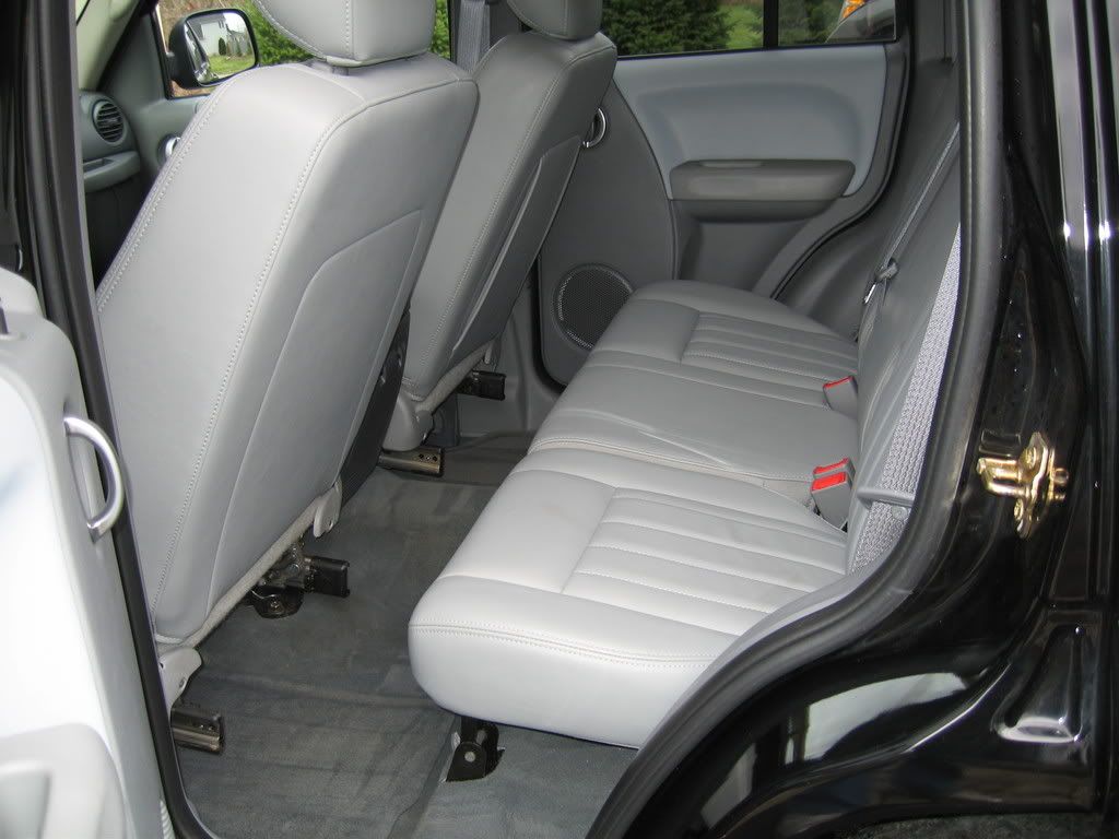

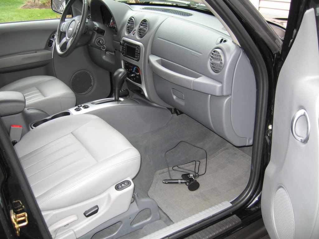

The interior looks better then new and the paint has a very nice gloss.

Thats a good looking Liberty. Those tires look good on that.
Whats up with the ebaum bumper sticker?
lol, the owner of the jeep is Ebaums founders father. :D
As for the seat rails I have a nice little cut on my finger because of those rails. Some things will never change. Although I did pick up the car and drop it off and road manors were not that bad. No rattles with 13K on the clock

About the wheels. Except the high end SRTs, all Chrysler wheels are just alloy wheels with chrome plastic covers. Even though it probobly felt like metal, and cleaned up like metal, if you were take the wheel off and look at the back side you could see the edges of the plastic.
Kind of a shame they aren't realy, but Chrysler is saving a fortune doing it that way!
