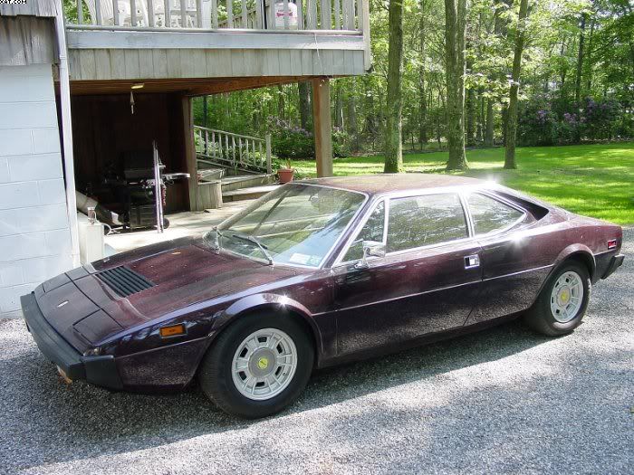

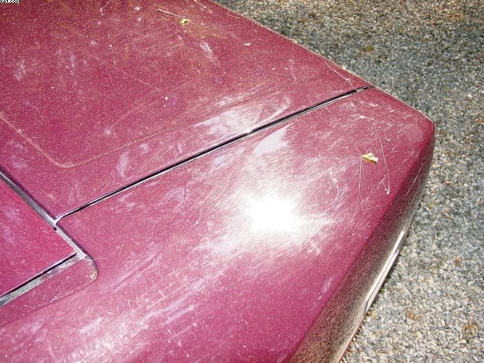

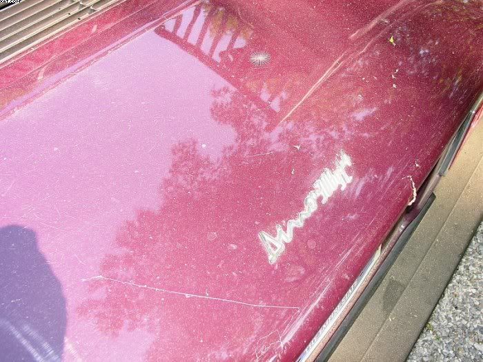

If I take this job, it will be my first pasta rocket :bounce . However, I'm not sure if its going to finish up to my standards. I'm fearing that I may have to use a light polish, glaze, then wax since the paint job is so old and beat up (original). In the pics you can see the heavy swirling, ferrous oxide present, as well as some clear coat checking on the trunk lid.
If anyone has any words of wisdom on what I should do with this job in general it would be greatly appreciated. Think I should have a waiver as well? Thanks in advance.
What kind of sicko lets THAT happen to a Ferrari?. I don't know why, but the paint just looks kind of thin to me. If I were doing it, I'd stay off the powergloss and just use OCP. I'd finish up with a good glaze (VM, FTG) and then a wax that'll hide defects and deepen/darken (blue Natty's comes to mind).

That sight makes me cringe! I think this is a detail that ought to be done mostly by hand and perhaps with very light PC work.
I hope the owner realizes that complete miracles aren't realistic.
I wouldn't use VM on that one, IMO it'll make the defects show too much. I'd go with an oil/glaze-centric approach.
I second the #80. I'd probably use #80, then either #5 or #3, then a "heavy" wax or maybe NXT if you can apply the NXT so gently that it won't strip the glazes/oils.
And yeah, if you have time I'd use a chemical paint cleaner first to show just what you're really dealing with. I'd use something other than AIO though so you don't have to work to cut through the protection it leaves behind. I'd probably use Pinnacle PCL myself.

Nice car! Do you happen to know what the offical color name is (i.e., Rosso Rubino, Rosso Bordeaux, etc.)?
These cars were painted with single stage paint, so there should be no clearcoat, unless it was repainted.
You should have no trouble using a PC. I've used it on mine several times with no issues, and my paint is over 25 years old.
The Dino 308 GT4's are great cars. Unfortunately (or fortunately, if you are in the market for one) they are not worth much - $25k should get you a really nice one. They handle better than their other 308 brethren and are also slightly lighter.
