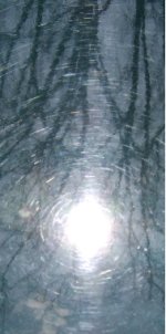

will a dual action fix these swirl marks or do I need high speed buffer? (photo)
I've attached a picture of a dark green BMW with swirl marks you can only see in direct sunlight.
Can I tell, before buying or using either, if I can remove them using a Dual Action Orbitable or I need a high speed buffer?
Thanks for any ideas!

I would say start with LC orange pad and SSR2.5 or a LC yellow pad and SSR1. Take your time and go slow. Apply some pressure. Start around 4-5 take it to around 6. I bet it would take them right out.
Cheers
Nick
Like state above with the right pad/product combo, yes it will.
