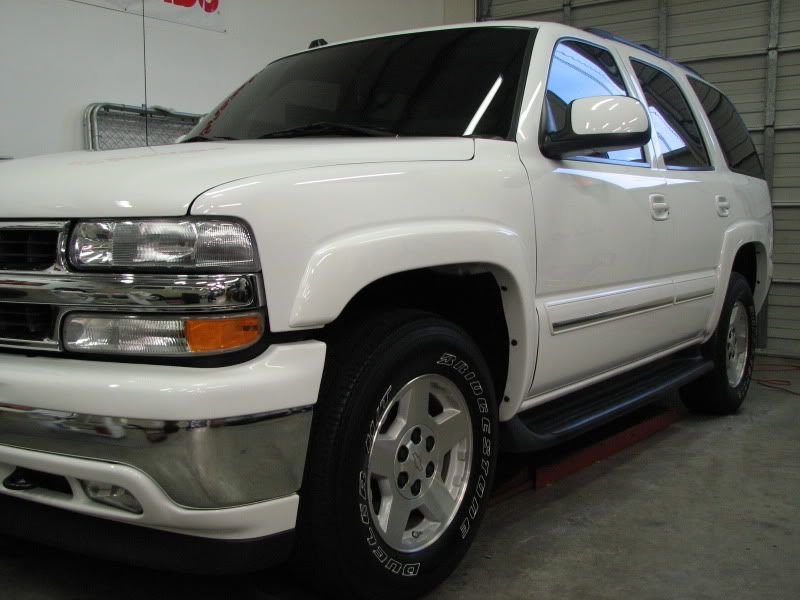

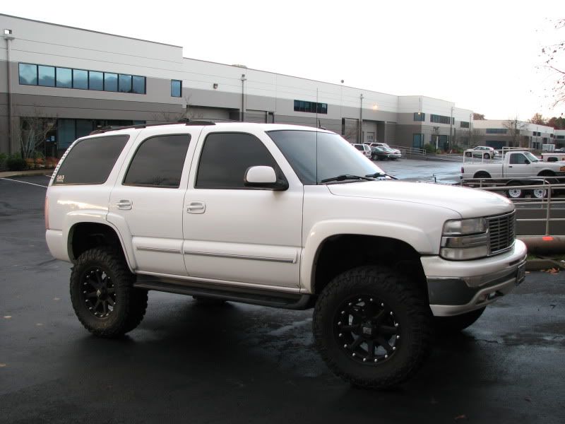

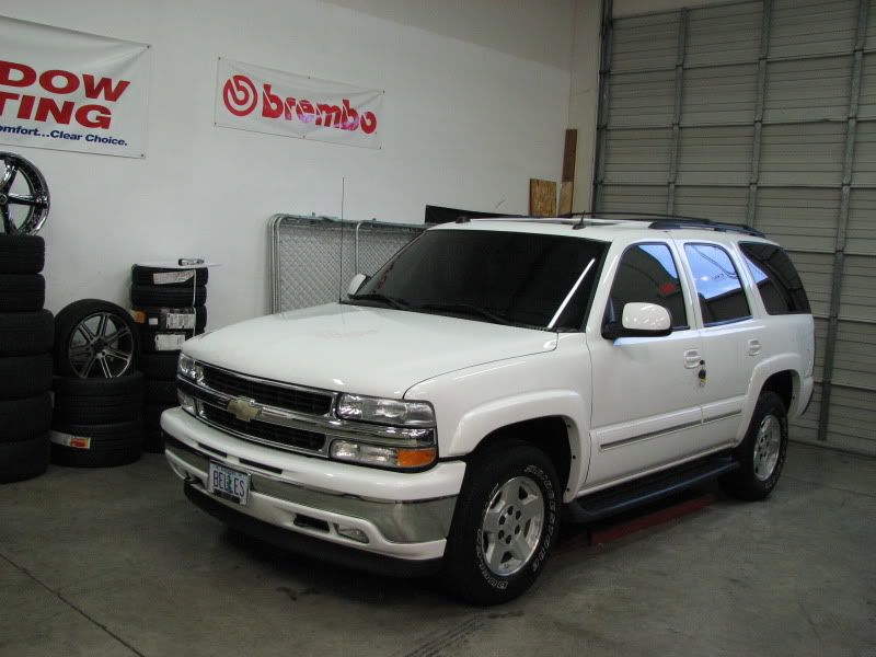

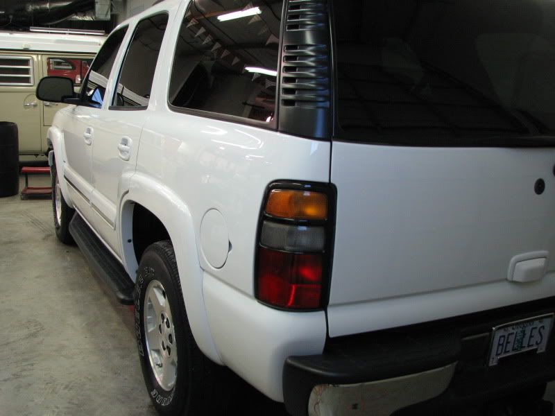

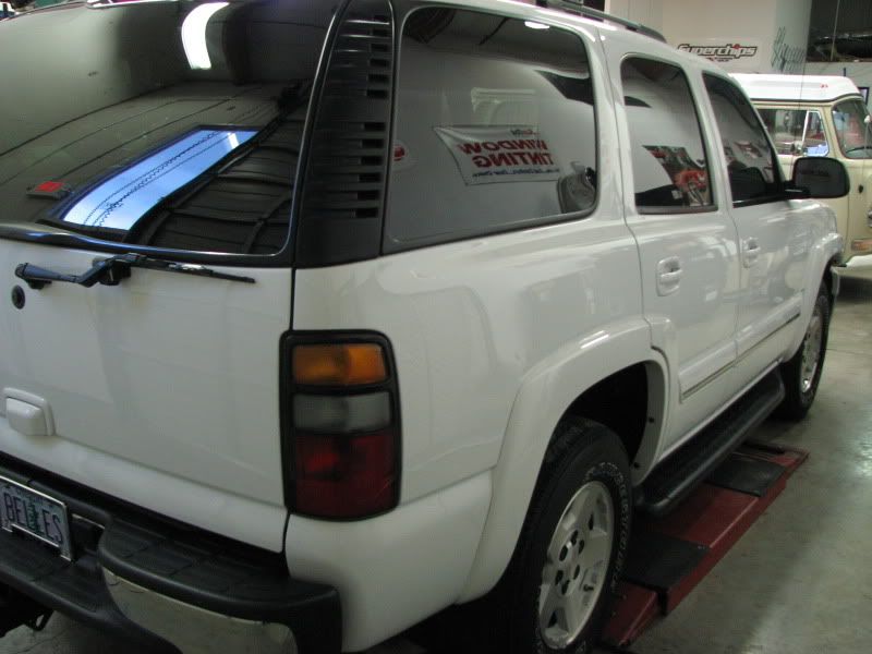

The owner of this Tahoe below that I have corrected recently must have liked the result because he asked me to do his GF's this time.
While I have seen this Tahoe in the flesh, it was from afar and had no clue what the condition was like. Thankfully I was reassured that it was in much better shape than the above truck (prior to the detail of course :D)
It is?

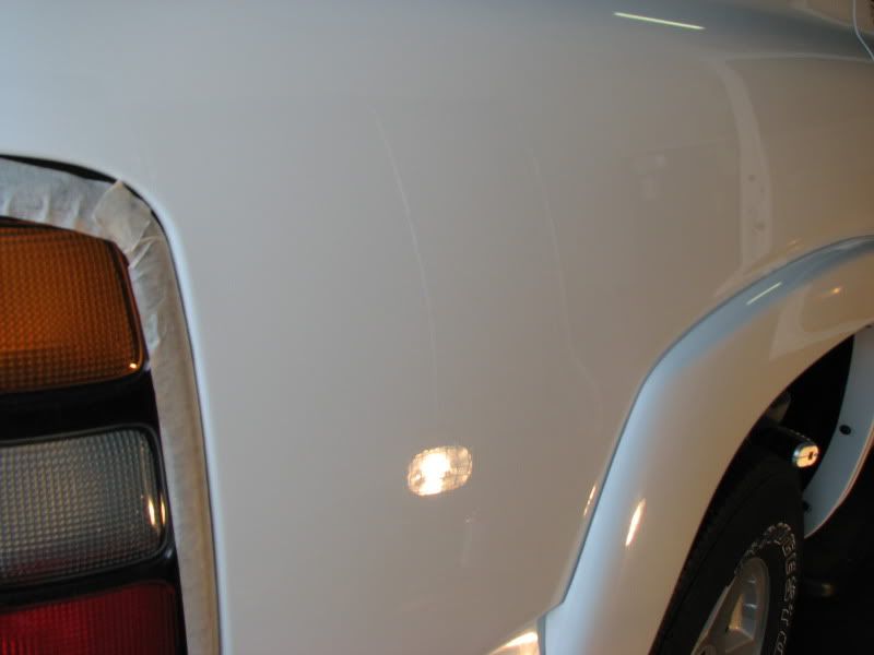

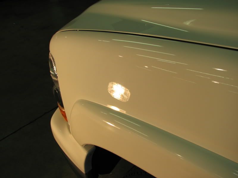

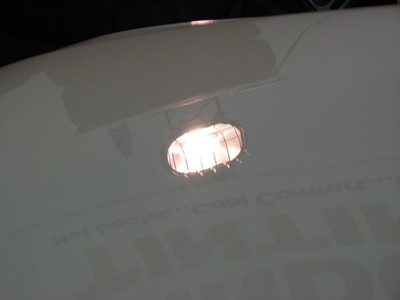

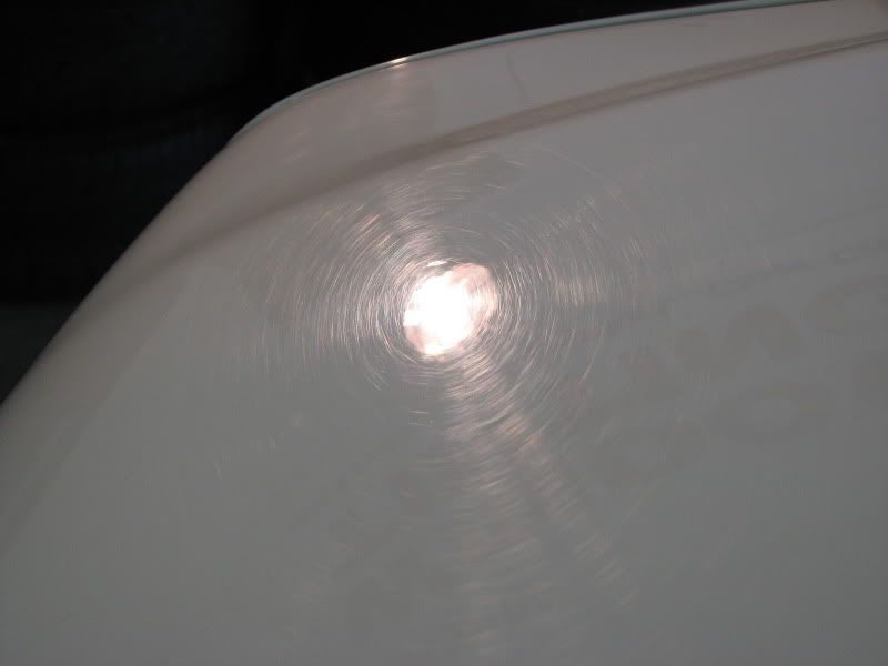

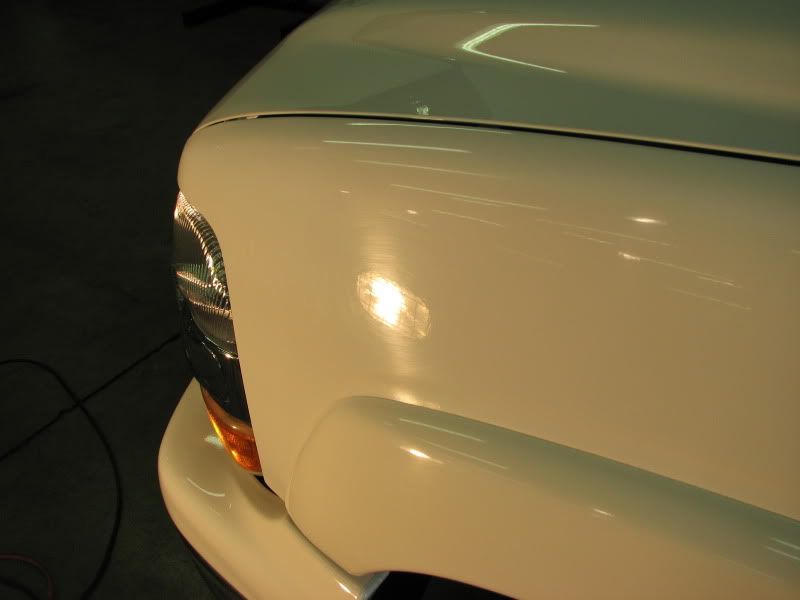

Before

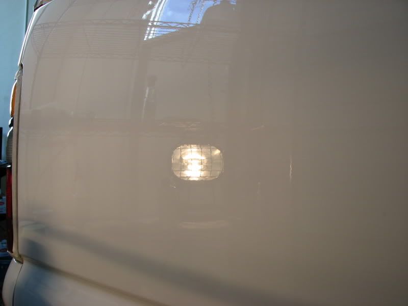

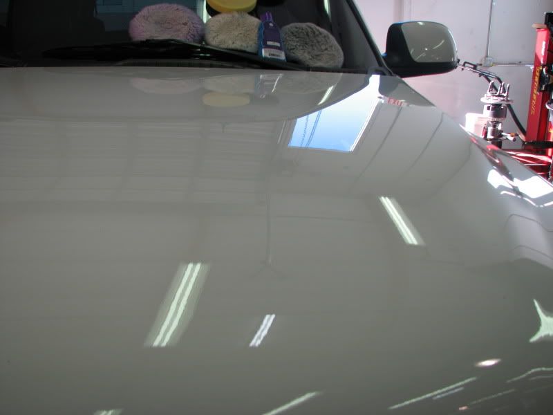

After ez creme glaze - much better
The process was
3D WASH
3D CLAY
HD UNO ON WOOL/ORANGE,WHITE PADS
EZ CREME GLAZE ON HD UNO PAD
FK1#1000 ON HD UNO PAD
OCW TO REMOVE SEALANT
HD QD ON WINDOWS
3D TRIM SHINE ON TIRES
TOTAL TIME: 20 HOURS

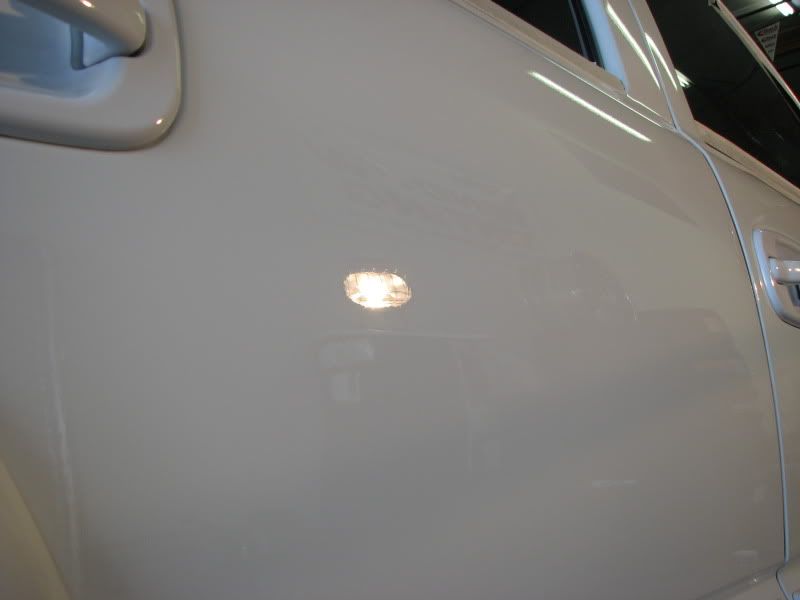

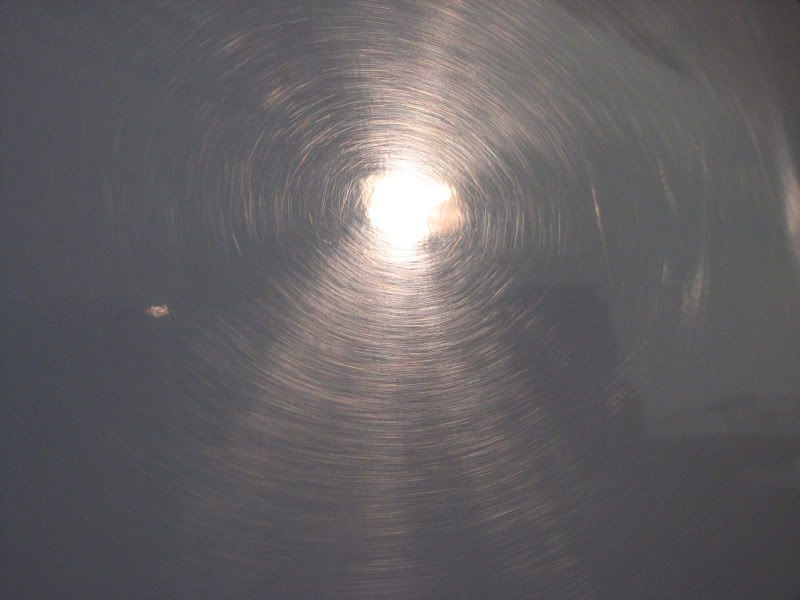

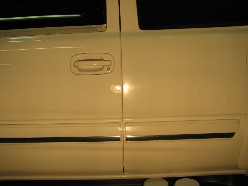

50/50
Before
After
Front door done
Rear door untouched

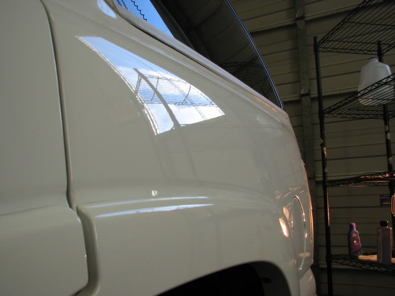

Afters

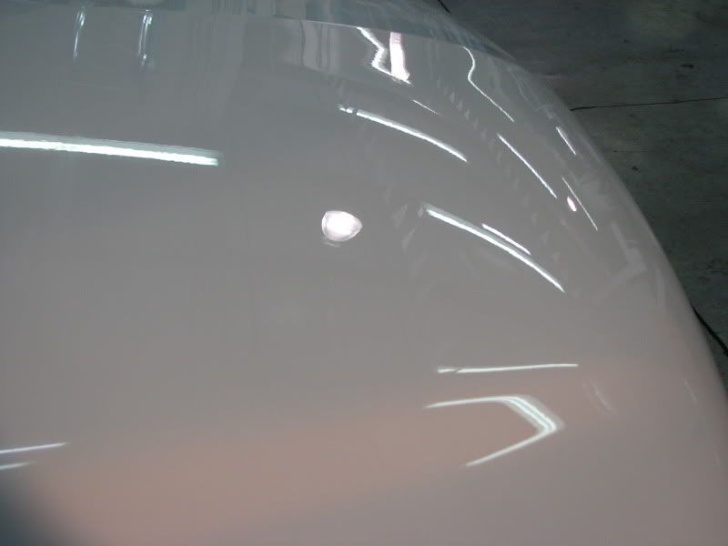

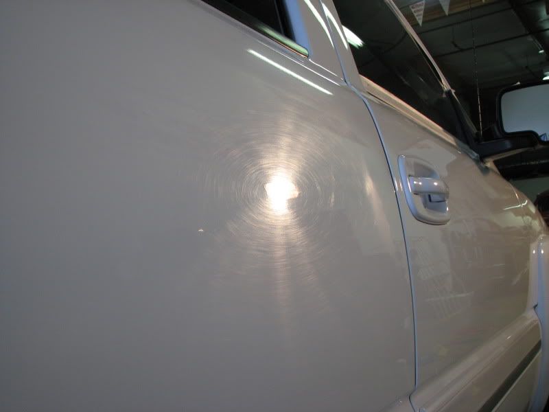

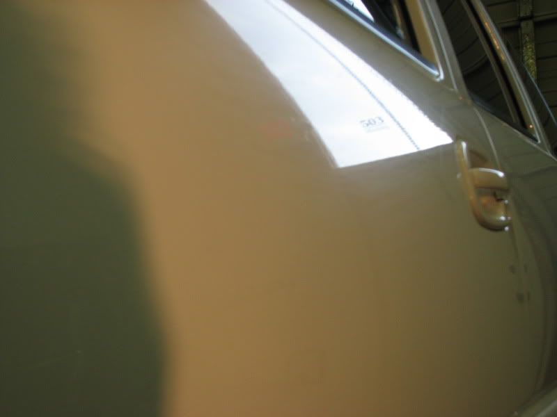

Before - cloudy looking paint

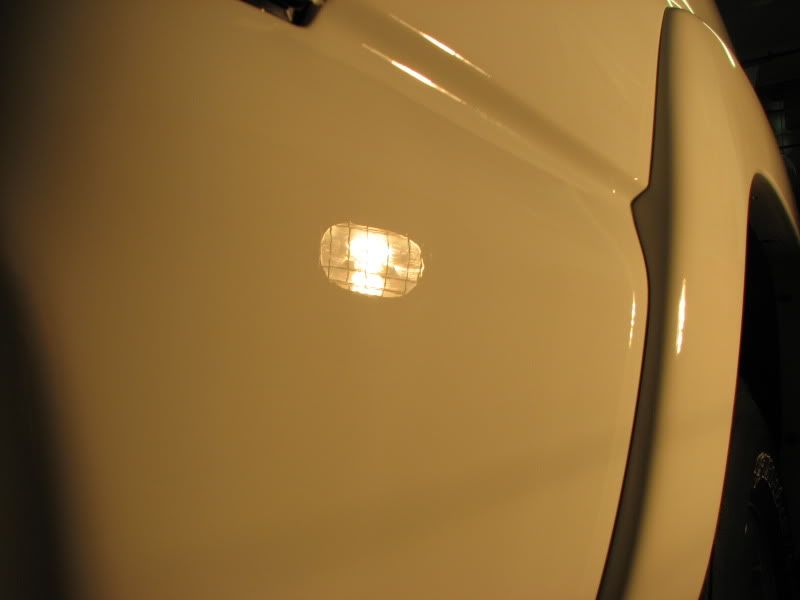

After - clear paint
AFTER FK1 #1000/OCW

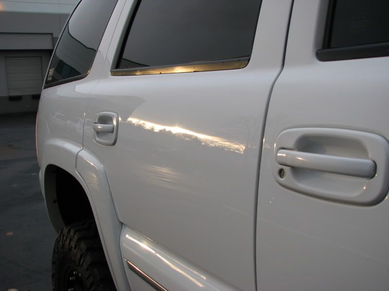

tdekany- Heh heh, I bet you've about had it with white Tahoes for a while! Good job once again, but one of these days you'll have to correct the roof on one of those :chuckle:
I'm *so* impressed with the way your pix capture the marring on white :xyxthumbs
I kinda like this one with its stock look better than the blinged-out one!
Very nice work, glad you were able to capture the defects on that color, really goes to show how great the final product is.
