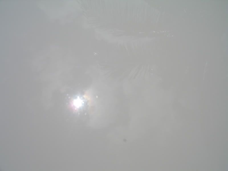

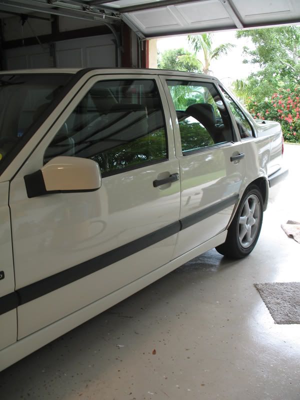

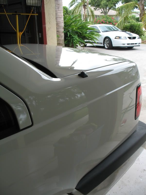

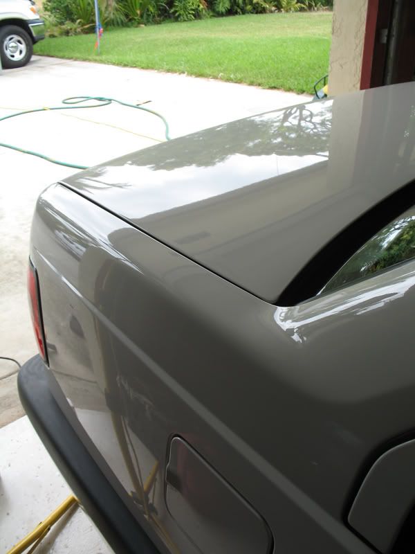

sorry, I didnt know the year but I do know it was over 10 years old, heres my process and sorry I didnt have many before pictures, I was trying to get this car done!
-Wash with nxt wash soap
-Clay with Pinnacle Poly clay
-PC with orange pad optimum polish, speed 6
-PC with white pad, optimum polish, speed 6
-Poorboys EX with caranuba

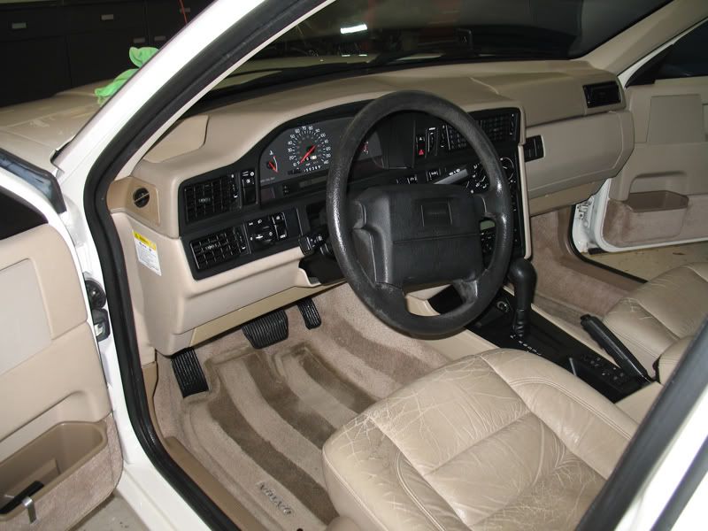

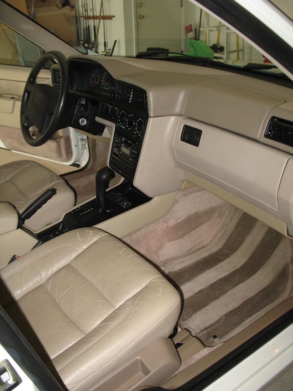

Interior...carpets scrubbed, vacuum, windex, interior trim shine, leather conditioned with poorboys leather stuff, etc etc etc

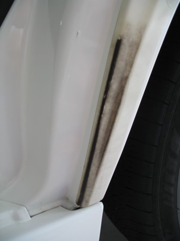

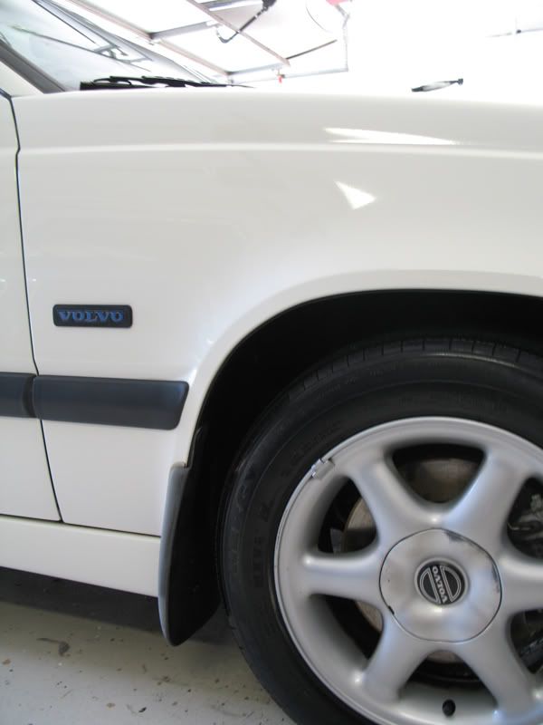

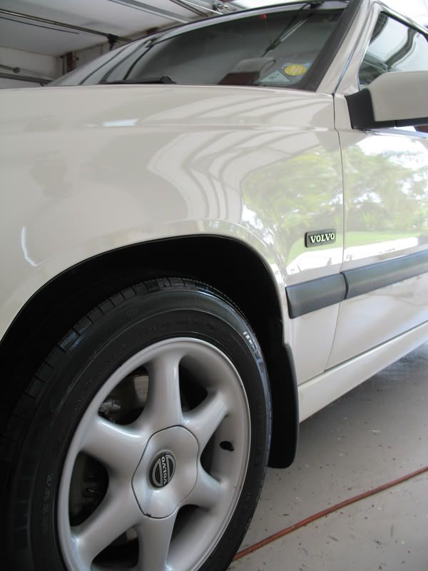

Look at the door as compared to the fender

holy cracking leather seats!!! :eek: that is a poster-child for why people should condition leather at least a few times every year. hehehe
oh, i just noticed...looks like you didn't dress the black trim on the vehicle...a little 303 or similar would make the white stand out a ton more too! :2thumbs:

I tried using back to black, some trim shine, didnt seem to wanna come back....and as for the leather seats, yes they were bad, I condition mine at least once a month lol
Nice job. Seems like tan or a lighter color leather cracks more easily than a dark or black leather. Just wondering if there is any validity to that observation, as I've only had cars with black leather interiors.

:wavey Yeah, I have tan leather and my driver's seat looks like crap.
Nice work on that old Volvo, looks like you got most, if not all the swirls. :)
