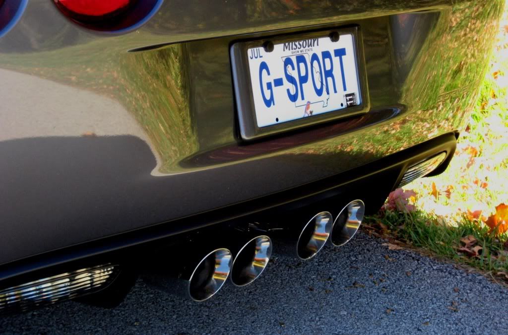

These tips are from my 02 Z06 with titanium exhaust . I dont know if the tips are titanium or not . How do you polish them ? A drill adapter like a mothers powerball and some metal polish or just the steel wool and metal polish ?
I polish mine by hand with Happich Simichrome Polish. Best metal polish I've ever used. 10 minutes, once a month.:thumbup:
