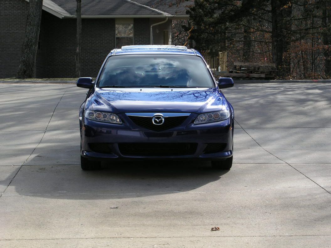

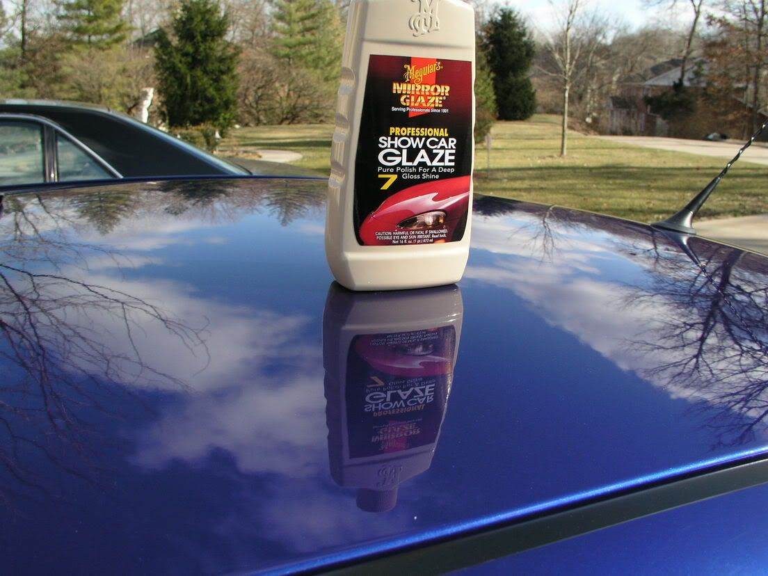

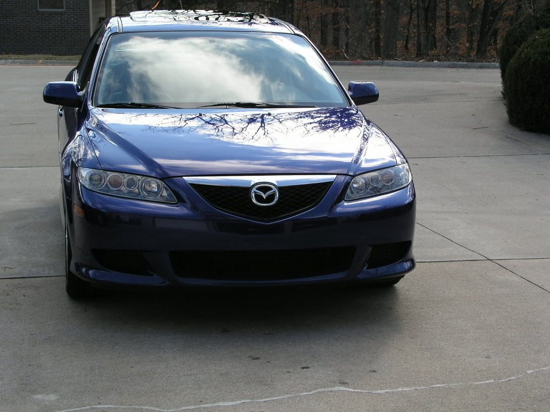

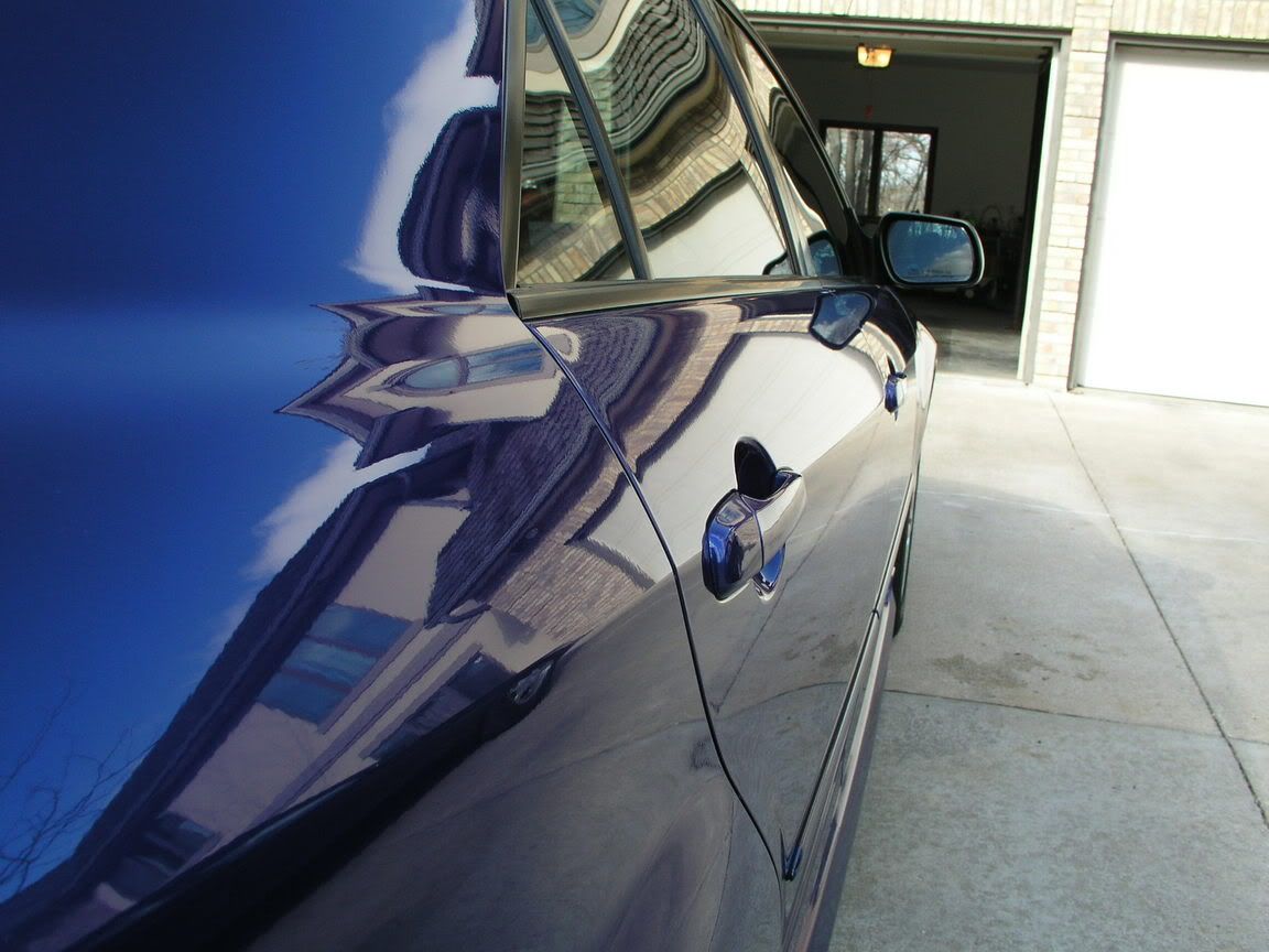

Thanks for all the help guys. I went ahead and bought this paint glaze. I know i know, swirls are still there somewhat but I don't have the cash in my wallet to buy a rotary at this moment of time. Anyway here's my car after i cleaned it. I just used terry applicator pad and buffed it off with microfibers.
#7???
Search MOL. #7 was made by Meguiar's in the stone age. Does Barry Meguiar use #7 on his car??? Hell no. #7 is a dust magnet. #7 doesn't last very long. #7 is a b*tch to strip off (which you will need to do, because it doesn't last.
It might look fine now, but you will live to regret #7.
Take the advice given earlier, and next time use one of the many products suggested in the thread. Any of those products are superior to #7. In fact, even Meguiar's has tons of products that perform better than #7.
Peace.
Actually, #7 is a very good glaze - even if its really old; same vintage as #16 - especially on s/s paints. It is hard to use but 6Th_WaRRioR seems to have worked out how to use it. It looks really good. It has that wet-paint look only #7 can produce...maybe because it has actually wet the paint!
Warrior, if you left it glaze only, you need to top it with a quality carnauba or else the glaze will wash off in the first rain. :up
True, because it is a non-drying oil. It will just skin like a cooling pudding. Show car effect for the period of the show... means a few days.
Yes, #7 will hide those imperfections. But even NXT will hide them quite good and it will last significantly longer than #7.
Warrior, believe us, it is worth to eliminate those scratches!
