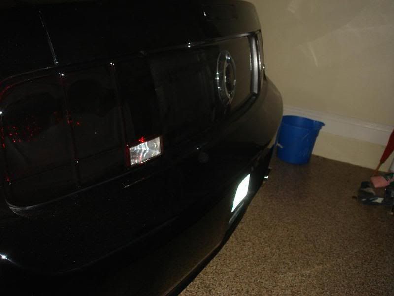

Since you are using Night Shades, I would wetsand them to get them nice and smooth first. Use 2000 followed by 3000 grit wet/dry sandpaper and then use megs 105 followed by megs 205 to buff to a perfect shine.
Here's a picture of mine, although I used Glasurit paint and clear.
-Jeff
