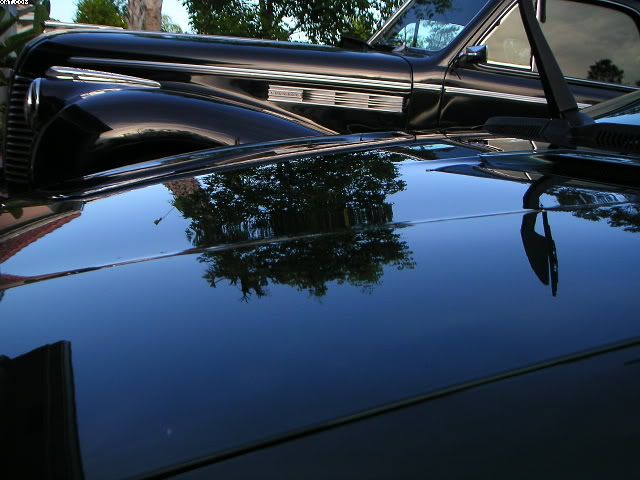

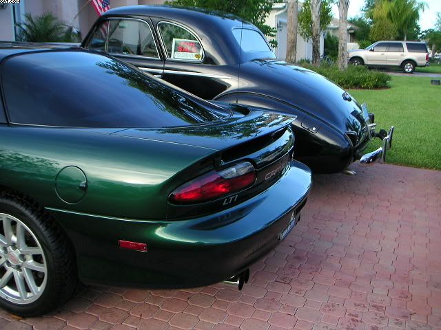

I LOVE S100 over EX-P. It's definitely one of my favorite combo's...looks extremely wet and reflective. Here are two pics.
