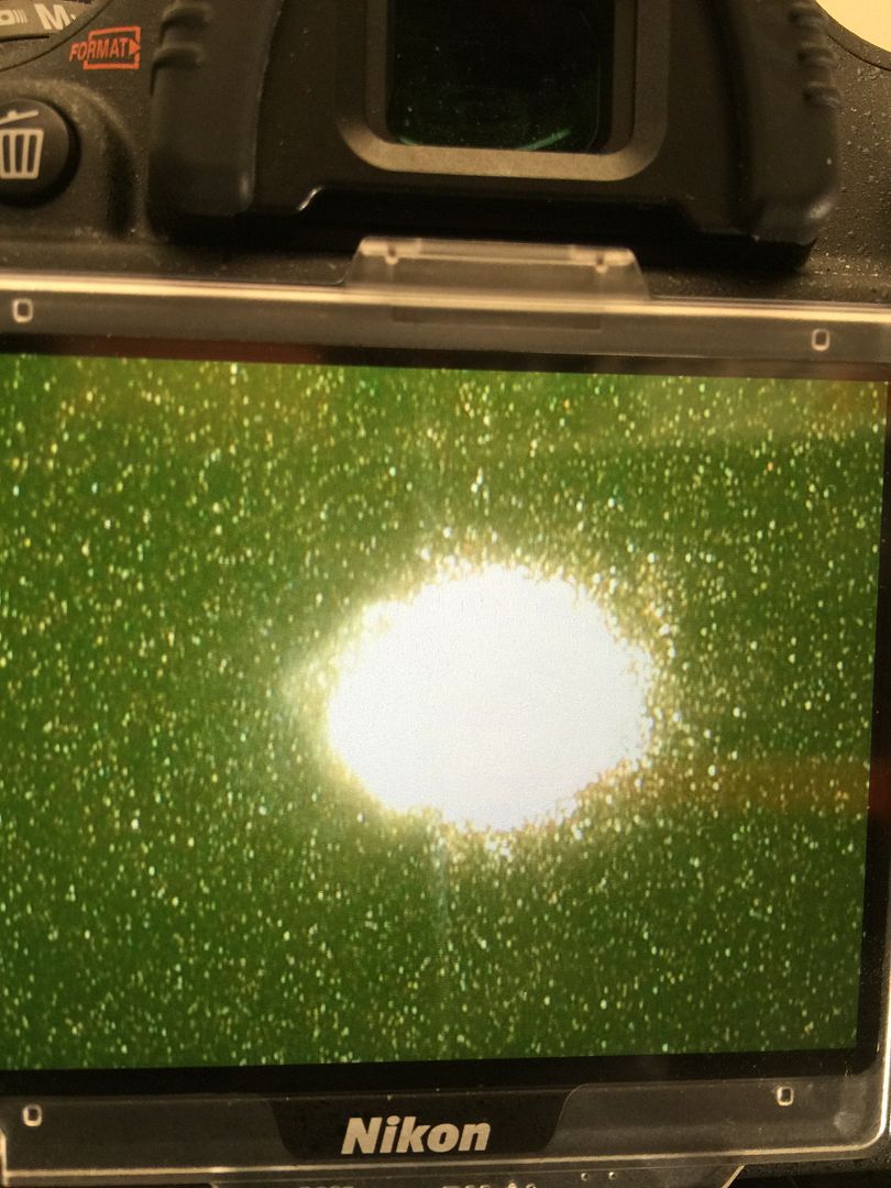

Make sure you look at the paint closely. The ones I've seen have had dieback and needed a good compounding even if they were virtually defect free. Seems pretty common with others I've talked to online as well.

I'm not familiar with what you are referring to...do you have any pics or can you point me to a thread about this? I definitely want to do this right and haven't quoted either hellcat yet (I have a plum challenger cat that's waiting as well). And both drivers are 60 miles away (in both directions ) from where I live so I have yet to inspect the plum cat yet but I imagine its worse based on my discussions with both owners recently.
these will be my Biggest (or most expensive car's) jobs thus far
previously put pbl on a brand new GT500 Shelby but that was a few years ago and we didn't polish because believe it or not the paint was great to start with

It was hard to capture in a pic and is more noticeable in person. Look at the right side of the light and how distorted it looks. All the conversation has been in private groups but I'm sure Joseph "Jsmooth" can comment on it and I think I recall seeing a pic from Billy where it showed it on here too.
Nope, but any compound should work. I used Griot's Correct Cream and a MF pad on the long throw.
