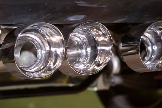

It's really quite simple. Take some 0000 grade steel wool and soak it with glass cleaner... You get results like this every single time. So simple yet so cheap.
Before:
After:
If you want to polish them out you can use stainless steel compound (green stick) with a 3" buffing wheel on a drill of grinder. Just remember the smoother and higher gloss it is the more it shows imperfection or scratches, thus the more it is to keep it at that point.
and yes I am crazy en off to polish the cross member
