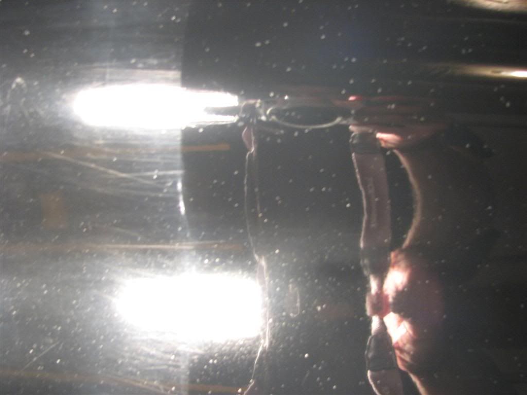

what is wrong with this paint???
i have just started working on a 1999 isuzu rodeo...black. using DACP and SSR-1...pretty happy with the DACP except it is a lot harder to remove after finishing than the SSR-2.5 i'm used to.
anyway, after a first pass on the hood, i saw THIS:

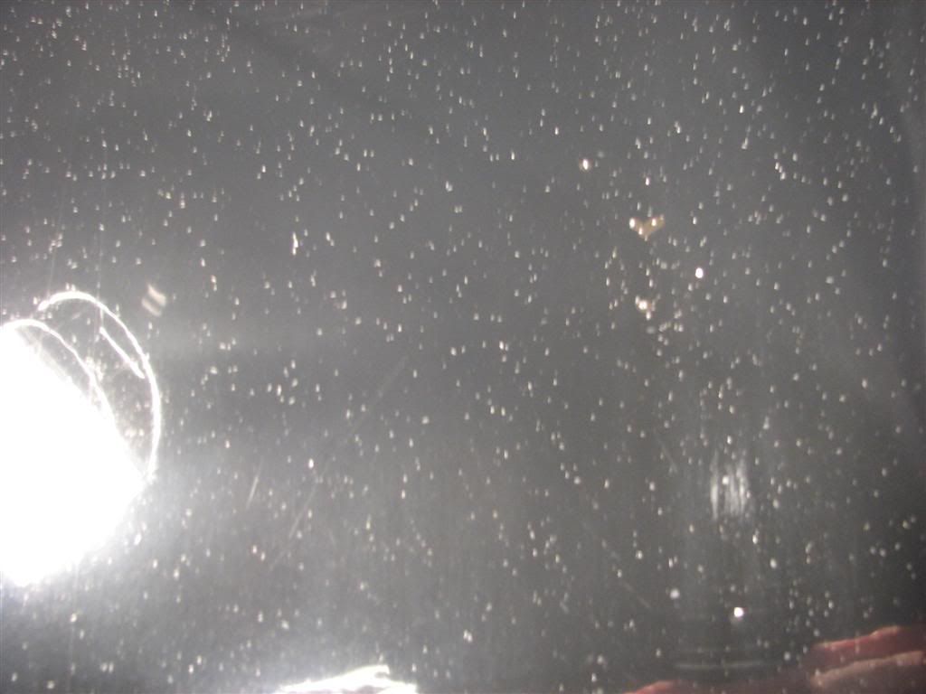

what are those specs?!? i started to freak out thinking i did something...dirty pad...something...but then noticed they are everywhere on the hood and quarter panels. the paint is completely smooth...they look like thin, tiny grains of rice under the clear or something.

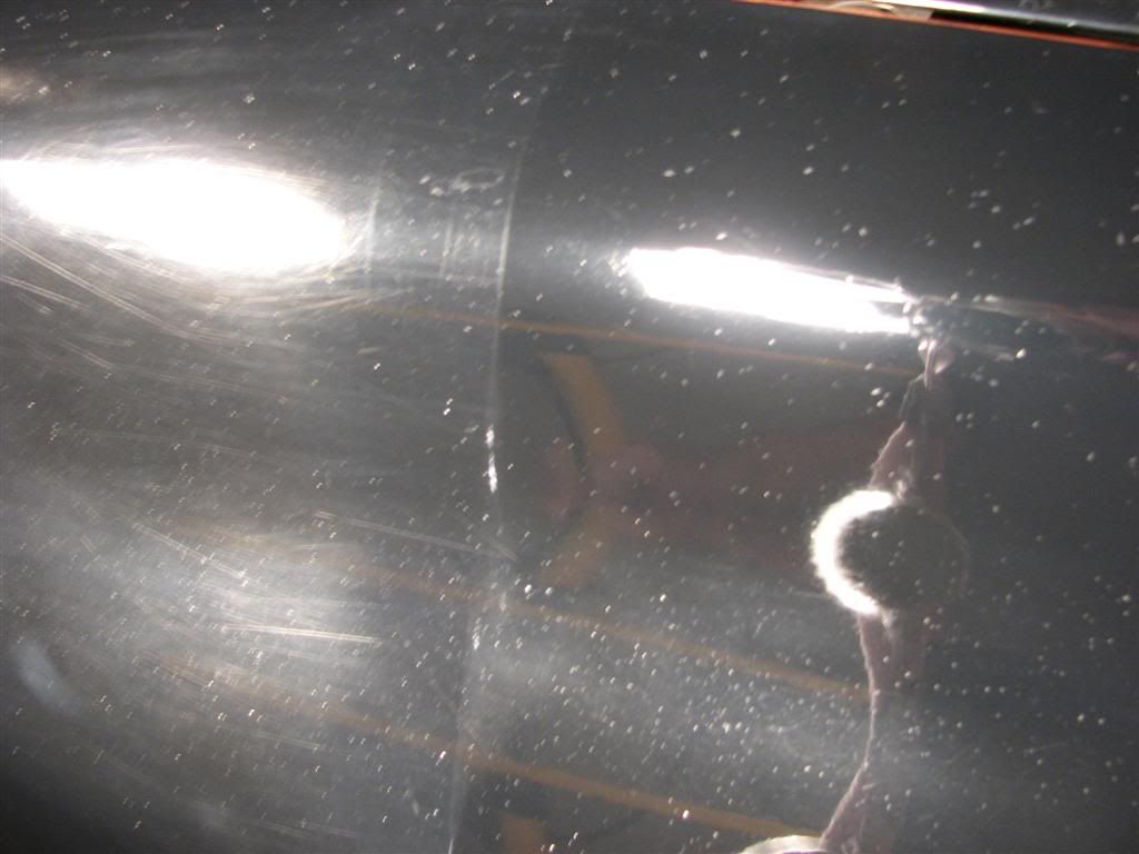

here are some side-by-side before and afters on one of the front quarter panels:
you can see the specs on the before side...they just stand out a lot more on the polished side. ugh. i just called the owner and had him check his email so he knew what was going on...he said it hasn't been waxed for over a year, etc.
Bubbling clearcoat.
I had it on my Integra from a bad repaint on my one pillar. The only option is to wetsand.
I would steer clear of that because you don't know how much clear there is under that.
i clayed all of the areas pictured prior to polishing...and it feels completely smooth. there are a handful of rust spots on the hood...so i guess it is indeed clear bubbling. :(
yeah, i've never wetsanded before and won't start with this one!
eek!

if it was caused from an external source (sand, dust, etc) then i would think you could feel it and/or repair it since it's on the top of the clear coat...but this is definitely inside the paint layers. i think the first explanation (clear bubbling) explains it.
i asked the owner if it had been repainted and he said no...bought it new in 1999.
