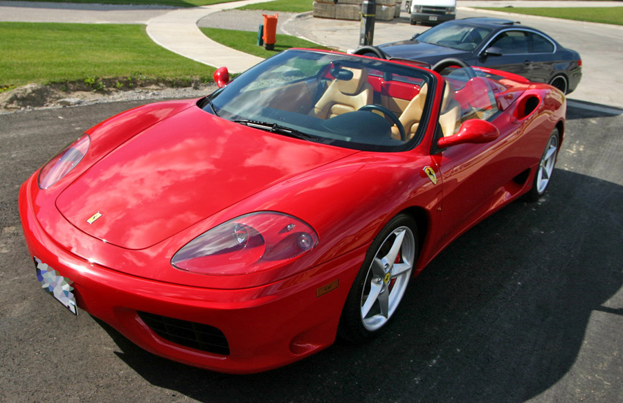

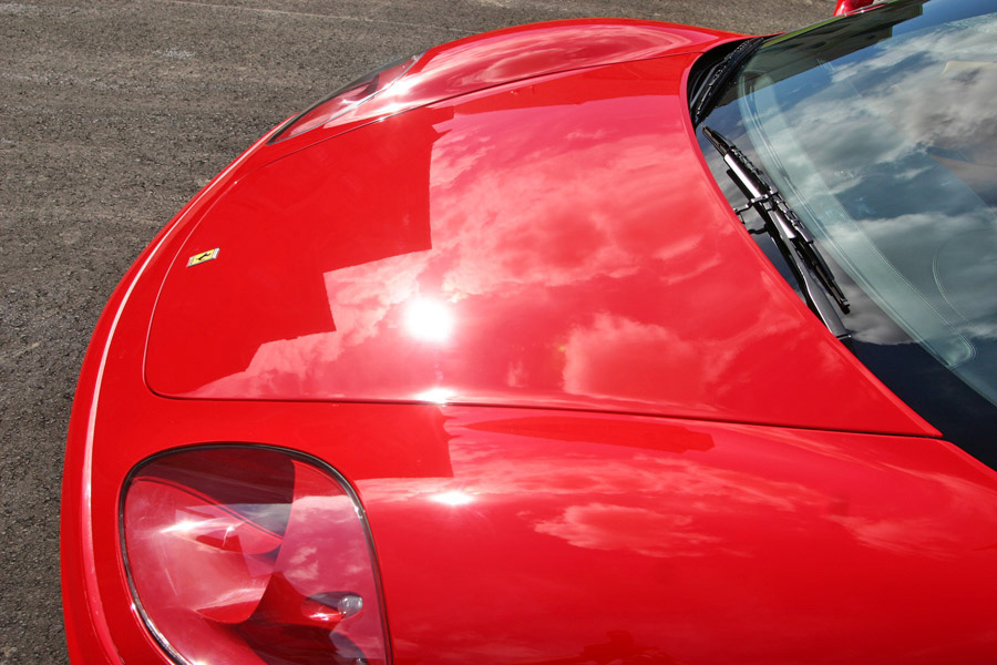

Pictures aren't the best thing to show a clear bra, but as an example the entire front end of this car is wrapped (bumpers, fenders, hood, mirrors, rockers and rear cowl).
http://gtaindetail.com/pics/360070308/images/d.jpg
http://gtaindetail.com/pics/360070308/images/e.jpg

That looks really good - you can barely tell it's there.
HOWEVER, how's it going to look in 2-3yrs time?
That's been on there 18 months. Modern films will yellow if they are not cared for properly, but unlike older films they are less prone to yellowing and won't if you take a modicum of care (as in, keep it clean). I'd say a film like that on a car that is generally well cared for will last at a minimum 5 years.

Interesting - the one of my dd (~7yrs old) isn't yellowed, however it is streaked and stained and all sorts of weird stuff that just won't come off....just generally doesn't look very good.
