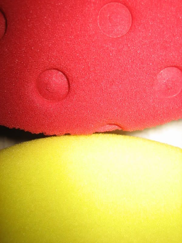

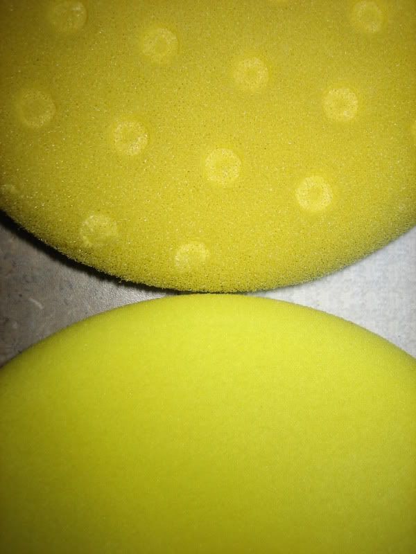

I have two yellow foam pads, both made by LC. The first one I got a few years ago from some clearance at either PAC or Autogeek. I can't remember. It's one of the older VC style pads. It's yellow, but not all that stiff (somewhere between orange and white) and has super small pores for an "aggressive" pad. The pores are much smaller than the yellow 6.5" Hi-gloss CCS pad I got from PAC. These two yellow pads are compared in the first pic below. In the second pic, you can see the pores in the VC yellow pad are roughly the same size as a red CCS pad.
The reason I'm interested is that I like the foam in the VC pad much better. It cuts roughly the same as the yellow CCS, but finishes much better. The yellow CCS pad is pretty nasty--I only use it on glass. It's like those yellow bug scrubbers. Any insight? Is this small-pore yellow foam available anywhere anymore? CMA are you listening? You guys seem to have a special relationship with LC. It might be worth your time to check into this and maybe upgrade your yellow foam offering.
Do the Hi-Gloss CCS pad (rough foam) also have the blue backing/beveled edges?
LC has used several different foams through out their history. The VC pads tended to be made from a very 'fine' version of the yellow foam, as you noted. I know that LC switched to a very large pore (low PPI) yellow foam for a while, that was more like a scotch-brite pad for a short while. I have several of these pads from another retailer (about 3 years old) that have this open foam. I was unaware that Hi-Gloss Pads where ever manufacturered with this foam.
The current LC yellow foam feels inbetween the old VC foam and the CCS foam you have, erring more toward the VC foam (finer). It is the most aggressive of the three yellow foams that I have used and finishes on par with the older VC foam.

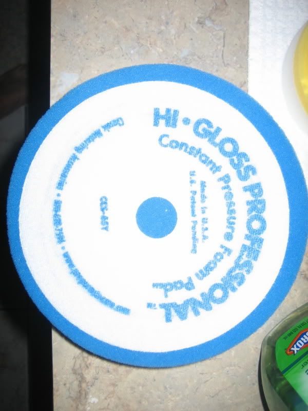

The CCS pad has the blue foam constant pressure layer and a white velcro with blue writing. It says CCS-65Y. This pad is probably only a couple of years old. I'll attach a pic of the back of the pad after I get my camera charged back up.
