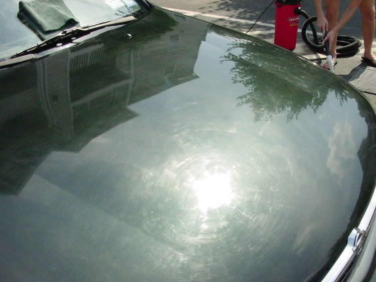

Onto the exterior. Well, there was pretty much no surface gloss due to the swirls or, shall we say scours? Here's what I was dealing with:

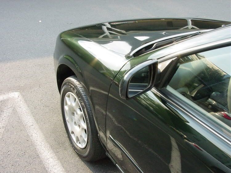

Thanks to Deanski, I had some abrasive stuff to work with, Menzerna Power Gloss and BOY DID I NEED THIS!! Thank you Dino :bow . Anyways, on the horizontal surfaces, I needed about 3 passes with a rotary @ 1900 rpm and a cutting pad to level it all out. Powergloss is the coolest polish ever! Most compounds I would get crazy marring/hazing with those speeds/pad. However, if I went a little slower on my last pass I would have been able to go to a LSP. This stuff breaks down very fine...All haise Menzerna :bow . Here is half fokked, half polished.
BTW: That pic is gonna be on my Detailing homepage pretty soon. My final processes were:

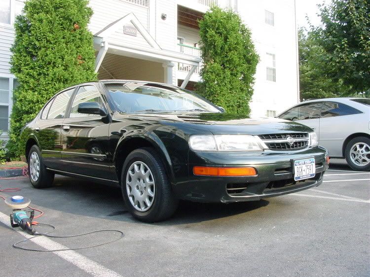

Afters
Too bad it needs a repaint on the front bumper/hubcaps, but the car is mechanically sound. Oh, and I saved the owner from getting a paintjob :D

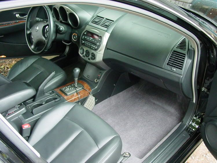

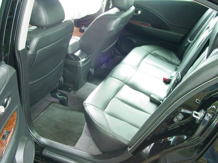

As promised, interior shots of the Altima Liz and I detailed. She did the entire interior, so this is all her work 1 day after detailing.
Enjoy!
