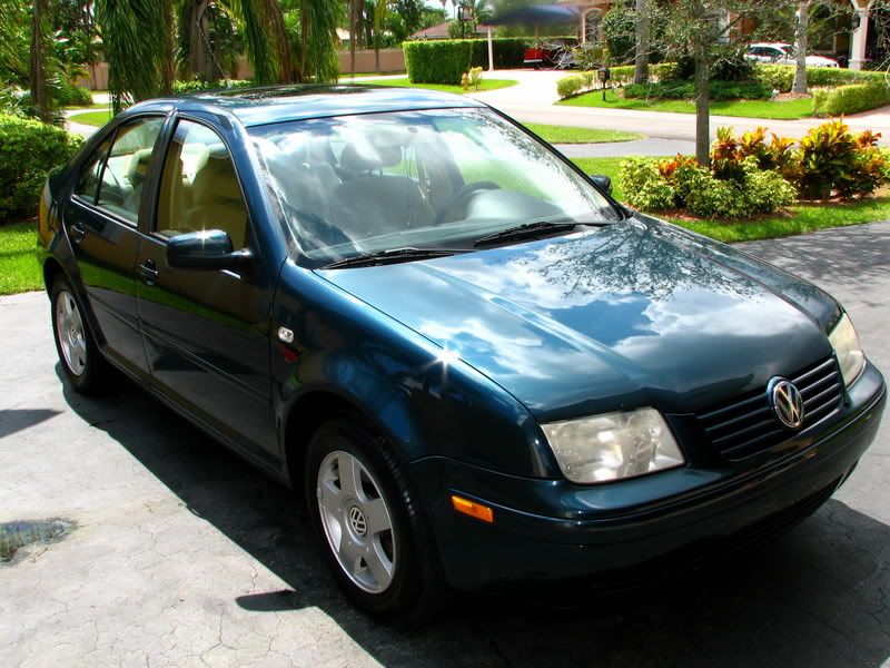

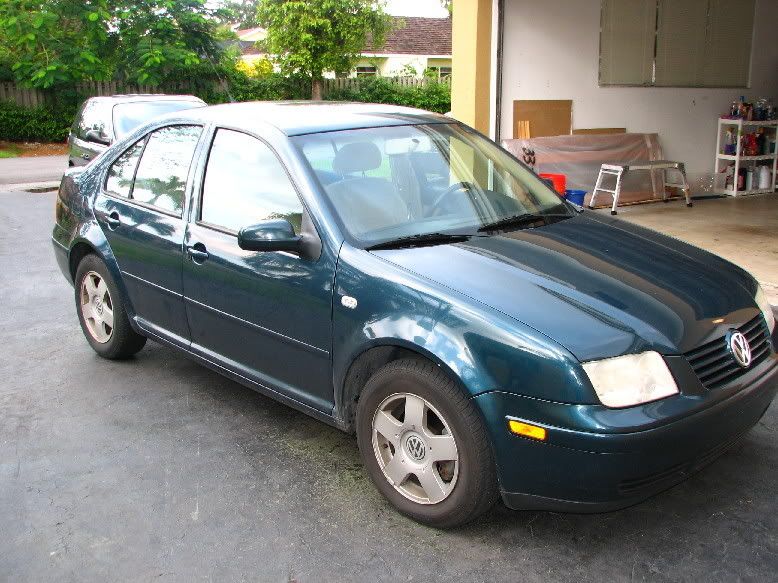

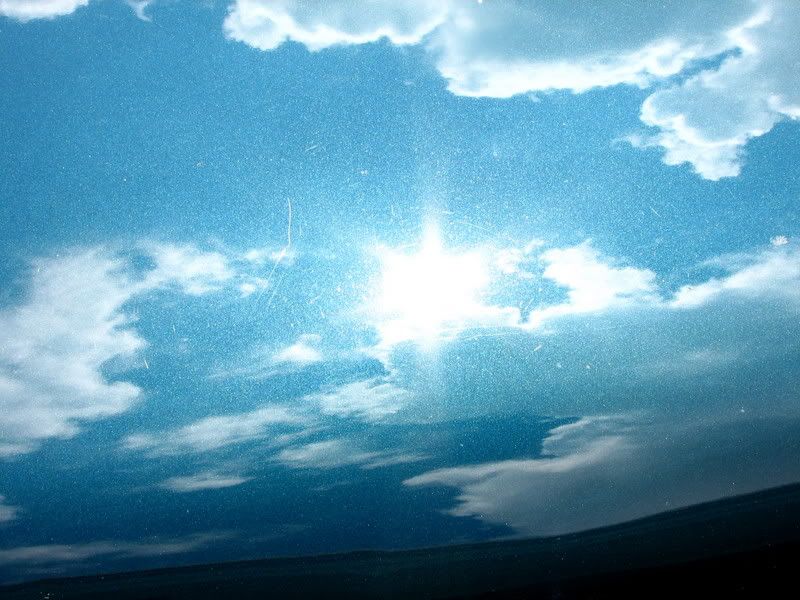

Co-worker needed her Jetta cleaned up but convinced her to get it detailed. The car was in horrible condition. Jags, cratches, scuffs, pitting GALORE. Surprisingly it wasn't at all that swirled. It had light rotory swirls most probably caused by a soft wool pad, but nothing major.
Since it did have a good amount of scratches EVERYWHERE I hit the car with,
Claymagic Red Bar
OHC via LC pad @ 1200-1500rpms
PO106ff via Finishing pad @ 1000-1500rpms
FK! Hi-Temp 1000P
Hyper Dressing 1:1

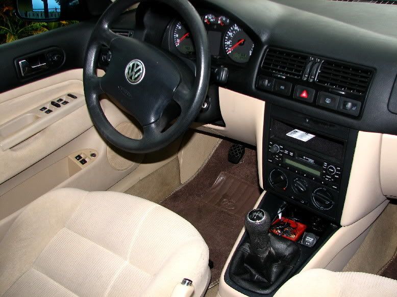

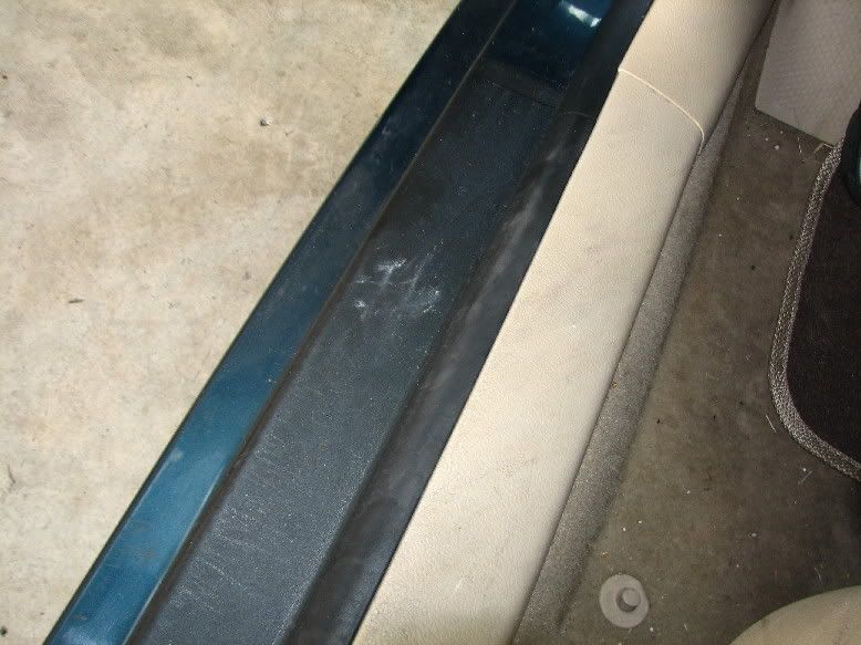

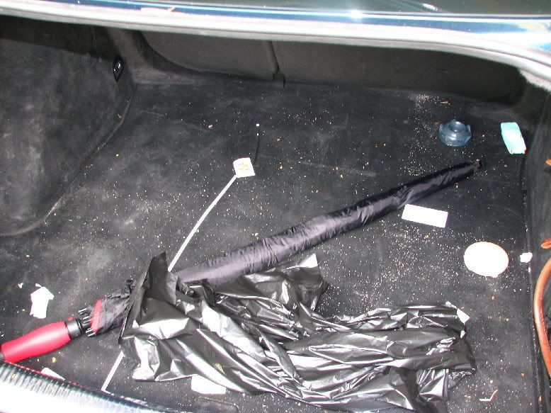

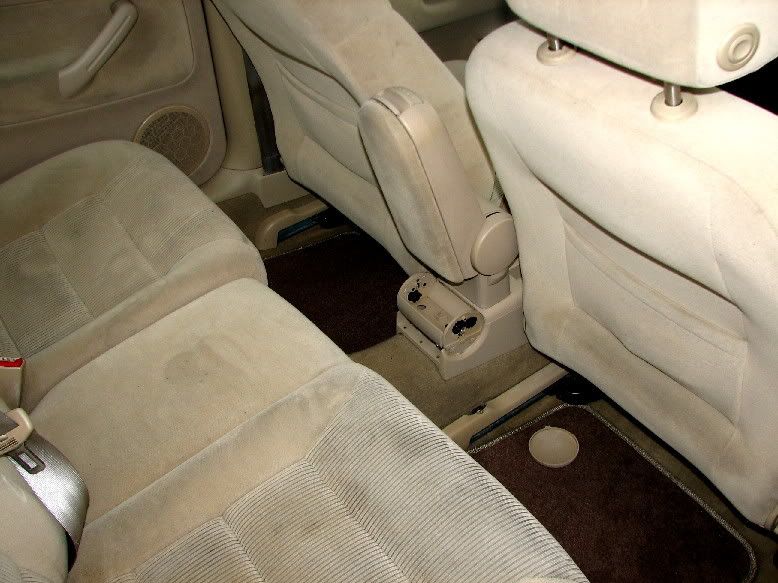

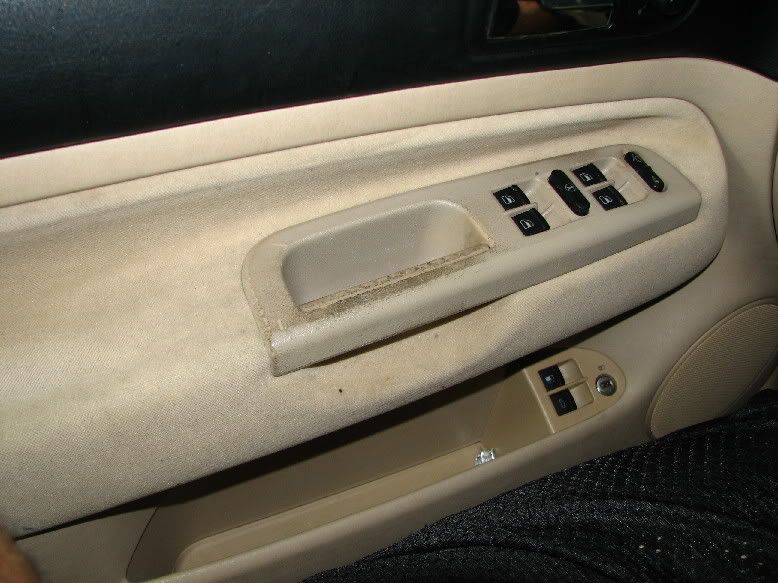

Interior was a mess. I think it was probably pissed in too, Im not sure. Show scuffs all over the place, small dirty prints, and debres everywhere
Entire interior received:
Tide Free and Clear (plastics, seats, and carpet)
Adams VRT (found this way in the back of the cabinet)

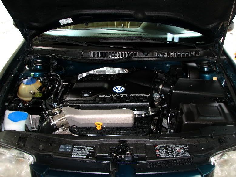

Engine was your regular dusty engine.
Degreased and dressed with Hyper Dressing 1:1
BEFORE

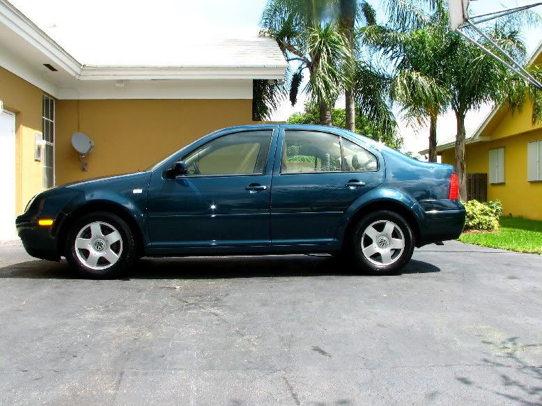

AFTER
That thing was nasty-how people could keep a car in that condition is beyond me. Very wet and flakey now. What do you think of the 1000P? Great work.
Application is a little above average. Looks are subjective but it looks pretty shiney to me.
People are claiming it can last well over 8months...
Whoa! I dont think I could drive a car around town with an interior like that. Great work Joy, I'm sure she was pretty excited about how the car looked after you did what you do.
