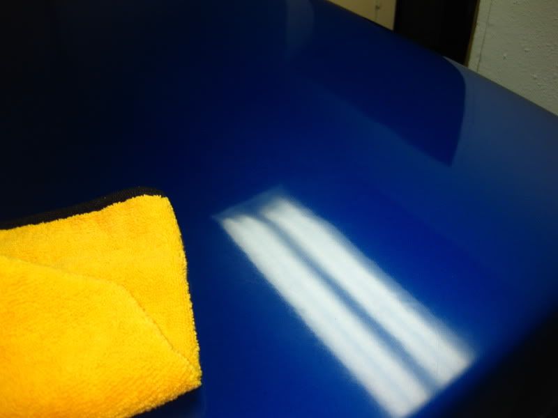

before:
after:
But today when I woke up, it was back to where it was in the beginning, it just has a smooth as glass finish.
What should i do? It looked great last night!

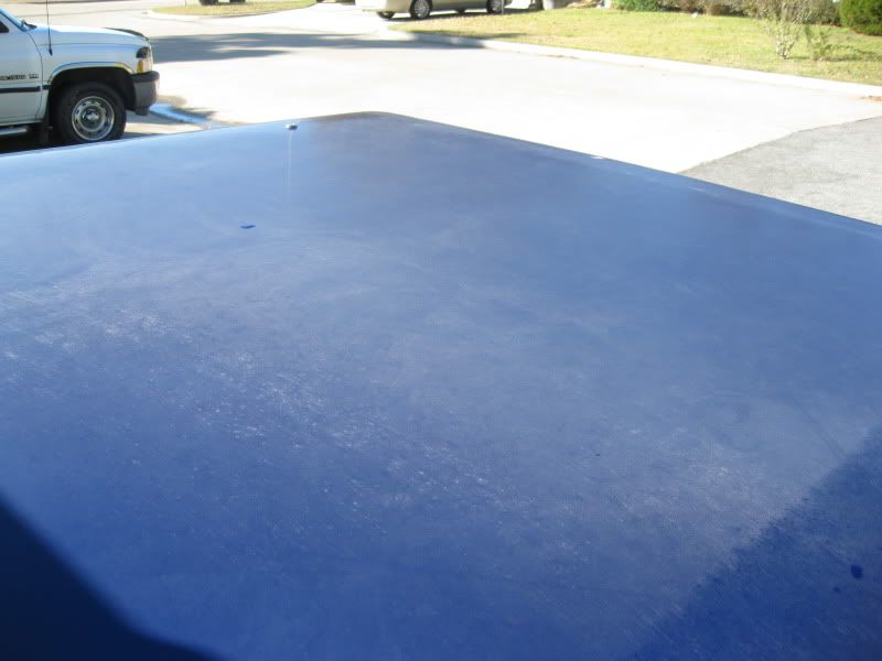

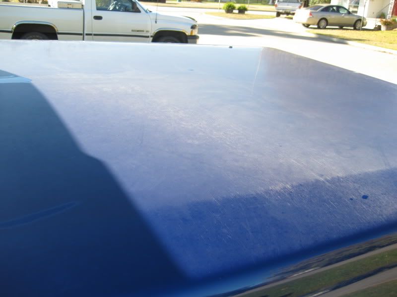

The paint is rough, those reflection shots are hazy cause the paint is physically rough (not flat like glass) the flatter the paint is the more clear the reflection will be.
The reason it looks so bad in the day light is due to more light hitting the roughness and refracting (light bouncing in many different direction) thus causing a hazy effect. In your garage at night there is very little light in play.
If the paint were physically flat the light would bounce in one direction giving a very clear and distinct reflection.

update:
I hit it with speed 6 last night (just did (2) 1x1 sections) and last night they looked great, this morning I wake up and they're back to looking like crap again. What the h?
