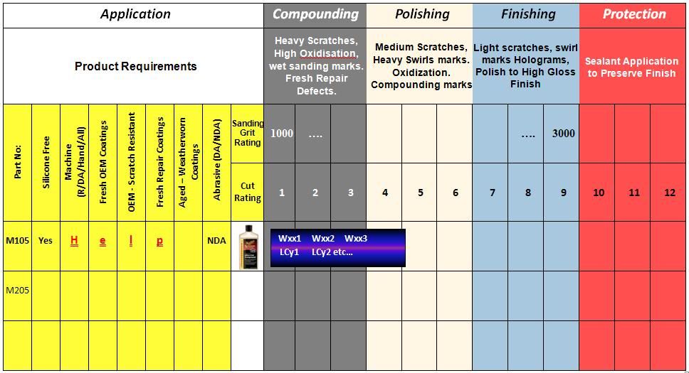

I am combing through ProperAutoCare.com and updated outdated information, such as our old comparison chart. Here is my idea for the new one, but please feel free to make any suggestions to make easier to read or understand.
Keep in mind that these types of charts are for reference only, as they do not take into account pad variations, machine types, and paint types. They are guide as to how the polish will work in relation to other polishes when applied similarly on most paints.

I see some differences in how polishes are rated, cut wise, but they are pretty similar. I rated the polishes based on my experience, and as such, some of them are a little higher or lower then what the product manufacturer recommends.
For example, Meguiar's rates M205 at a cut of 4. However, since it is a non-diminishing abrasive, it is really hard to rate. There is not cutting cycle; the longer it is applied for, the more it will cut.
Of course any suggestions on making it easier to read, or changes I could make, please feel free to share!!!

Hi Todd and everyone
I think Menzerna has got one of the best charts around, n yours too.;)
Here you go: http://www.carcareproducts.com.au/public_file/59
http://truthindetailing.com/Forum/showthread.php?t=1541&highlight=chart
Menzerna's approach to the chart is very concise yet very user-friendly and informative. The choice of colors play a significant part in differentiating the compounding, polishing, finishing etc...
I think you can use menzerna's, tweak and make the best.:-? The Other Chart - TID's own:-?
we could have something like different columns for product code, its specifities/characteristics, a picture too, (the name i've missed :doh: or may be represented by the code) its color and along the abrasiveness and sanding grit scale, we coud have the most popular and most used pads represented in the correct column.
This will help newbie like me greatly. I'm annexing somethin of the sort. Hope this will be useful to the whole TID family

Todd...just a question. Do you find using both compounds that M105 is stronger than Menz power gloss? I don't. To me, the Menz PG is the strongest stuff I have. It has taken out marks that the 105 could not.
