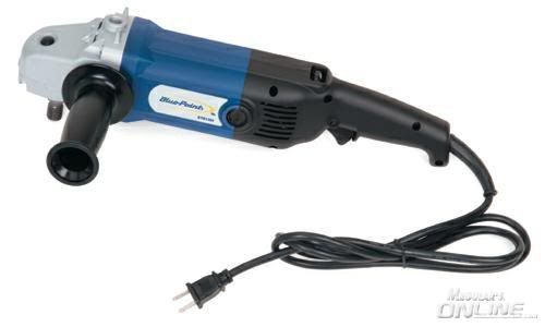

It is not the orbital. I am not sure it is a DA or rotary. It does spin fairly higher rpm's. Sorry for the lack of info I am at work and the buffer is at home. Thanks again for the help.
I have been using this rotary for the last 8 years. It has worked well just the old pads I was using are not available anymore and the new 3m waffle pads were causing the dry buff marks.
How long are you working a section? What color are the 3M pads? What RPM's are you working at, how fast are you moving the polisher (arm speed).
Foam pads can heat up fast and too much heat will cause the polish to flash.
You may want to look into a different polish as well.
I like no faster than 1800. Foam pads are like a blackish grey color. I try to use very little pressure and I do move back and forth fairly quickly. I am going to stop using the Meguirs polish all together except the #26 wax. I want to try this Presta SR or the Blue Coral velvet cut I have with the white finishing pad.
Ok, that's their finishing pad used with the perfect-it foam pad glaze. Try bumping down the RPM's to 1000-1200 and see if that helps too.
