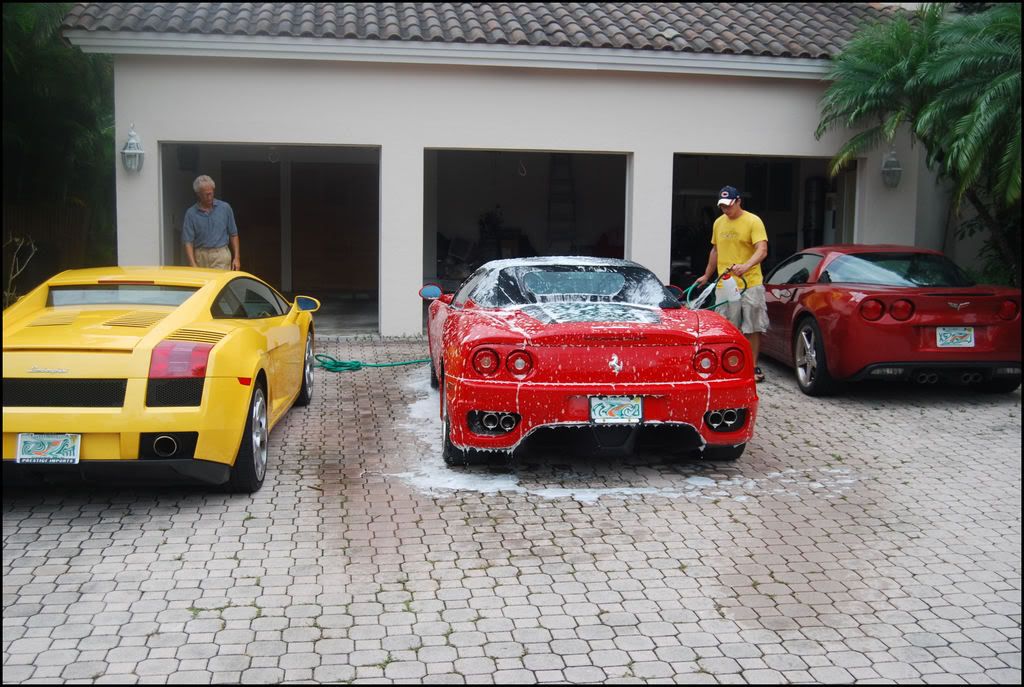

The trip started early (4:30 AM) for me, but earlier for Brian (2:30 AM, to drive to Orlando). We made a trip to Miami for four cars on the first day (luckily only two corrections).
Because we where pressed for time the entire time, we where not able to document a lot of the details, but more or less snapped pictures as time allows. As such, I will recap the major details that I can remember about the details, as it was a LONG weekend.

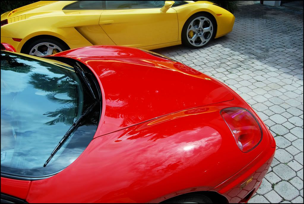

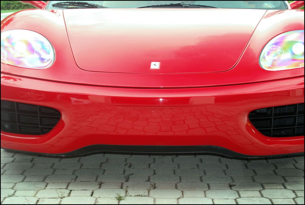

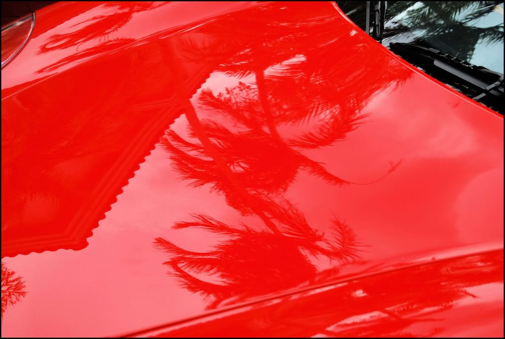

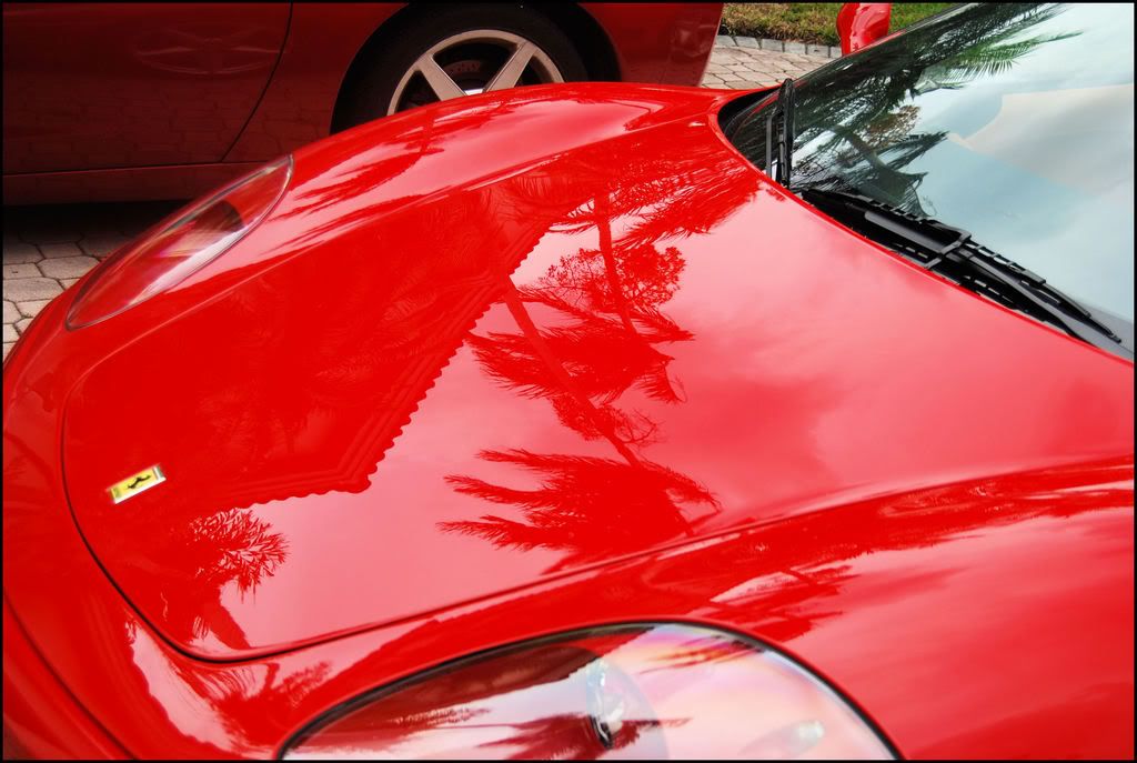

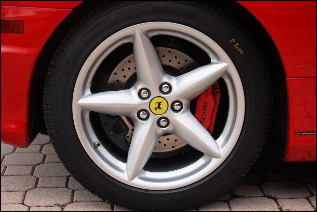

Ferrari 360 Spider.
Wash with Megs Hyperwash
Clay with Zaino Z18
Polish with a combination of Menzerna (SIP and IP), OP, and 3M Ultra Fina. Also certain scratches on the Euro style rear plate required 3M Extra Cut and a LC Purple Wool. The leveling power was great and Brian and I where able to remove some very serious defects safely.
Rewash with Zaino Z7
Two coats of DeepFinish Deep SWAX
Zaino Z8 final wipe
Zaino AIO on rims, glass
Zaino Z16 on tires
DeepFinish Deep Chrome on Tubi Exhaust
other stuff :D
Pics

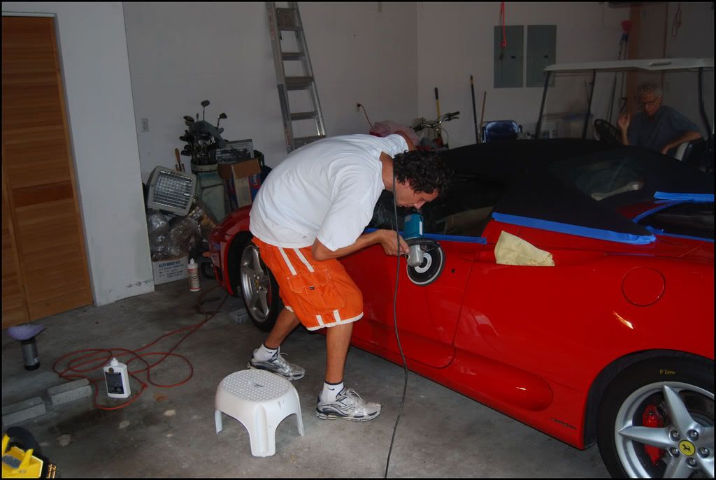

VA(Brian) working OP with a 3M finishing pad at low RPM's to jewel the surface. The paint had a lot of swirling and scratches that where removed. Time didn't allow us to document, but the turn around was stunning.

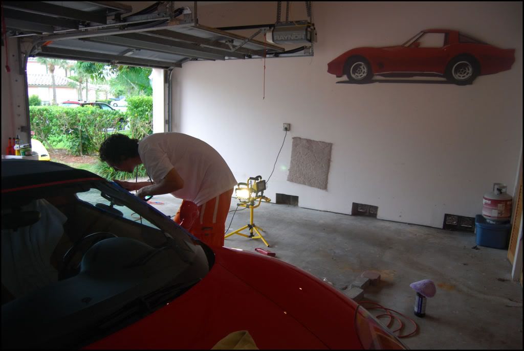

Polishing under the halogen...
Finish perfected!
Yours truely removing defects by way of LC purple wool and 3M Extra Cut with quite a few RPM thrown in!
We pulled the car outside to check in the sun, but there was none to be found ( a common theme for the entire 4 day trip). However, the reflections where crisp and the paint was glowing before any LSP.
Using the foam gun to lather on Zaino Z7 after polishing...

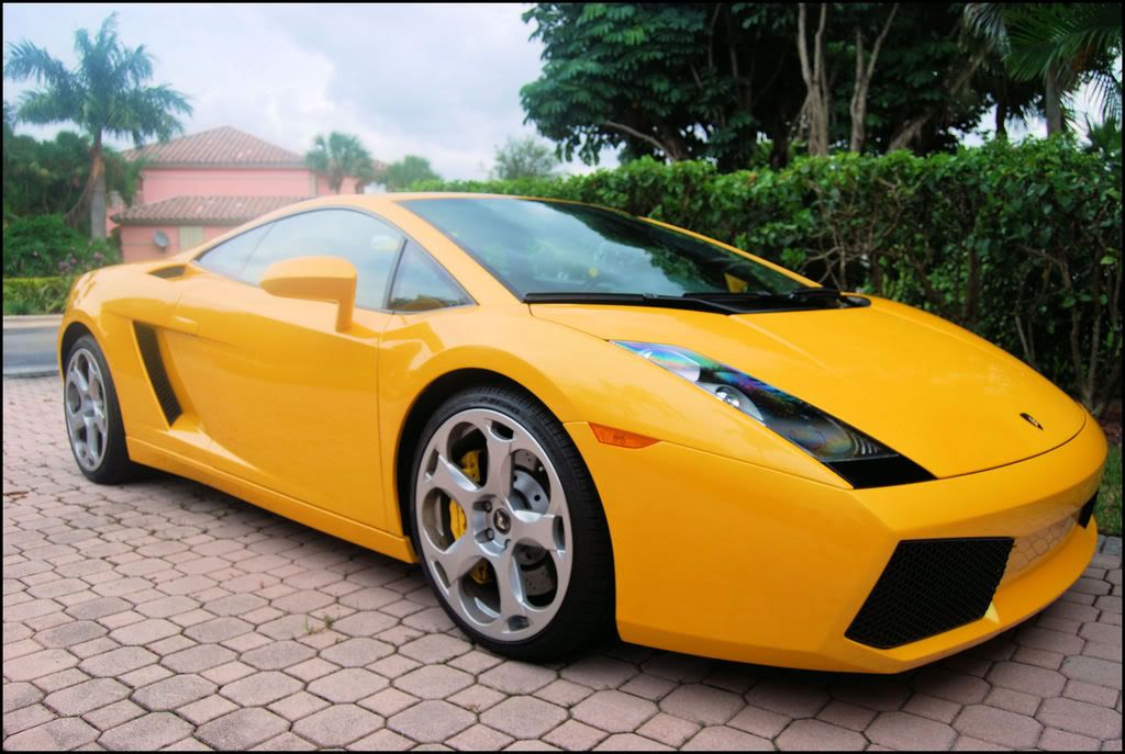

The owner's other baby, which recieved a Z7 wash and Z8 wipedown (the full correction will have to wait until next month on the Lambo)...
I had orginally planned a multi coat Zaino LSP package for the Ferrari, but time was short so I settled on two very quick coats of DeepFinish Deep SWAX. The paint took on a very nice glow.
Brian inspecting the finish while I was goofing off (taking pictures)!
Now that's a DEEP finish :P

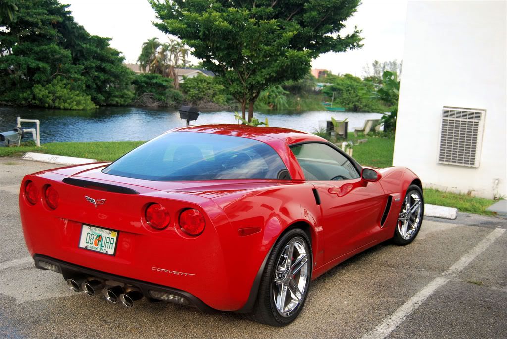

Next was a 30 minute trip to North Miami Beach for a detail on a previous customer. '08 Z06....
ONR Wash with a Z6 wipe down...
2 coats of Z5pro
Z8 final wipe
DeepFinish Deep Chrome on rims and exhaust
Z16 on tires...
Famous Zaino glow (the paint is blinging :D )

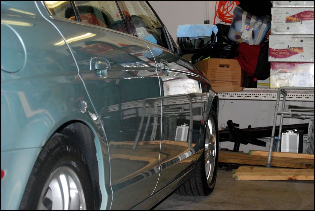

After we finished up it was down to south Florida for a forum member's Jag S-Type.
Clay with Z18
Polish with SIP on a white pad
Zaino AIO on a blue pad
Z2pro
Z16 on tires
Z-AIO on rims, glass, ect..
It was very dark at this point so we couldn't take a lot of photos!

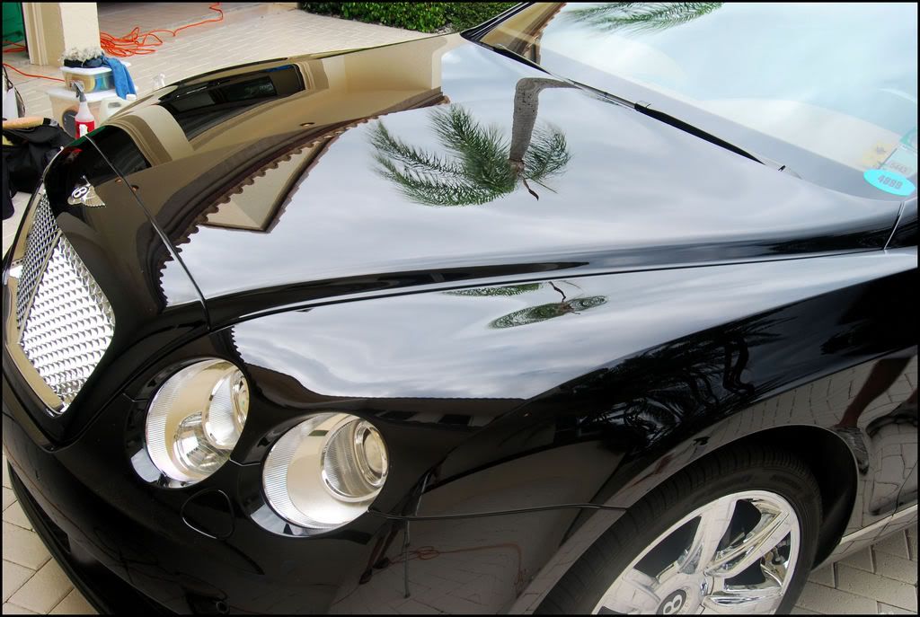

Day one complete on to day two which started in Boca Raton with a Bentley Flying Spur exterior and a new Bentley Azure interior detail.

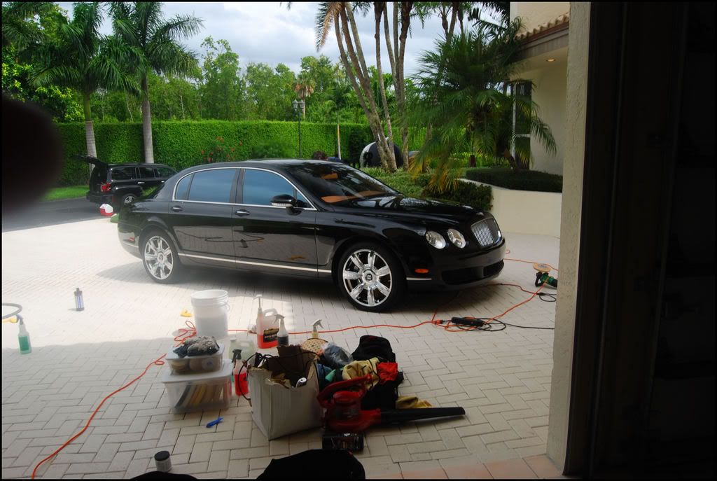

Flying Spur...
Wash with Meg's Hyperwash
Clay with Z18
Polish with 3M Extra Cut, LC purple wool/ Menzerna SIP, LC Orange/ Menzerna 106ff, LC White Pad
Z7 Wash
Z5 pro x 2, Z2 pro
Z8 Final Wipe
Z16 on tires
ZAIO on rims
DeepFinish on Exhaust

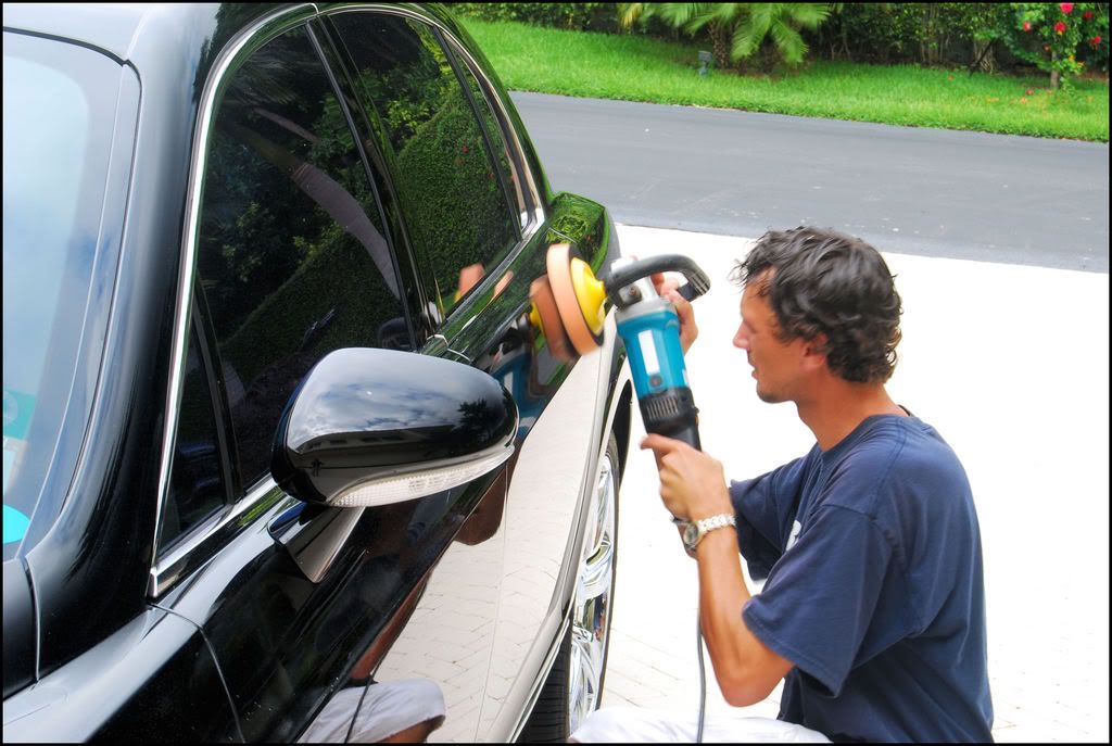

Brian spinning the wheel on the Bentely...

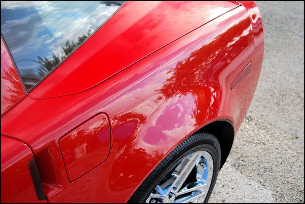

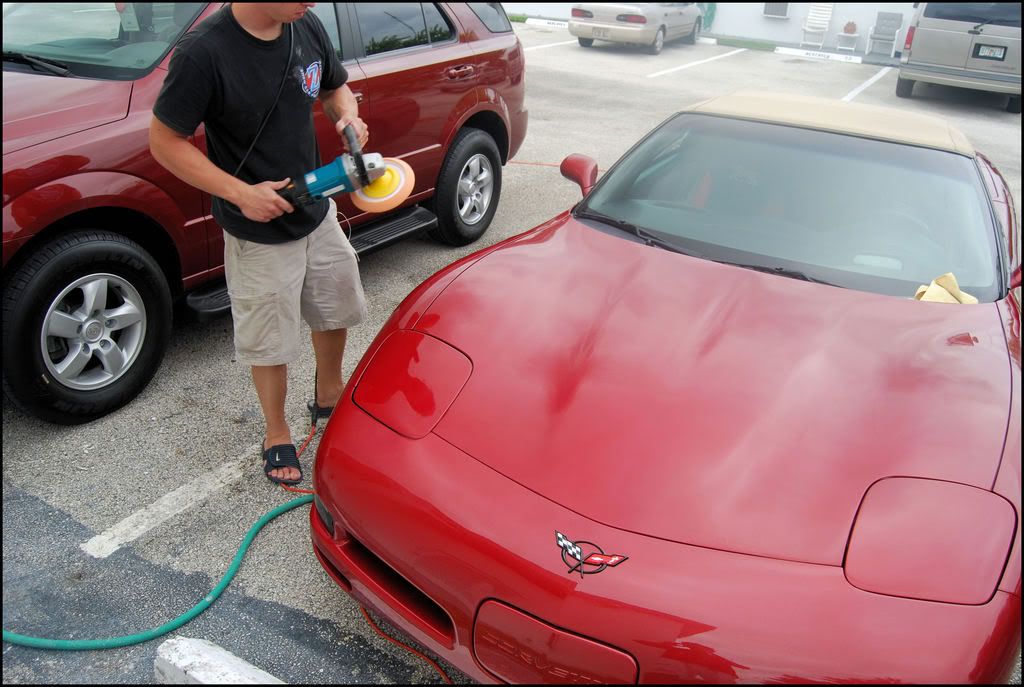

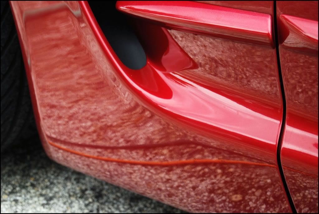

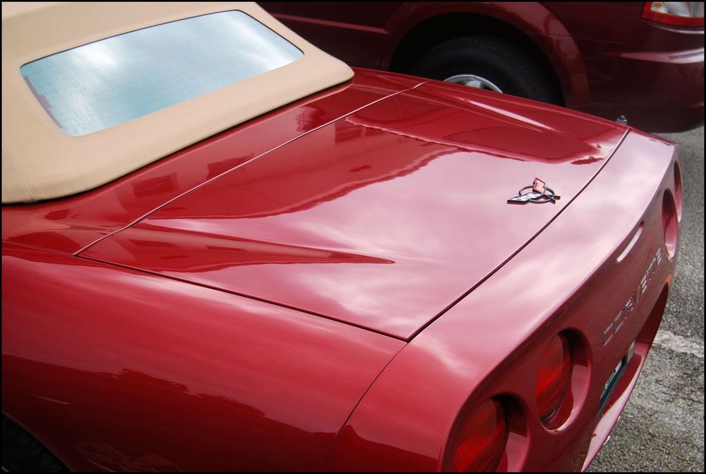

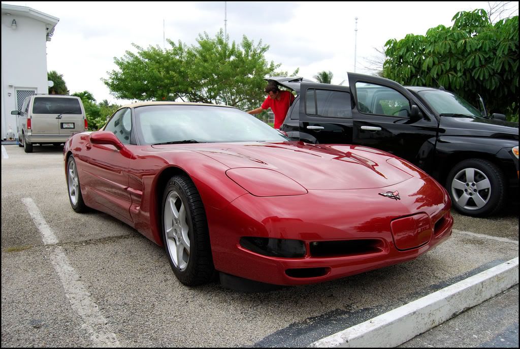

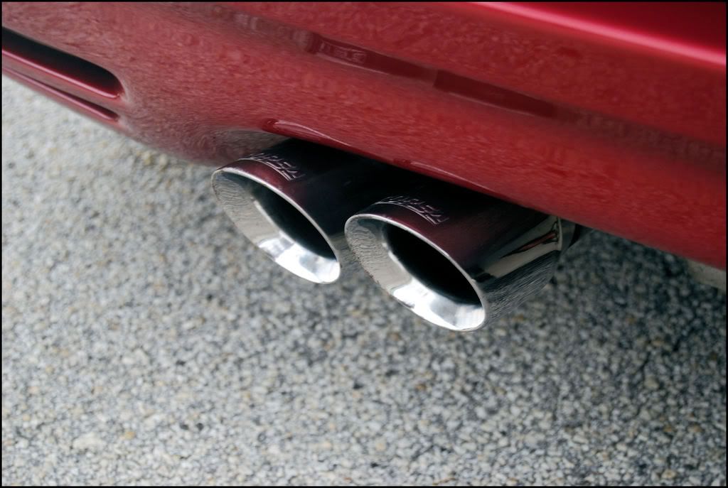

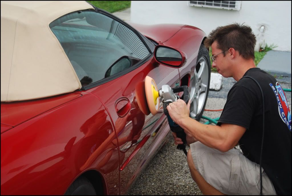

Day three was very simple and went smoothly with a couple of Corvette details. Of course, we only took pictures on one, lol...
A full C5 correction
Clay wit Z18
Polish with 3M Extra Cut on LC purple wool, Menz SIP on Orange, OP on White
ZAIO with blue pad
3 coats of Z5pro
Z16 on tires
ZAIO on rims
Deep Finish Deep Chrome on exhaust

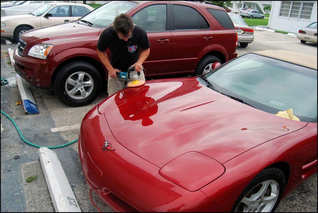

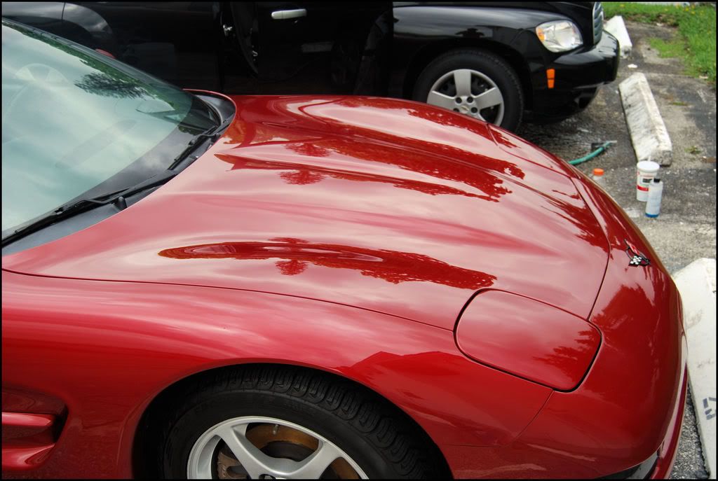

The paint was very FLAT and dull before getting started... Here I am inspecting it...
Here is the car after making one pass of SIP/Orange across the hood and fender... Much glossier (though some deep defects remained, so the car had to be repolished with 3M and wool before being brought back..)
Yours truly peforming surgy by way of rotary...
After AIO...
Full Zaino bling...

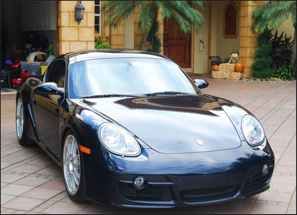

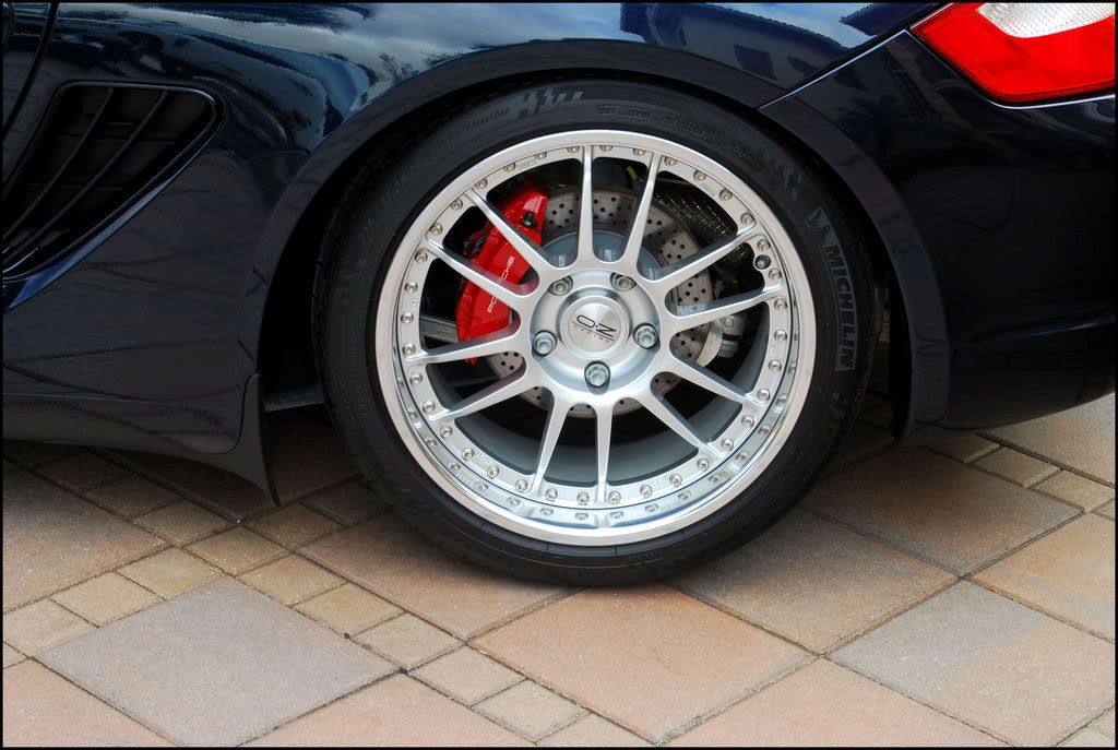

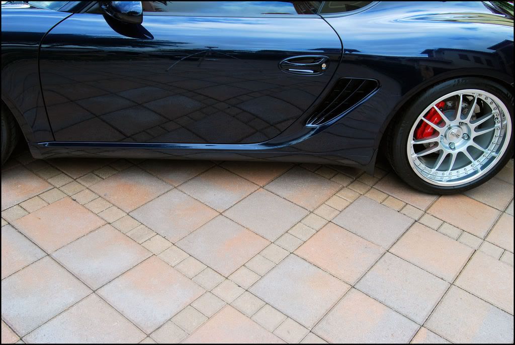

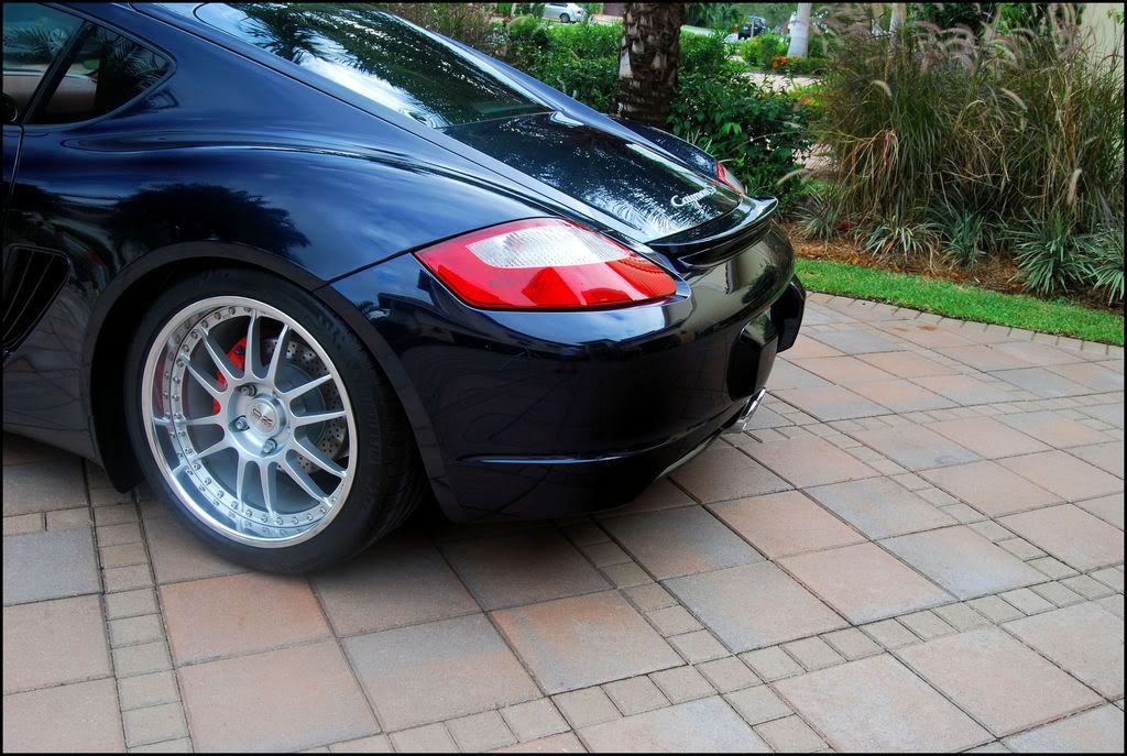

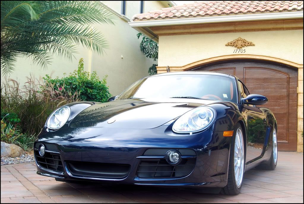

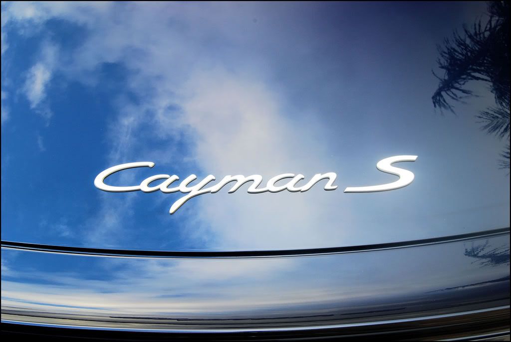

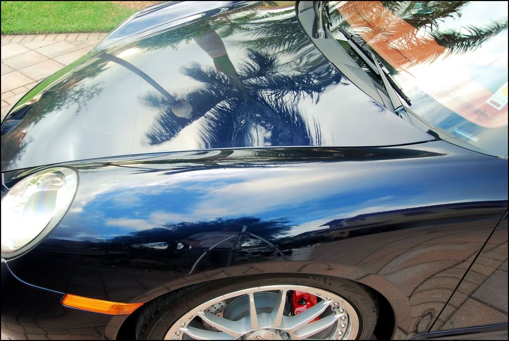

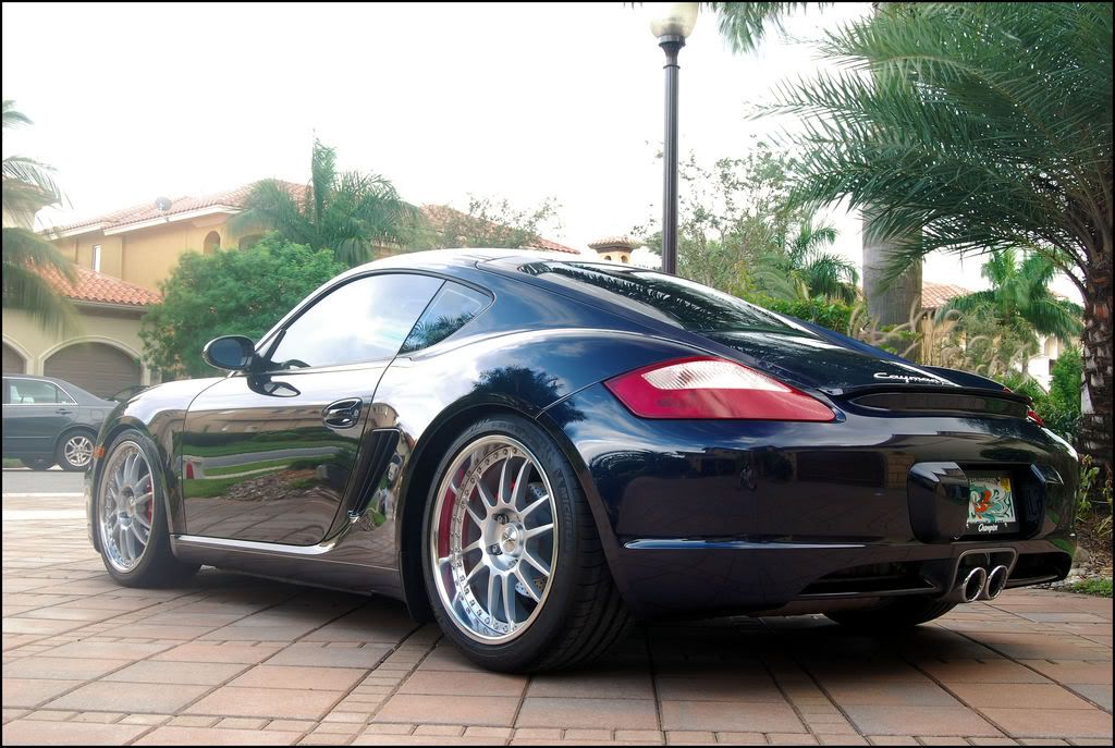

Porsche Cayman S
Wash with Z7
Clay with Z18
Polish with SIP/Orange x 2, OP/White
Z7 Wash
DeepFinish Deep SWAX x 2
Tropical Detailing 7 Step Rim package (ask Brian, I was giving a quote, but the results where stunning!)
Z10 on interior
Z16 on tires

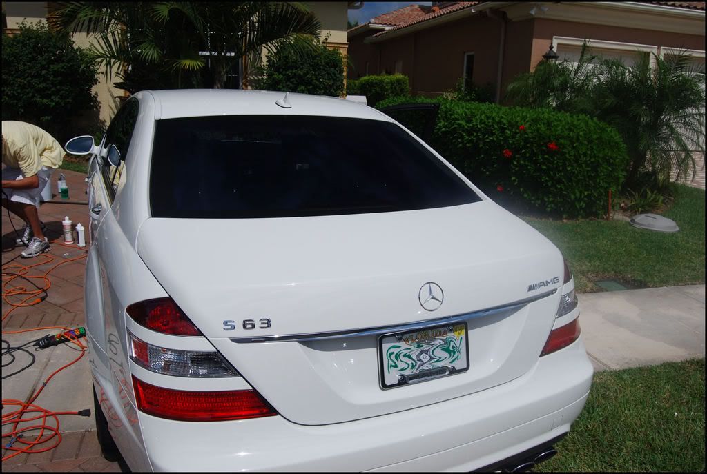

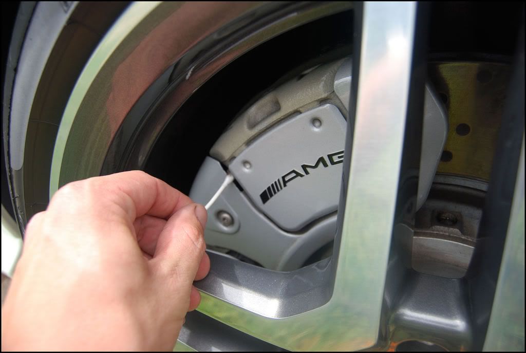

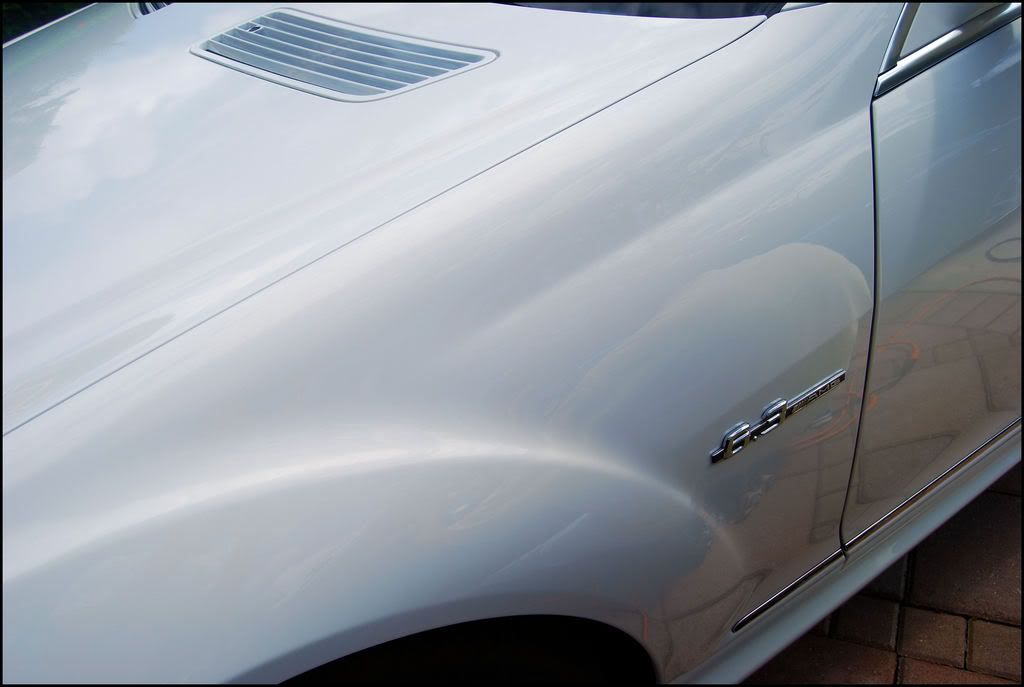

MB AMG S63
Wash with Z7
Clay with Z18
Polish (scratches) 3M Extra Cut orange/ Zaino Z-PC on White
Zaino Z8 wipe (and on interior piano black surfaces).
Tropical Detailing 7 Step Wheel package (Brian's not sharing)
Z16 on tires
Leatherquie on interior

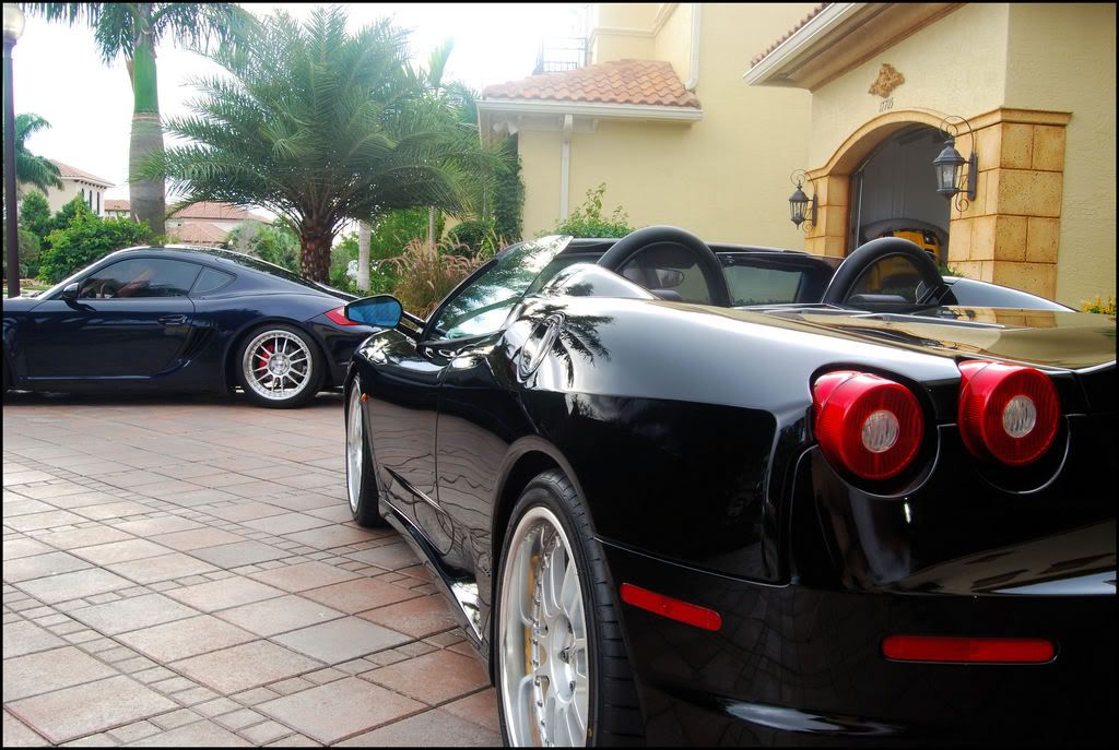

Ferrari F430 Spider (previously detailed with Bryan/GMblack3a and myself, just a touch up)
Wash with Z7
Spot polish with SIP/106ff to remove some scratches from the track
2 coats of Z5pro
Z8 wipe down
Z16 on tires

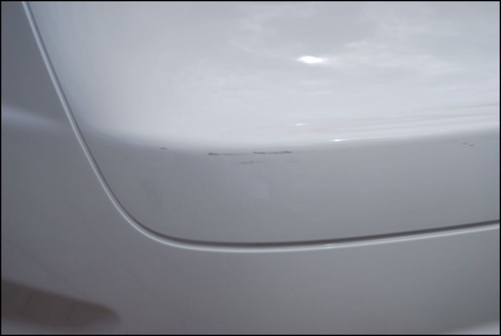

SIP on white, testing the lower panels on the Porsche

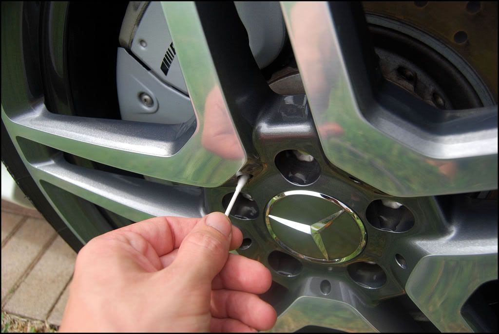

Scatches on the AMG
Gone
Qtips :P
The only real "after pic" of the AMG. The owner had to leave so I was unable to get more (I will though :D) Brian finishing up the Porsche...
Almost done (glossy and blinging)
Afters (none of the AMG :()
