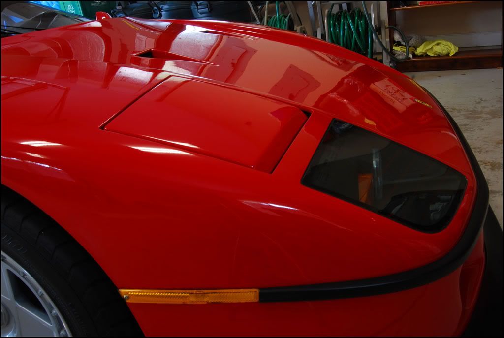

Even though car only required very light polishing (the paint was soft and VERY thing, with the kevlar weave apparent in certain areas), the paint cleaned up very nicely, knocking out 90 percent of the swirls with a Z-PC and a portercable! And even then, only about 50 percent of the body had swirl marks, so the polishing portion took less then 45 minutes! The rest of the detail (over two days) was cleaning and detailing every nook and cranny and making sure the car was ready for the Winter Park Concours show.

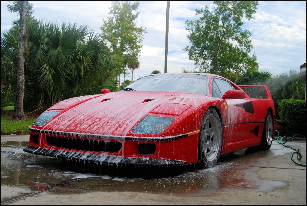

Wash with Zaino Z7 and foam gun

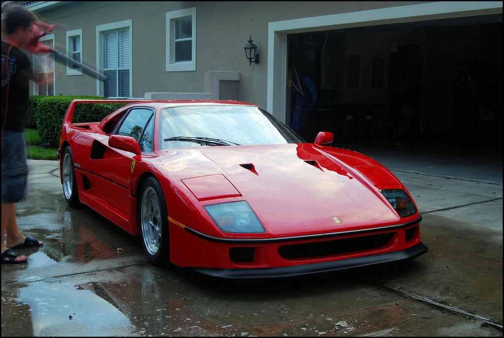

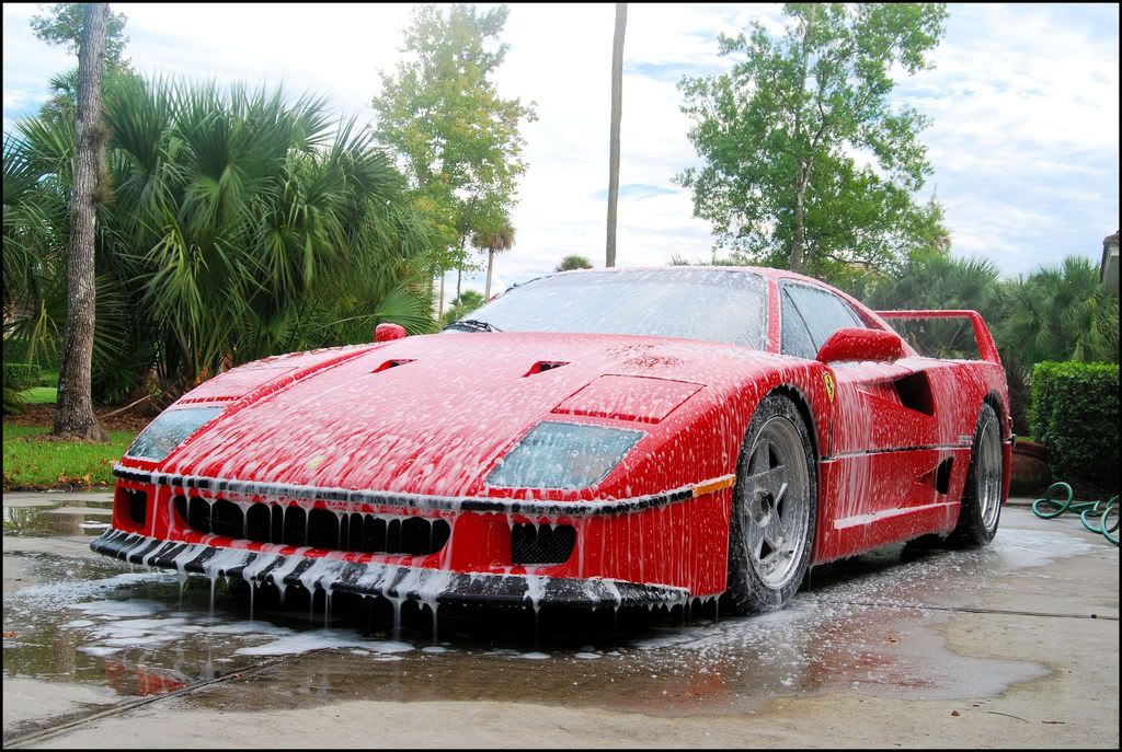

The Z7 was allowed to dwell for 5 minutes...
After rinsing and sheeting the water off, the car was dried with a highspeed leaf blower to remove water from the various areas...

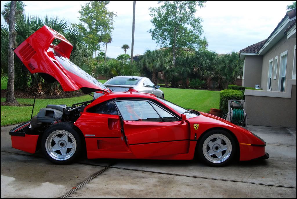

You can see how low the F40 really is...

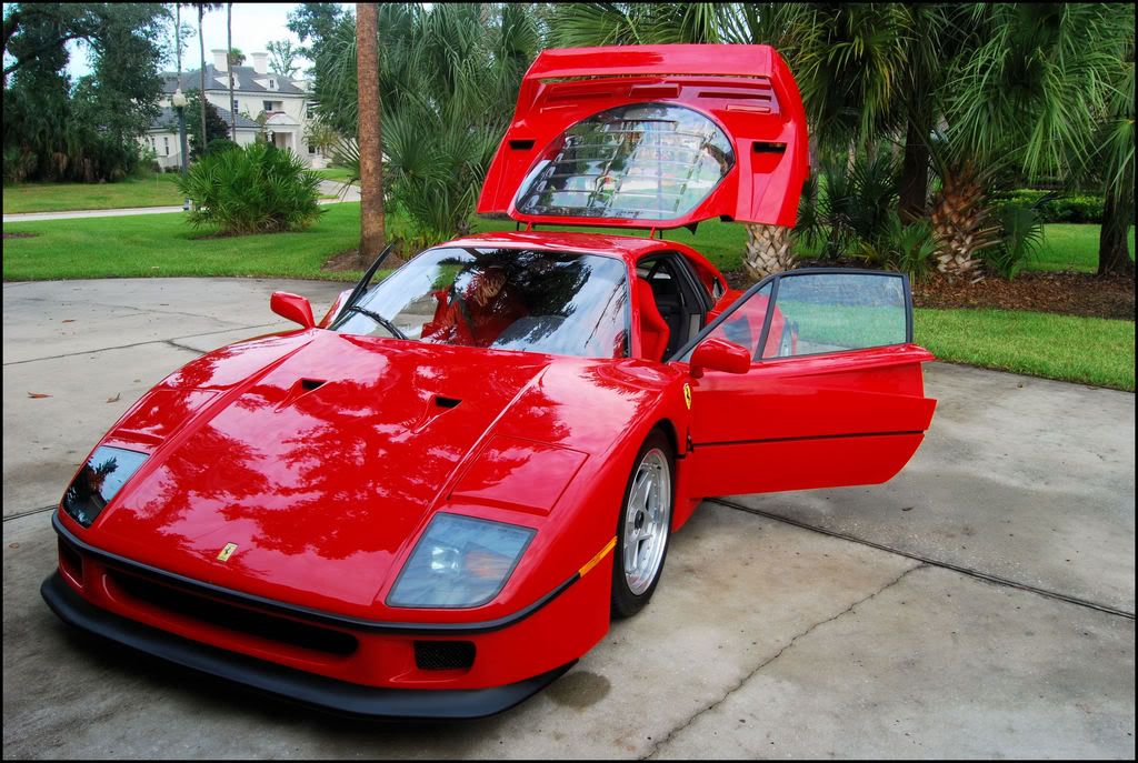

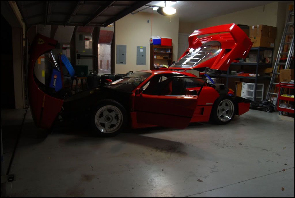

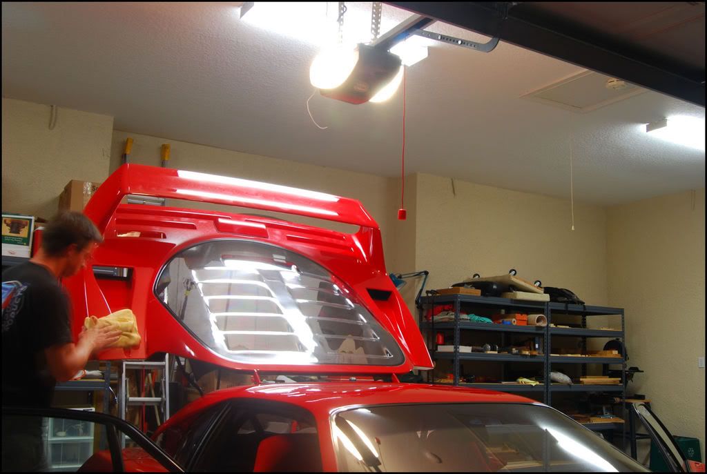

Opened up and getting detailed to the wee hours of the morning...

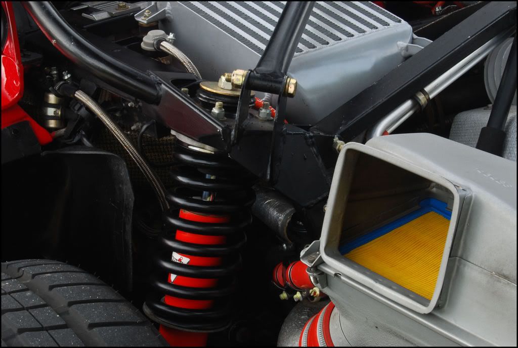

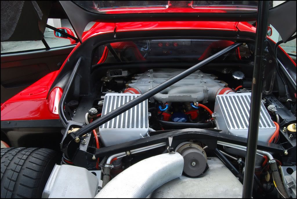

Many hours where spent detailing the engine, suspension, trunk, ect...

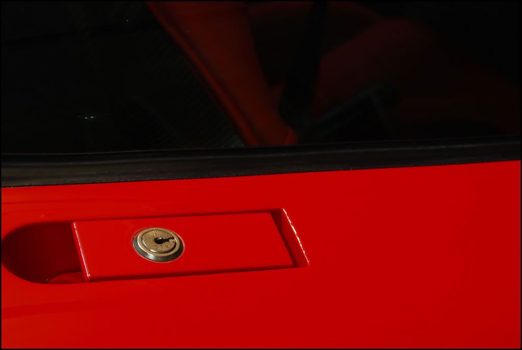

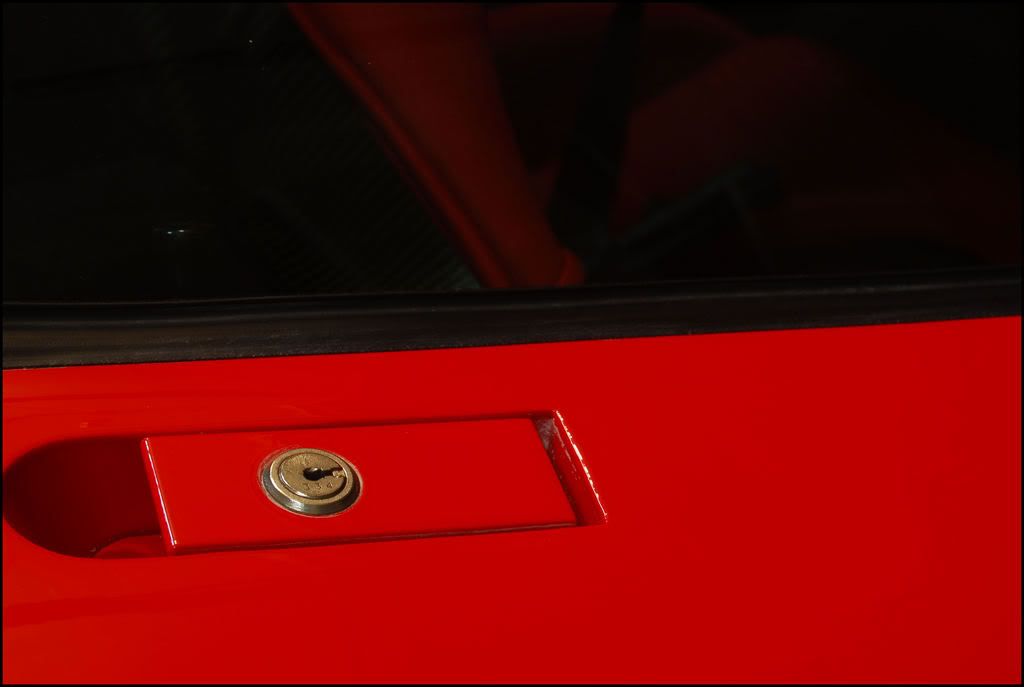

I am really enjoying the show car aspect of detailing (focusing less on paint correct, though that is still vital, but finding the dirty areas and making them perfect). One of the things I have realized is that you are never done. Sometimes you have to take the car to a very high level to see the little things that need work. Here, some compound residue from a previous detailer was sticking out like a sore thumb in the door handle.
Much better (megs APC and qtips)

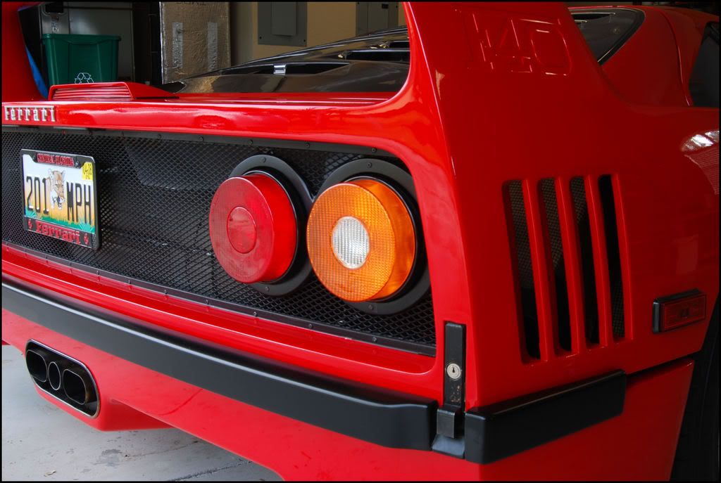

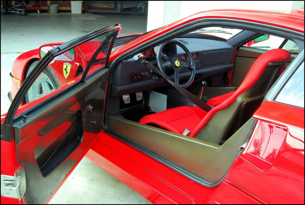

The second day of detailing consisted of more of the same, with an additonal layer of SWAX, and more q-tipping and tire/rim/wheel/suspension/brakes/ect detailing :D

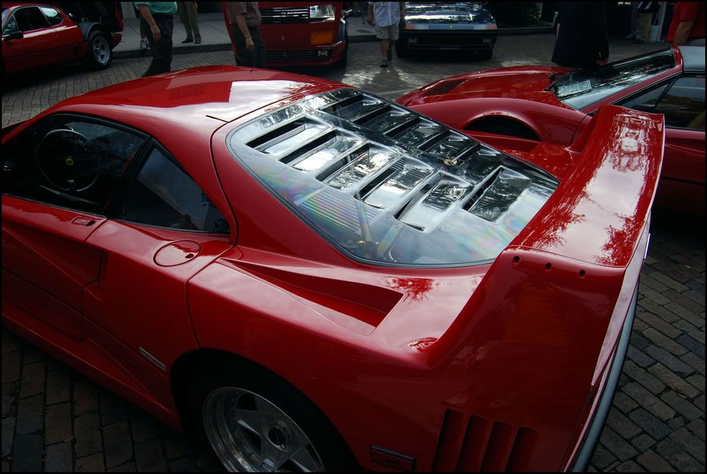

About 3 hours where spent cleaning each vent (this car has a lot of them) and dressing them with the correct products)...

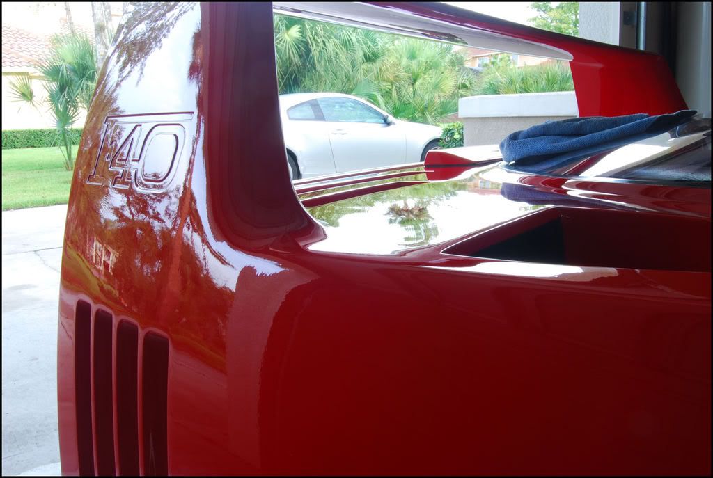

Outside with the third coat of SWAX applied...
Ready for the show!!!

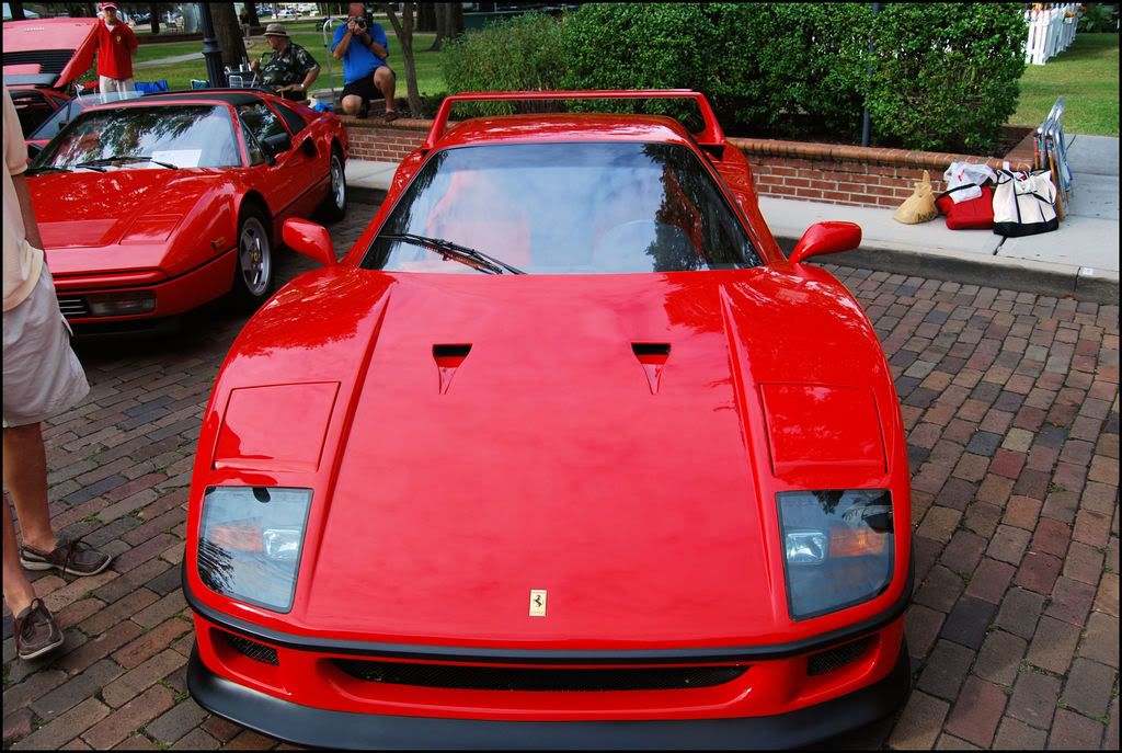

Here are two of the several cars I had at the show (the BBi is on the left with the front cover open and the F40 is on the right with the same open)...

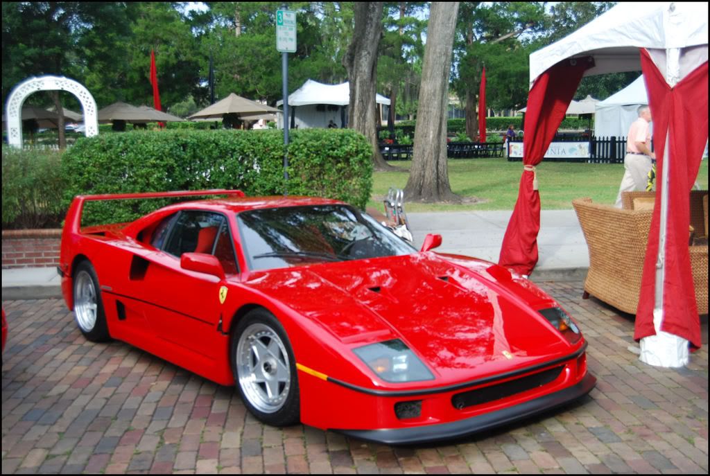

During judging, the F40 started on the first try and passed all the tests :D
Sun shot (kinda, it was so over cast yesterday that I was very bummed out)
