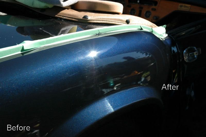

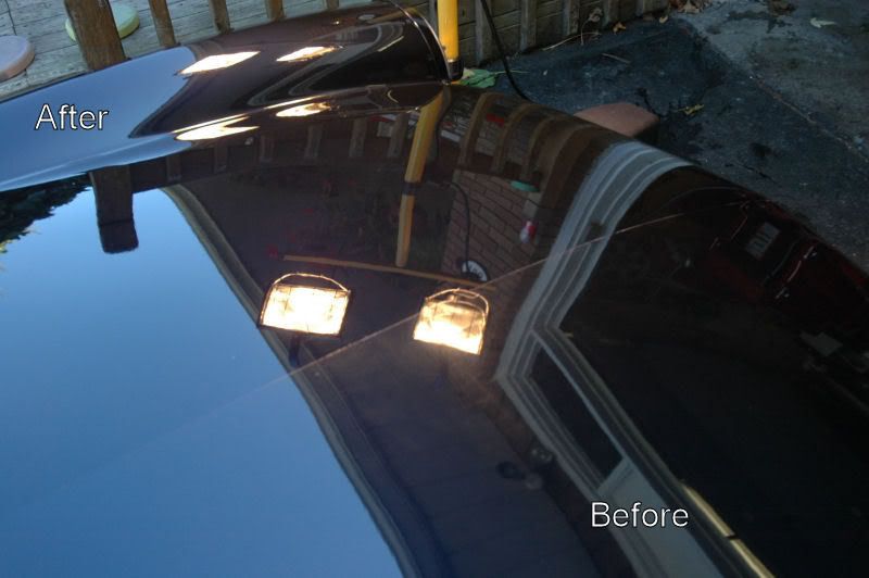

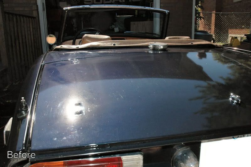

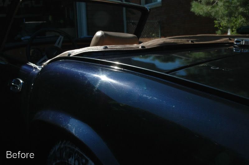

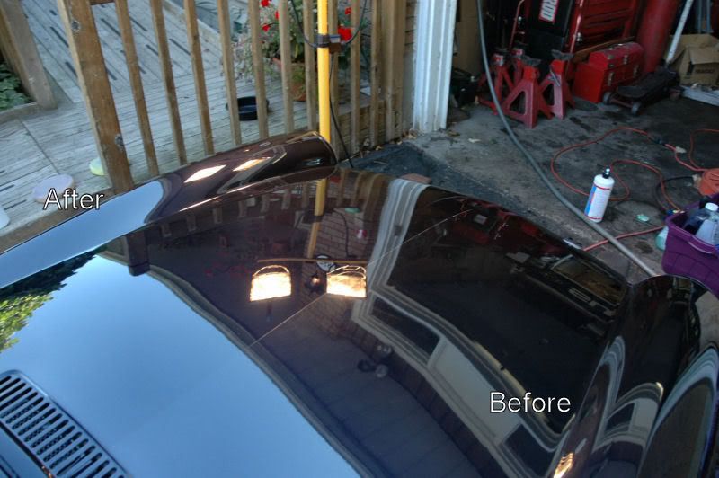

This was just polish and seal, so no heavy compounding.
Process:
PG via PC/Yellow Speed 6 (only on hood)
PO106FF via PC/Orange Speed 6
PoliSeal via PC/Black Speed 4

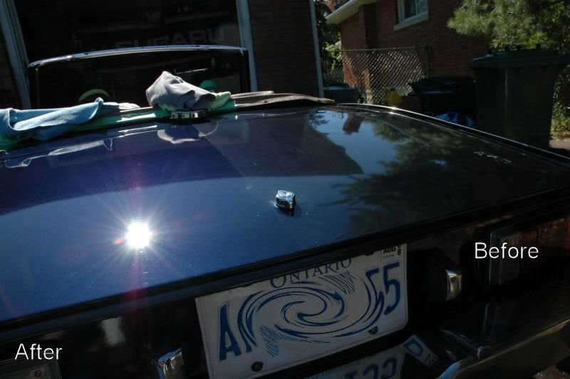

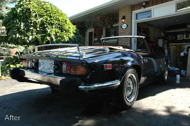

Awesome, I like seeing those side-by-side pictures where one side is all hazy and swirley, and then all of a sudden, you can see clearly now. Although, I still see some swirling...of the license plate, hehe. :)
I tried to buff the license plate and it just melted it.
