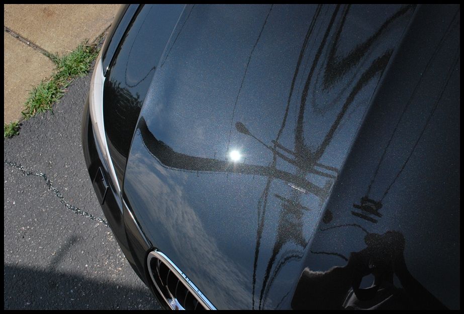

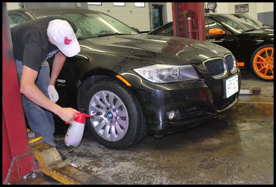

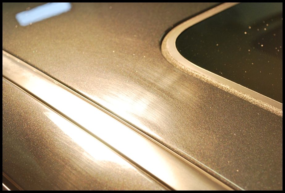

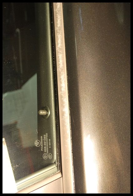

Once the car was washed, all tires & wheels well cleaned and the paint was stripped free of all previous waxes or sealants from the body shop, it was time to give the car a claybar treatment to remove any overspray before the polishing process.

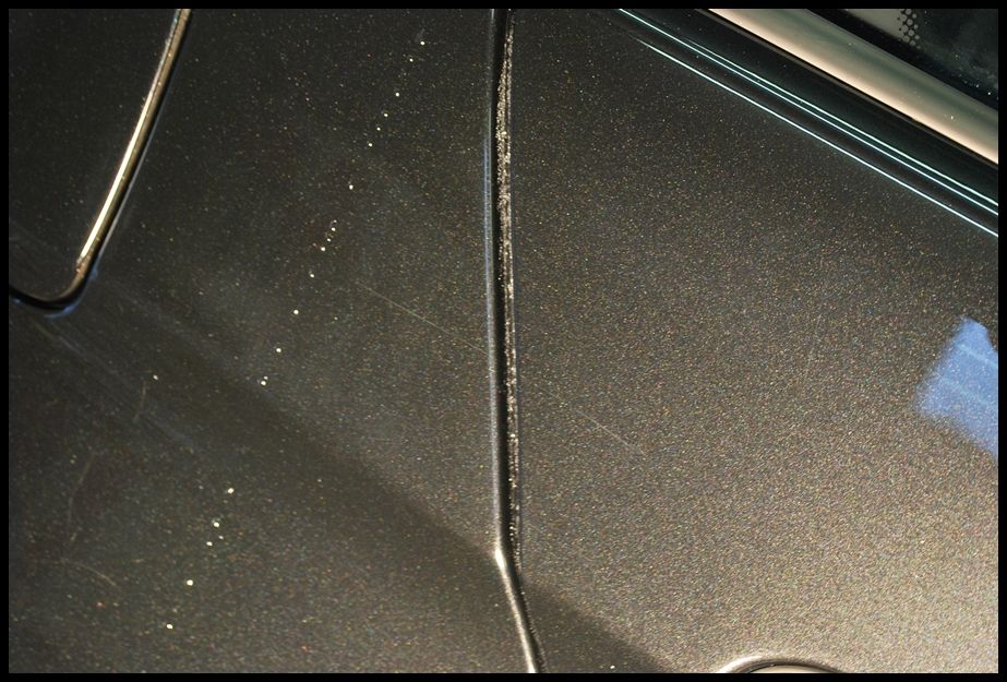

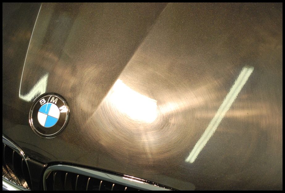

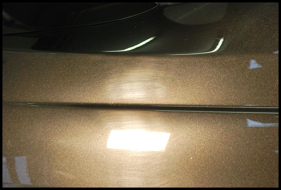

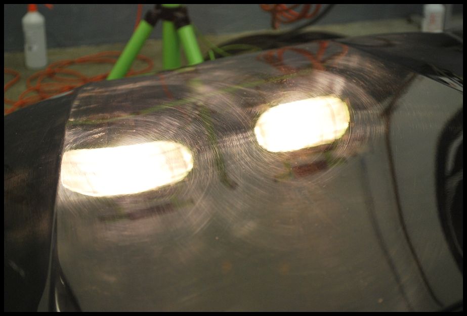

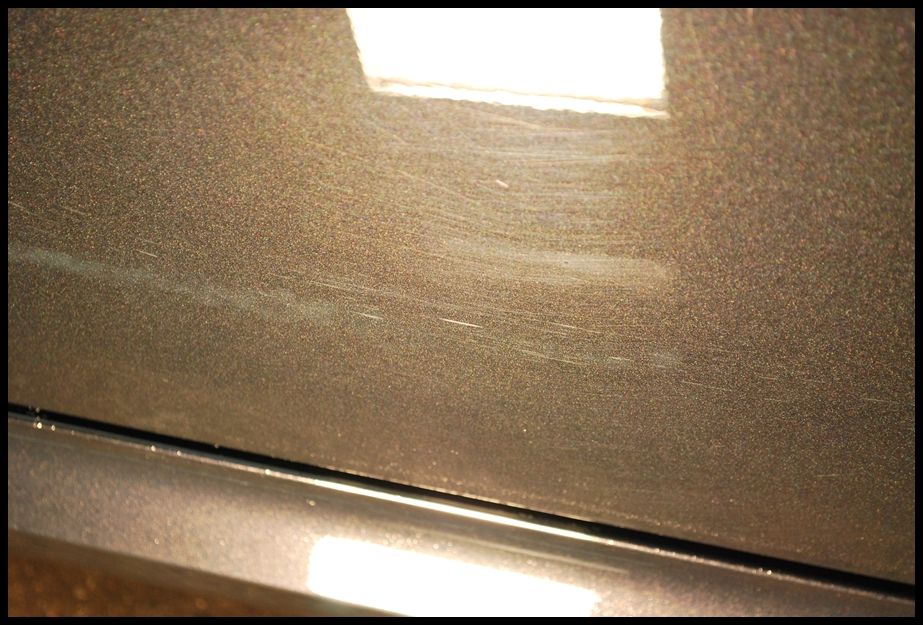

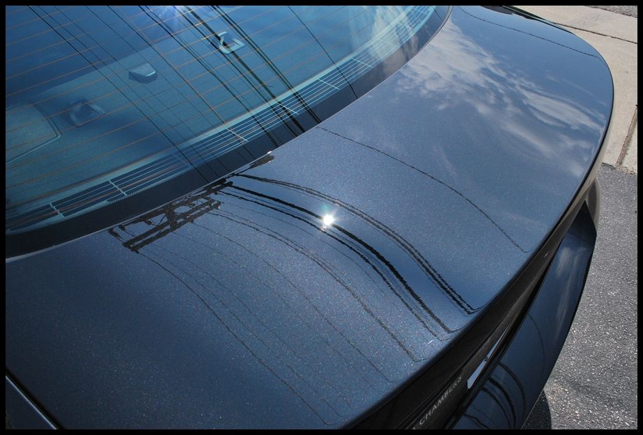

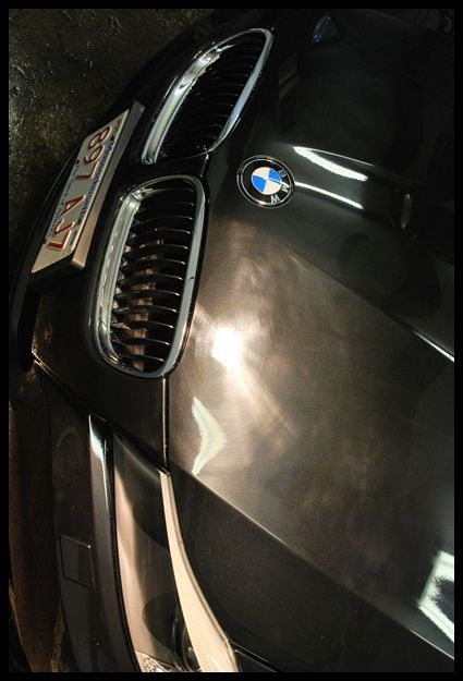

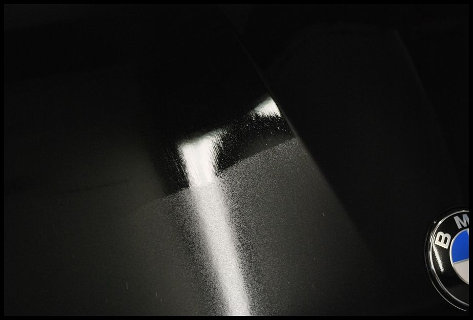

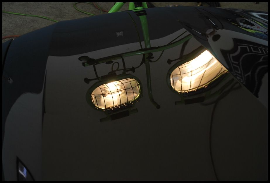

The hood had the most overspray, which you can see in the picture below…

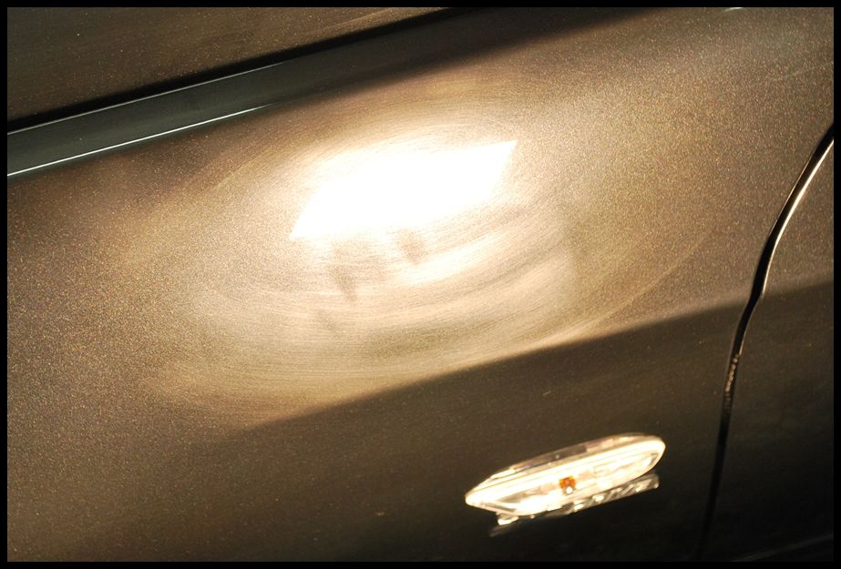

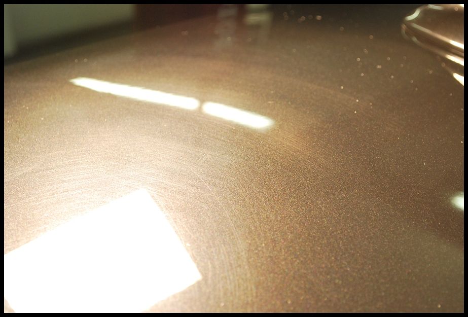

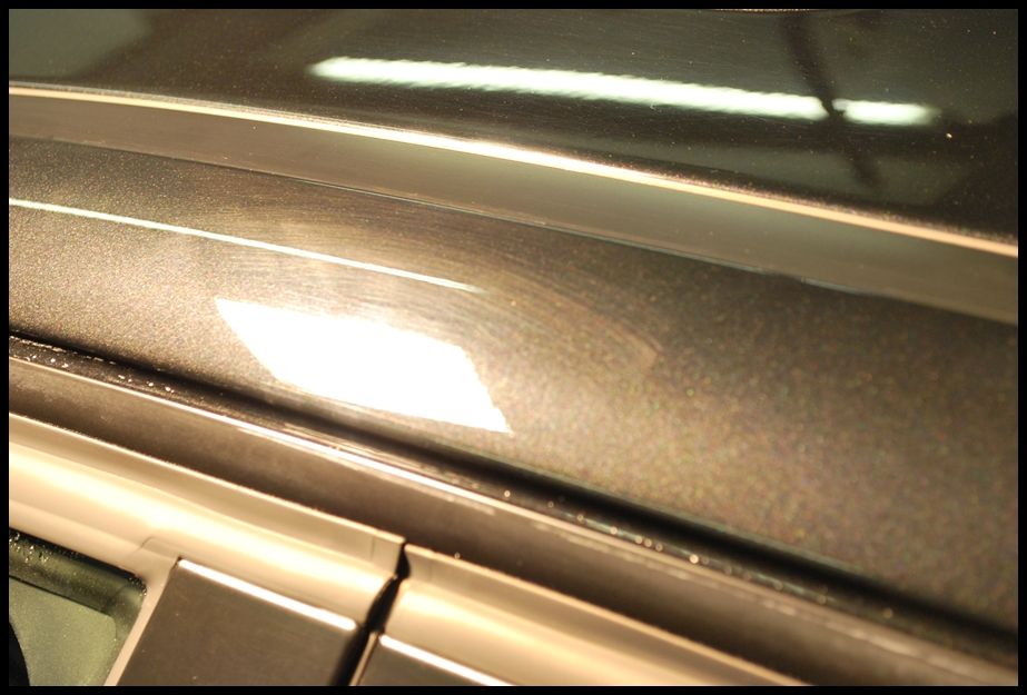

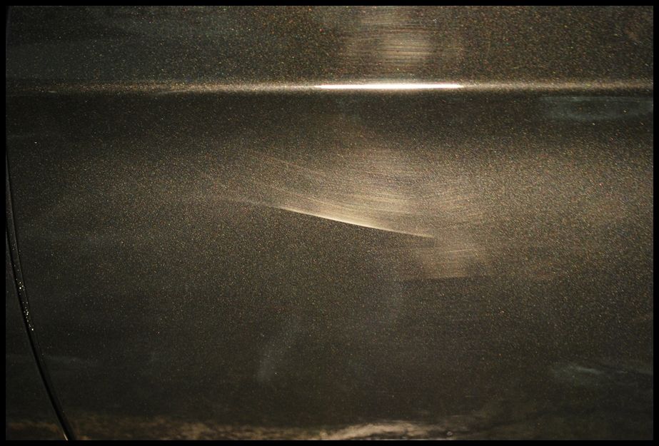

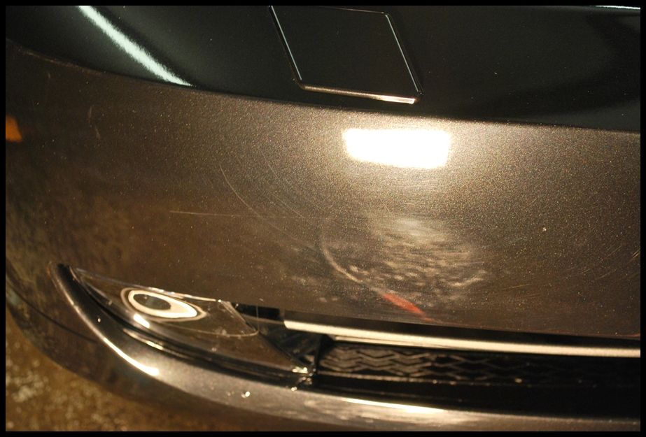

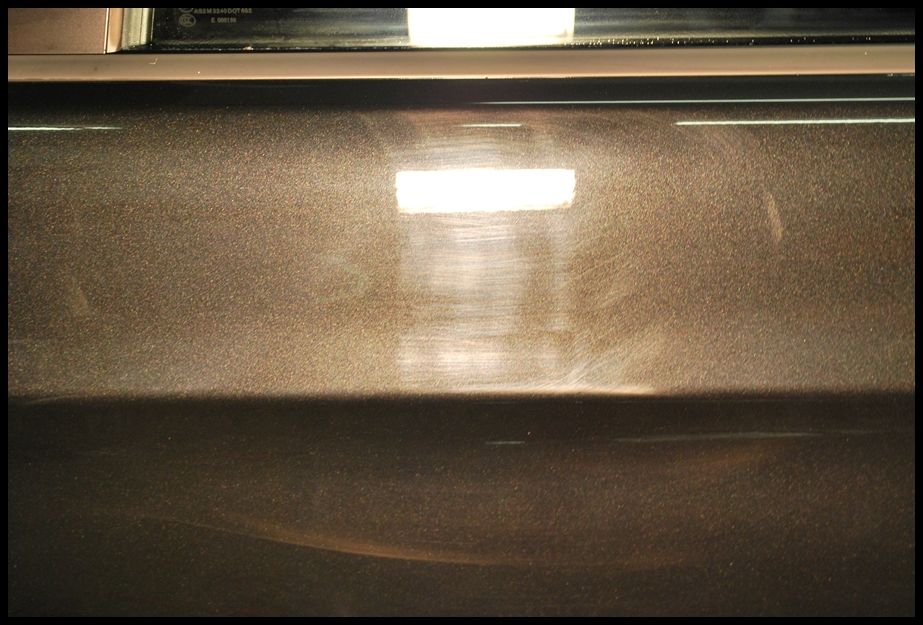

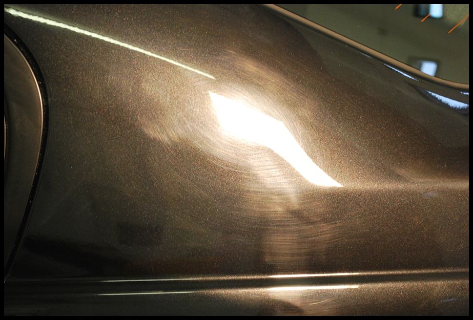

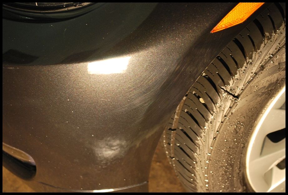

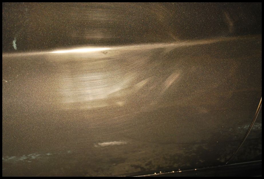

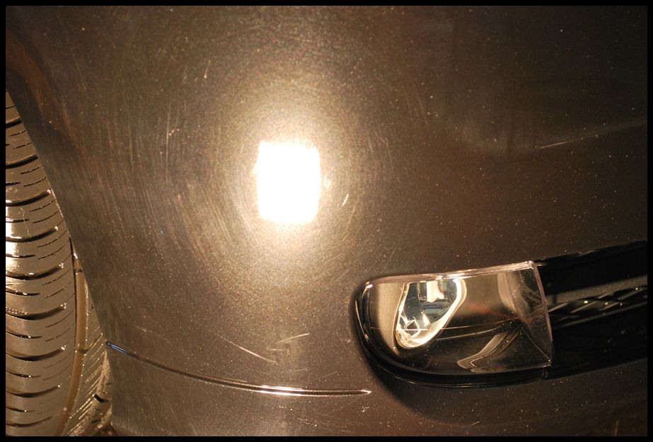

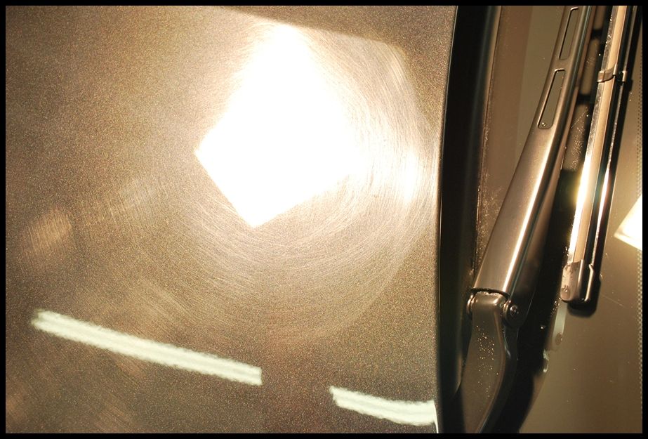

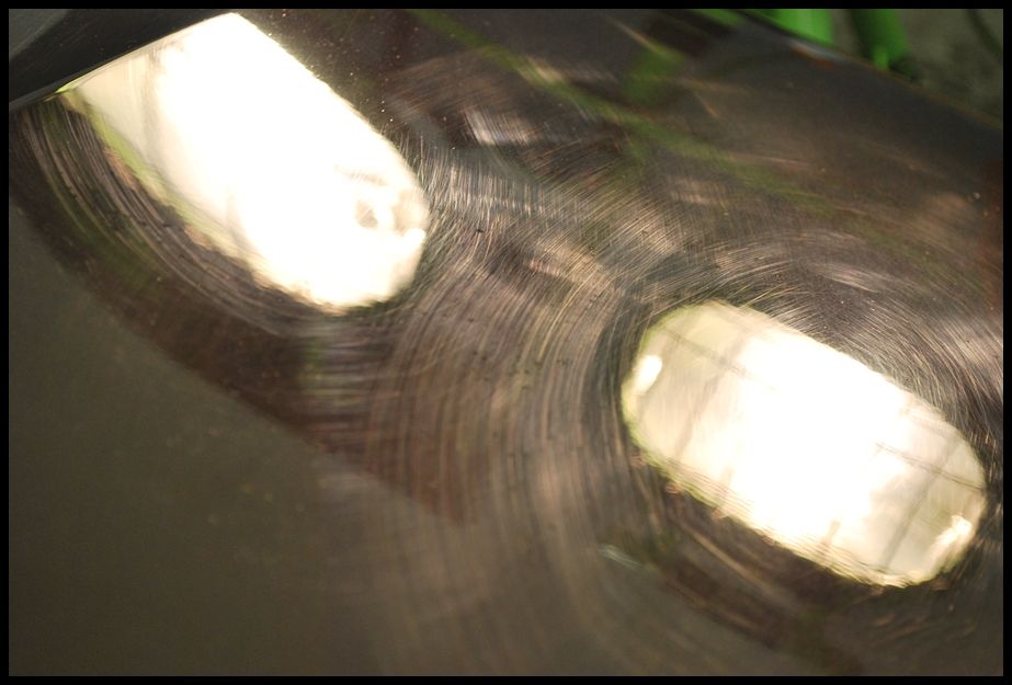

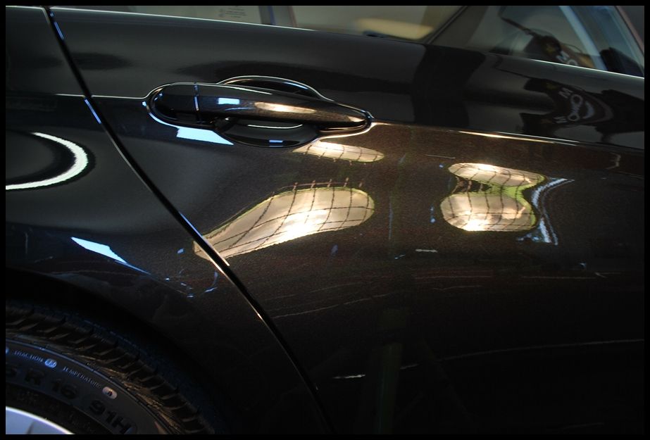

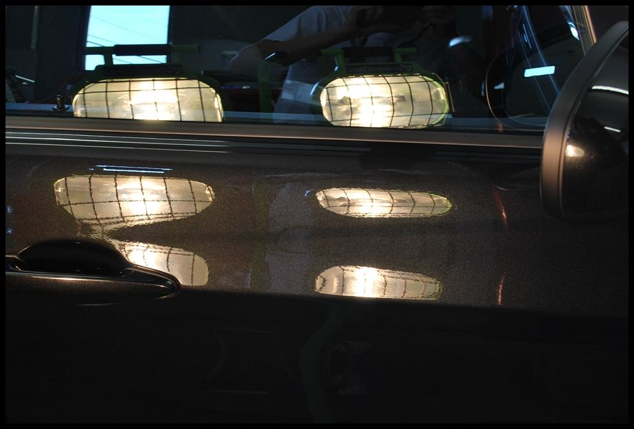

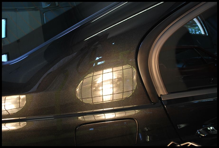

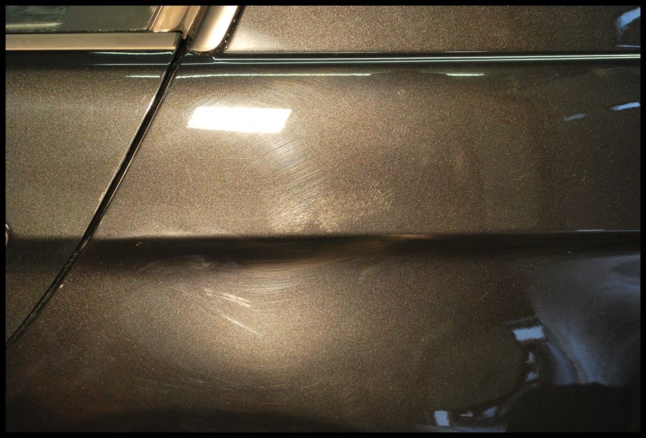

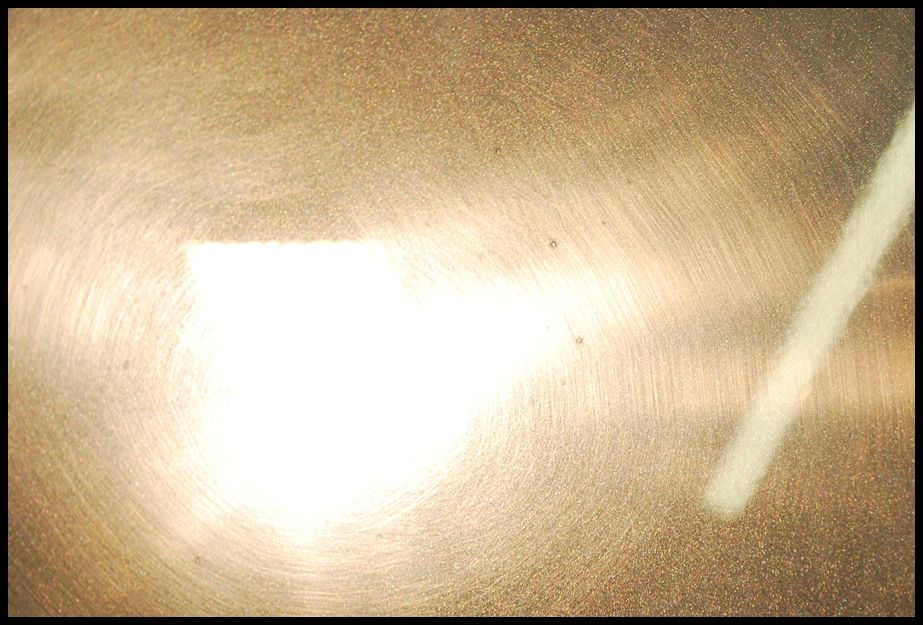

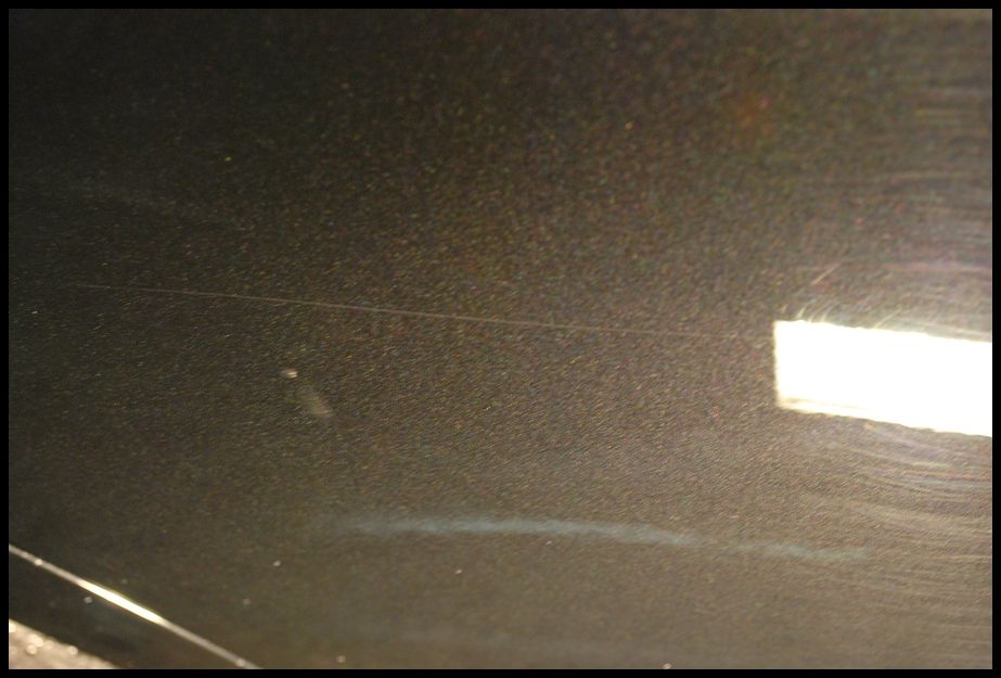

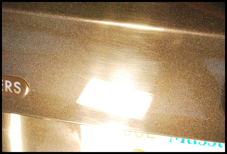

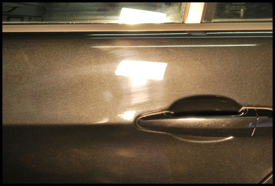

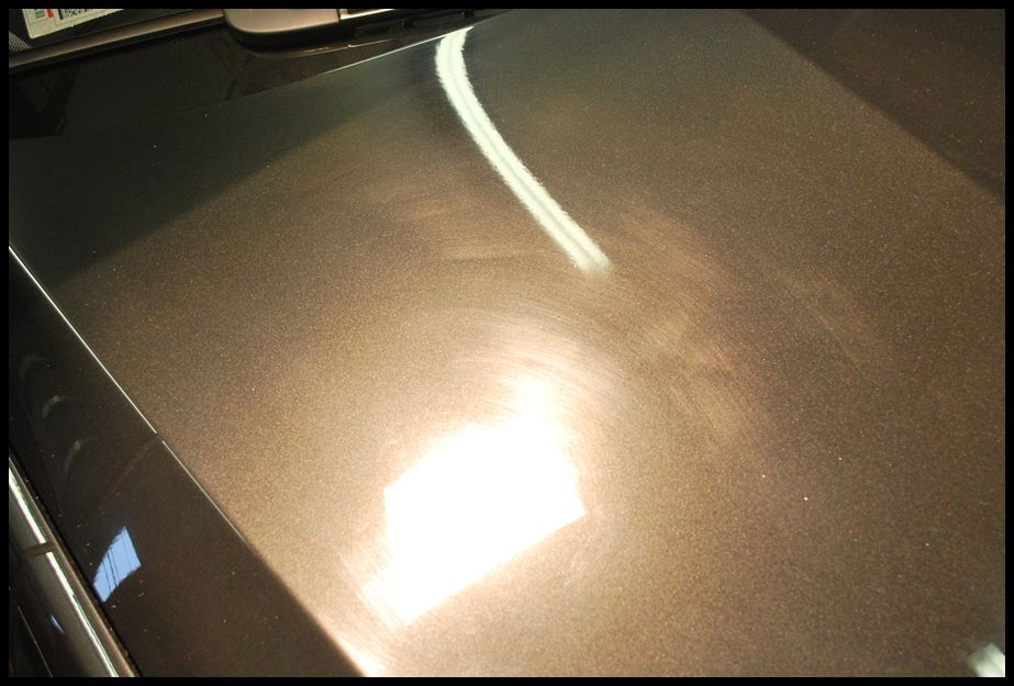

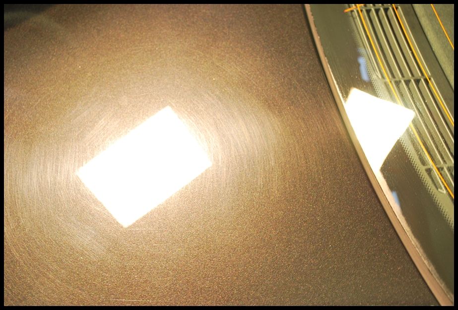

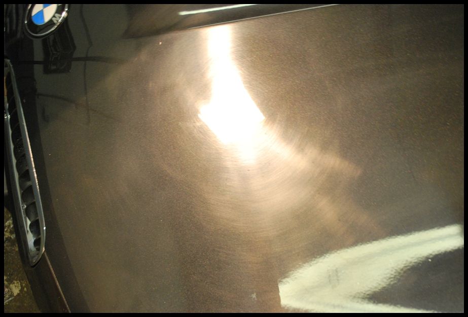

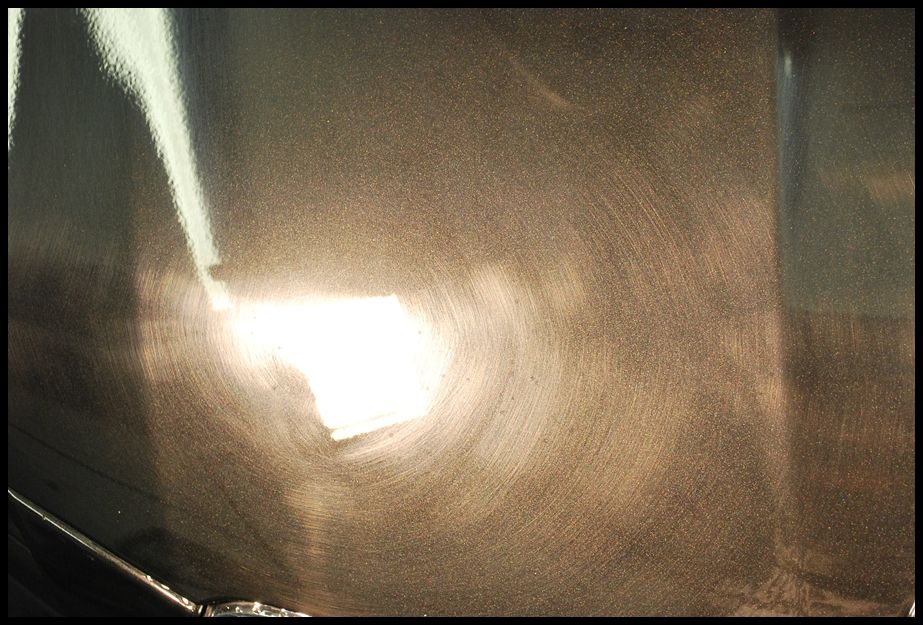

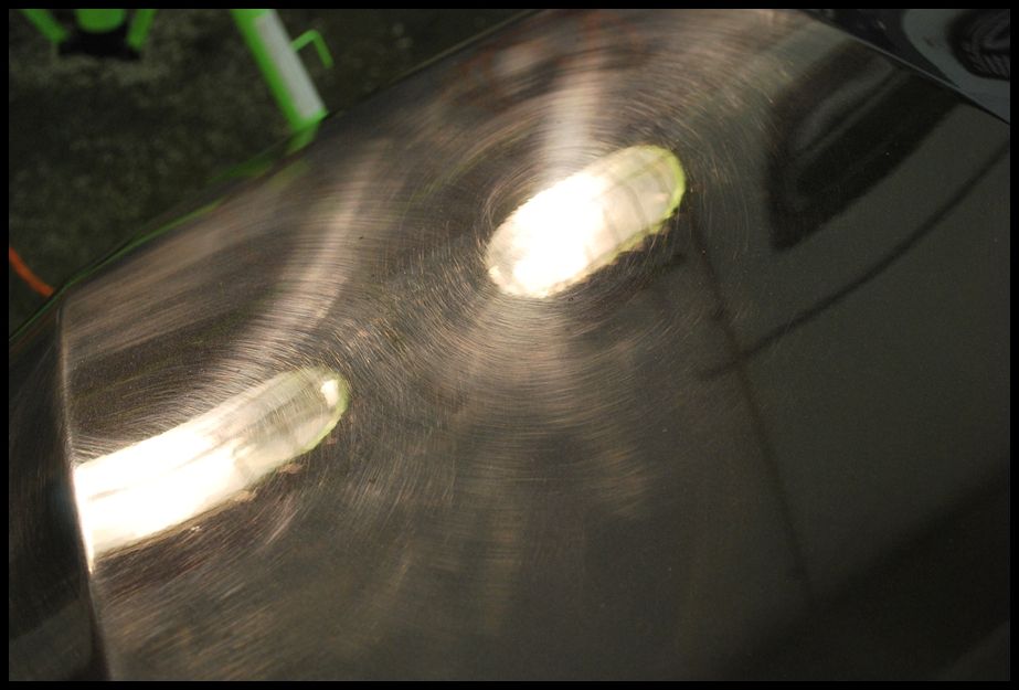

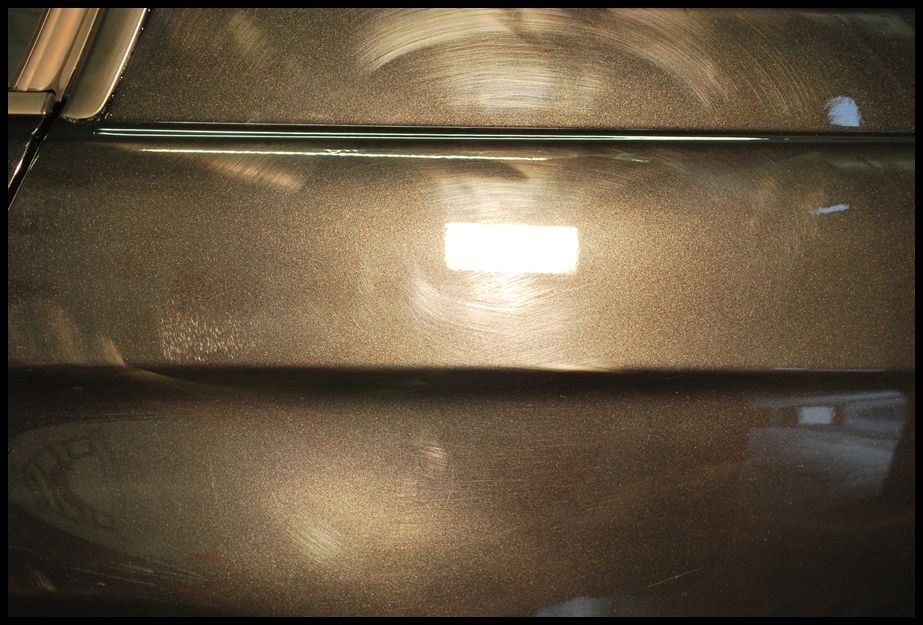

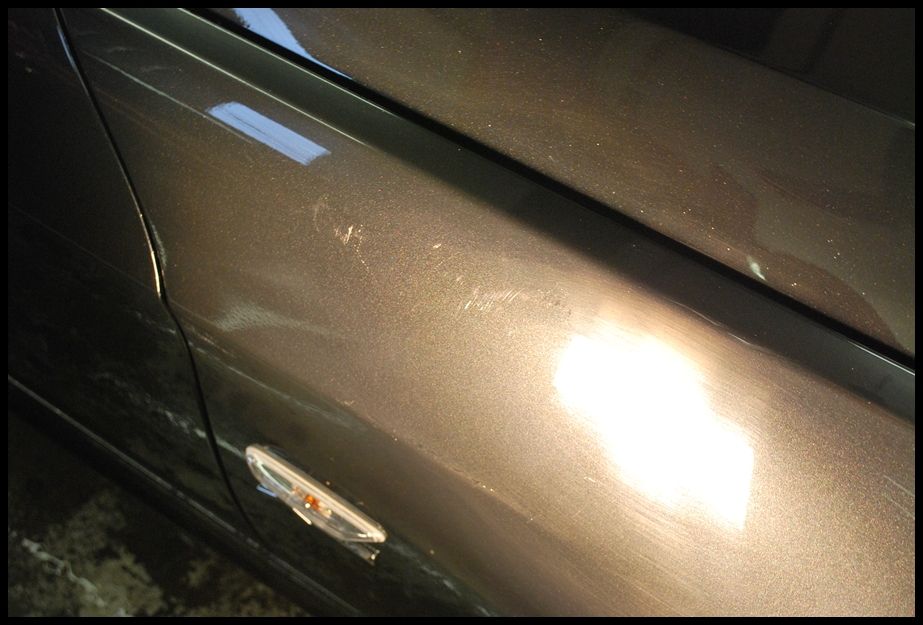

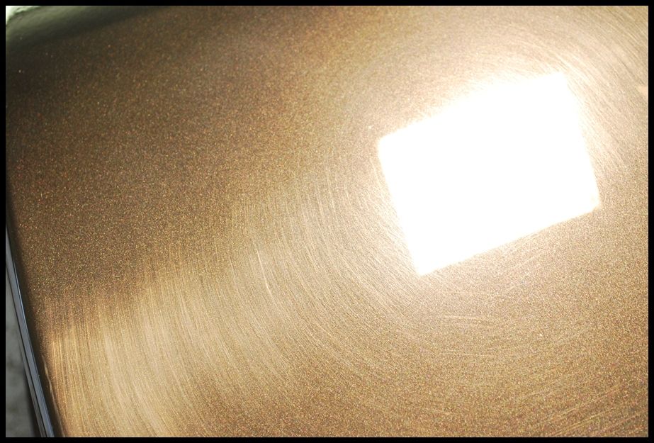

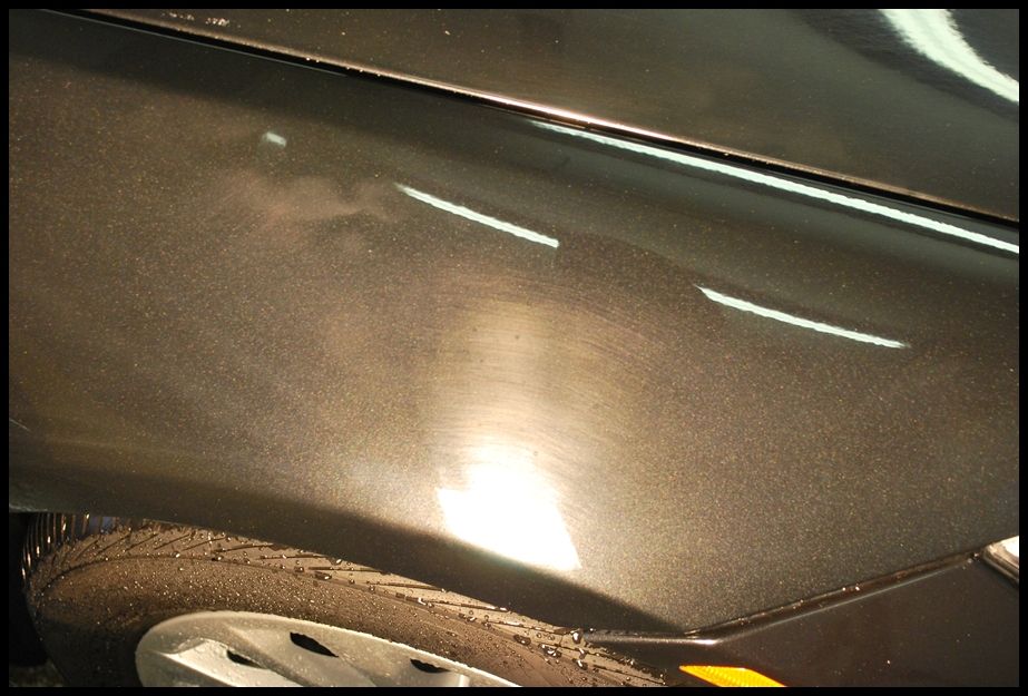

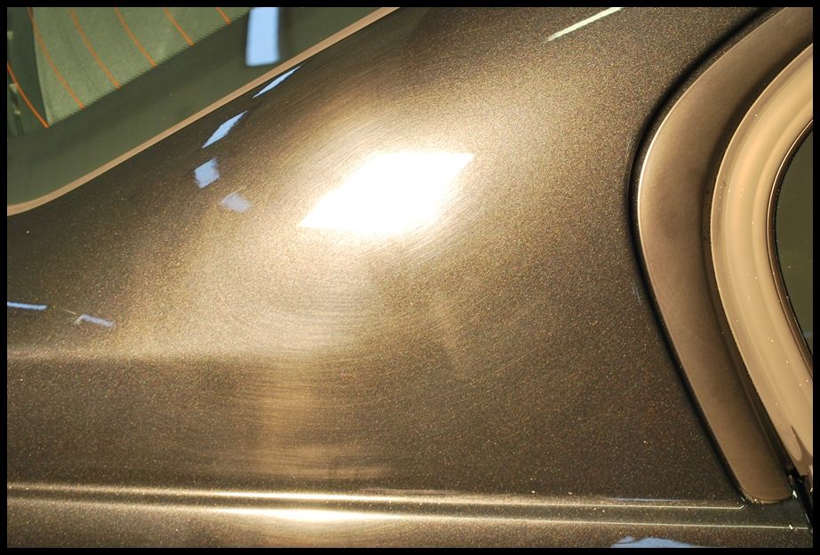

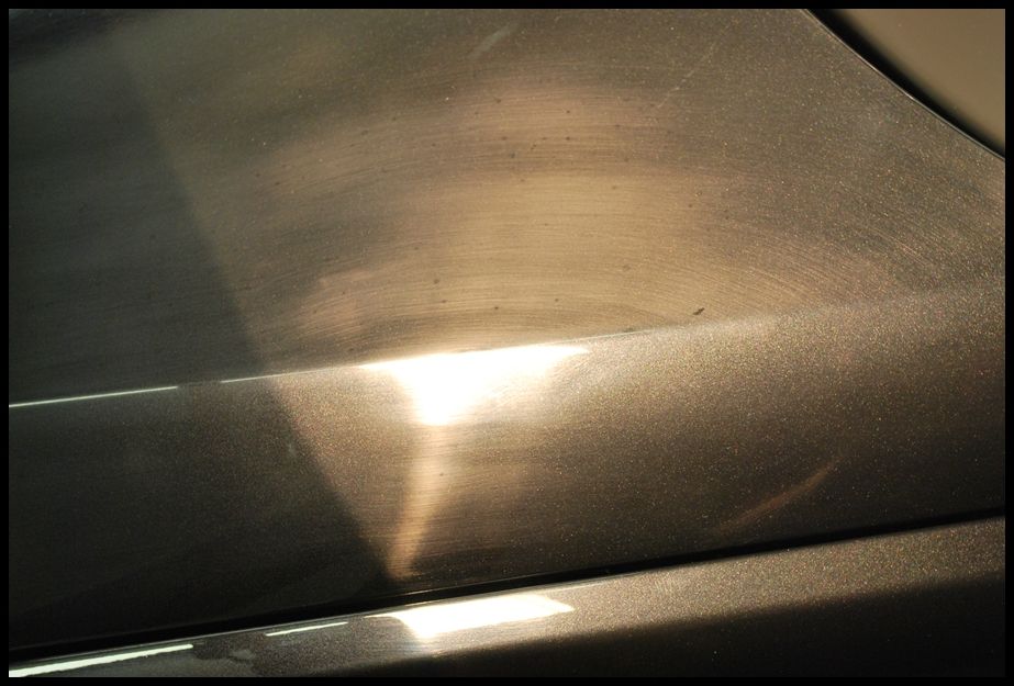

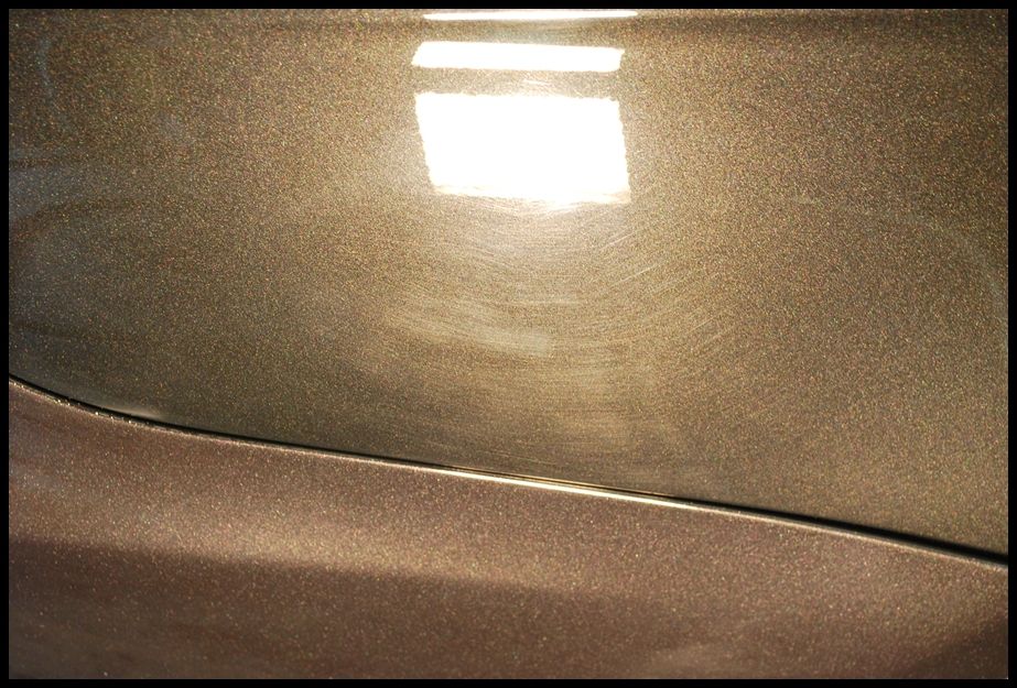

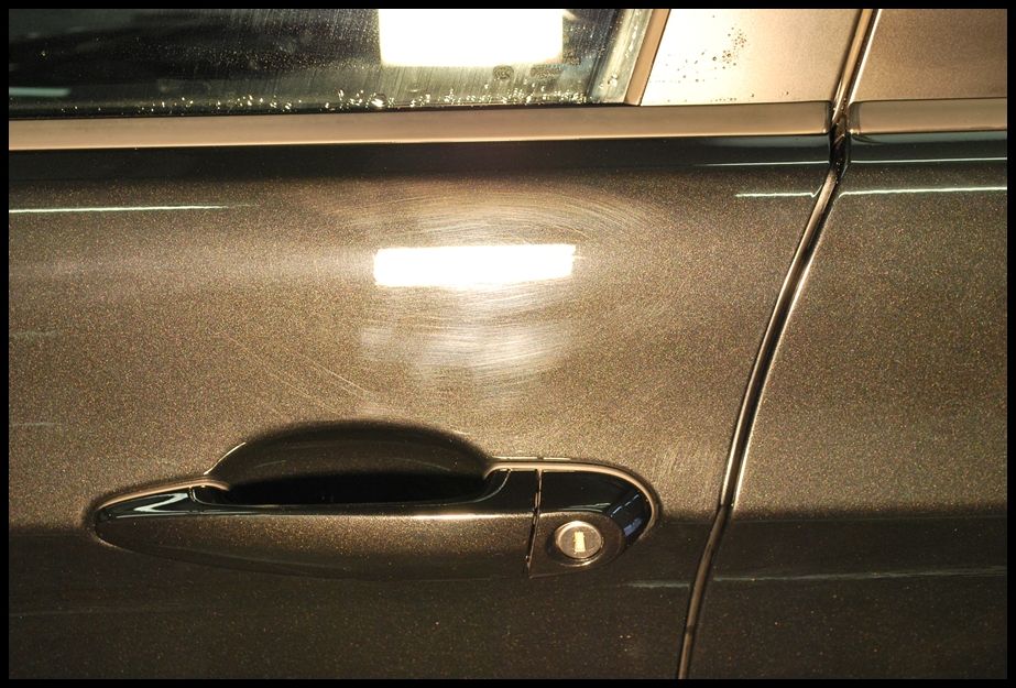

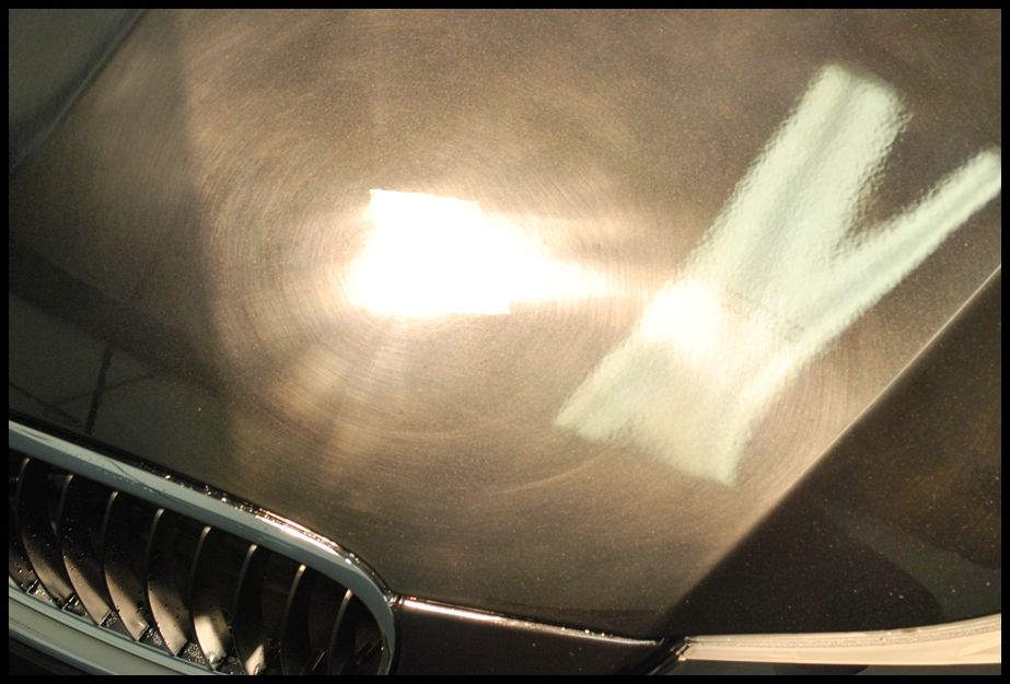

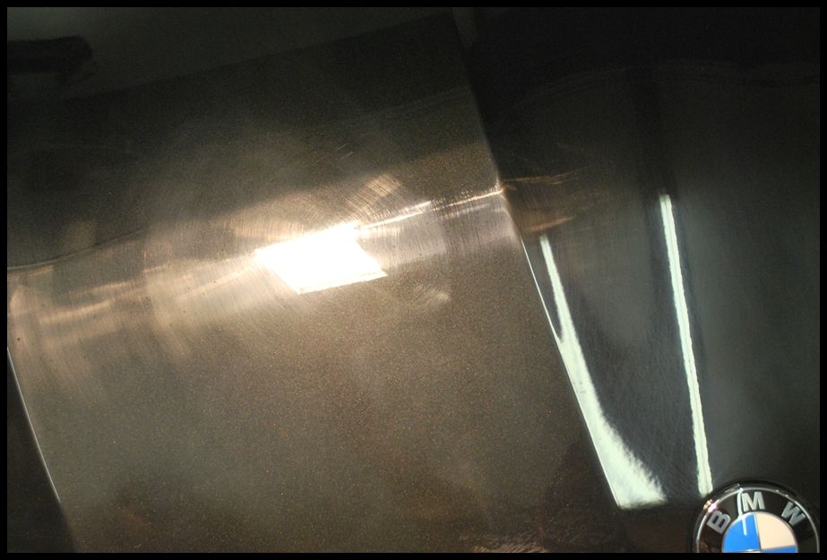

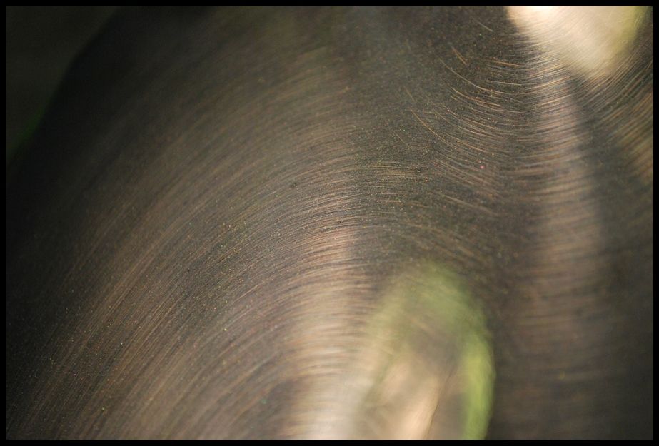

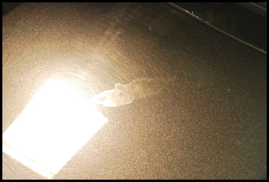

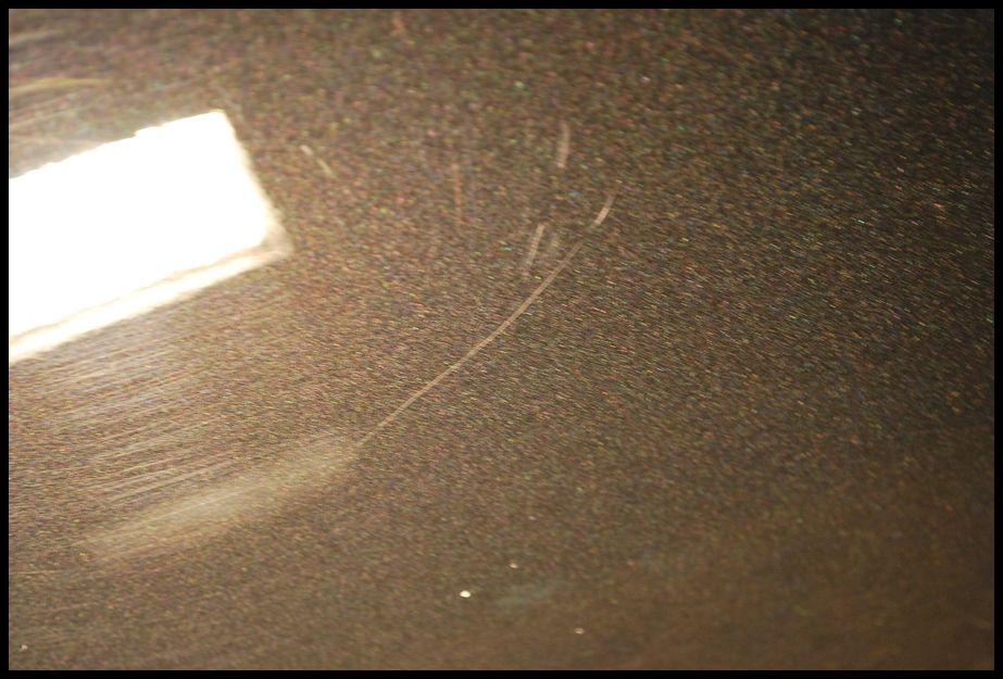

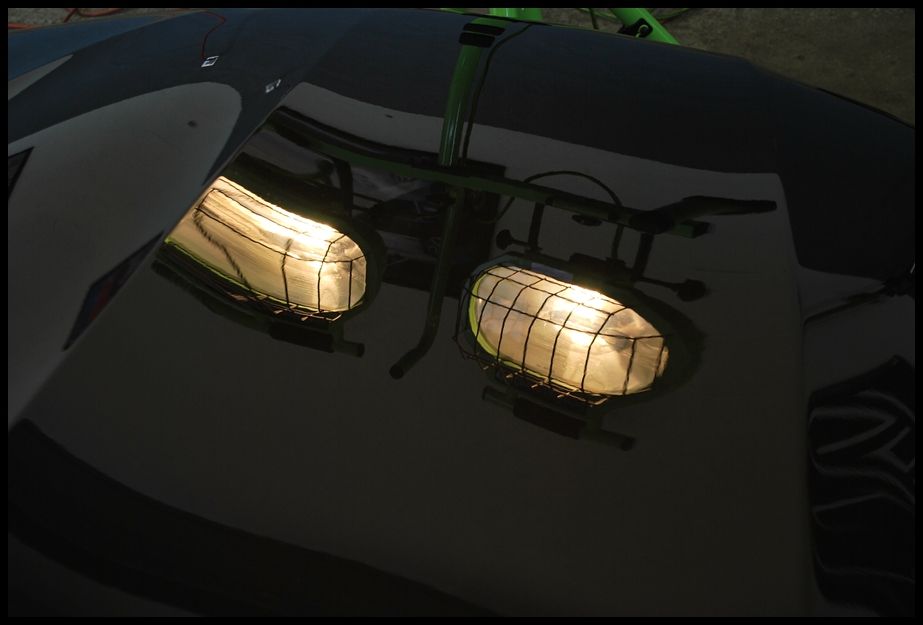

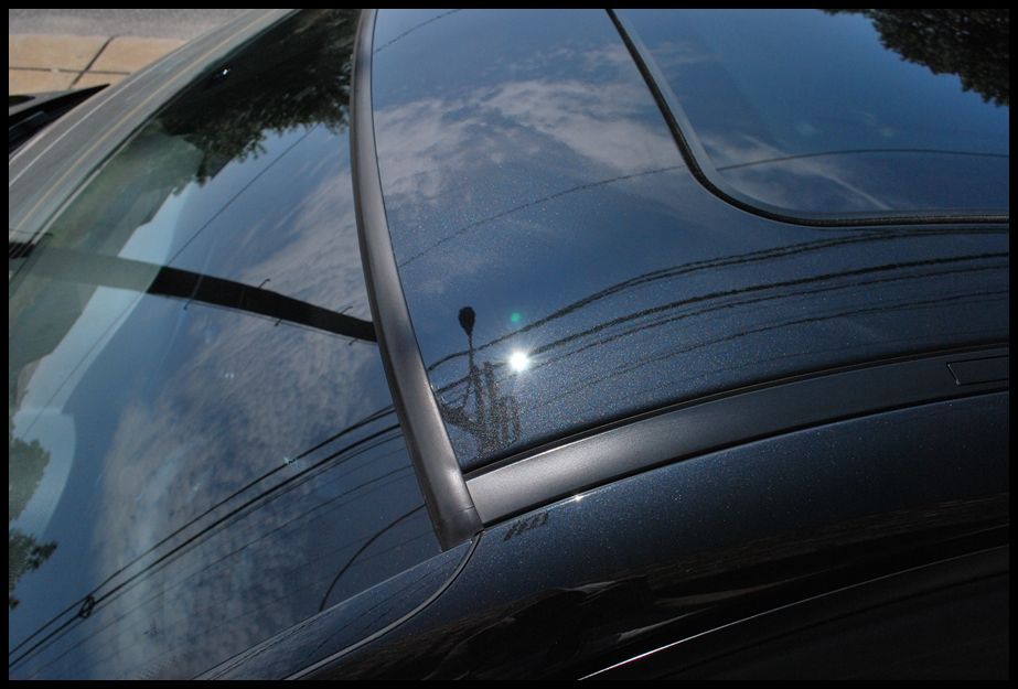

The pictures below show how horrible the paint was prior to any polishing…

We ended up polishing the complete exterior with 3M Extra Cut Compound using a cyan Hydra-tech pad via rotary, followed by Menzerna Super Intensive Polish using a tangerine Hydra-tech pad via rotary and finished off with Menzerna Power Finish using an orange 3M ripple foam pad via Porter Cable.
Alcohol wipedowns were performed between each polishing step to ensure no filling was taking place and the car was given a quick wash before the last polishing step to remove any product spatter from the cracks & crevices.All tires and wheel wells were dressed with Opti-bond tire dressing, all wheels were sealed with Opti-seal and the LSP of choice was Blackfire Wet Diamond.

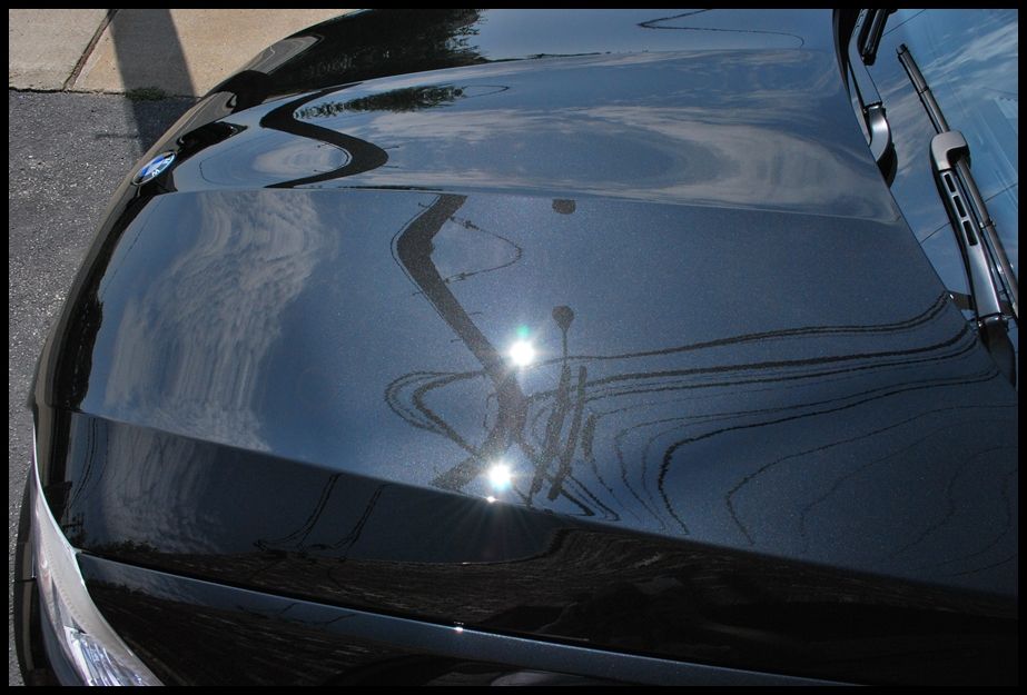

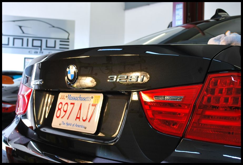

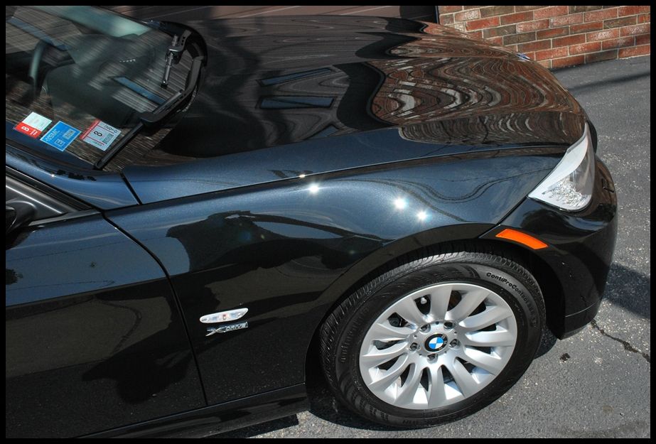

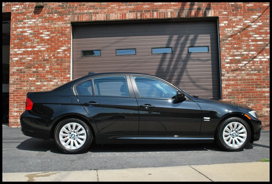

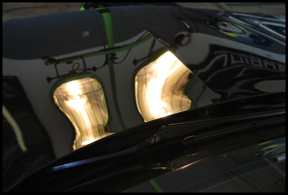

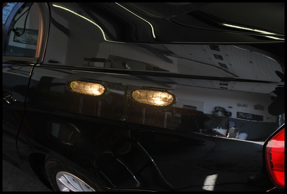

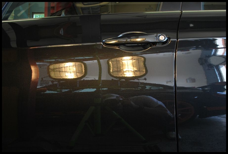

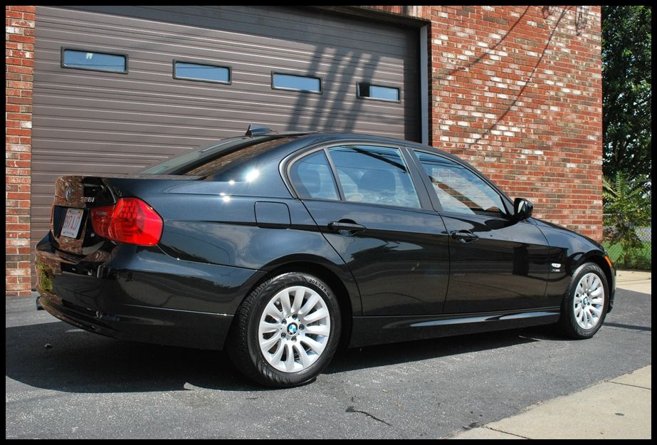

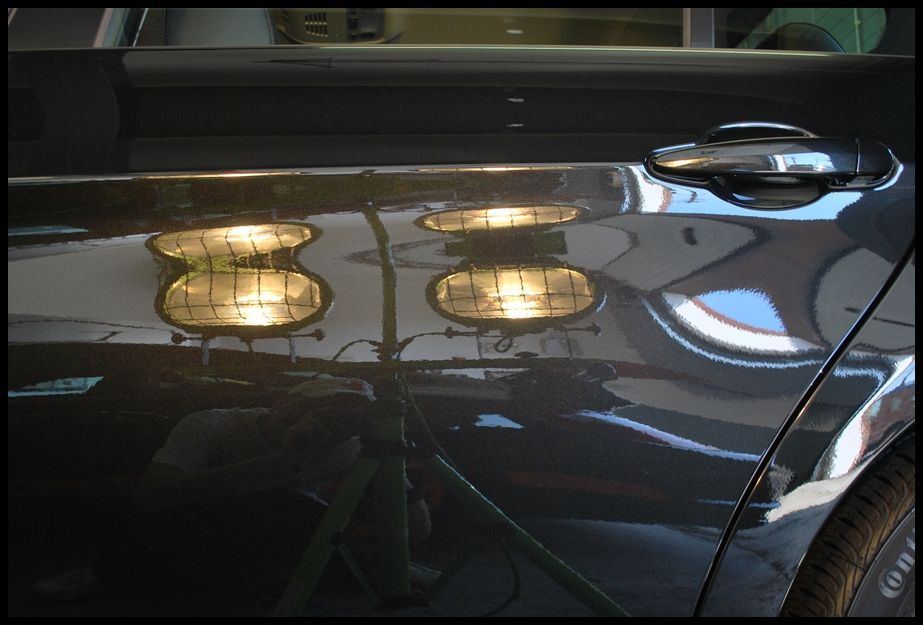

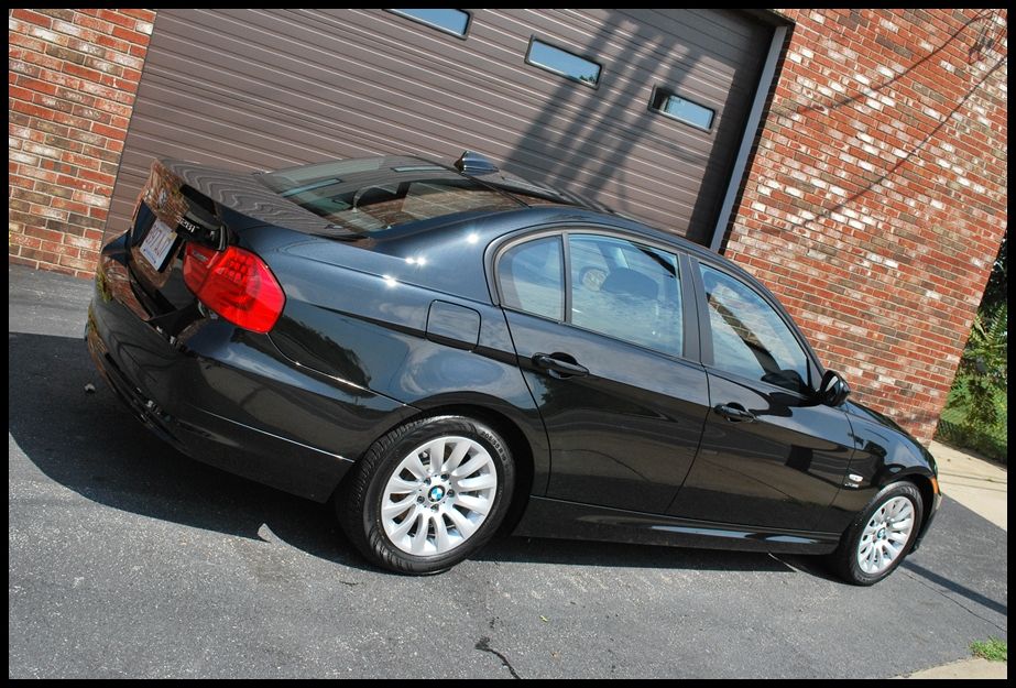

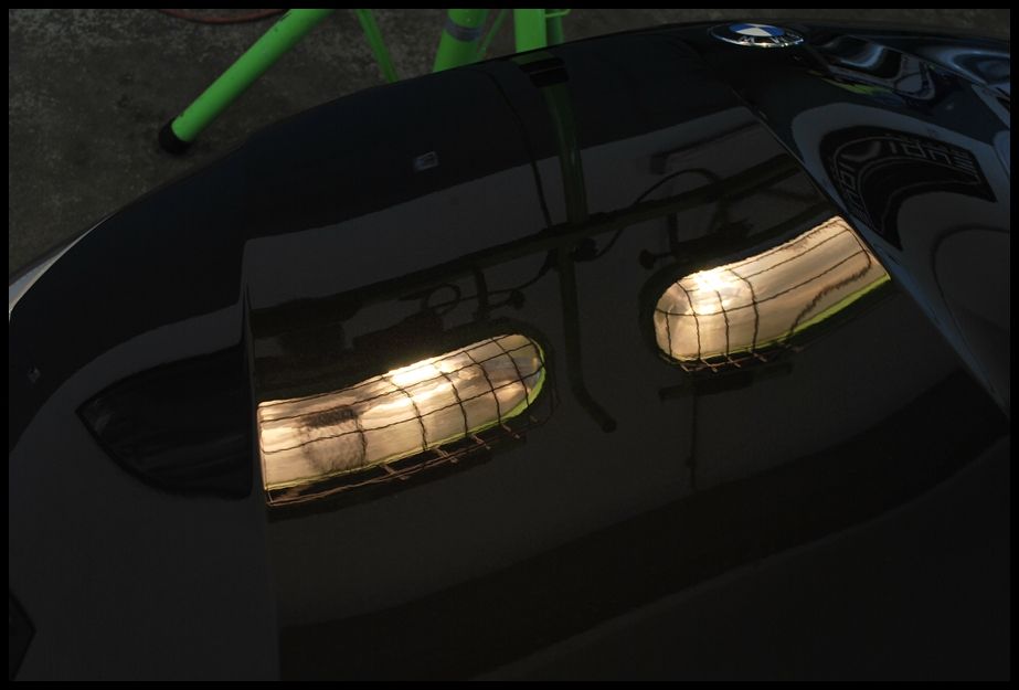

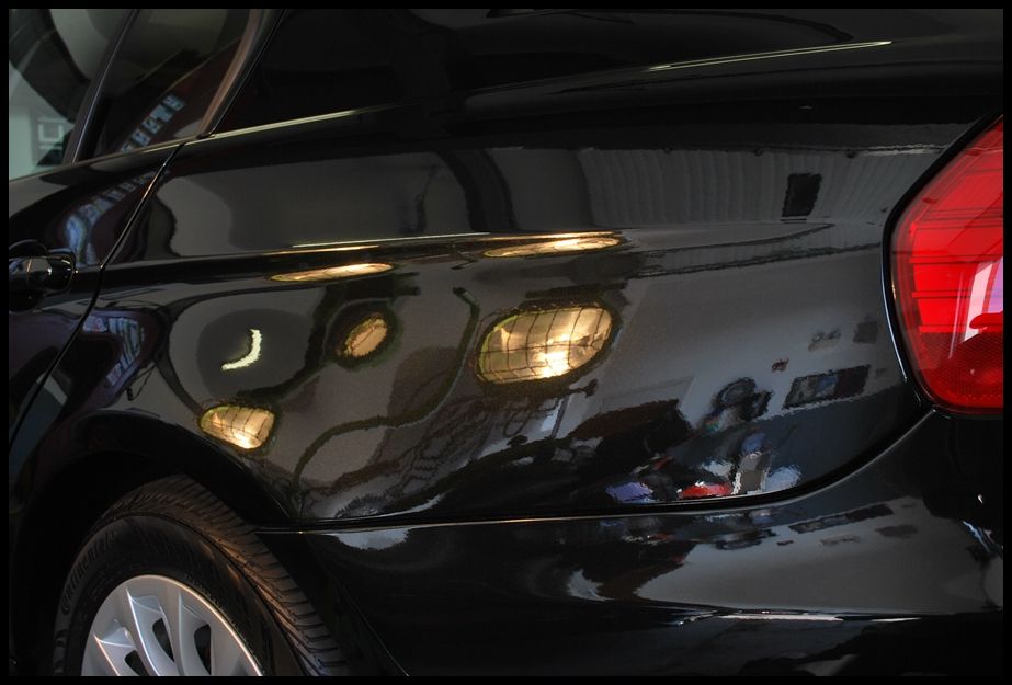

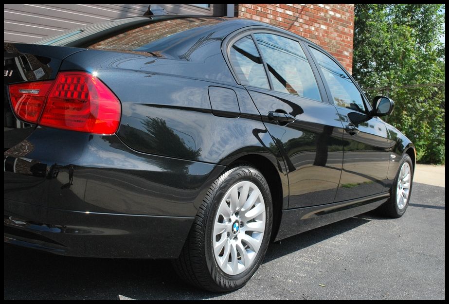

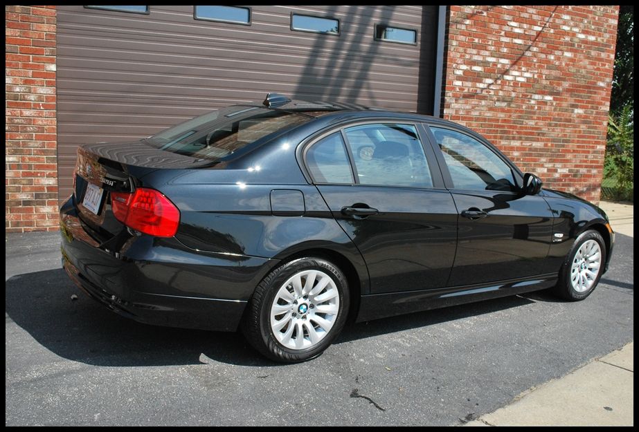

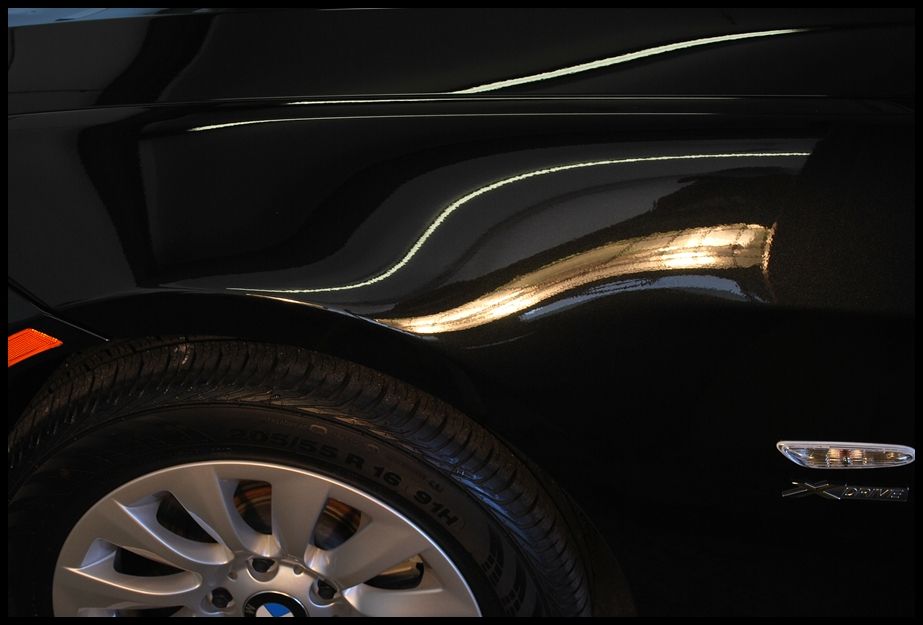

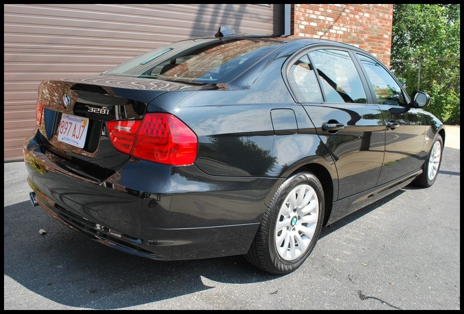

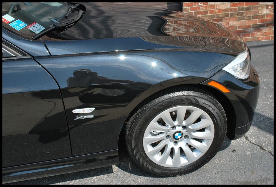

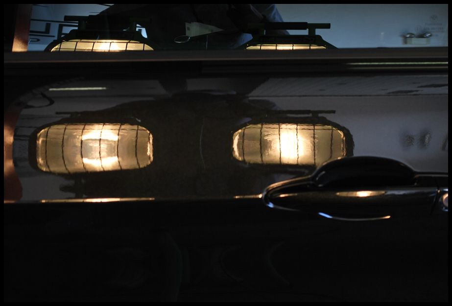

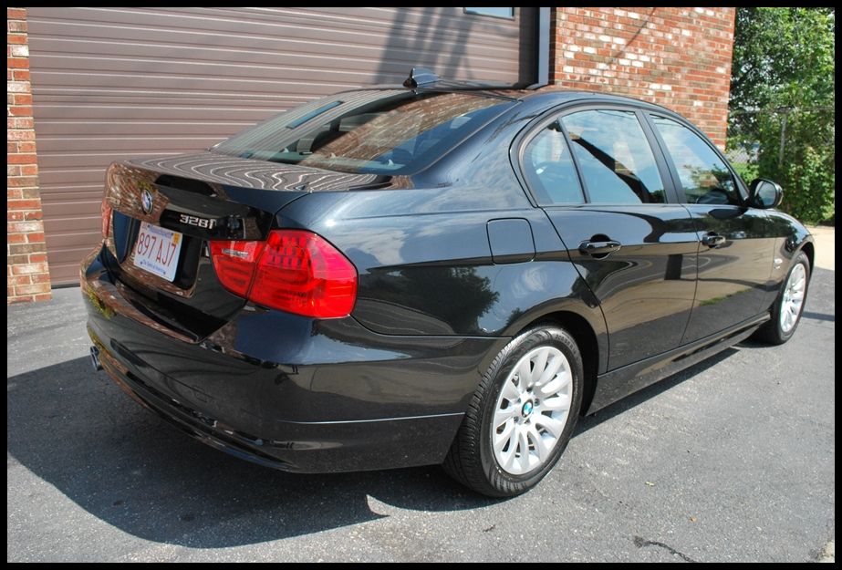

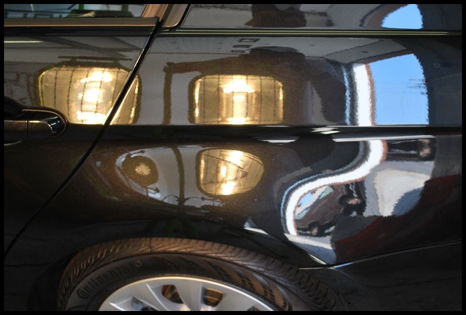

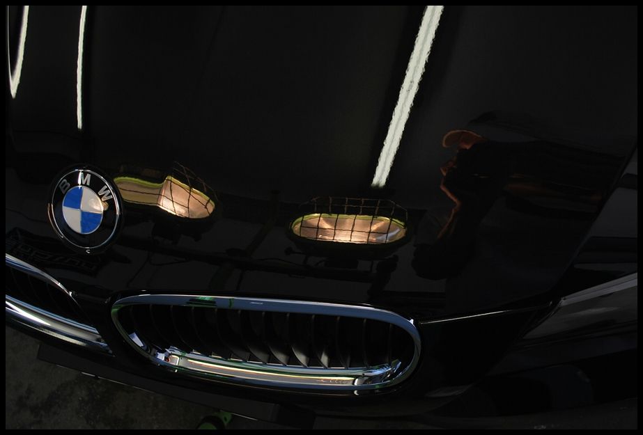

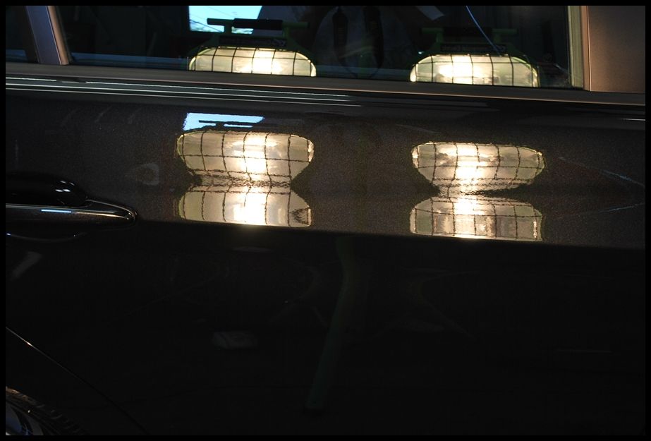

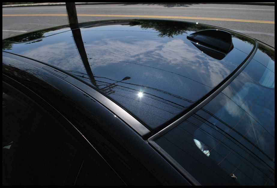

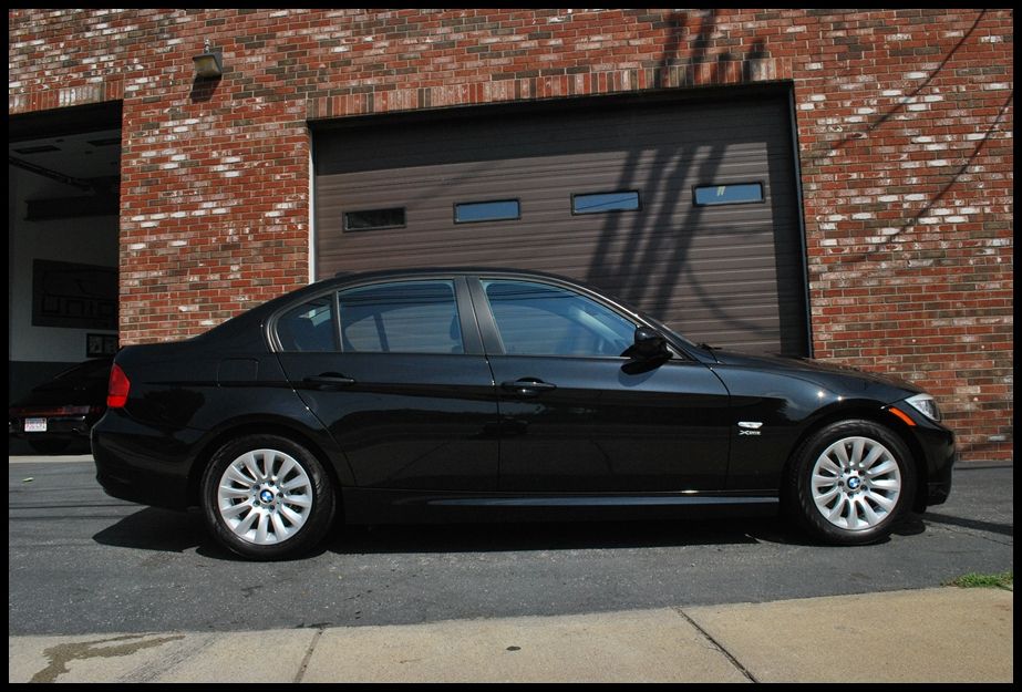

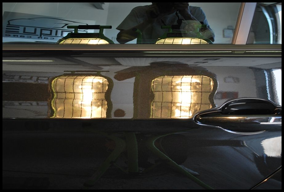

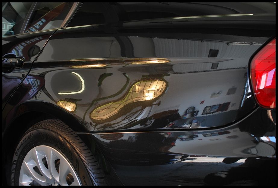

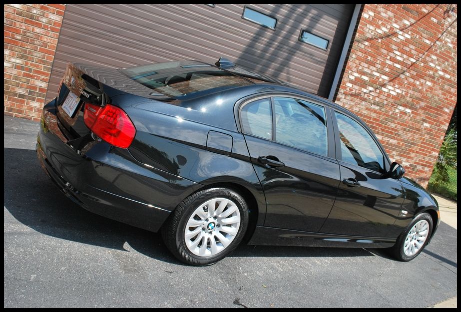

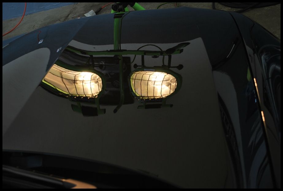

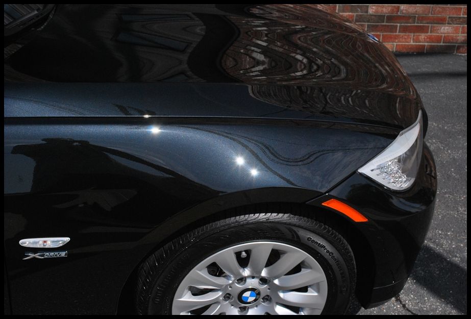

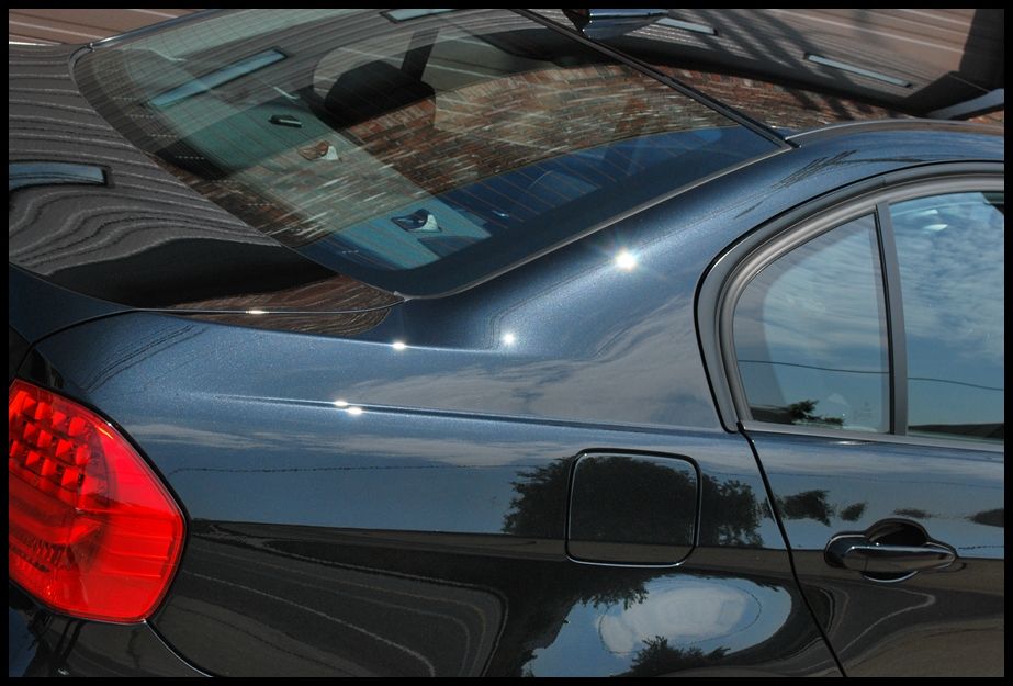

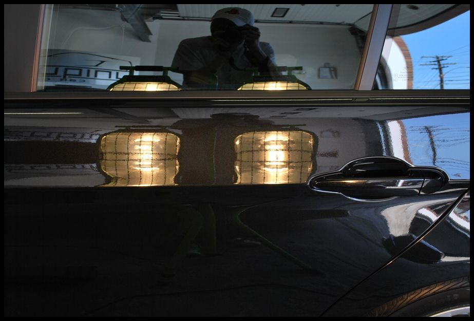

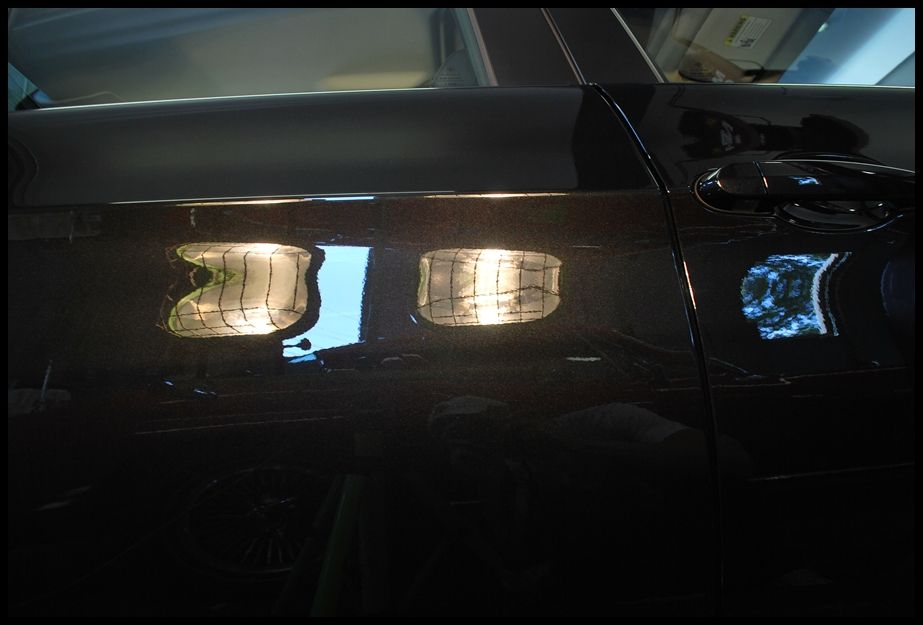

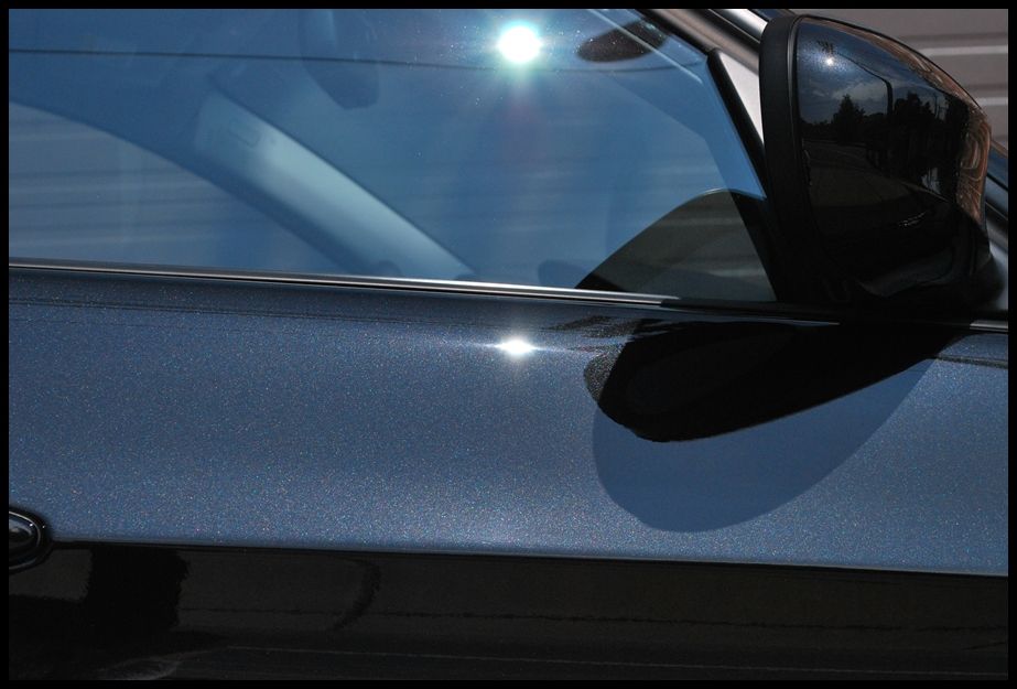

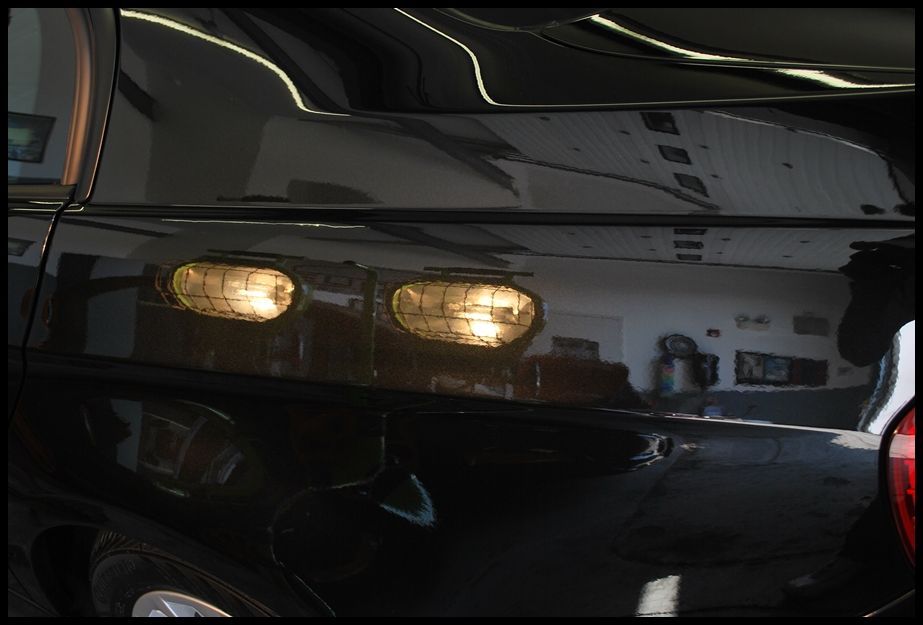

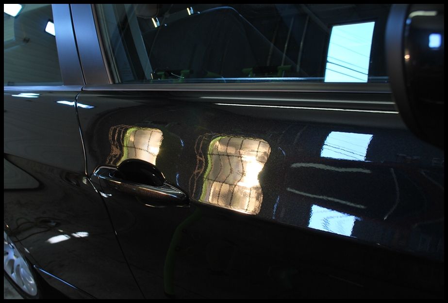

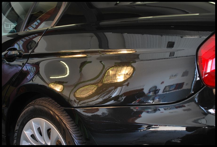

Here are the final results under halogen lighting…

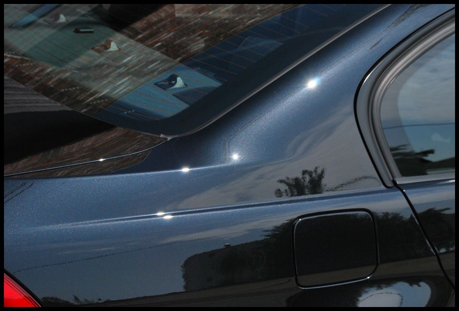

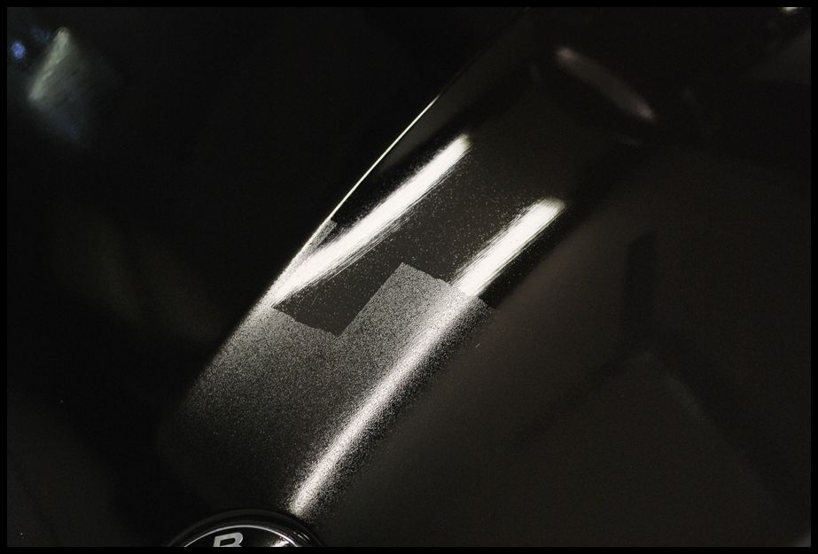

On this particular car, the dealerships body shop did the work, but I know that 95% of the cars I usually see from dealers will have a mobil repair company do the work. As you can see in one of the pictures, the color match wasn't the greatest...
