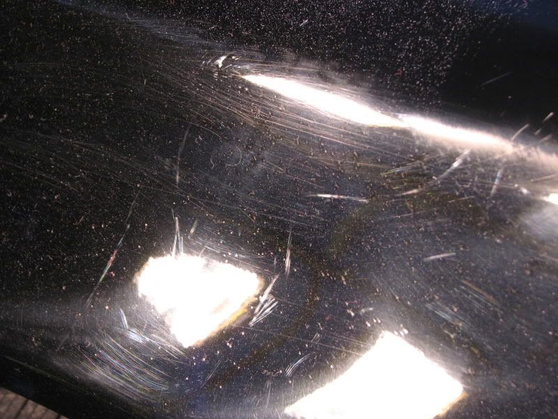

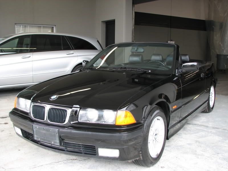

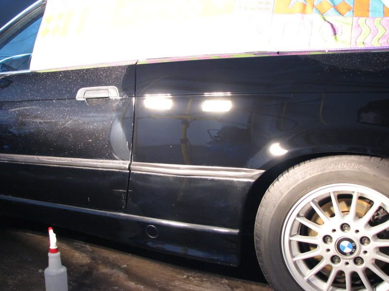

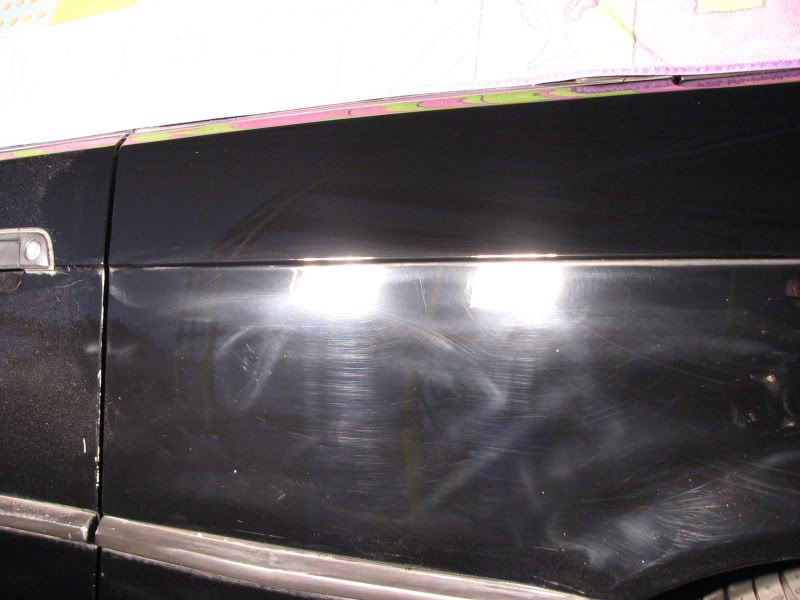

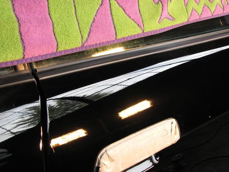

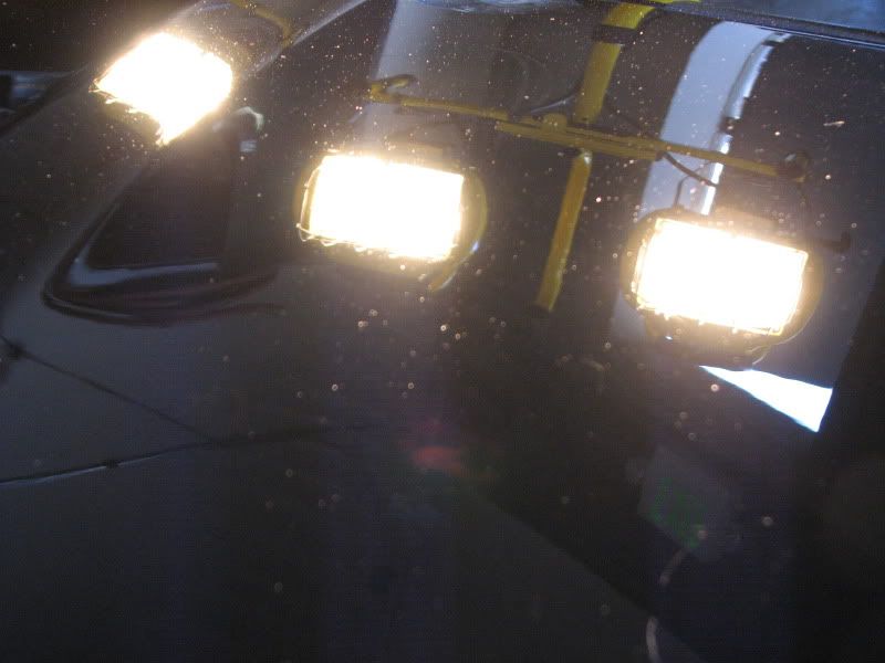

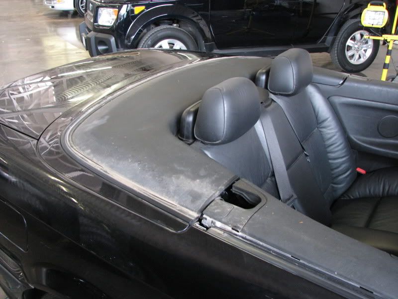

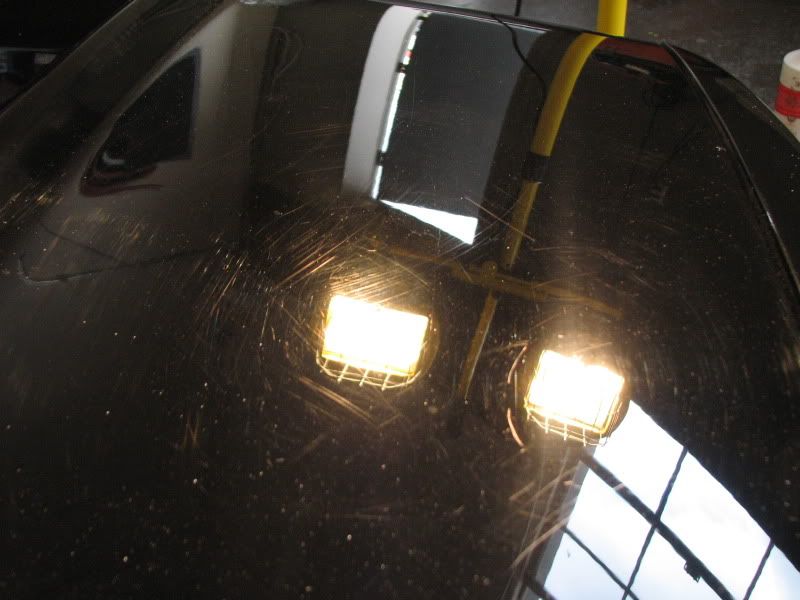

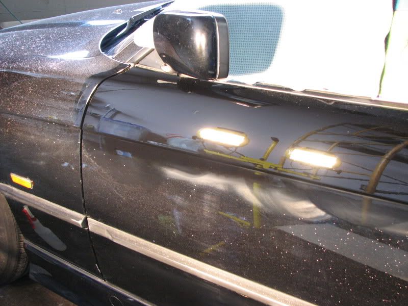

BEFORE
AFTER

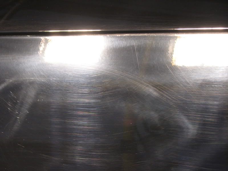

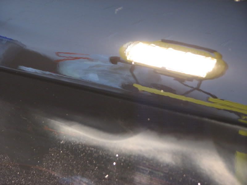

MAKING PROGRESS
BEFORE
AFTER
Thanks gents.
HD UNO - wool,yellow, orange,
EZ CREME - finishing pad
HD POXY is curing over night.
Still need to do the interior and it doesn't look pretty.
PS:Clay bar didn't pick up much at all.

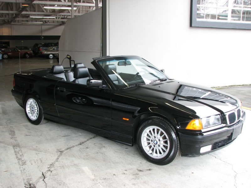

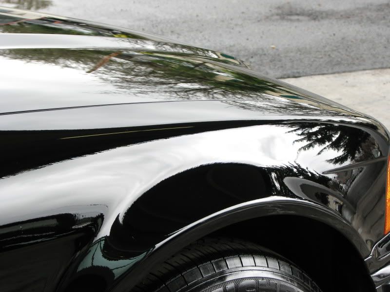

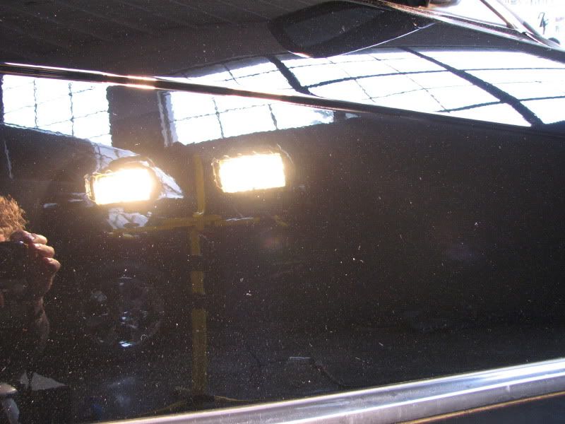

Ok, so the car is now all done. Worked 5 days total on it.
The hood for some reason had very thin paint on the windshield side. About the first 10 - 12inches had only very low 80, so there was no paint correction done on the area, only medium polishing. Swirls are gone, however all RIDS remain. Some edges also had RIDS that were not removed completely, but I reduced them as much as possible.

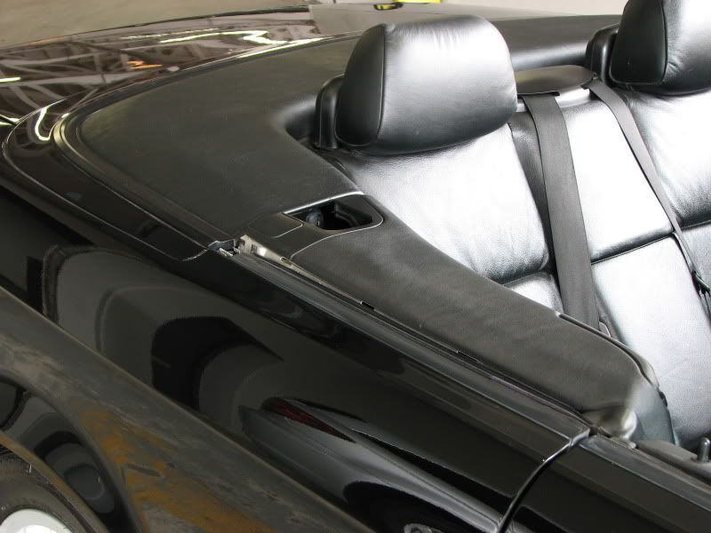

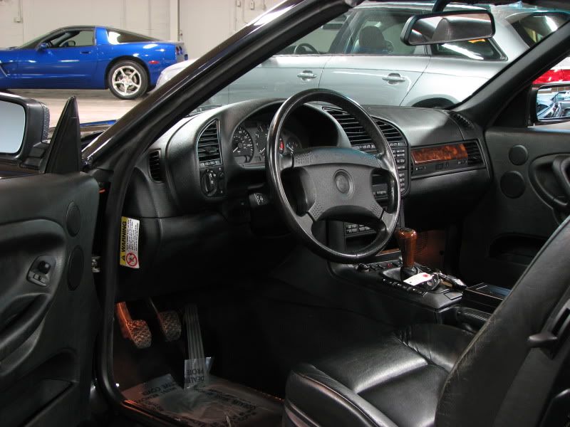

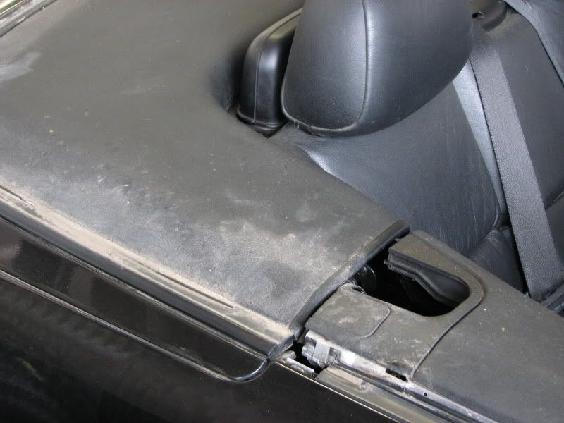

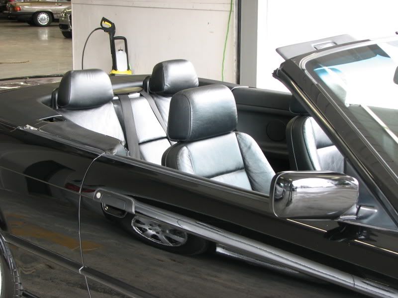

Interior Process:
Vacuum
3D interior APC
Steam
3D/HD mix - protectant
3D QD on windows
Before
After

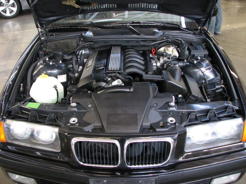

Engine After

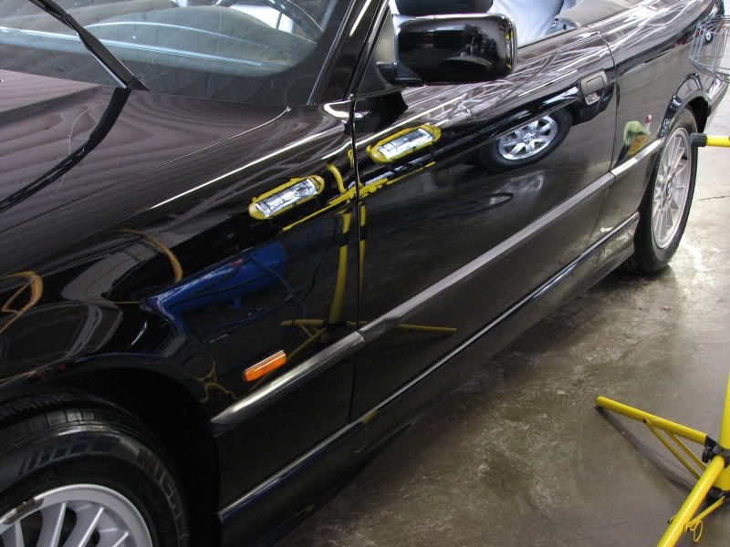

NOW THE EXTERIOR

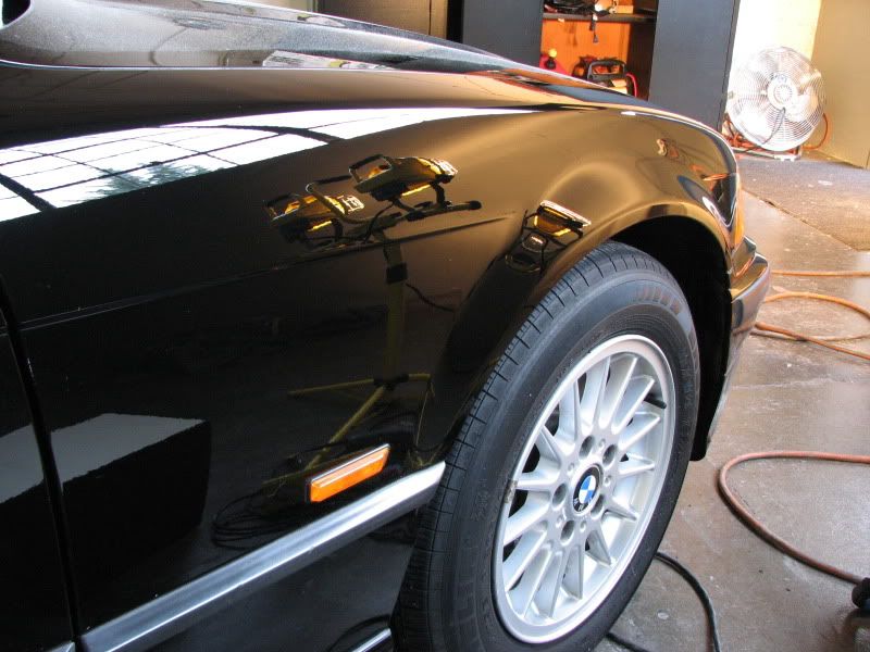

AFTER CORRECTION
LEFT DOOR
tdekany- Hey, great work there!
Was that paint soft like today's Jet Black, or really hard like my '97's Byzanz Metallic?
Interesting that the paint was OK with such a low reading; mine was having issues where it was thin, even though it read a lot thicker than that (I suspect you can see such problems more with metallics than with straight colors).
Oh, and I see some more interesting vehicles lurking in the background :D
tdekany said:
Thanks Accumulator. The paint was very hard.
The paint was normal except for part of the hood, about a foot long line.
OK, sounds like mine. I do find it interesting that you could thin the nonmetallic paint so much more than I could the metallic :think:
