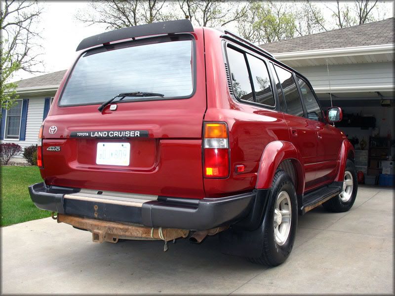

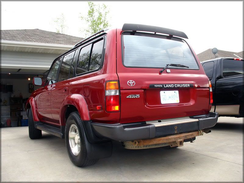

Not much to say about this one. I will let the pics talk.
The rusted hitch was replaced after the detail FYI.

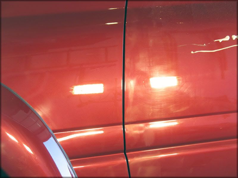

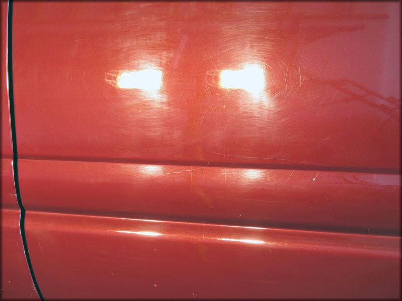

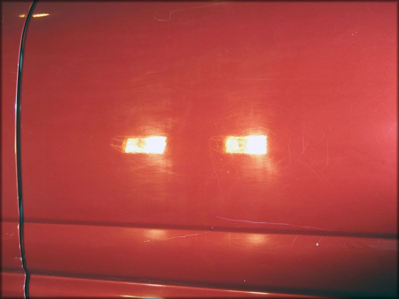

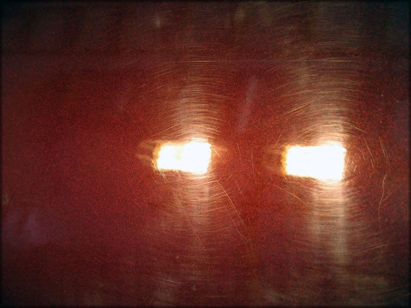

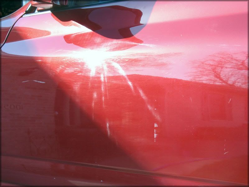

Exterior:
Wash Z7
Clay
HTEC via twisted wool @ 1500-1800
Optimum Polish @ 1200
ZAIO
Z5pro x 2
CS
Wheels Z16
Wells, sprayed with undercoating (left only, right sprayed after pics)
Glass got Z12, then ZAIO, Z5pro
Z16 on trim

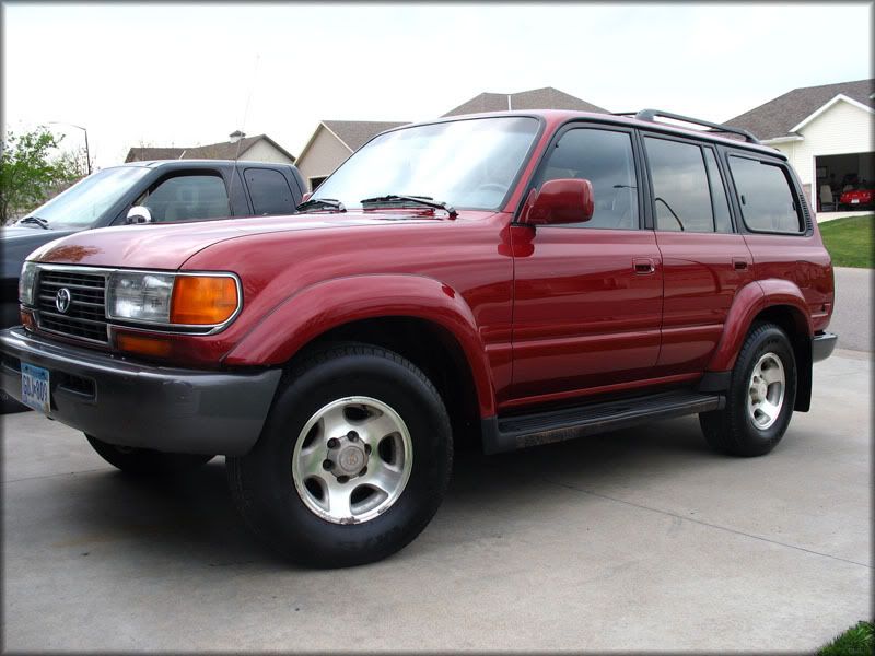

Ouch! You saved that SUV from a future at the County Fair Demolition Derby.
The before shots are just... :shocked -especially on that paint color, which masks defects pretty well.
You nailed it on the correction steps. It’s absolutely GLOWING!
When the owner paid for the detail, he probably felt like he was picking up a new SUV.
When people look at your car, they must shake their heads and cross it off as an anomaly; It has to be the best looking finish in the state of MN!
Great job man!:2thumbs:
MMMmmm red dripping paint! I know you mentioned the rusted hitch was replaced AFTER your detail which is a shame since it detracted the overall appearance of your photos seeing that rusty thing lol. The paint however is glowing as John mentioned above!
